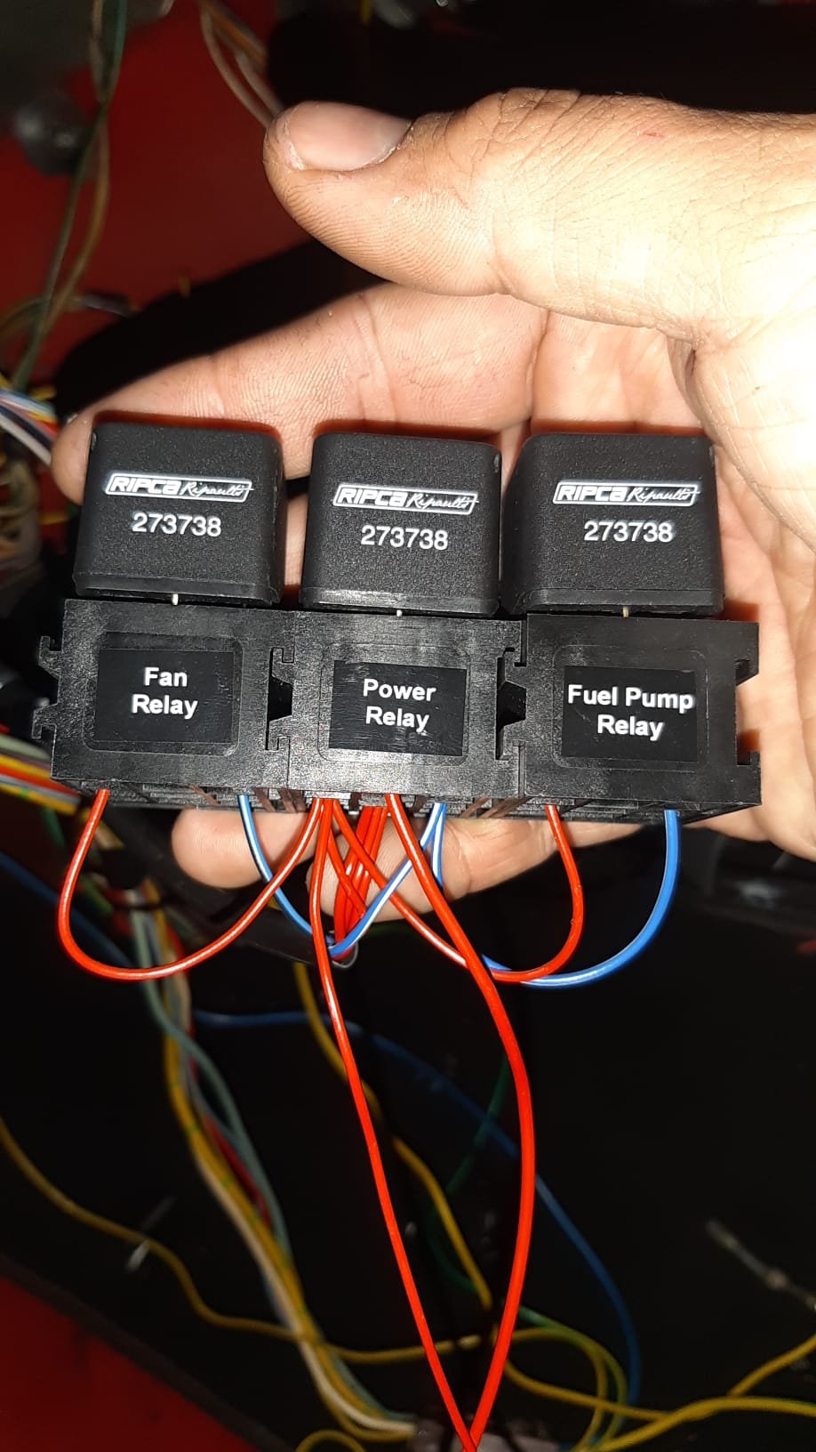

Ruben 0 Posted April 20, 2021 Hi folks! Just fitted an Omex 600 on my 205 1.6 GTI , but , i have a little doubt about how to connect the two red wires , one says ign and another says battery , i think i allready found the place for those , the battery goes to the red wire that comes from the key and the ignition one goes to a blue wire that feeds the starter engine, correct me if im wrong. Still i have other two cables one blue and another blue and green that goes to DASH , but i dont know where those go. Best Regards! Ruben Figueira Share this post Link to post Share on other sites
welshpug 1,737 Posted April 20, 2021 (edited) wrong! battery, shock horror... goes to battery! this will be a permanent live feed for the relays. ignition is for the red wire switched by the ignition key, originally goes to the ignition coil, this will turn on a relay which will turn on the ecu. ecu will turn on the fuel relay when it sees an engine speed signal. dash wiring depends on function, I would imagine one will be a rev counter feed and another for a shift light maybe, look at the wiring diagram. Edited April 20, 2021 by welshpug Share this post Link to post Share on other sites
Ruben 0 Posted April 20, 2021 (edited) 3 hours ago, welshpug said: wrong! battery, shock horror... goes to battery! this will be a permanent live feed for the relays. ignition is for the red wire switched by the ignition key, originally goes to the ignition coil, this will turn on a relay which will turn on the ecu. ecu will turn on the fuel relay when it sees an engine speed signal. dash wiring depends on function, I would imagine one will be a rev counter feed and another for a shift light maybe, look at the wiring diagram. Thats exactly what i tought at first , but after i asked the person who sold me the wiring and the ecu itself , he told me that the two red wires should be connected on switched lives + and not permanent ones. I tried to see in the ecu installation manual but i dont seem to find any info about the DASH wires and their location. I have three relays , one for the power supply , one for the fuel pump and anothet one for the fan , but i might not use the one for the fan, the power supply relay feeds the fuel pump and also feeds the fan relay. The fuel pump relay is bridged by the power supplie. Btw , thanks for the advising and the correction! Best Regards! Ruben Figueira Edited April 21, 2021 by Ruben Wanted to add info Share this post Link to post Share on other sites
