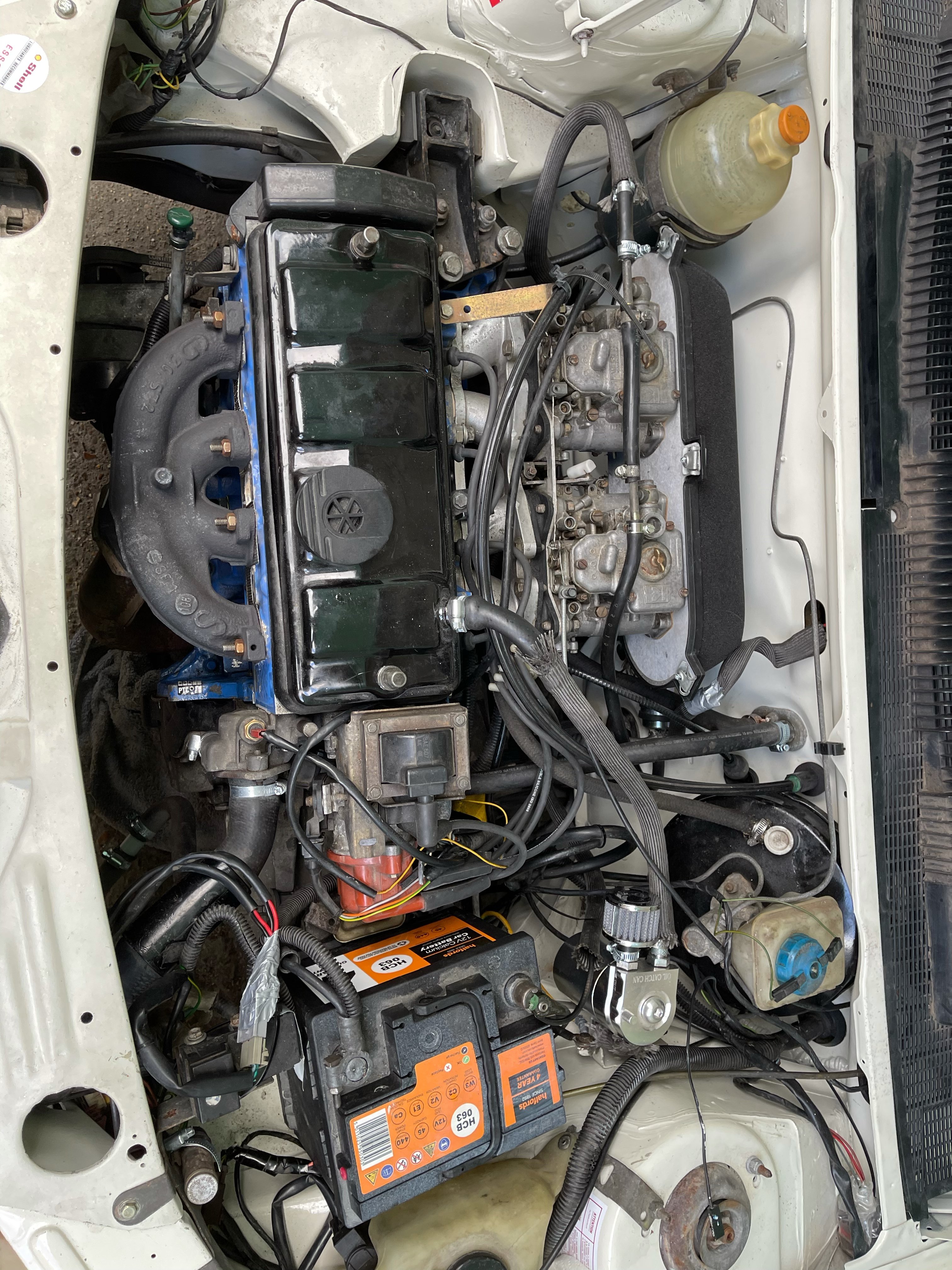

Hi everyone, I finally got my 205 up and running ! I’m needing the carbs sorting as it doesn’t like to idle, but it runs and sounds great. The engine was bought as a new build and is a tu3 of some description. I took the car up and down the lane to make sure it goes and stops ok, it goes well and sounds amazing..... unfortunately I have an oil leak from the front right hand side of the head. I have looked online and there’s some people say re-torque the head after a while ? Do I just re-torque or is this not the way to go ?

Leaking from the valve cover gasket or the head gasket ? can't really see on the pics ..
On the valve cover , better quality gasket usually does the job , or an thin layer of sealant applied on the rubber gasket especially on corners/edges .
If it leaks across head to block base , head gasket , yes by all means re-torque the head bolts ... the sooner the better while the engine is still "fresh" after the rebuild .
But loosen all the head bolts first (i like to drain the coolant , completely undo and remove each head bolt and re-grease the bolt threads prior to re-torquing)  , then re-torque back to OE specs and can even add a little bit more on the end stage say + 35/45deg. on each bolt to be sure .
I've done that on engines before with slightly coolant or oil leaking HG and it works .. haven't tried on high mileage engines though , where the leak was more of a long term neglected issue and the HG was old likely unable to re seal again as it went trough much more heat cycles and the HG coatings degraded loosen the ability to surface bond/seal up .

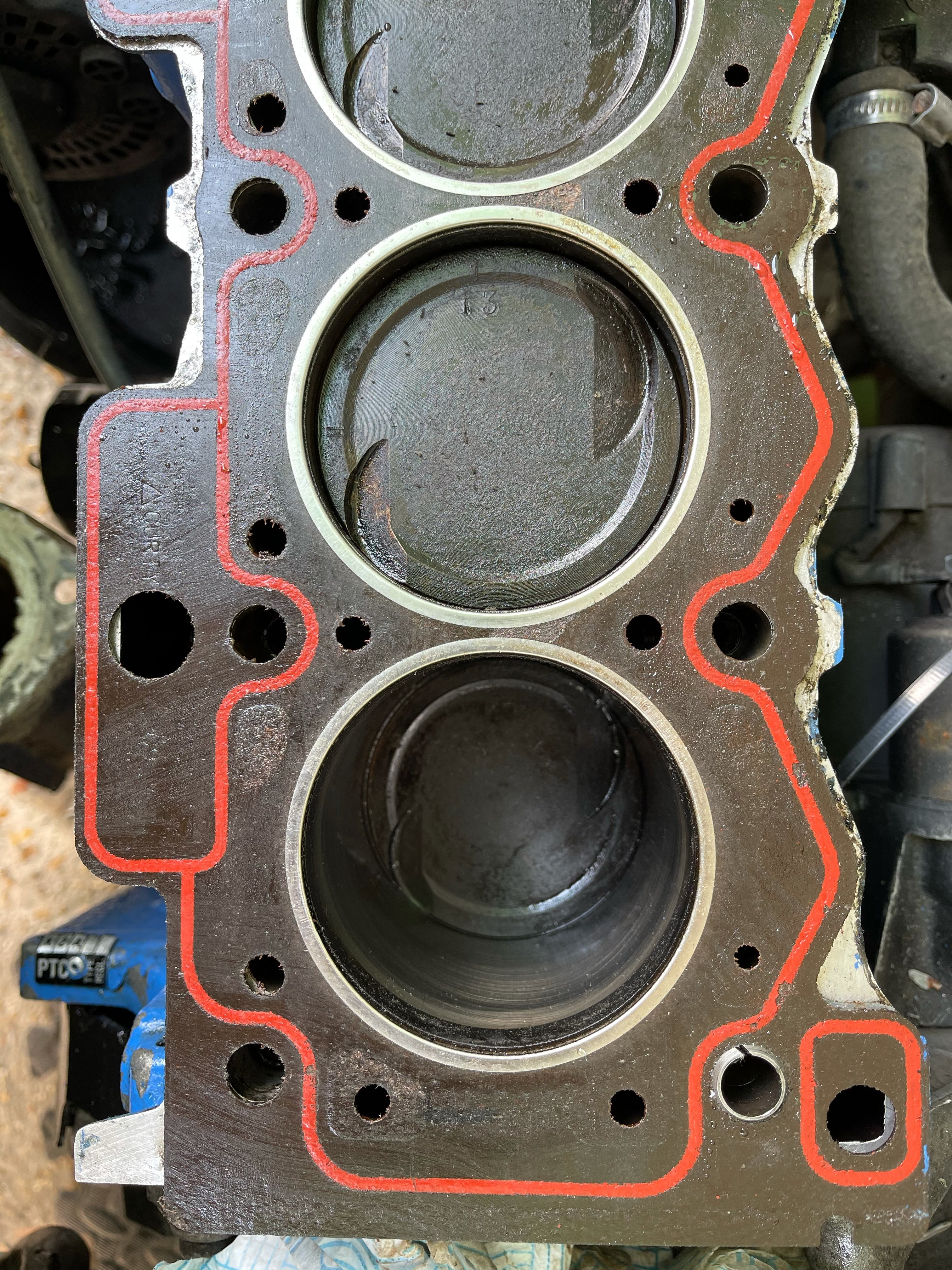

I’ve put a new gasket on now and a new set of bolts and it’s all good ! That old gasket was a mess and re- torquing made it worse !
