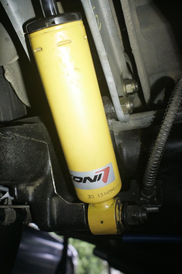

I inherited a set of Koni shocks on my 205, marked with :
KONI
made in holland
30  1314SPORT
as soon as I took the car for a proper drive I realised they don't give anything like the nice ride of the standard peugeot dampers

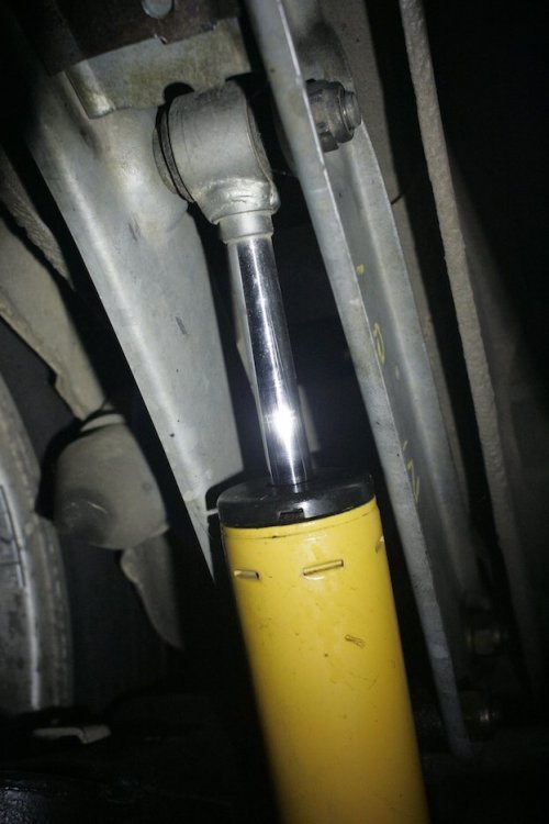

took em out and adjusted them to try and achieve the smoother ride
they have 3 settings, and are easy to adjust once off the car
prize/lift up black dust cover on main body of shock
hold in little button with left hand on damper, twist plunger/top with your 'other' left hand
counterclockwise for softer, clockwise for harder
it has 3 stops
first setting 20% softest
second setting 50%
third setting 100% hardest
I found the softest setting was still too hard, giving a bouncy/jerky ride, you feel every bump
and the hardest setting was ridiculous and should have a Warning: can cause kidney damage
I've since removed them altogether and put them on the shelf
and put on a set of original peugeot ones (Made in Yugoslavia, hi Damir !!) which are totally fantastic
they are from an Si which is the 1.6l petrol single point injection.
according to the part catalog there about 6 versions including the UpRated ones (what's that mean ?)
anyway, the markings on my OE ones are:
ap
MADE IN YUGOSLAVIA
TAO - 26 - 205
9751383980
203
N38A2
the Koni's are bright yellow and cost a lot of money
the originals are black and dusty, thirty years old this year - and ten times better
its possible the koni's are good for track, but I dont do any of that so dont know
