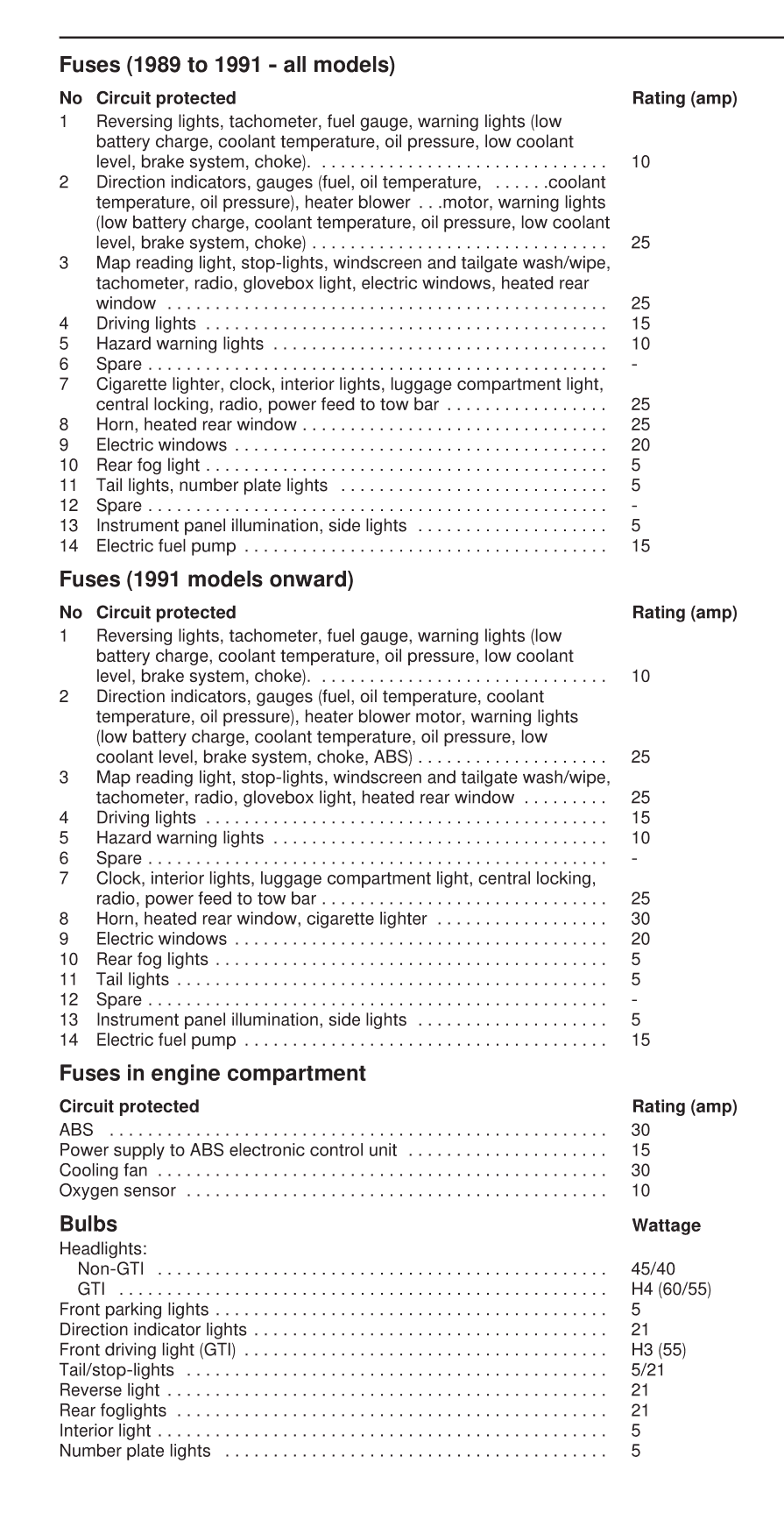

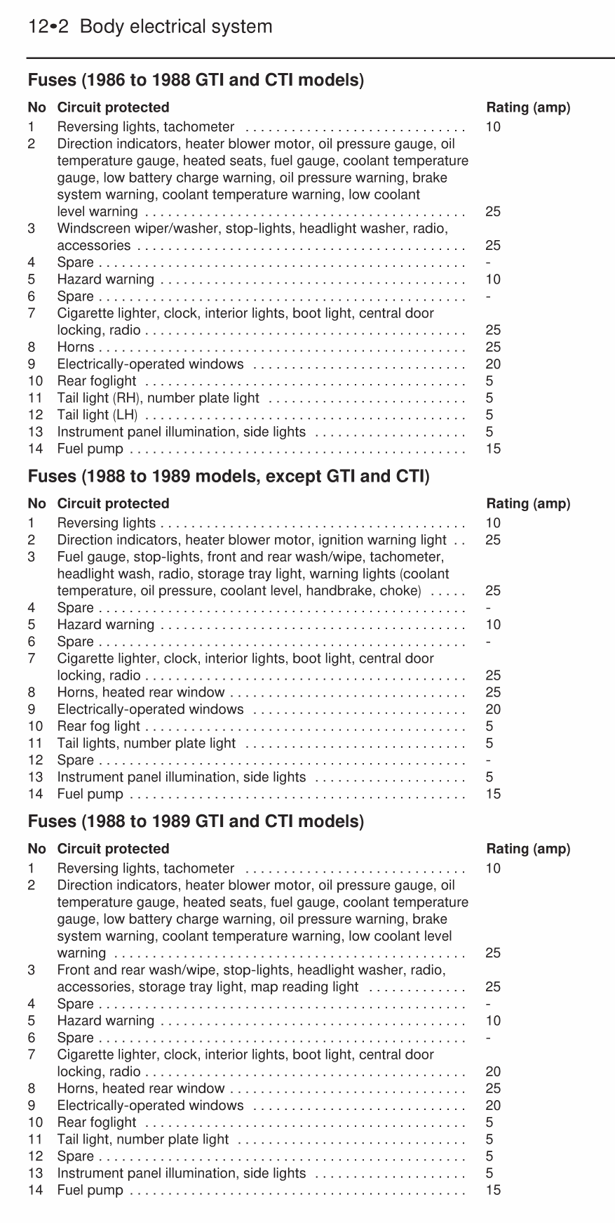

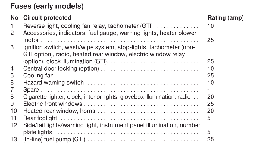

Here's the fuse listings from the Haynes manual. They vary a bit depending on the year, and might not be 100% correct, especially if someone has messed with the wiring in the past, so I've included them all rather than just the 1988-9 page.
Early (pre-1986) - Note: Only 13 fuses on early cars
Middle (1986-89)
