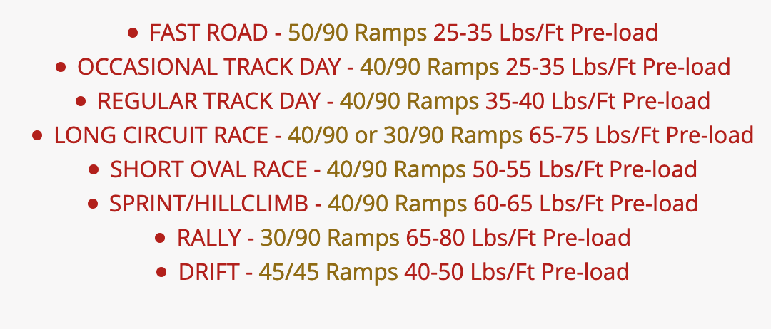

I've got a Tranx, similar to a 3J. It's wound up pretty tight for circuit racing and thus clunks and groans around the pits. Here are the suggested settings from the 3J website.

Hi Peter, many thanks for that, have seen those but appreciated, didn’t know if anyone had any further experience or whether above is pretty accurate, I suppose a lot with 205’s depends on driving style etc... I reckon regular track day would be a good starting point.... cheers
