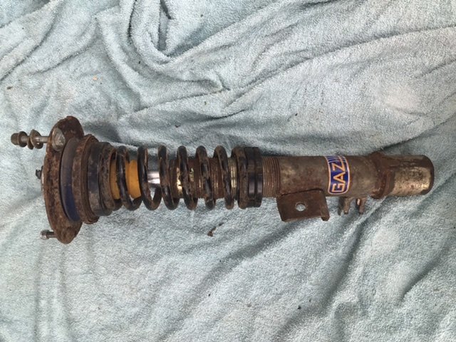

I have a ex stage 205 its currently set up for single venue tarmac rally, and as such is a bit low and way too stiff, I want to use it for night rallies and targa’s plus some HRCR historic regularity rallies. So, it’s not currently ideal for my needs.
The car has these GAZ coilovers on, I have sold these for £200 yesterday,
so I need a replacement.
I can’t make my mind up about just getting these,
with some 180lb 9” springs or getting the following setup-
