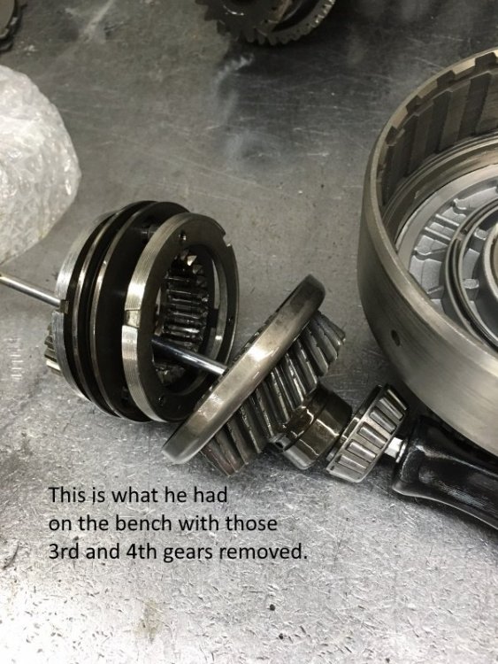

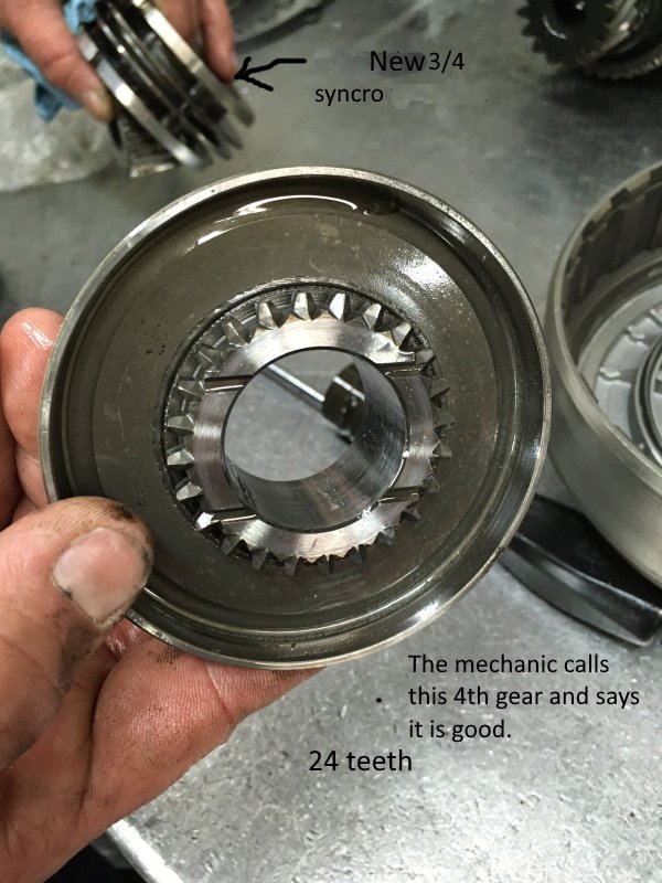

ob2s 3 Posted May 18, 2021 Hi, I think I am fooked. I found someone willing to try and he has it apart and says I need a new 3rd gear, but someone (in the know) said that 3rd and 4th are joined, so either my guy doesn't know what he is doing or I am doubly fooked ? I really have to get this right, because shipping is so high. Thanks Share this post Link to post Share on other sites
petert 607 Posted May 18, 2021 3rd and 4th are definitely a pair. Share this post Link to post Share on other sites
opticaltrigger 52 Posted May 18, 2021 Hi there, Do you have any photo's of the damaged parts.? That might help the guy's really pin it down for you. This link could be of help, maybe.. https://www.autogear.uk.com/peugeot/peugeot-205/peugeot-205-be1-be3-gearbox-3rd-4th-gear-hub.html All the best, O.T. Share this post Link to post Share on other sites
ob2s 3 Posted May 18, 2021 Here is what the guy said was wrong Share this post Link to post Share on other sites
welshpug 1,677 Posted May 19, 2021 looks like the left hand synchro friction ring there is worn, hard to tell from the images, the gears look fine Share this post Link to post Share on other sites
