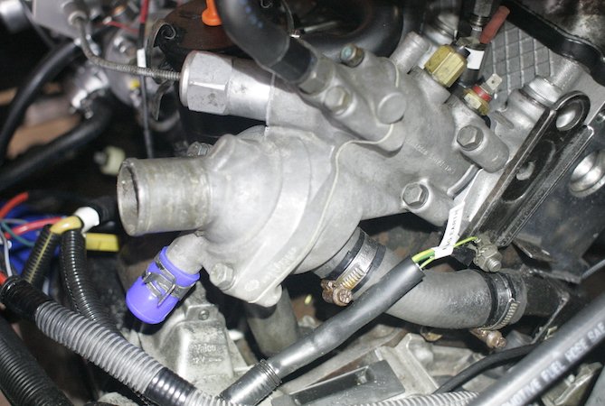

So I have removed both of the heat exchanges from the engine and would be interested to hear opinions on any possible downsides to doing so
The XUD7Turbo Diesel comes with two heat exchanges
One which attaches to the oil filter unit at the front of the block . This diverts coolant from the thermostat to heat the engine oil more quickly, and
The other one is built into the coolant flange attached to the bottom right rear of the block. This warms the diesel coming from the tank before sending it back out to the filter and diesel pump
Both seem to be entirely optional as neither the non-turbo D or the XUD9TD had them

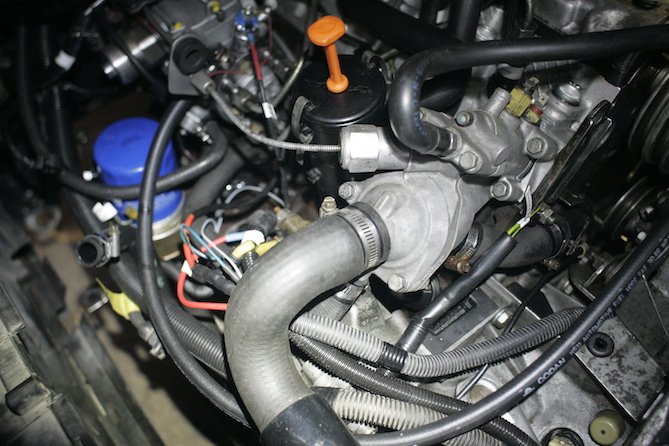

As you can see from the first pic, its a whole lot simpler without the two extra coolant hoses, the heat exchanger and the mount to jam in the space under the alternator. Just one filter and a stubby little spindle into the block is the alternative I've gone with
I wasn't able to properly show the hose tangle caused by the rear heat exchanger but you can see its gunna be easier by comparing it to the simpler flange. Two less hoses in a tight spot
At present I'm still troubleshooting everything, leaks, temp sensors, electrics and listening for funny/not so funny noises so there's no test runs yet to even report
But I do reckon the diesel has been flowing thru to the pump more freely without the rear diversion to the heat exchanger
To remove the front one, you'll need to get the regular top hose shown in pic4, blank off the lower front thermostat pipe as shown in pic6, and scrounge yourself a normal short little oil filter spindle from any XU petrol or diesel engine
To remove the rear one, you'll need to get yourself the regular coolant flange first or just use the same one shown in pic2 and disconnect the extra diesel lines from it . I also found that the pipe outlets on pic3 flange are smaller so if connecting it up the smaller D coolant hoses might need to be obtained/fitted also.
