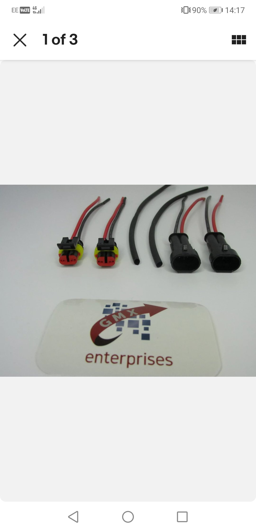

I need to replace the plugs for my driving lights as they have a poor connection, ive seen these that i could replace a section of the loom with and in the advert its says suitable upto 14amps and the wiring is 1.5mm could anyone tell me if these will be a suitable replacement thanks

In terms of current rating, they should be fine - a 55W driving lamp bulb will pull around 4.5A
The problem that I can see that you're likely to face however is that those look to have quite a short length of wire on them, and in my experience, you're likely to find that the 205 wiring will have corroded blackened wire for several inches minimum (and quite possibly a lot more) that you'll need to chop back to find clean wire to make a decent connection.

Thanks for your reply good to know about the amps. In the advert it says its 10cm of wire so i may be lucky if not its not an issue to be honest
I used much the same style of plug on mine (typically called superseal)   however I bought a crimping tool and the parts all unassembled.

Fitted the replacement plugs and loom was lucky and didnt have to cut too much of the original loom back pretty happy with out come
