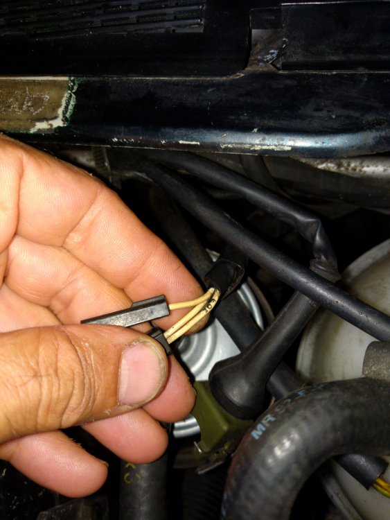

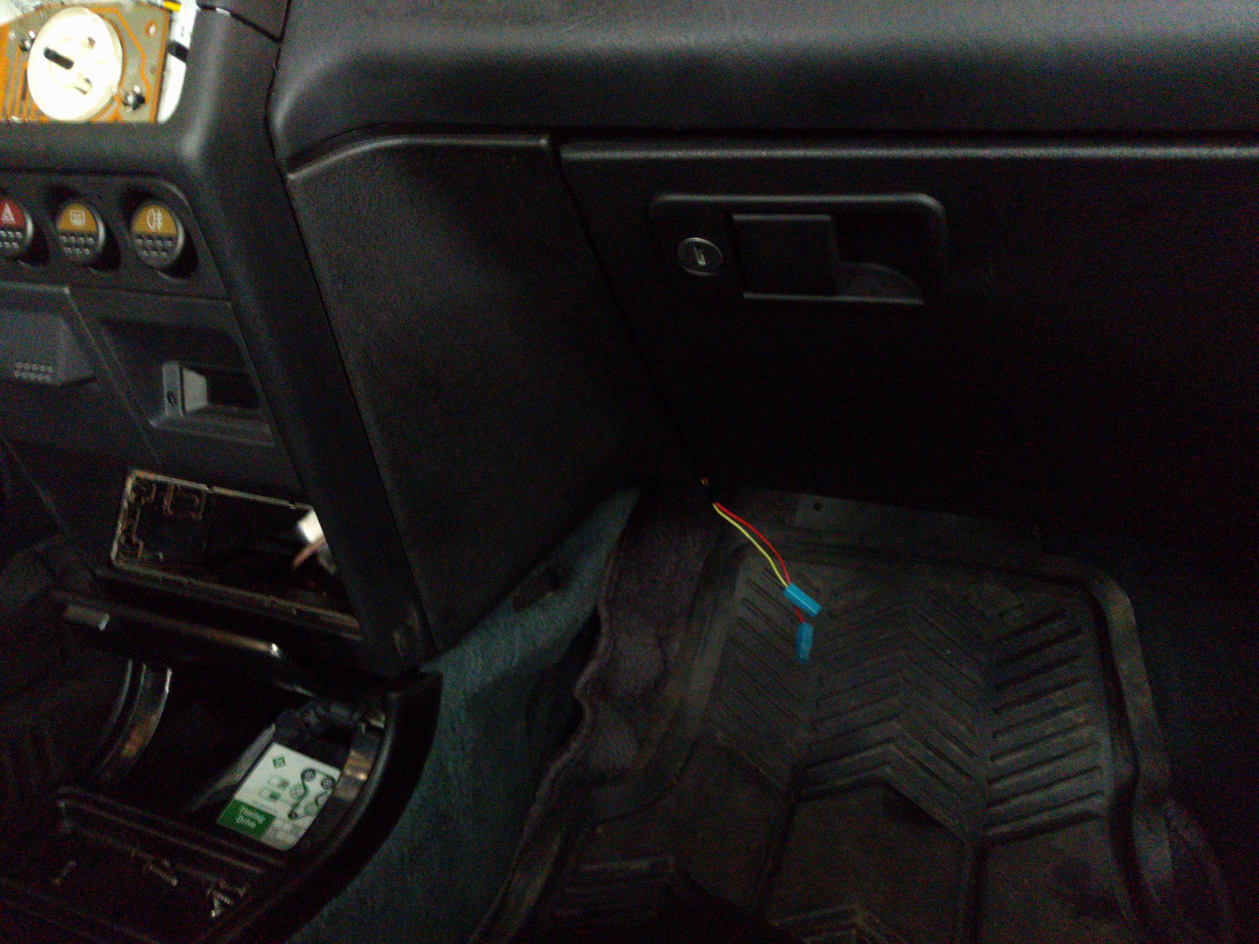

Not sure if this is the correct place to ask, so please check out the two photos and give me a shout if you know where these connectors go to.
On one of the photos the two wires hanging under the glovebox are yellow with marking with M108 and a red one. They come off the top of the glovebox wires and two of the same colors go to the direction of the cental console.
The other three wires are in the engine compartment, as you can see the pair I have placed above the fuel pump and the other single wire above the coolant bottle.

Thijs_Rallye
The two wires that came from the top of your glove box are for the glove box light. As for the other wires I don't have a direct answer, but you could take a look at the haynes schematics to cross reference the wire numbers you have.

stewal
I think the single wire under the bonnet is the earth connector that fits to to male spade connector at the top of the suspension strut to operate the pad wear light. There should be another on the other side too.
the twin wires look like the brake fluid level warning light connectors for the brake reservoir but presumably yours is left hand drive?
Dimi
Thank you Stewal, yes LHD  here. I will continue investigating, as my brake fluid reservoir has the connectors to it. In one of the two spade connectors there are two wires and some numbers . See photo.
