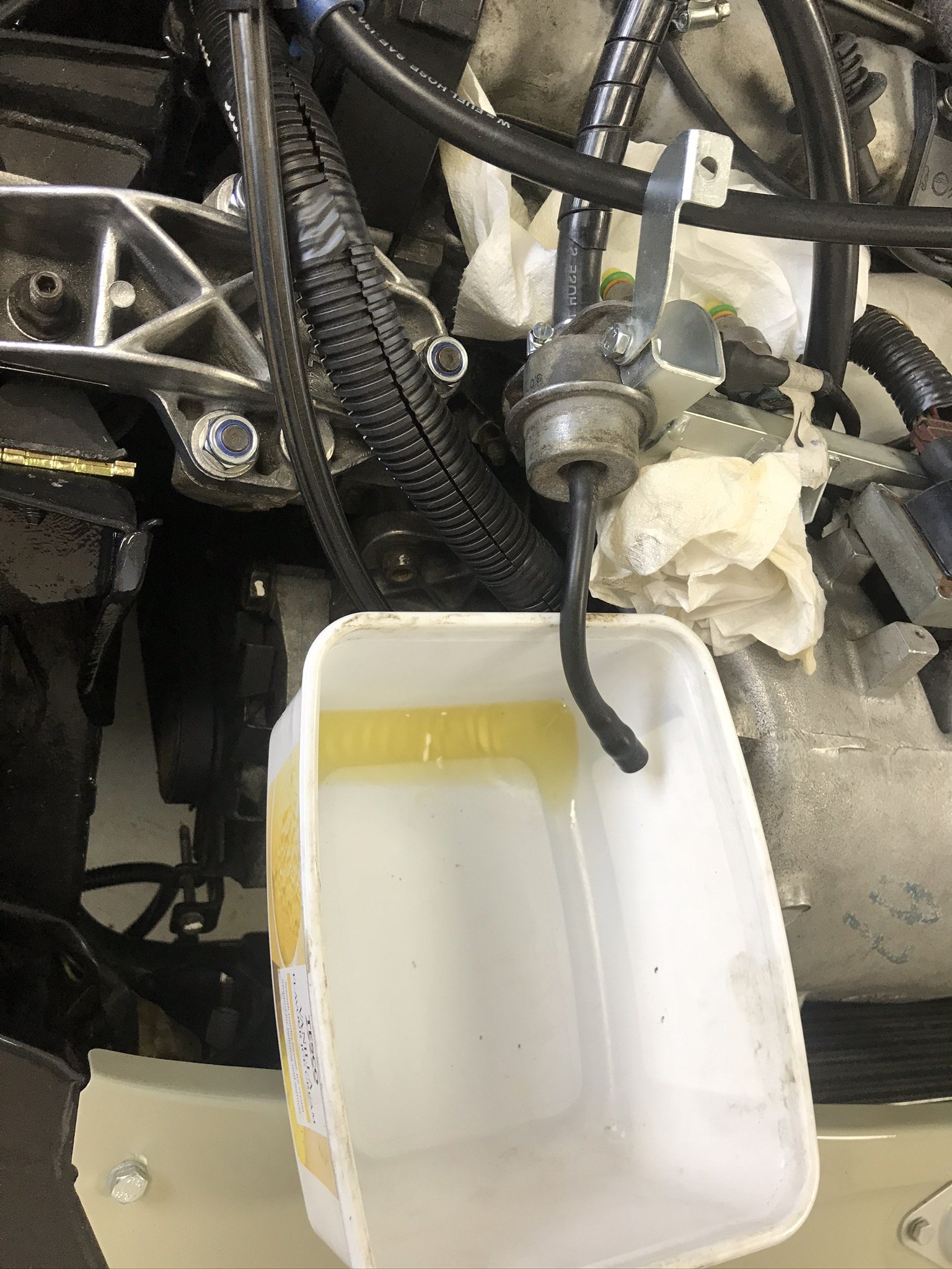

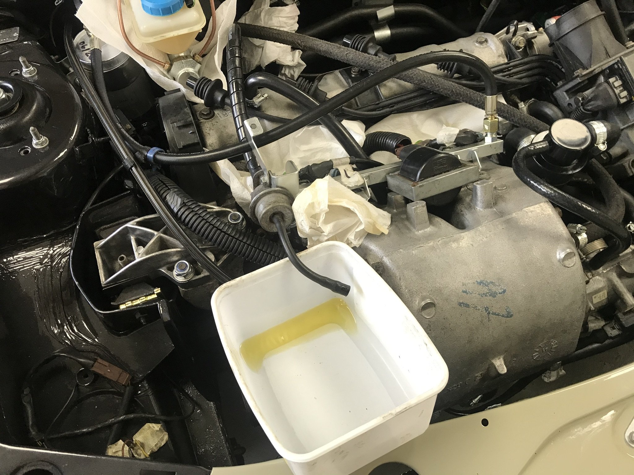

Thanks to everyone for their input into my fuelling problem, I have now resolved the issue and can report back  on the cause of the problem. Out of interest, when I spoke to a mechanic who had been working on Peugeots for the last 40 years, he said that he had never seen this issue that I experienced.
Anyway, back to the issue.
It turns out that my fuel pressure regulator has a perforated diaphragm, what was happening is that fuel was leaking from the fuel pressure regulator, down the vacuum pipe and into the inlet manifold.
This was then finding its way into the first cylinder and was causing all the running issues that I was experiencing.
Its worth people knowing that this could happen, even if is only one in 10 thousand :angry:.
