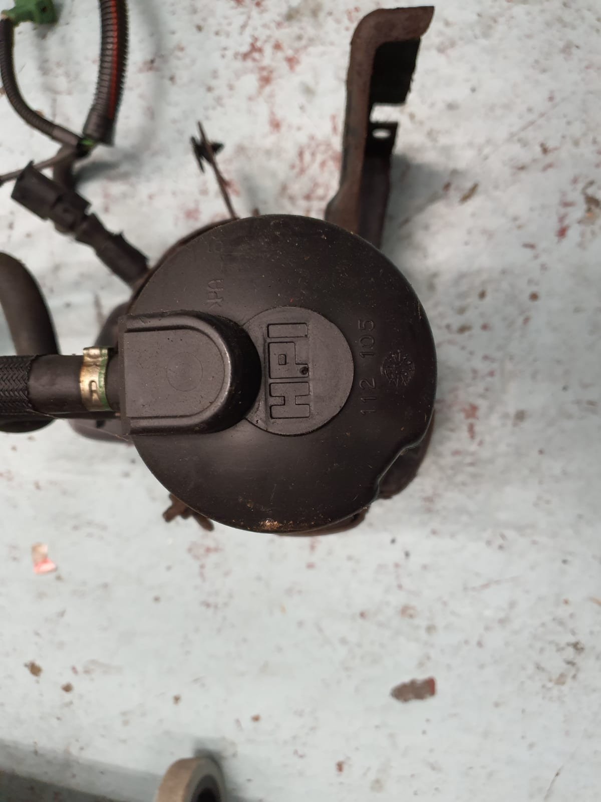

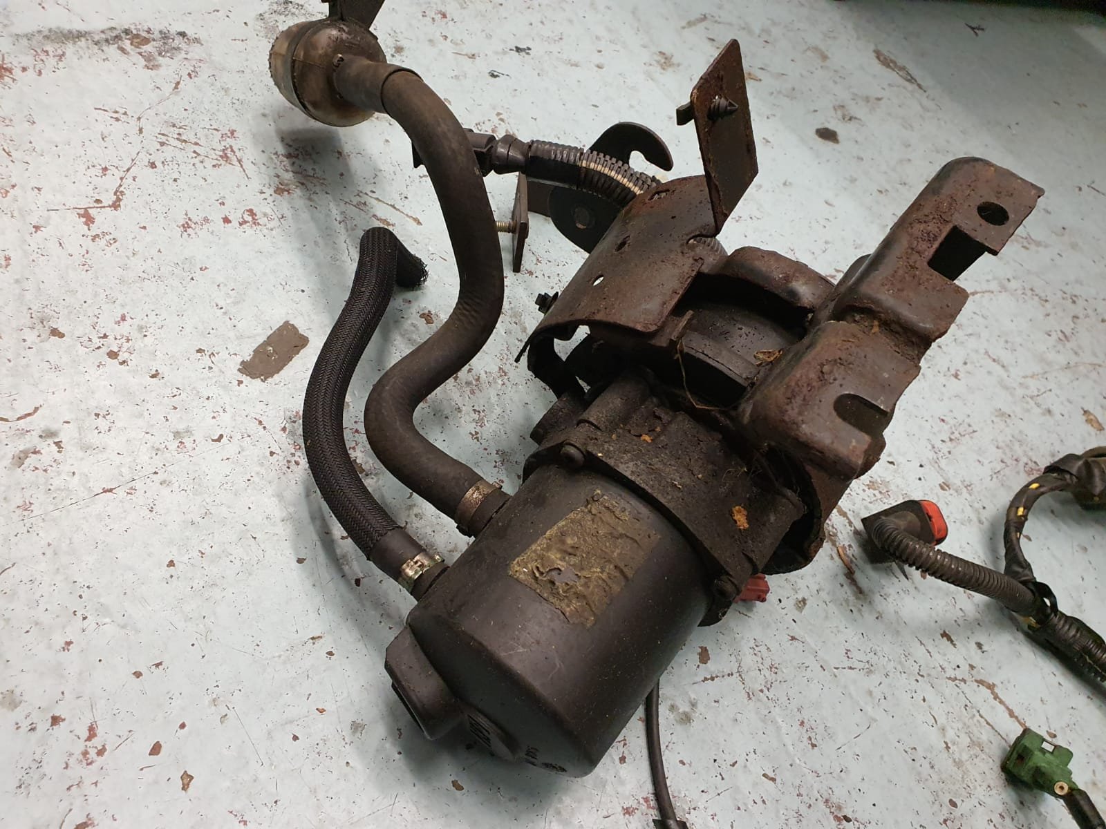

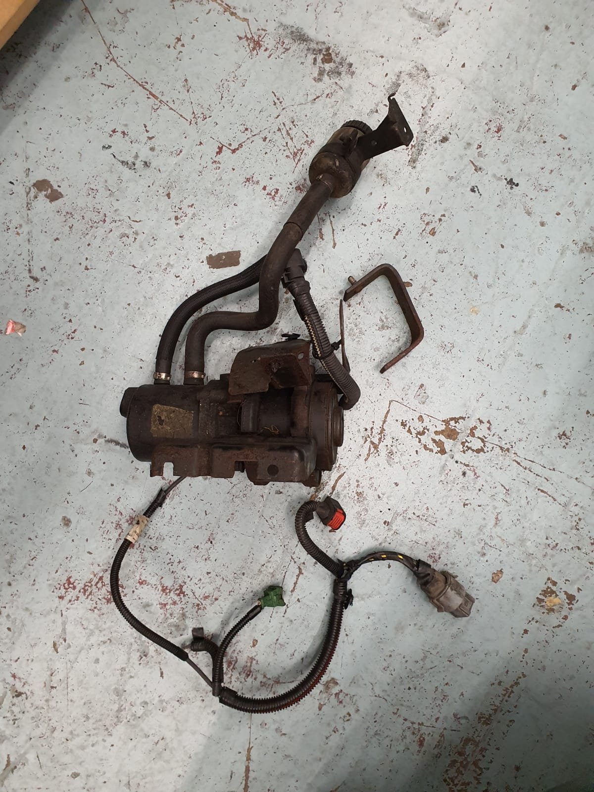

Hey all, I got a power steering set up in a box with my car as the previous owner was going to fit it - its a track car and he suggested it was a good upgrade.
Here are some photos, I am not even sure what car it is from or how it fits. Two queries I hope you can help with:
1. Is it worth fitting - will it make my 1.9 GTI 'better' on track
2. If not then how much is it worth, cannot see any for sale on here or eBay, or just general searching
Thanks all!d287f05d-ad3f-4598-b178-c45642f39455.thumb.jpg.85029a2490b615a85f2ab4948eb06d46.jpg4d6ff10e-be50-41bb-95ca-da5dfb257d30.thumb.jpg.04e7fca29e2e72471d41292312d50fc0.jpg497512032_WhatsAppImage2020-07-06at16_28_47.thumb.jpeg.4dd37403bc93dafbb73ac2e6aa48c3b6.jpeg
That's a 106 GTI / Saxo VTS electrical PAS pump.
You'll need a custom high pressure hose to fit it to a 205. And you'll need a PAS rack with ram if you don't have those fitted already.

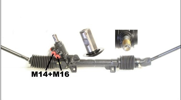

joris_andriesse
Hi all,
I found a new xsara vts ph1 pas steeringrack, but to me it seems that the pinion doesn't have splines.
So I recon that isn't going to work as-is, how/can should this be solved?
SweetBadger
A new one wow, where did you find that! Erm sell it to me :D
You need the 205 Gti non-pas square drive lower universal joint. This will fit, however it's about 10mm too long so if you use it unmodified it pushes the steering wheel towards the driver and you'll lose the self cancelling indicators.
To solve this I simply extended the flat sections that go into the upper column UJ by about 10mm (by using grinder / file), then chopped off about 10mm from the top. Job done.
