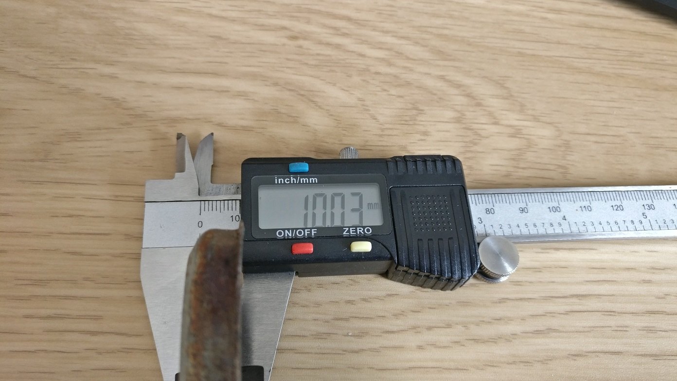

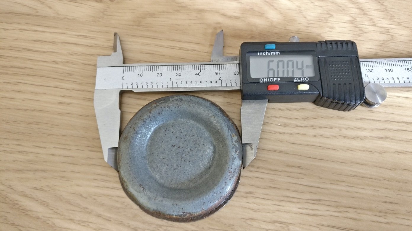

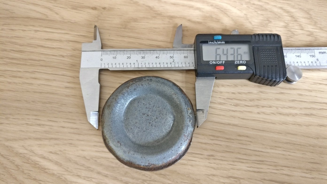

The dust/grease cap on the rear hubs have seen better days, but there seems to be different profiles and sizes - My current ones are pictured below, they don't appear to match the dimensions of those being recommended as suitable for my '89 1.9. - some for 106's are closer in size and profile.
The calipers are definitely standard 205 but could the hubs have been changed, for expmple to 106 meaning a different cap?
The gauge is a cheapy, the measurements won't be 100% accurate, but close.

only 2 types that I know of without looking at parts diagrams, disc and drum brake.

Cheers... yep, seems to be the two types you mention, both different dimensions / profiles, though quite a few sellers don't seem to realise that.
Ended up getting them via Spoox, should be the correct ones.

Still available from main dealer 3740.18 and 3740.45 are disc axle caps. 3740.19 for drum axles
