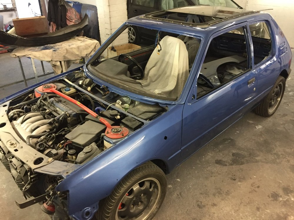

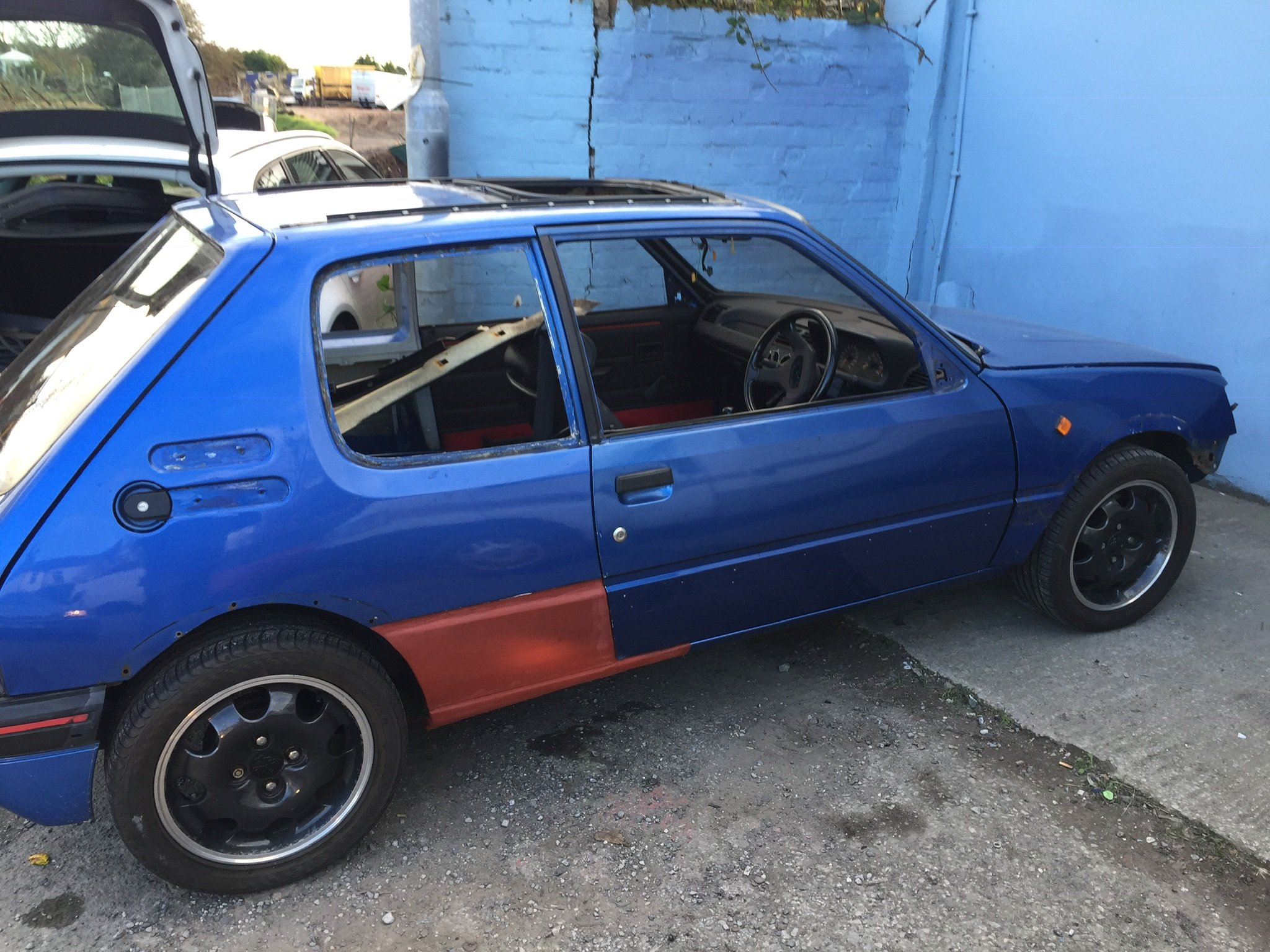

stripped mine for respray 2 years ago
miamigtimark
You can see I left the sunroof in but removed the glass.
left rear bumper on and rear screen in but removed rubber surround/ seal
