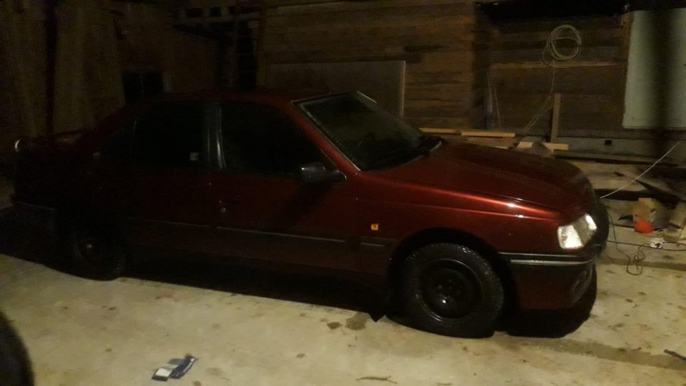

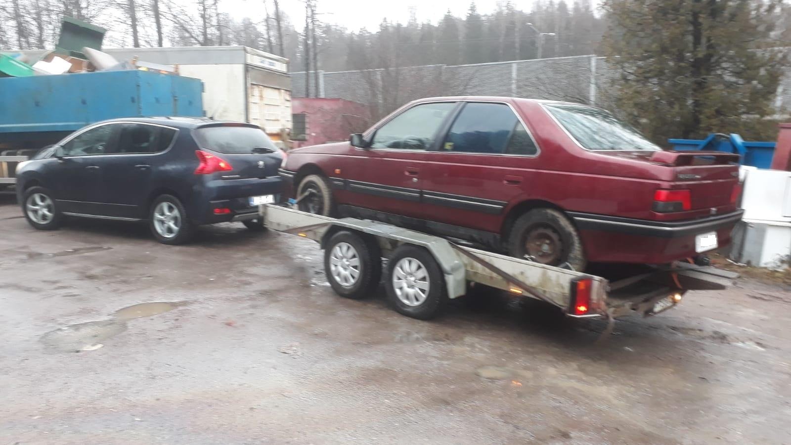

Failed inspection due to brakes in 2015 and had been standing still since then (bought by me in February 2020)

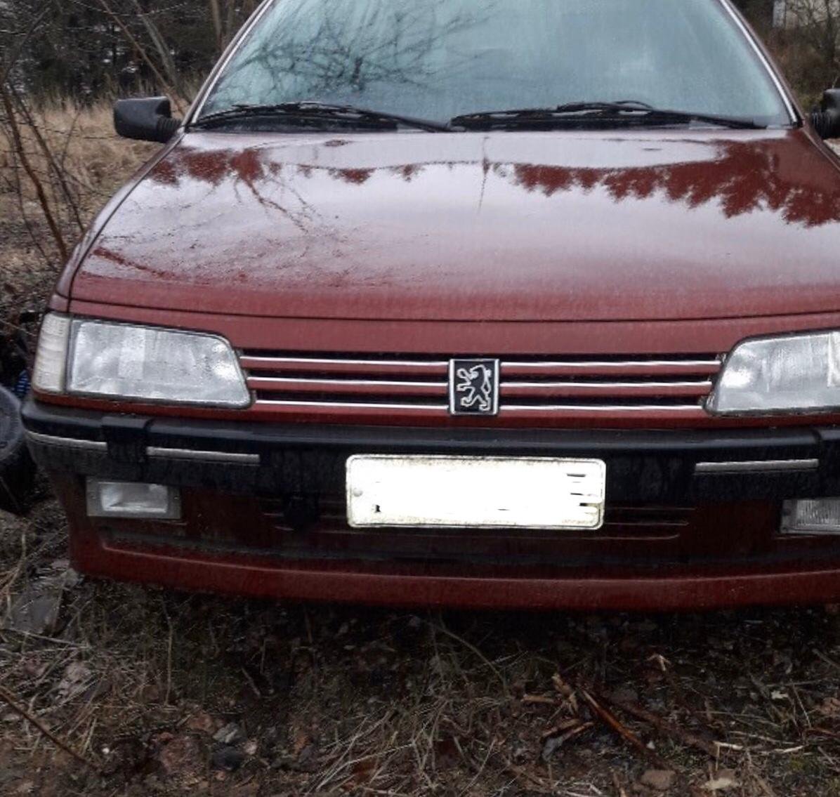

I saw the car by chance on the biggest second hand car website in the country and instantly knew I needed it. It was advertised for 350€ and in non drivable condition. At the time of the purchase I lived about 5 hours from my hometown due to studies
I instantly called the seller and discussed coming to see it, this was a Thurday. Said and done I informed my dad about the car the same day. Friday I went to see it and spoke to the seller, it was a very rainy day so no thorough inspection was done. I quickly tapped the lower sides of the car to listen for rust, turned the steering wheel to listen for gaps in the steering rack, and checked the angle of the rearweels for rear axle damage/wear.
748456354_WhatsAppImage2020-05-09at20_09.55(1).thumb.jpeg.15423cc0f0972d70eab641145a3d2465.jpeg637346305_WhatsAppImage2020-05-09at20_09.57(1).thumb.jpeg.5657cc051cdf81f09b49884aacc1bcce.jpeg
The exterior of the car was in overall good condition, the hose from the radiator was off, meaning the engine had no fluid in it and the exhause was broken off by the last muffler.
The interior was covered in white mouldy patches. The car overall smelled bad, there was green moss growing in nooks and crannies e.g. on the chrome trim strip on the bumper and side mirrors. The roof liner was hanging down and there was a hole in it from where (I assume) a mouse had chewed its way through it.
The price of the car was negotiated down from 350€ to 220€ on the condition that I'd have it removed from the area before the weekend was over. My dad gladly jumped in his car and came to pick it up on the Saturday. The car was loaded and ready to go around 3 pm (left) and arrived safely at home around 10pm (right)

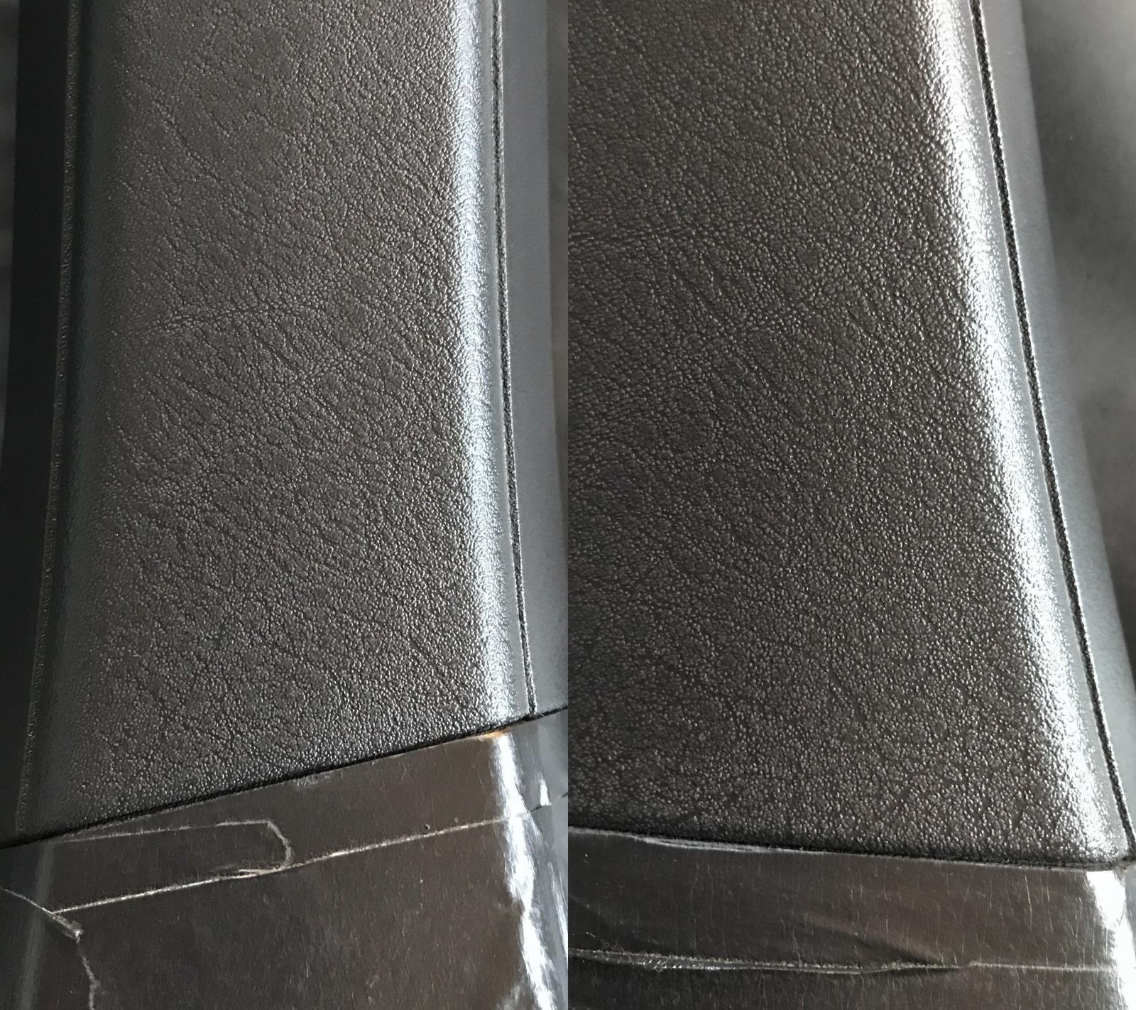

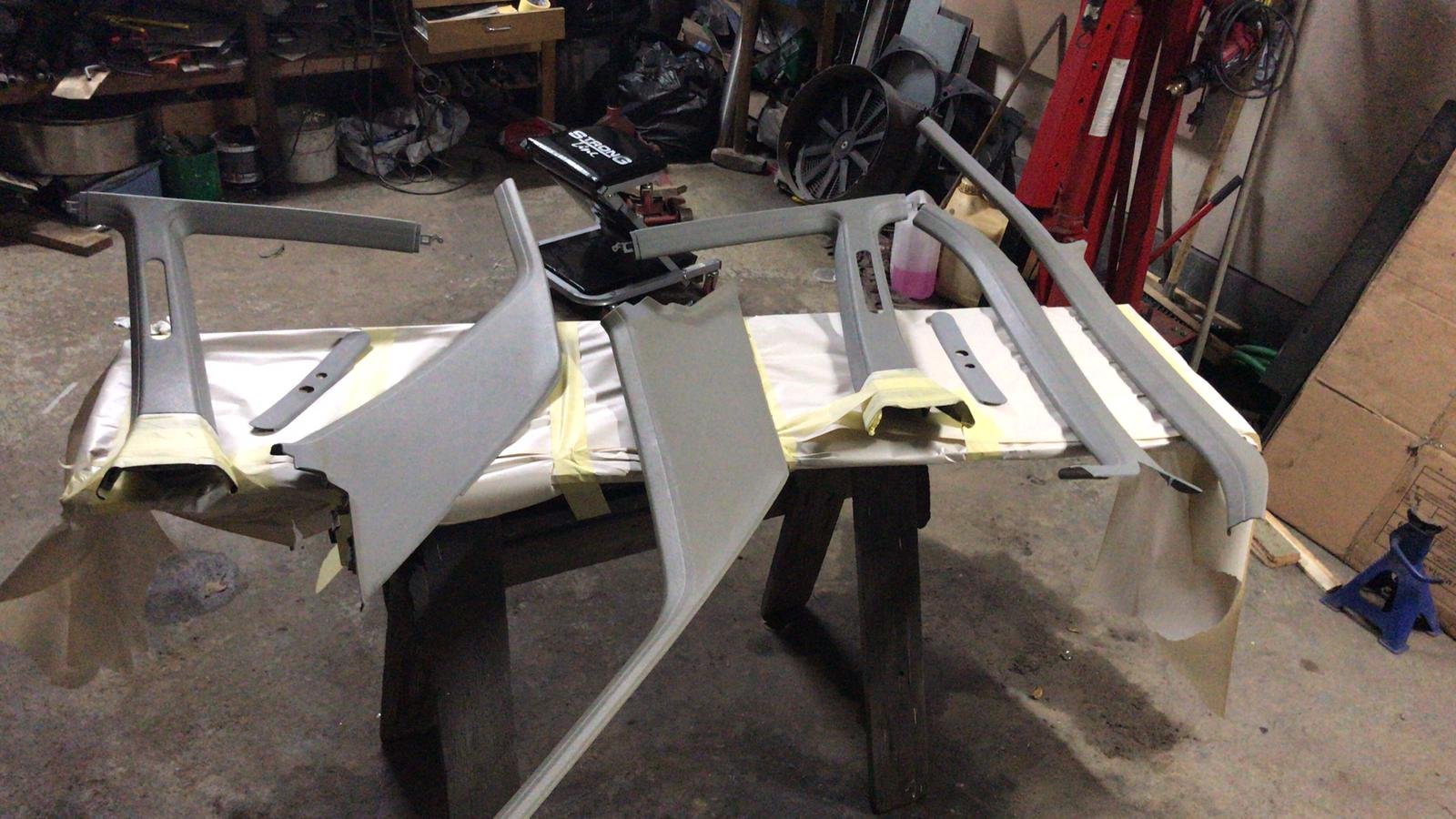

The A, B and C pillars as well as the plastic trim were all removed and sprayed with vinegar to kill whatever was growing on them followed by isopropanol to kill off the vinegar smell. The dashboard received the same treatment plus some soapy water to get rid of other gunk. Note to everyone, the gearshift knob apparently disintegrates from soap.  Luckily I have a semiwrecked 405 with an XU7 engine in it so I took the gearknob from it. The interior roof that had the mouse hole in it was taken out and as this car had received a sunroof conversion at some point in its life the roof liner was actually modified and a fabric had been tensioned over the "gap" where the mechanism for the sunroof is housed as well as the sunroof itself when it is open. This fabric was dirty, smelled bad, had mouse poop on it as well as the hole.

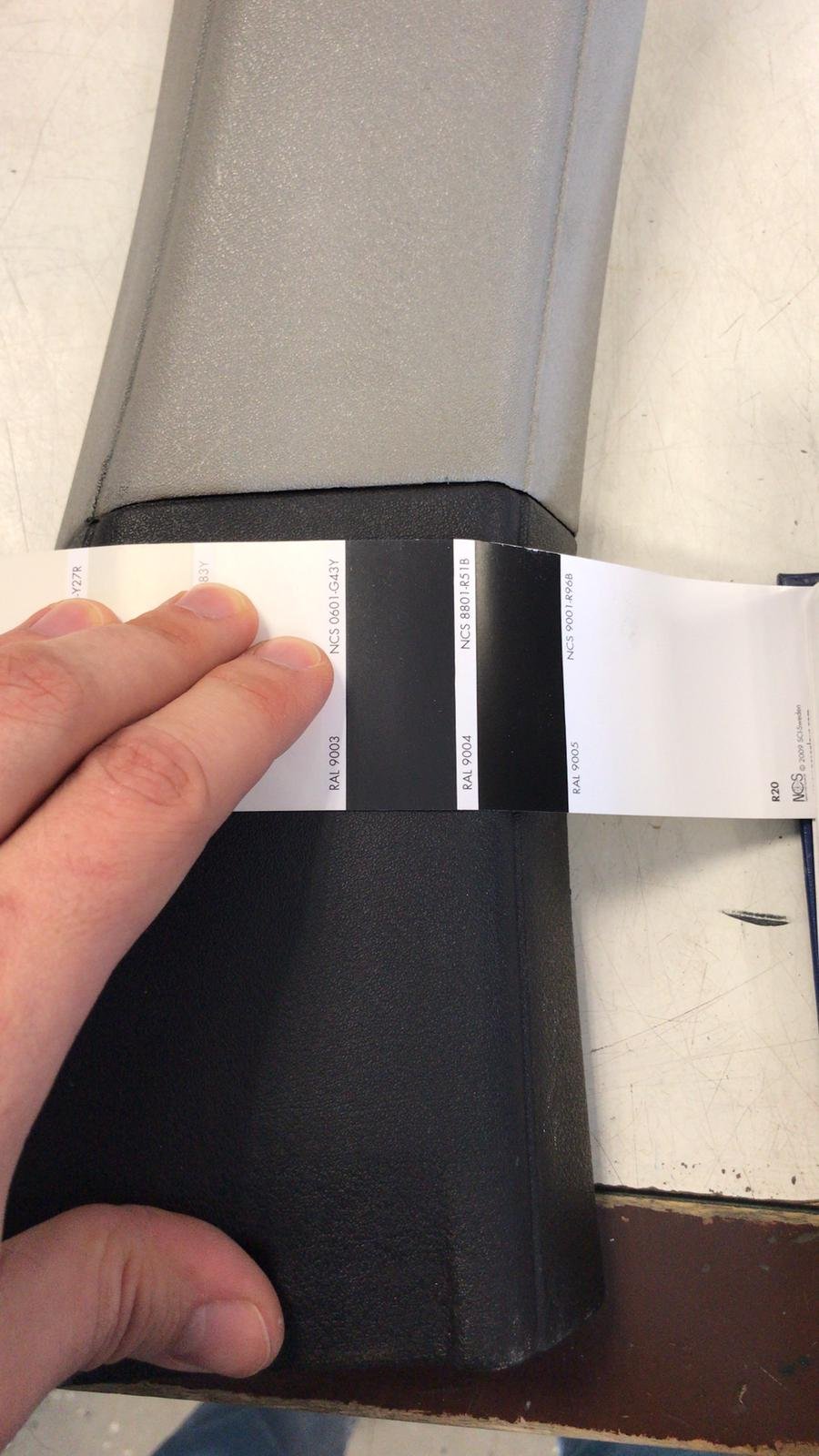

I then got the idea to paint the A,B and C pillars a darker color as the rest of the interior (door panels, seat, lower door trims, etc) were all black/dark gray so I went to the local paintshop and the owner helped me look through the RAL color table to find a suitable color that matched the rest of the interior. The color RAL 9003 is pretty much as close as you get to the original dark plastic trim color. I bought about 4dl of the color in semi gloss. I had to fill in some of the edges with a spray can of matte black but luckily there is a plastic weld line on most parts that I used as "edge" so the difference in shade of black/dark gray is not noticable. The original color also shines through a bit in one place on both B pillars but that area is hidden by the seatbelt so it's not worth correcting in my opinion.
910050517_WhatsAppImage2020-05-09at20_03_22.thumb.jpeg.798499a1afbec00b4f4390c61baed813.jpeg1266381701_WhatsAppImage2020-05-09at20_10.02(1).thumb.jpeg.a1b181385df7f2da1003c14f3942fe14.jpeg672549673_WhatsAppImage2020-05-09at20_10_01.thumb.jpeg.e7bea65c417e01a73d8a8e79ec7eaeb8.jpeg

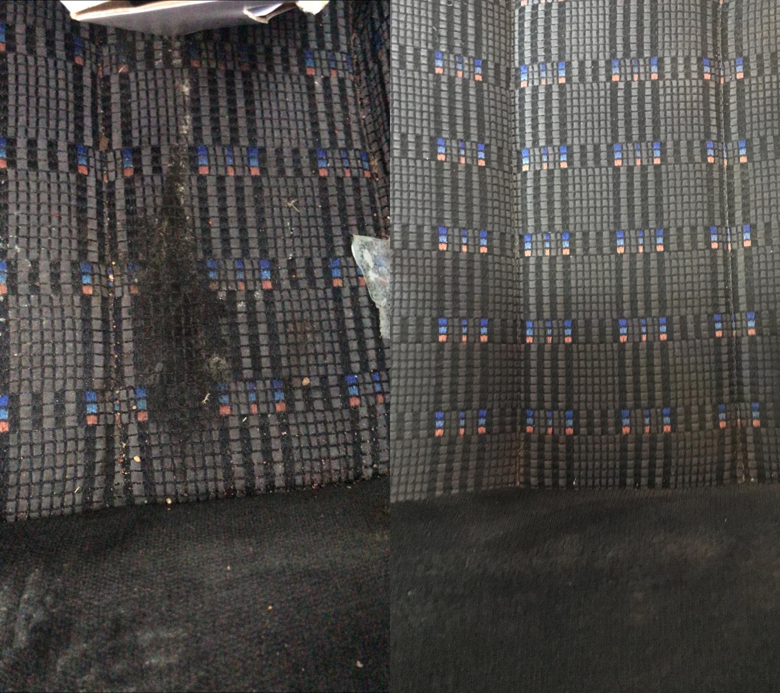

While the paint was drying the floor mat was washed with the pressure washer and dried again in the sun. Lots of sand and what not came out of the carpet.
 757640285_WhatsAppImage2020-05-09at20_03.23(1).thumb.jpeg.7423a7f8c53758bde54fc6f39b26cec6.jpeg1178643314_WhatsAppImage2020-05-09at20_03.24(1).thumb.jpeg.0a7c3aff0c2ddb9495a16cd362797127.jpeg

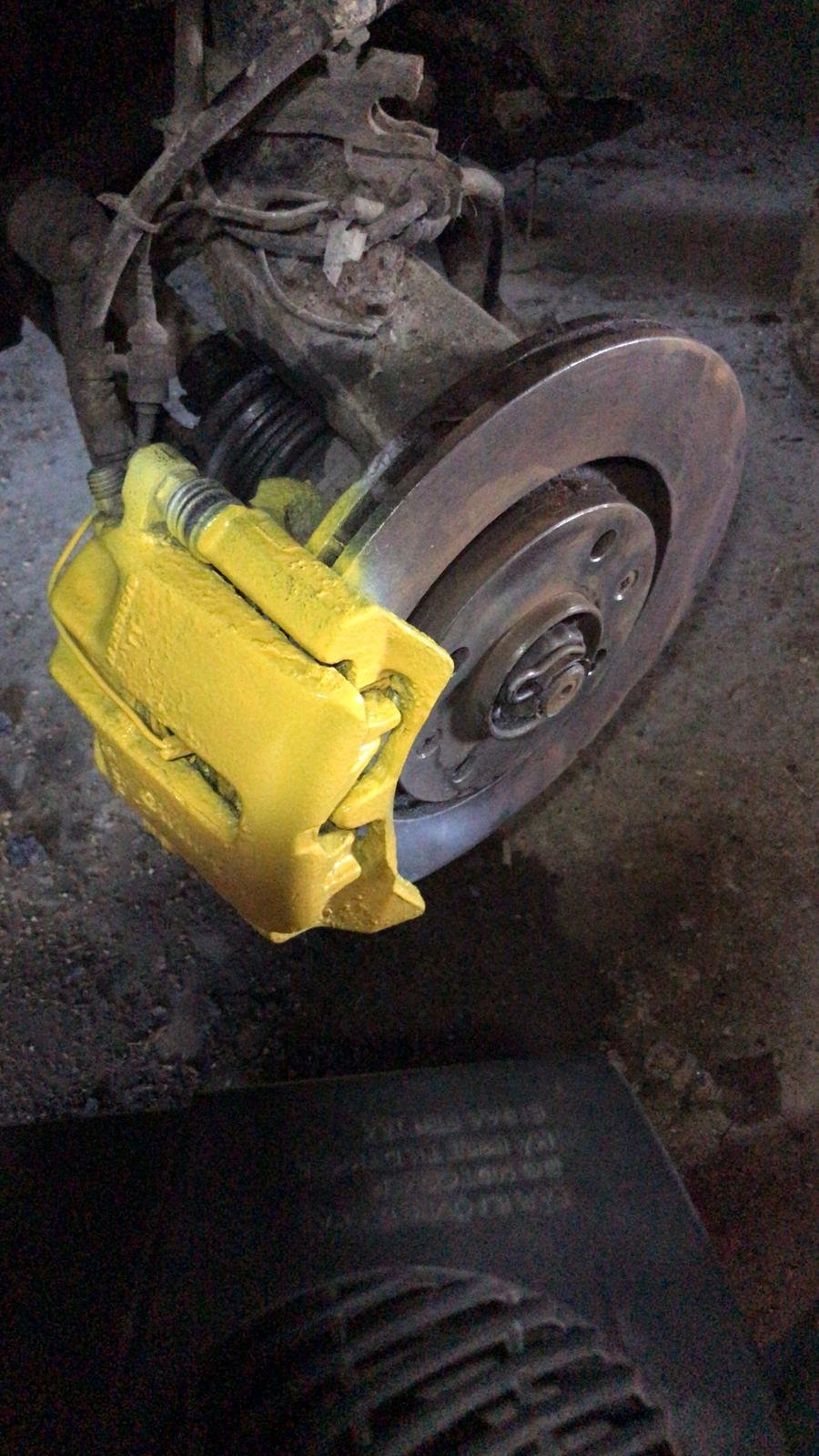

When the lower plastic trims and seats were back in the car I started working on the things I could in the dark barn where my Peugeot was standing since the main garage was occupied by my brother's Volvo 740 which he had put a T6 engine in. That means the brakes were taken off, inspected and reassembled. I later too decided to put on new disks and pads since there was quite a bad layer of rust on the disks all around.

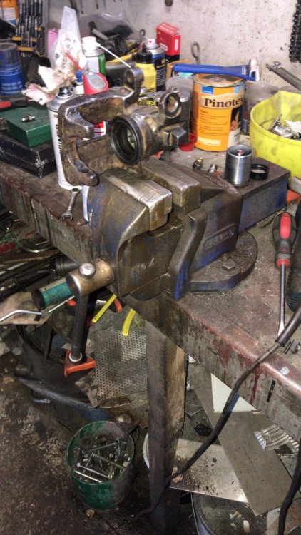

Remember to paint your brake callipers a different color to increase your car's HP with 10. ;)
 1732460454_WhatsAppImage2020-05-09at20_03.29(1).thumb.jpeg.086d2fc23d545629cde18bee4b37bb71.jpeg

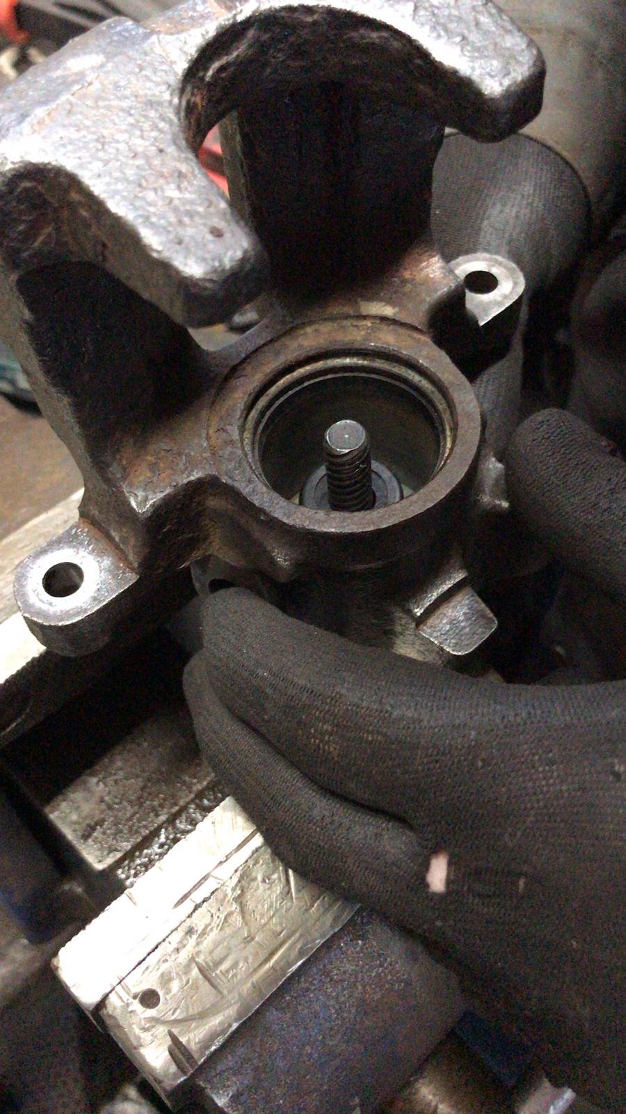

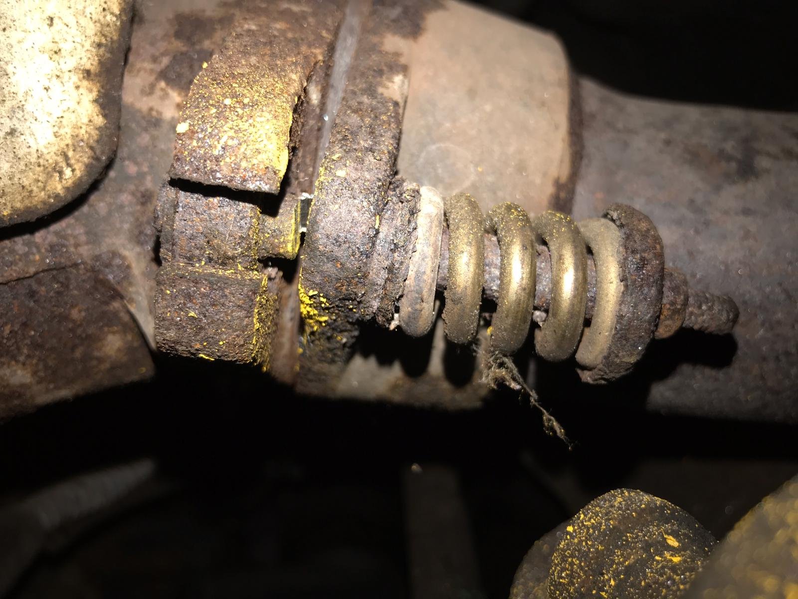

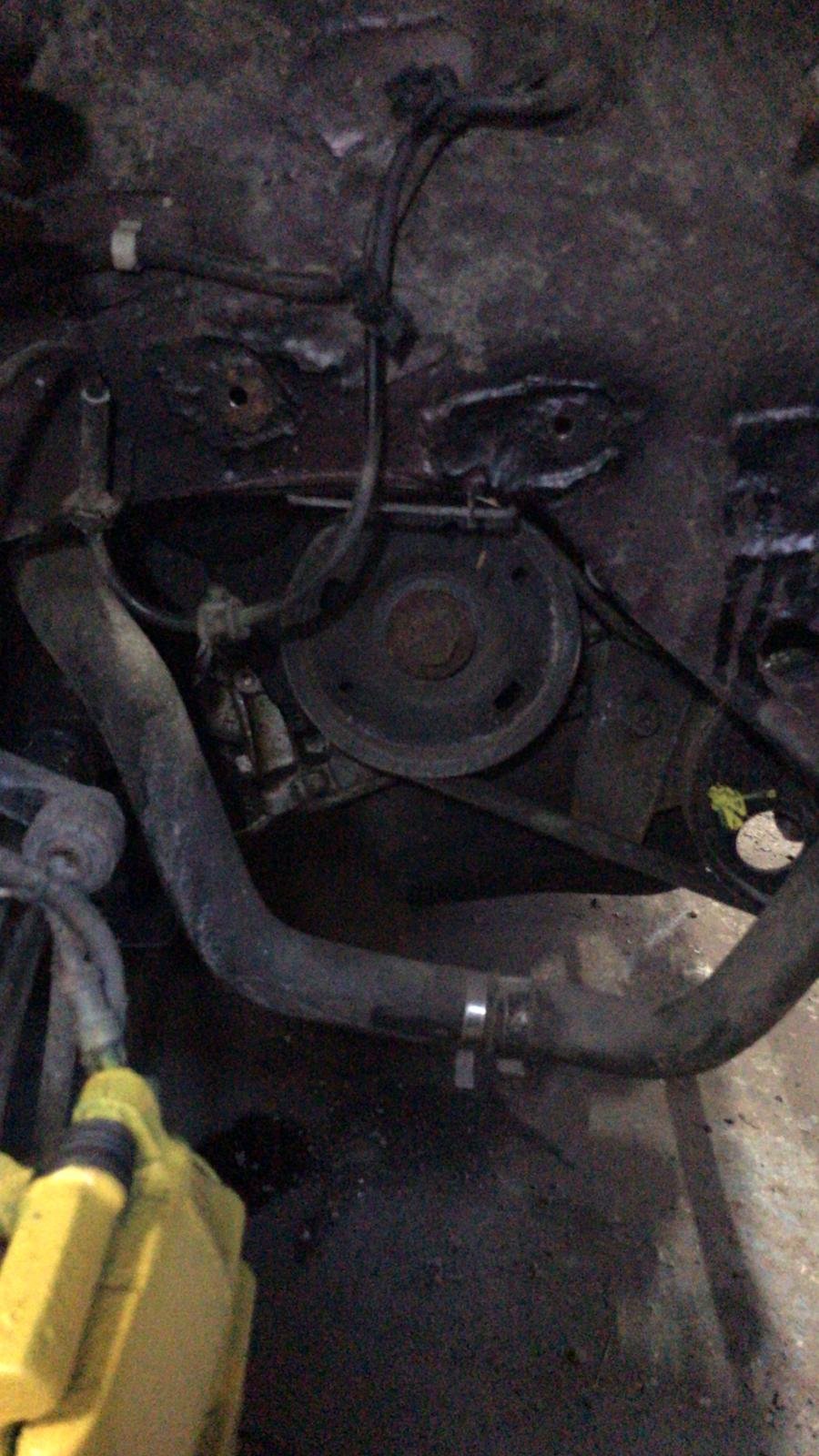

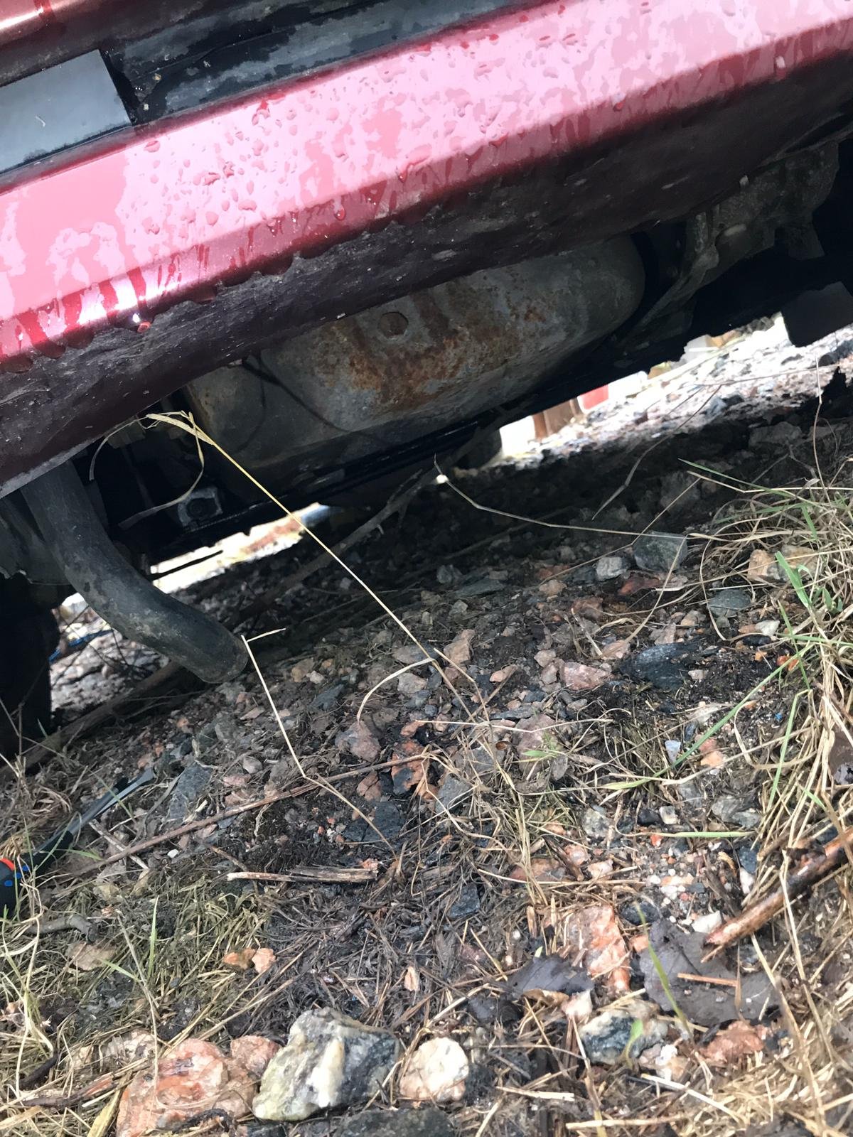

The calliper on the passanger rear wheel was completely stuck and the break lines' hexagonal nut was almost stripped so I took a file and ground down two of the sides to fit a smaller key. I don't remember the exact size now but let's say original size was 13mm and the key didn't properly grab on to it but the 12 key was too small I took the file and ground down on two sides until the 12 key fit on to it.
As for the calliper being stuck, the plastic gasket/seal by the lever of the hand brake was broken so water had gotten in and it had rusted. We disassembled the calliper completely and gently polished the parts with what we call "bears tongue" which almost like steel wool but made from a synthetic material. It's basically sandpaper but in a random mesh and thick like a foam. It's hard to describe. It feels like, well I assume, a bears tongue. I guess kind of like a cat's tongue but not as rough?
1614959607_WhatsAppImage2020-05-09at20_10_02.thumb.jpeg.be6d91f36f304c5a73b479872ae2989f.jpeg1785897309_WhatsAppImage2020-05-09at20_10.01(1).thumb.jpeg.d18ef5b1e4a8d84953f59542db6c5c20.jpeg

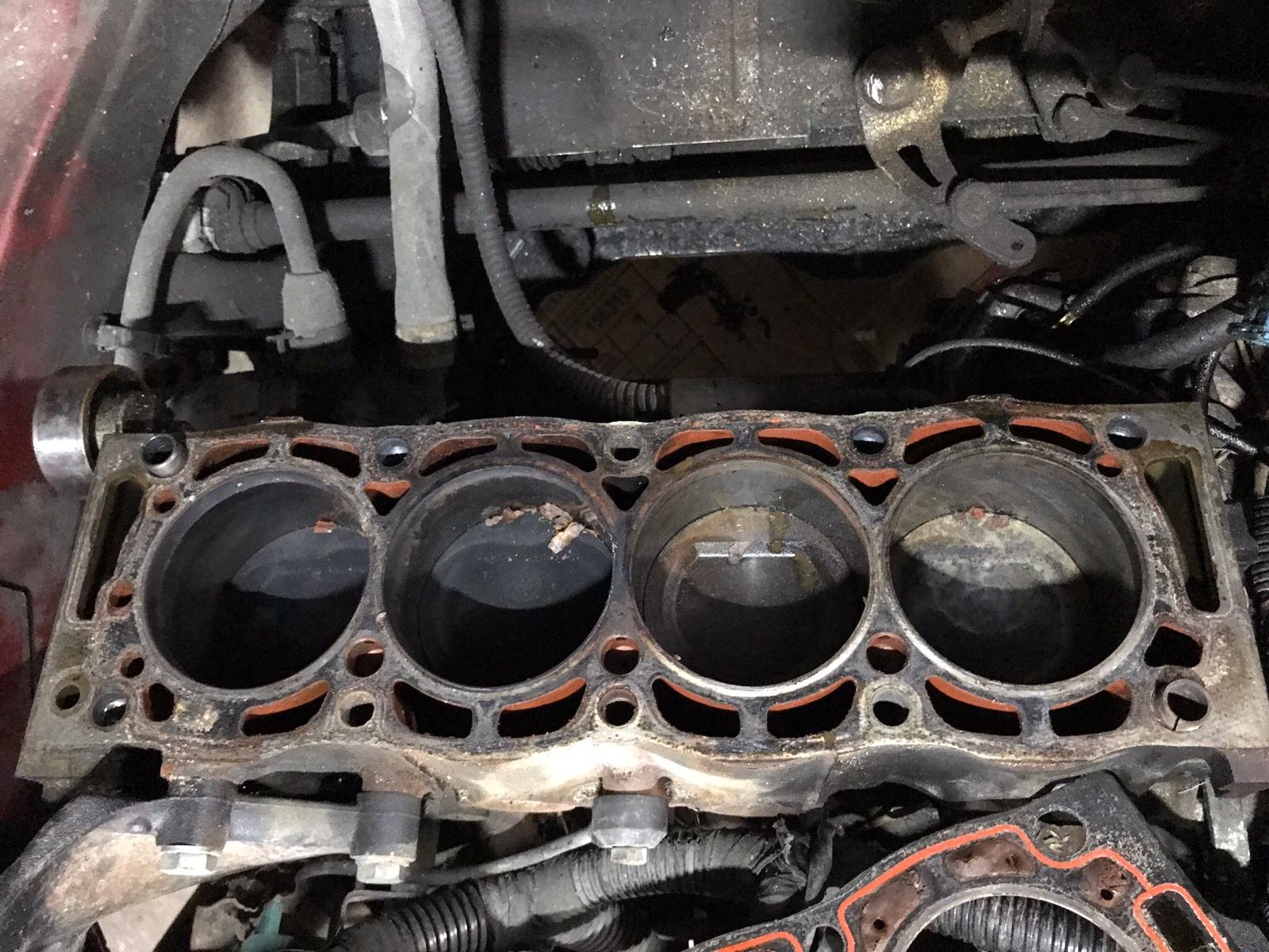

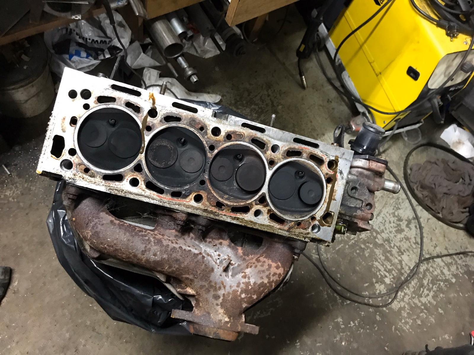

With the exhaust separated, intake manifold disconnected, and valve cover removed the bolts holding the head to the block were undone and the head came right off.

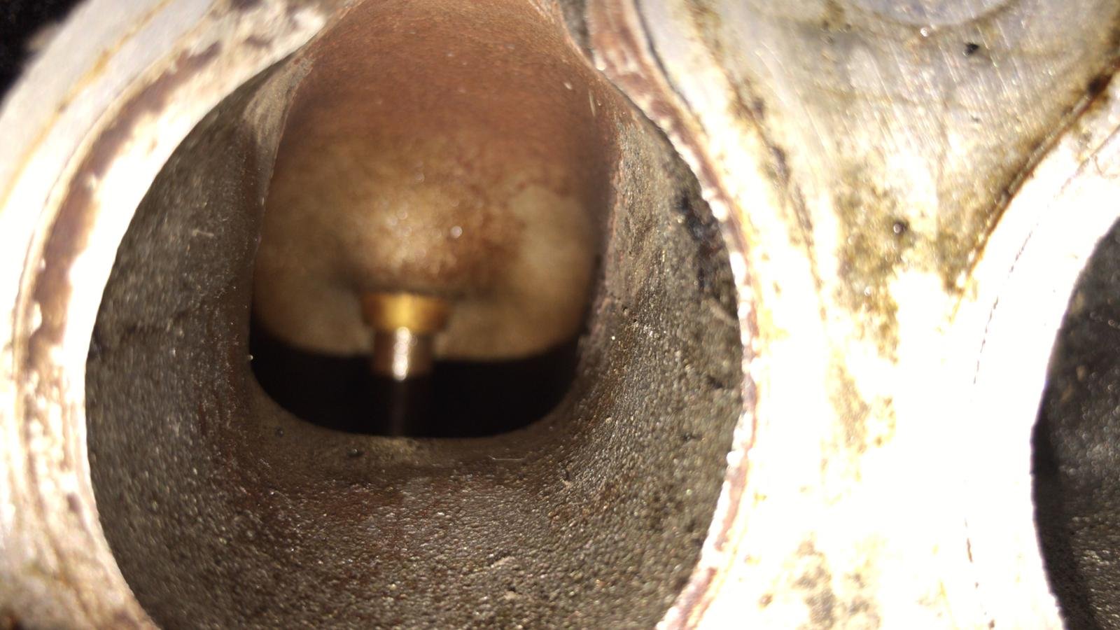

There was clearly visible area between the two central cylinders where gas had leaked between them.
889979917_WhatsAppImage2020-05-09at20_04_53.thumb.jpeg.6604bb3409ed9bc4a77495518c442417.jpeg2124716734_WhatsAppImage2020-05-09at20_04.53(1).thumb.jpeg.768e4f4e5701cc78b8bdea10aefd5a0d.jpeg
Intake port no.2 (counted from the right) had some visible discolouration.
159032937_WhatsAppImage2020-05-09at20_04_50.thumb.jpeg.2b51de0f3d7c8a4f5ecbb22be0d05cc8.jpeg

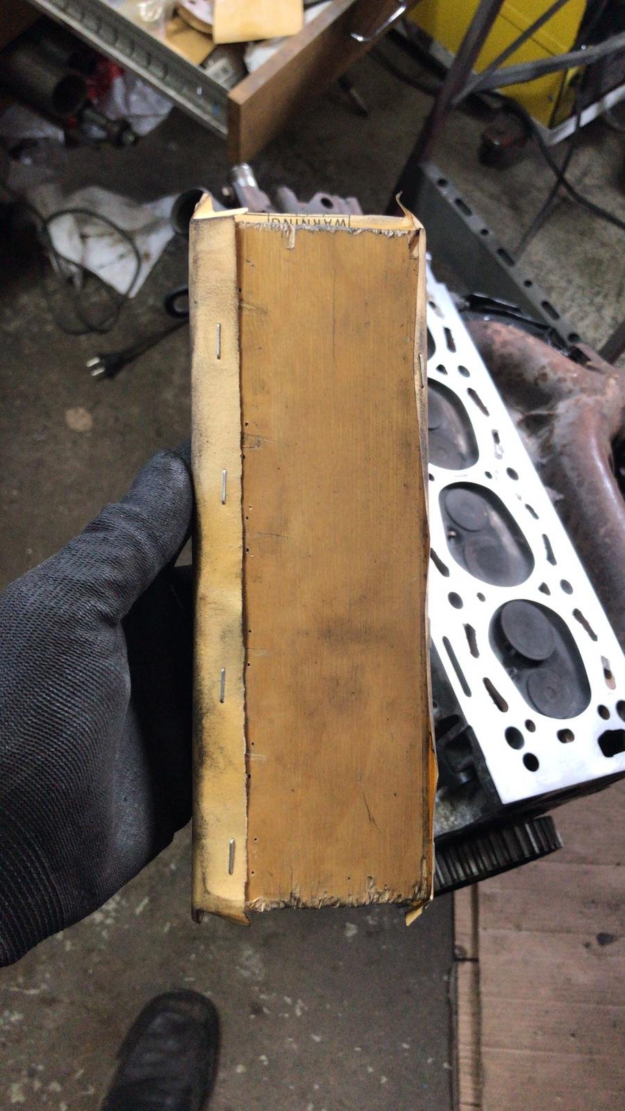

I after removing the old gasket I gently sanded the head with 320 and 480 grid sand paper attached to a piece of wood going across the whole block in one motion to remove residue.
1874464623_WhatsAppImage2020-05-09at20_04_55.thumb.jpeg.fef27c958581b552af98685630e685b1.jpeg
With the cylinderhead and top of the cylinders sanded, the threads were cleaned by going through each hole with the right size thread bit and when all were done all holes were cleaned with pressure air.

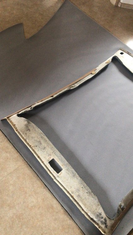

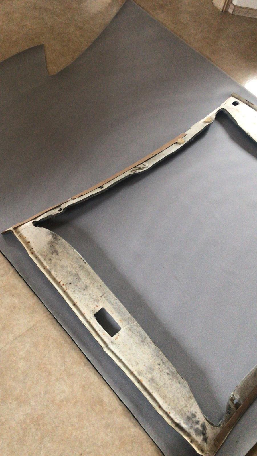

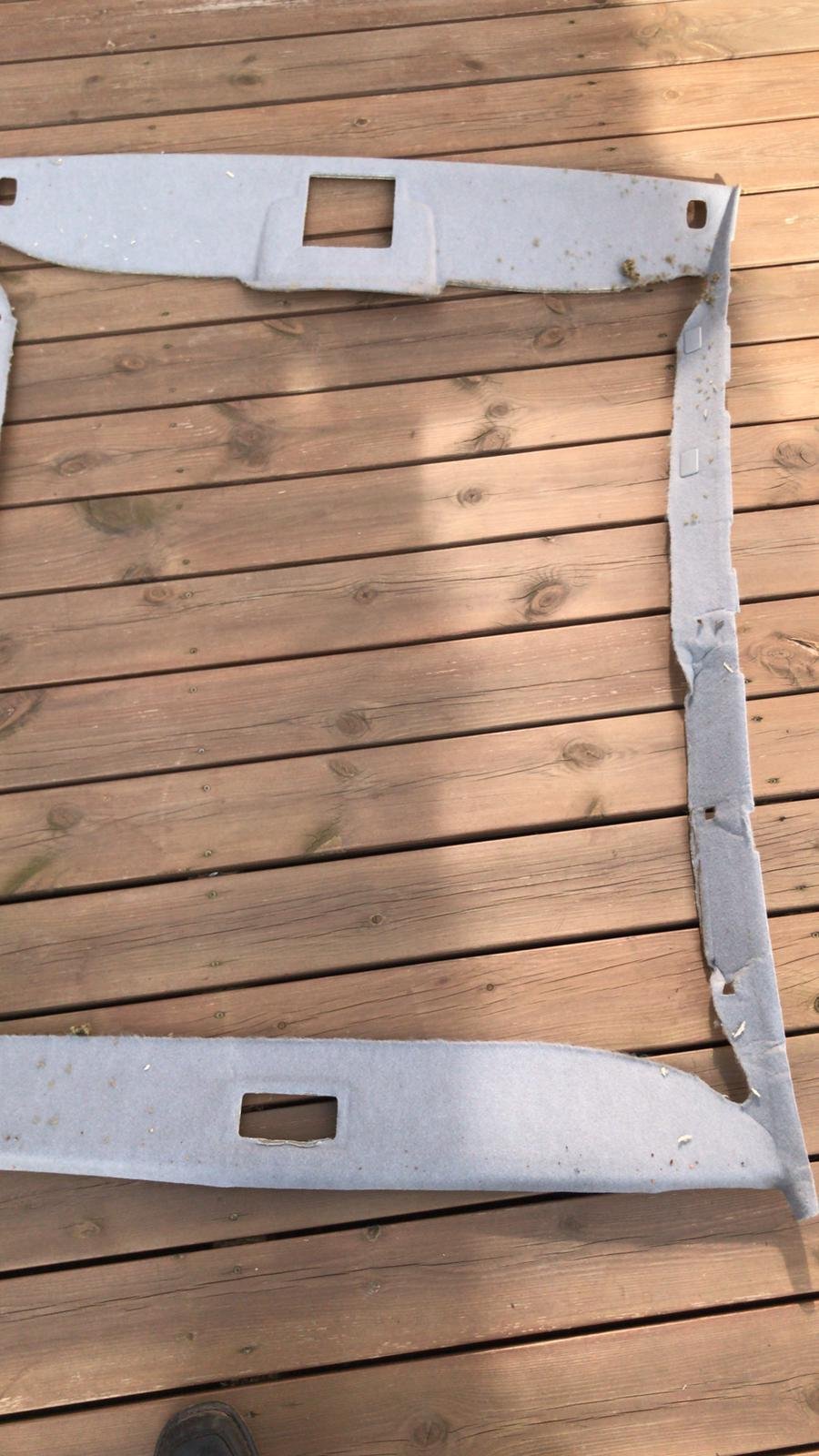

The roof liner was the next on the list of things to do, here is the original roof liner that had the mid section cut out for the sunroof conversion. I bought some fabric from a local custom car/boat dressing company for about 50€. Note, if you are ever doing this you only need about 1,5 by 1,5 meters of fabric. I bought 1,5 by 2 and it was way too much.
786359430_WhatsAppImage2020-05-09at20_10_03.thumb.jpeg.904708fc1a7817b6a95ce3e8e581010f.jpeg875264303_WhatsAppImage2020-04-27at14_12_16.thumb.jpeg.5110082928fdf2f40447a586e776144f.jpeg

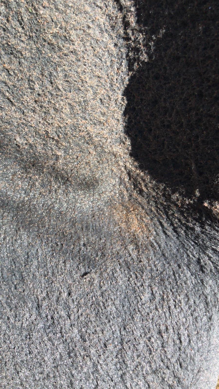

Unfortunately I didn't take more pictures of the process but I placed the fabric on the floor and placed the old liner over it and simily cut out the square shape leaving about 5cm clearance on all 4 sides. The fabric was then attached to the liner with a staple gun (same method as whoever did the conversion).
I gentyl cut out the holes for the lights by cutting an X inside the two holes and stapling the fabrics up around the corner of the liner. I also placed velcro on the roof liner to prevent it from hanging down in the middle . I measured the distance roughly in the car then marked it on the fabric. The velcro was selfadhering.

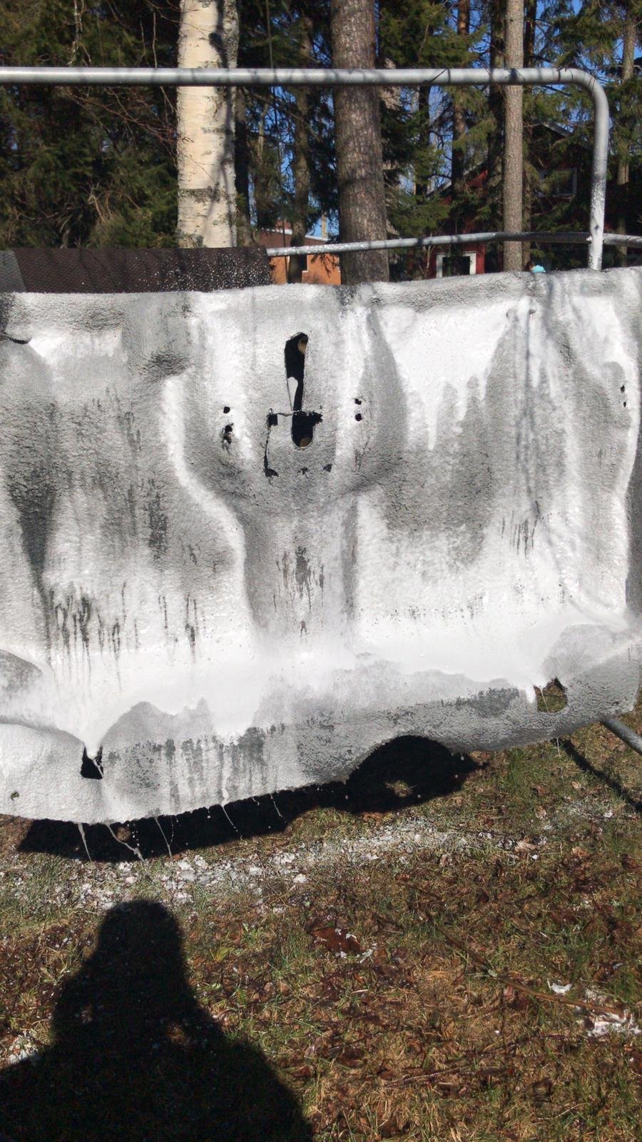

Before continuing with the roof I used a spray paint (RAL 9005) suitable for fabrics and sprayed on the fabric part that covers the sunroof if one wants to hide it. I couldn't take out the piece I'm talking out as I would have replaced the fabric on that one too then. I built a small enclosure for painting inside the car to not get any paint on windows or carseats and it all went well in that way. It didn't turn out great but I will almost always have the sunroof visible so hardly anyone will ever see the failed spray.
With the fabric attached to the liner I brought it out to the car where I first attached it to the roof by attaching the light trims so it was at least staying up. The corresponding velcro was then placed roughly where it needed to be so I placed 2 strips next to each other to make sure I got it in the right place. I then started putting in all the interior trims by starting with the B pillars, then C and finally A pillars. Unfortunately I broke the a pillars a bit (yes, both of them), the clips connecting  them to the B pillars broke but I used a thin double sided tape to keep them joined together.  Finally I just opened the sunroof completely and drew with a black sharpie (would not reccomend doing that if you have a light color fabric) roughly 5 cm inside the edge of the roof hatch. I then cut that out, made some extra slits and tensioned the roof by putting the edge rubber trim on to it. I simply pulled on the fabric and pushed on the trim then moved about 3 cm and repeated the whole way around.

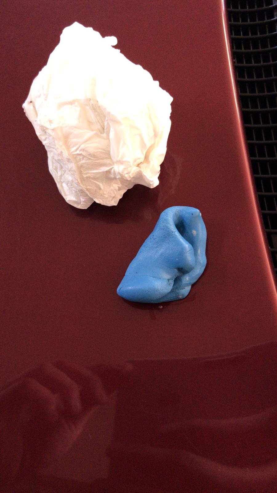

Final step was washing the car, cleaning the exterior with clay, polishing and waxing the car.
From left to right, clay, polished, waxed.

The color I bought for the pillars was not RAL9003 (white) it was RAL9004 which is dark gray. RAL9005 is pitch black. We also looked at RAL9011 but it was not as close of a match as RAL9004.

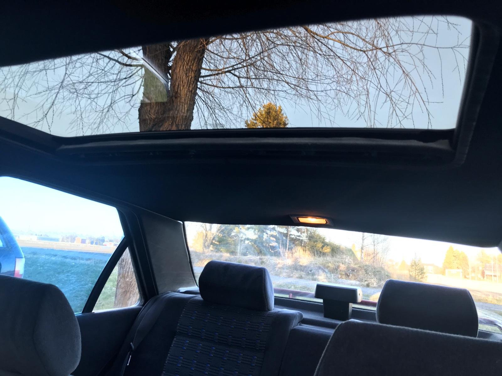

My 405 also had a missing drivers side mirror cover. I added some filler and painted it to match the car's paint. Looked much better, than before :)
Does your sunroof work ok? These days the cables tend to rust stuck.
Atlaskrukvaxt
  On 5/17/2020 at 3:35 AM, estland said:
Very nice reading :)
Thank you and sorry for late reply!
Yes it works completely, I was really surprised that it is holding water away too since we have had bad experiences with "aftermarket" sunroofs on our volvo projects.
