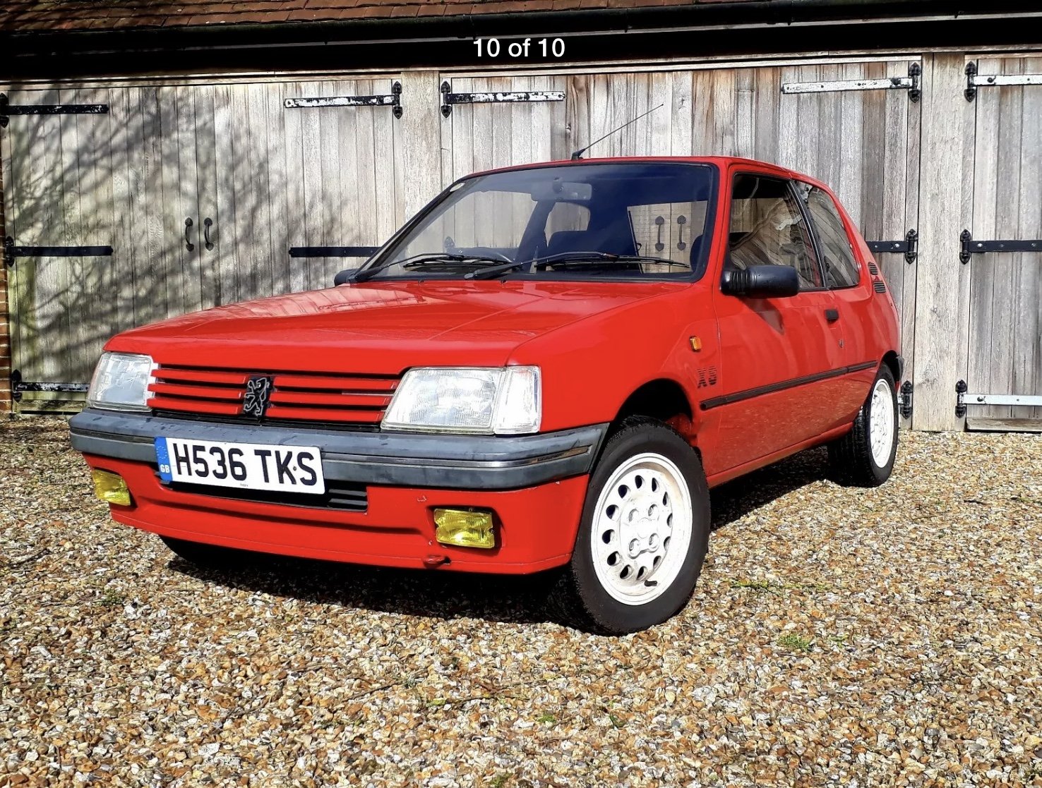

gtiburge 0 Posted April 26, 2020 Hello ! I’ve just bought this car xs1.4 my second Xs and 5th 205 I’ve had a right mare getting it home badly blown head gasket many water stops then finally gave in and trailered the last 20 mile, hoping the engine is ok ( it’s just the head gasket ) you could not wright the hole journey really! questions 1 dose any one no history of the car previous owners on here would be nice to find out anything really there is a post in the TU section regarding the head gasket so any help much appreciated Located Holsworthy Devon Thanks Olly Share this post Link to post Share on other sites
