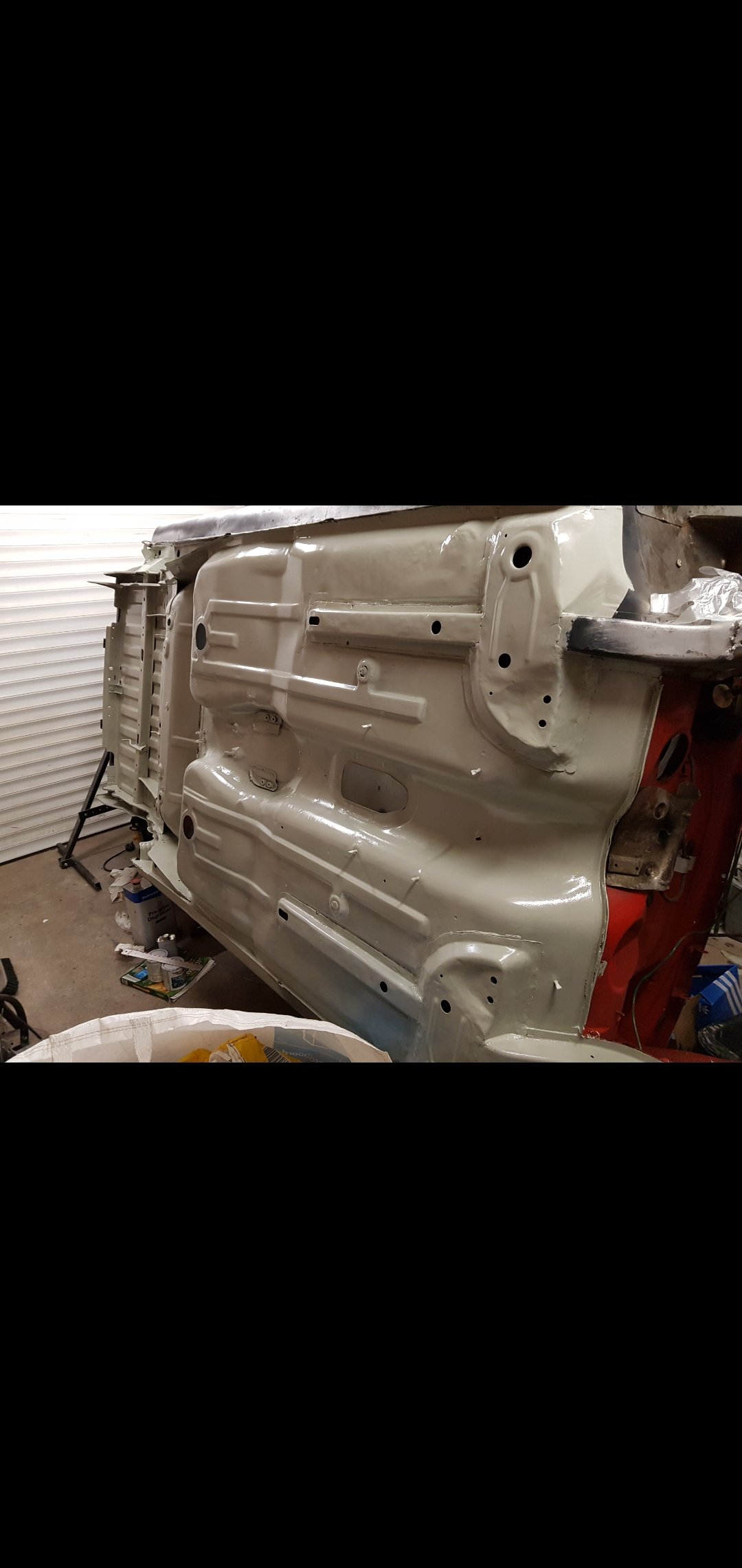

Been a busy couple of days replacing the boot floor.
Bogsye
Good effort!! That must be pretty satisfying. How was the fit of the panel generally?
I have the repair section for mine, so hope to get that on the go in the next few weeks.
series111
Had to do a little trimming here and there, but to be honest it was a pretty good fit.
Just make sure you take your time and keep checking the fit, as I must of fitted it on and off about half a dozen times!!!

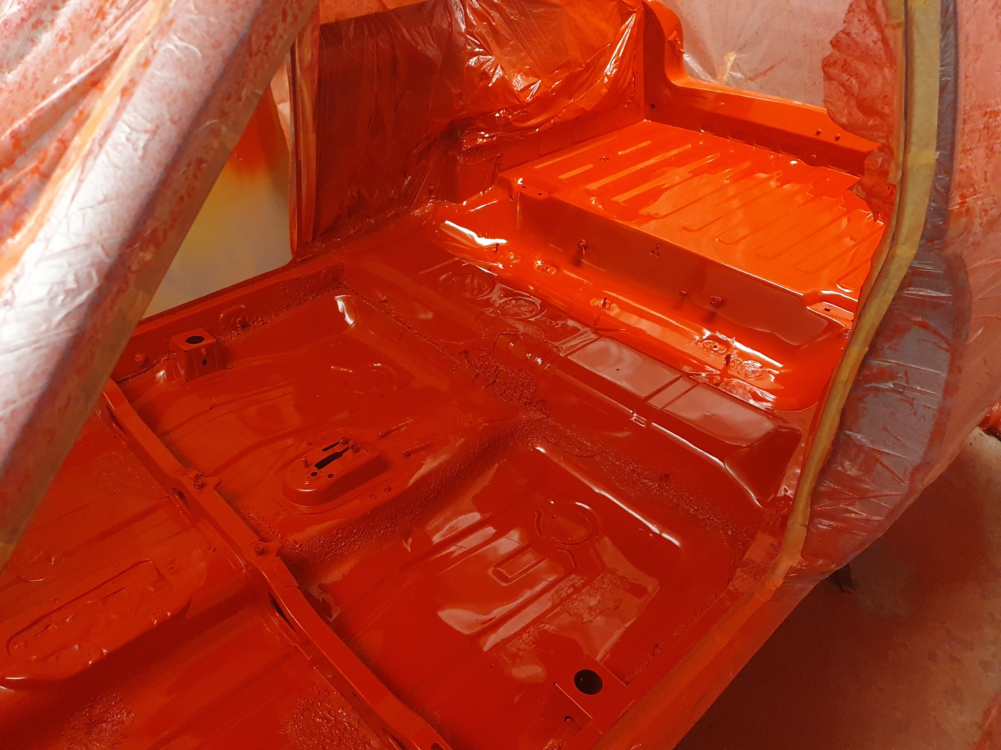

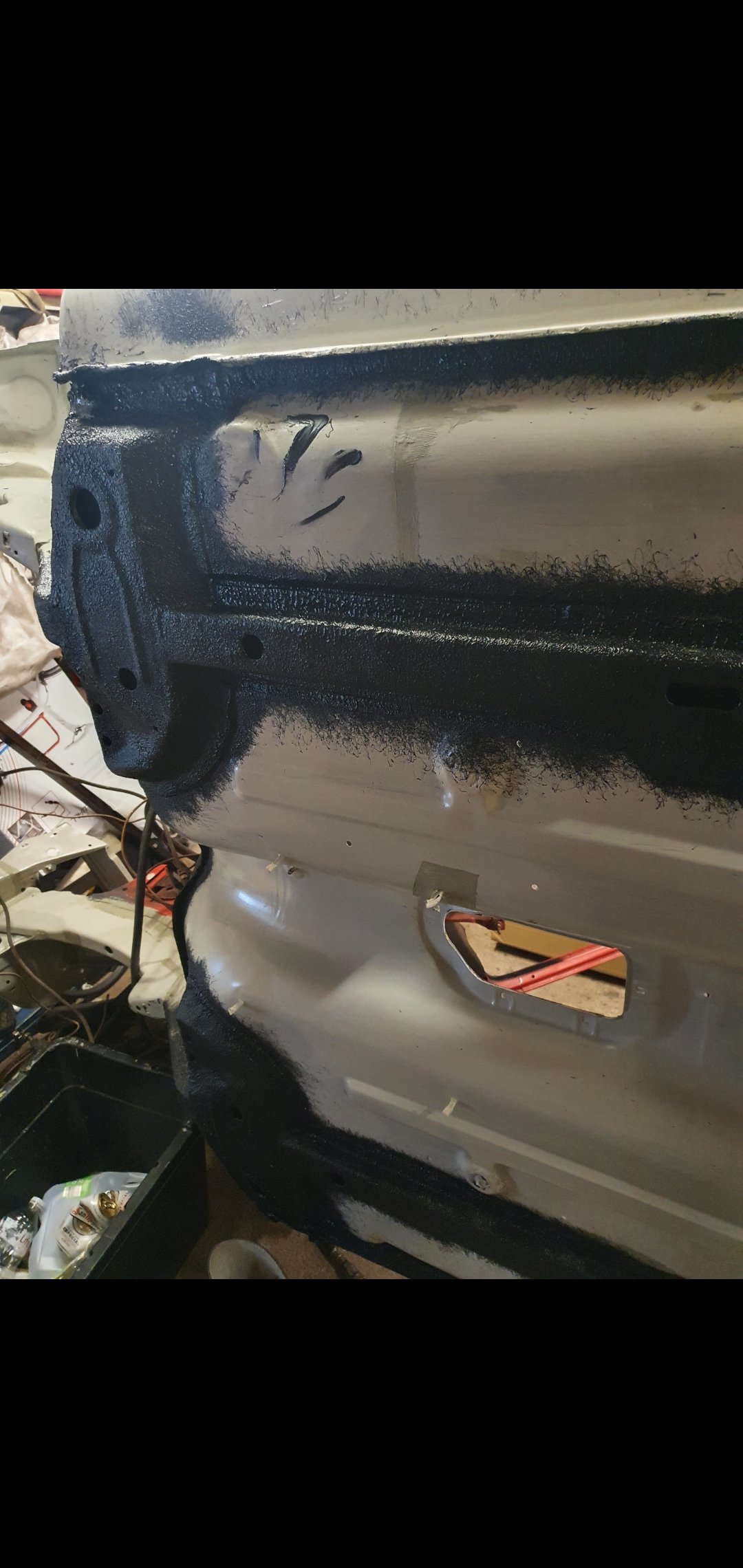

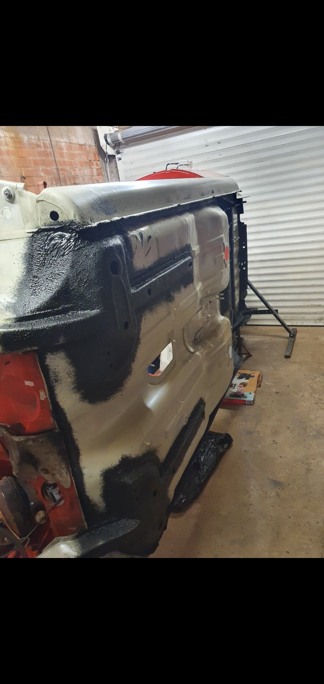

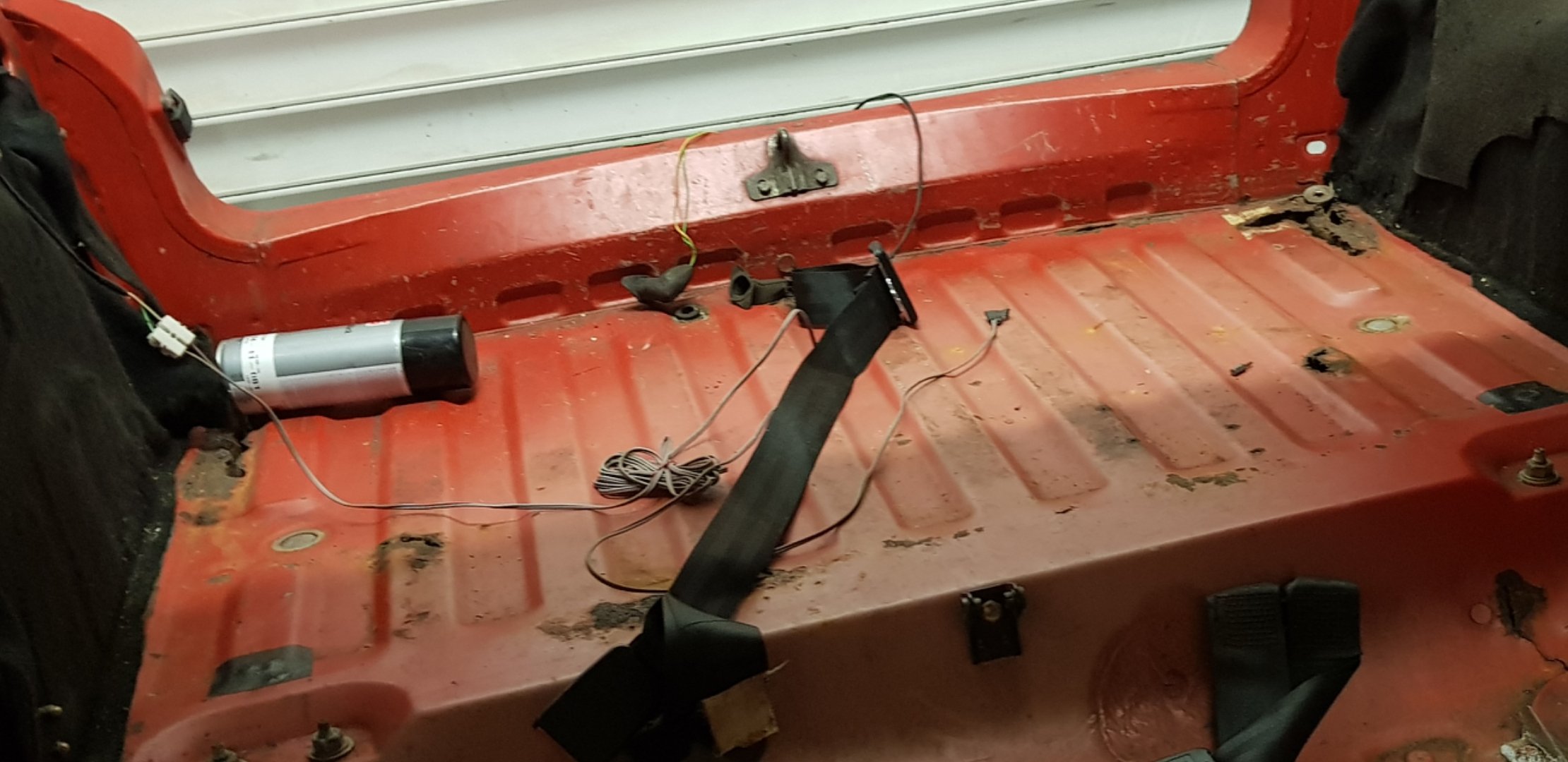

series111
Thought I would post an update the welding is finally finished!!!
I have now painted the underside with rustbuster EM121 epoxy mastic this stuff is tough once dry and applied sprayable seam sealer to give that factory finish.
Now just waiting till it gets a bit warmer to paint the underside with gravitex stonechip & 2K paint.

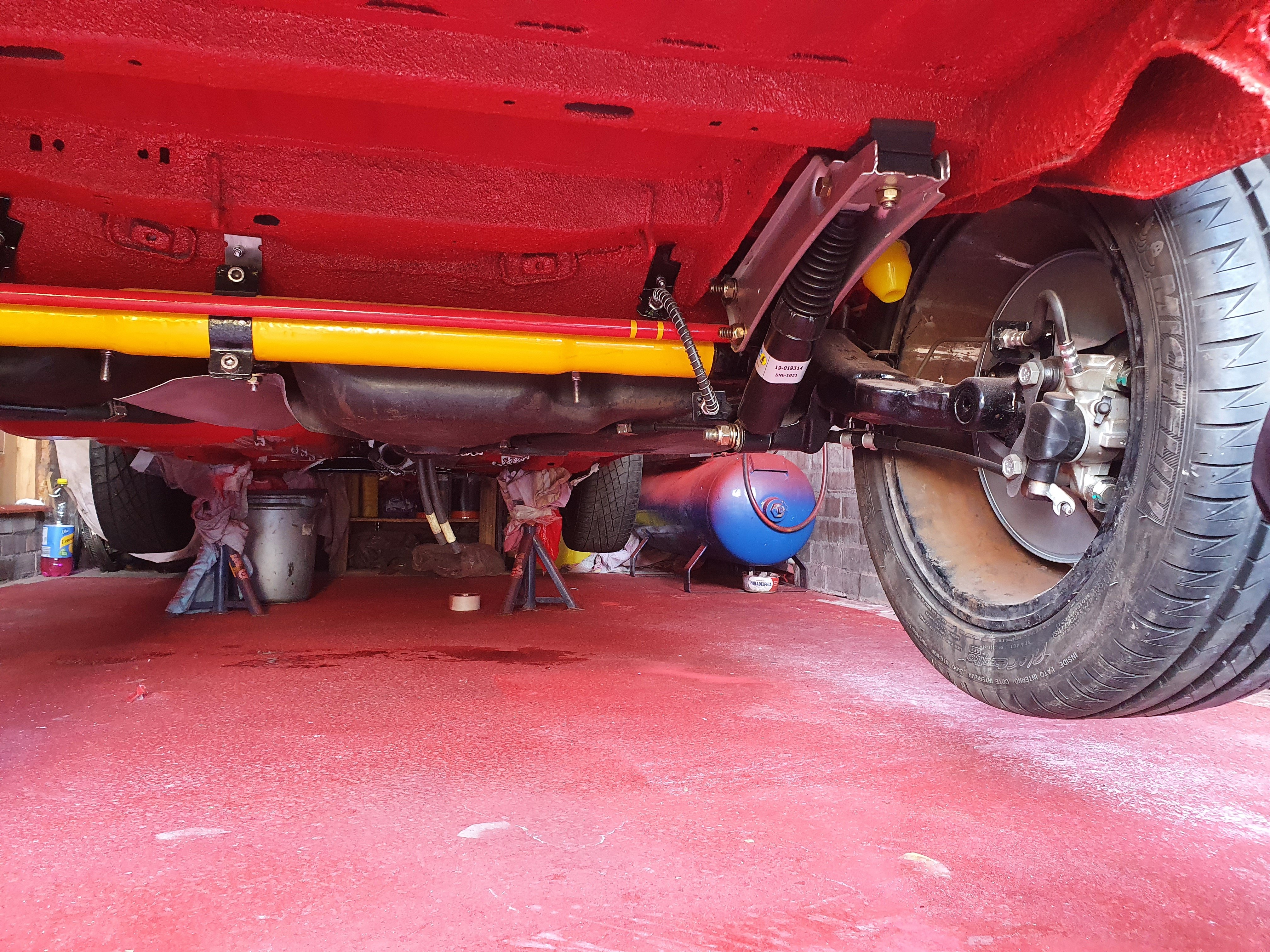

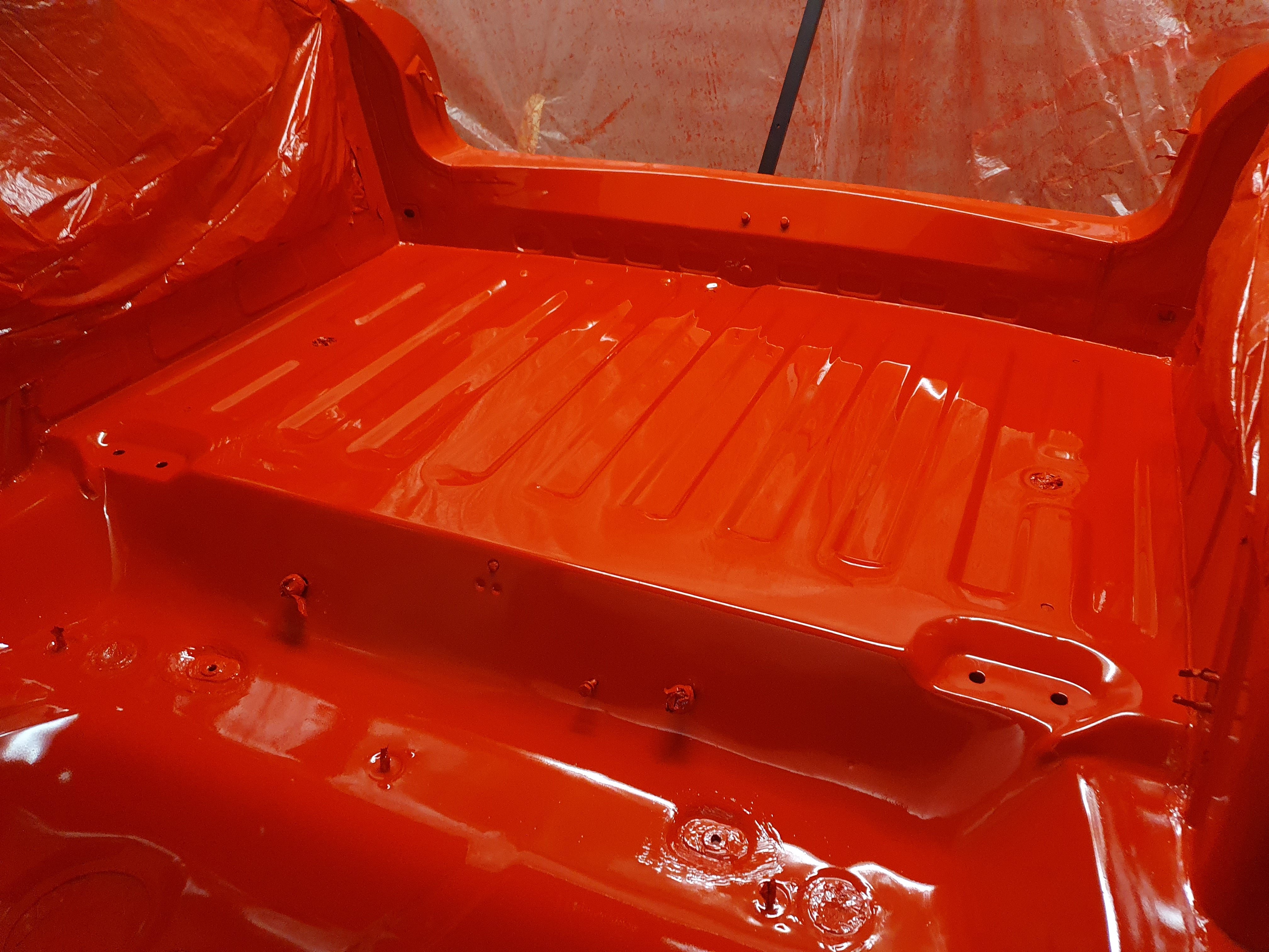

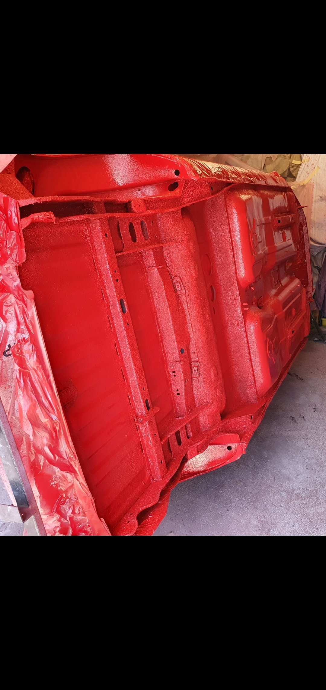

series111
It's been a long time coming, the underside is finally in colour!!!
  • Like 2

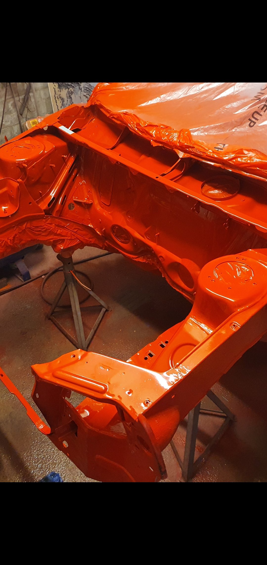

series111
Slowly getting there it's been a long slog to get it to this point.
Nice job well done.

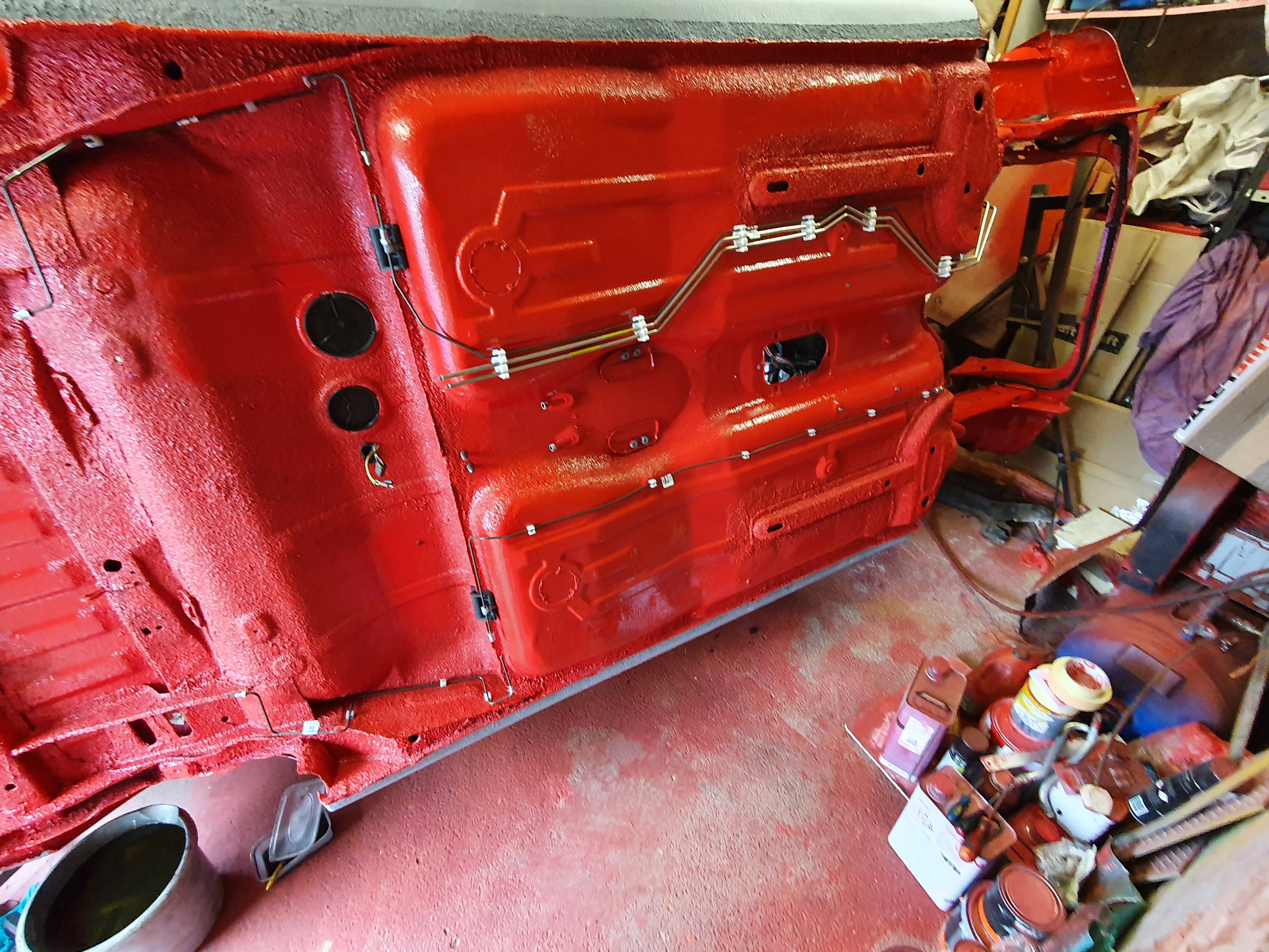

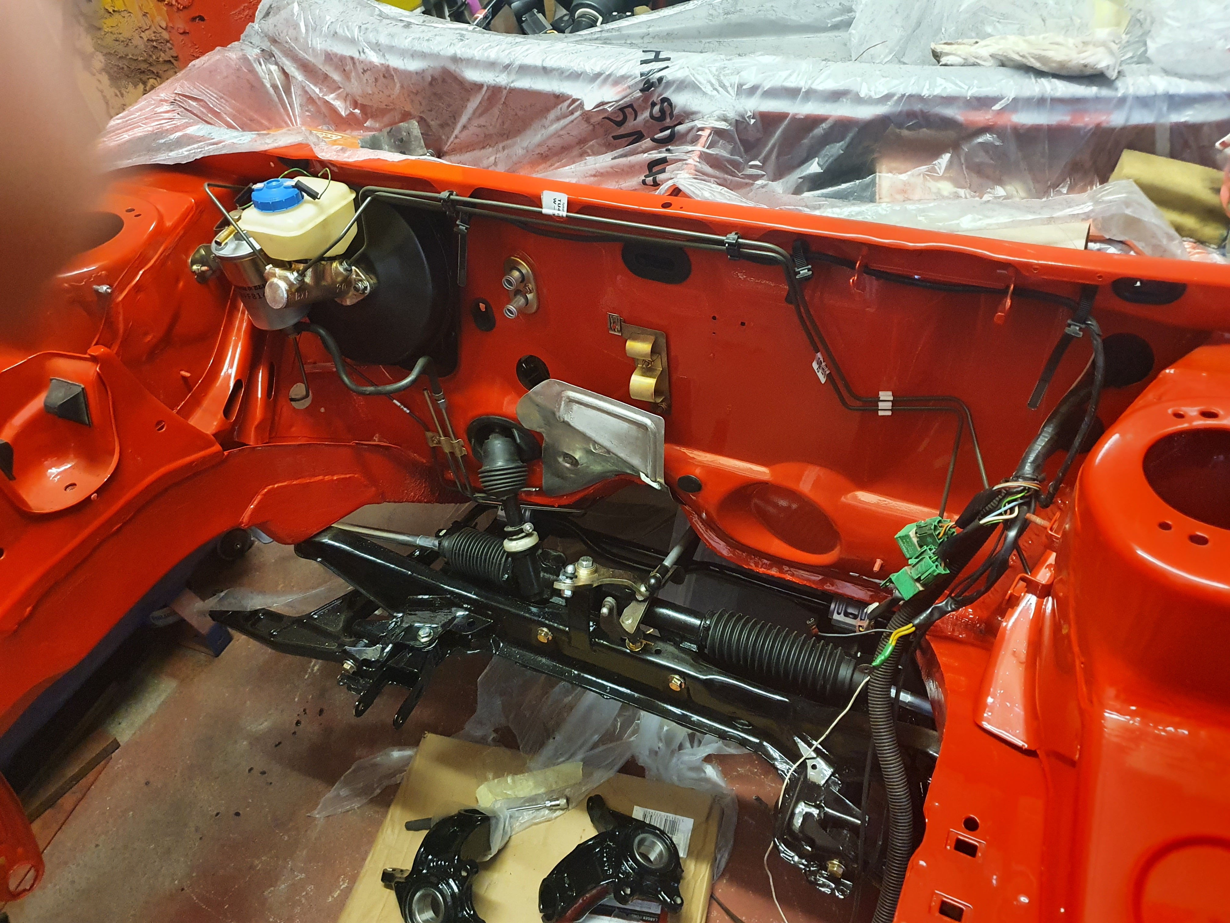

series111
I can now finally start to get it rolling again in preparation for the external bodywork being painted.
Now that the inside & engine bay are now in colour
Edited by series111

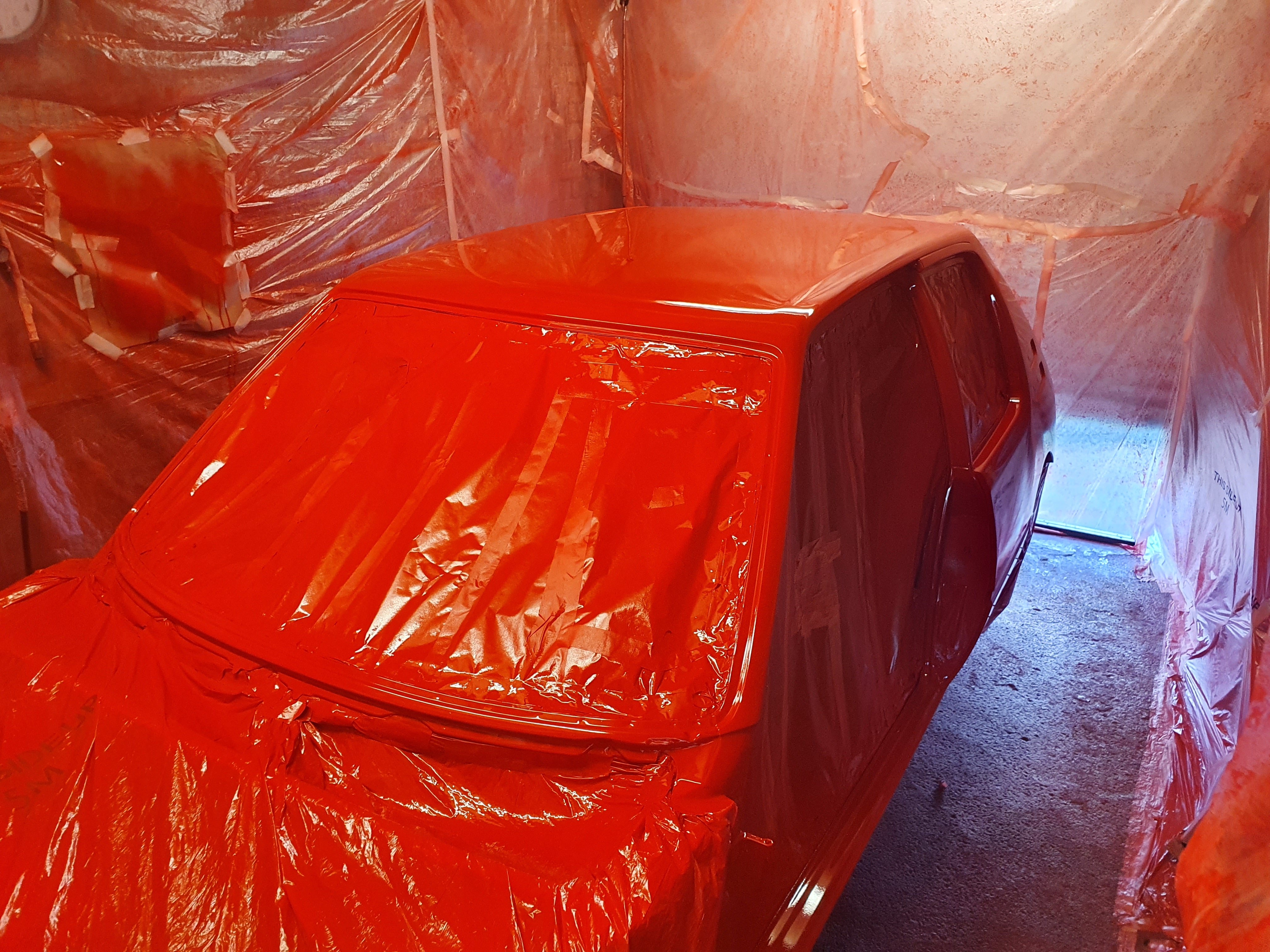

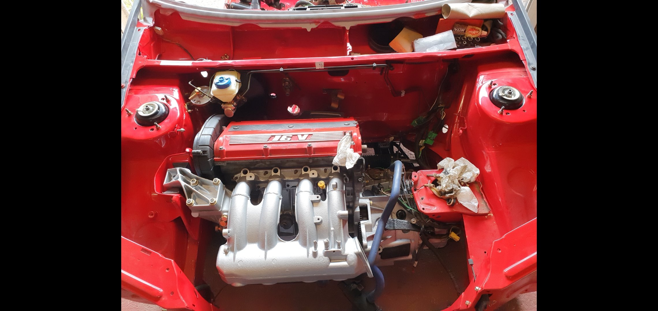

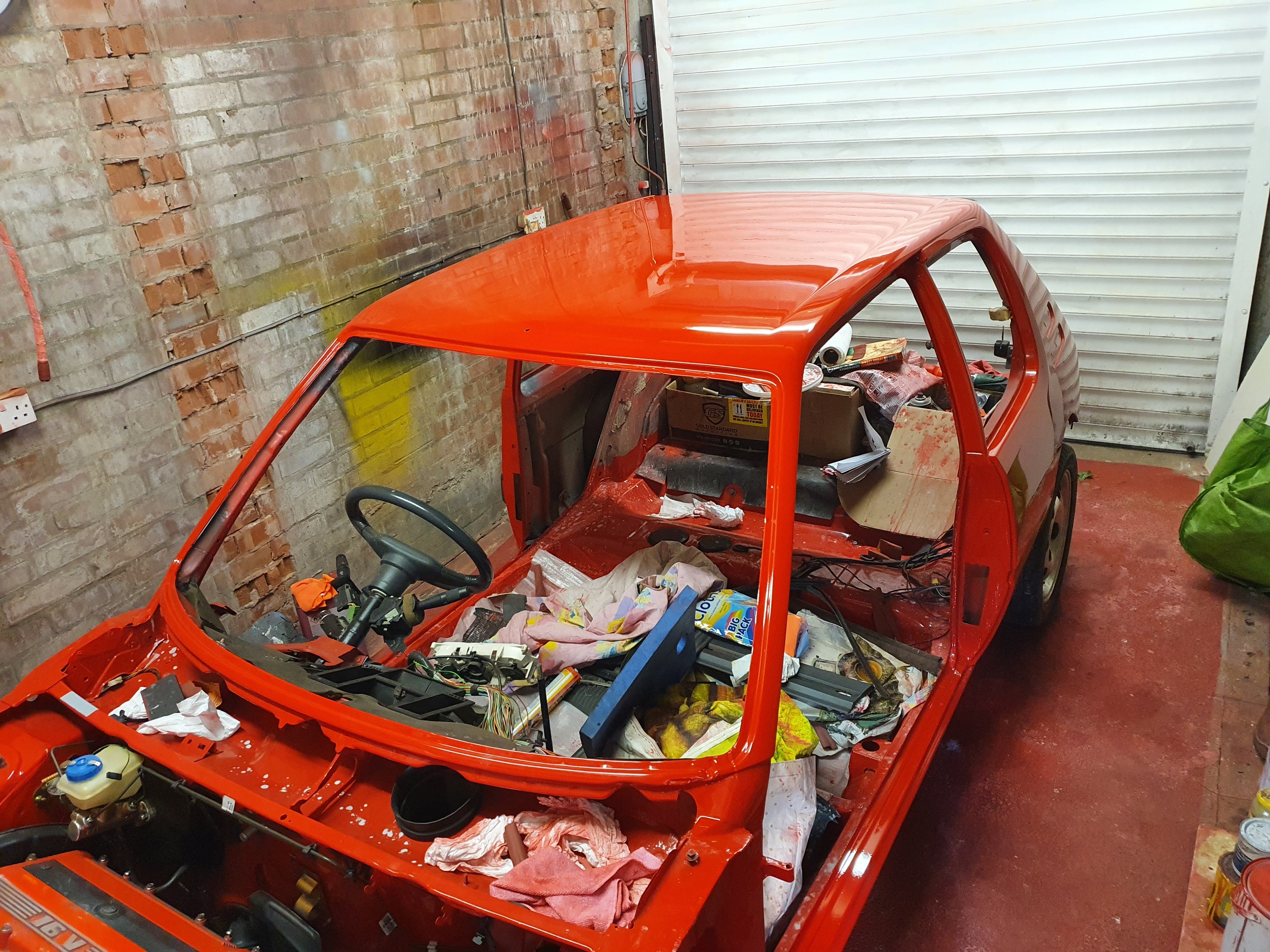

series111
It's been a while since I updated this project I've been busy as you will see in the pics.
It's been a long slog but she is finally rolling with the main tub painted which I did myself due to being let down by my bodyshop man so taught myself.
Just the bolt on panels to do now which I am currently in the process of doing.
Excuse the mess inside the car I'm struggling for space !!!
Edited by series111
