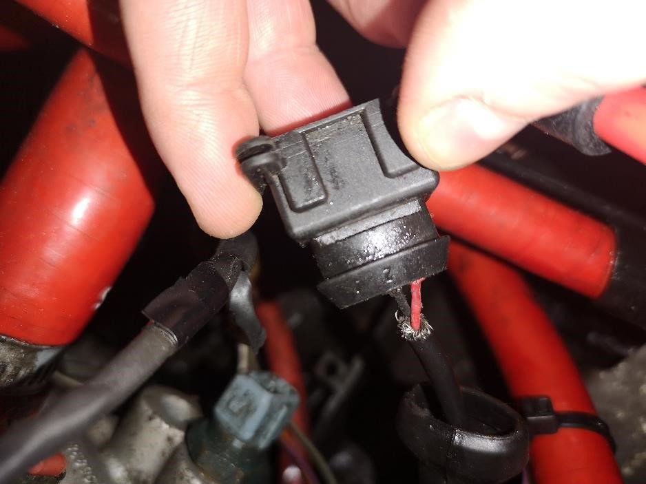

I managed to have a quick look at the cps last night, below photo is of the sensor end. I take it that the red wire is the signal and black is ground? The black is not connected to the screen at this end, I'll have to have a look at the ecu end to see if they are joined.
jackherer
That looks right as long as the screen is grounded at the other end to the ECU.

Screen is connected at the other end, so that all checks out. Hopefully get to test it with the alternator disconnected at the weekend.
