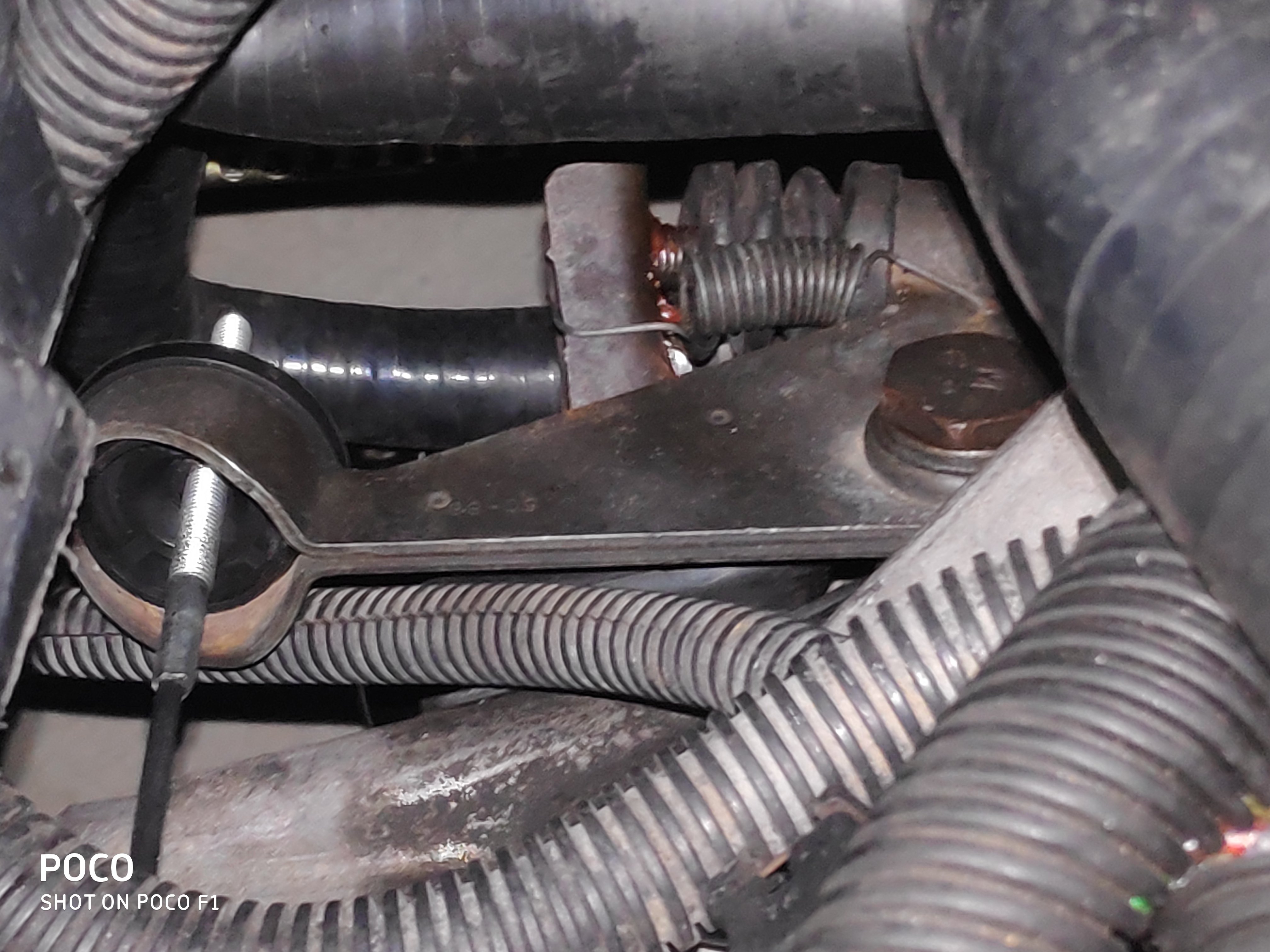

Many thanks for the info jackherer. Not sure if it looks ok, but I will pry open the rubber boot and take a picture again during daytime.IMG_20191220_200420.thumb.jpg.04d96e7ed569409c974ee8e5ba917df5.jpg
The pin looks like it's probably OK to me, I've never seen a rubber boot there before though.
Get someone to press and release the pedal while you watch the arm on the gearbox, look for any bending or twisting of those two parts.
If the paddle coming out of the gearbox has excess play it could be the ball joint it pivots on inside the bellhousing, they are only riveted on and can detach.

That looks fine.

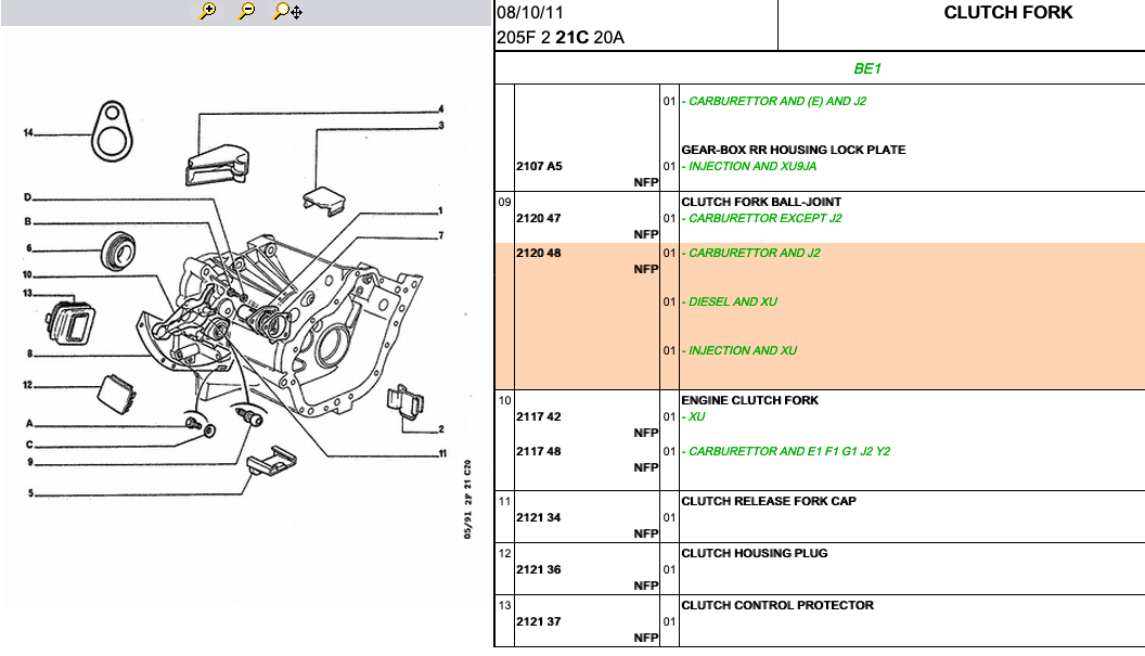

Hi jackherer. Is the ball joint inside the bellhousing shown in the image below?
No, that just shows the gear change linkage.
The ball joint is number 9 on this diagram:
1082582622_Screenshot2020-01-02at18_37_06.thumb.png.8b6046ca08691c150460c63110fe1b11.png
I can't find any actual photos to confirm it but I don't think that diagram is very accurate, it's years since I've touched a BE1 but I was sure that ball joint is just riveted in. Maybe it is the socket on the fork I was thinking of..? Either way it definitely comes loose.
