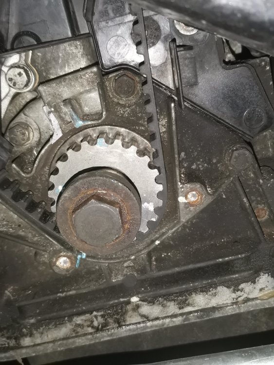

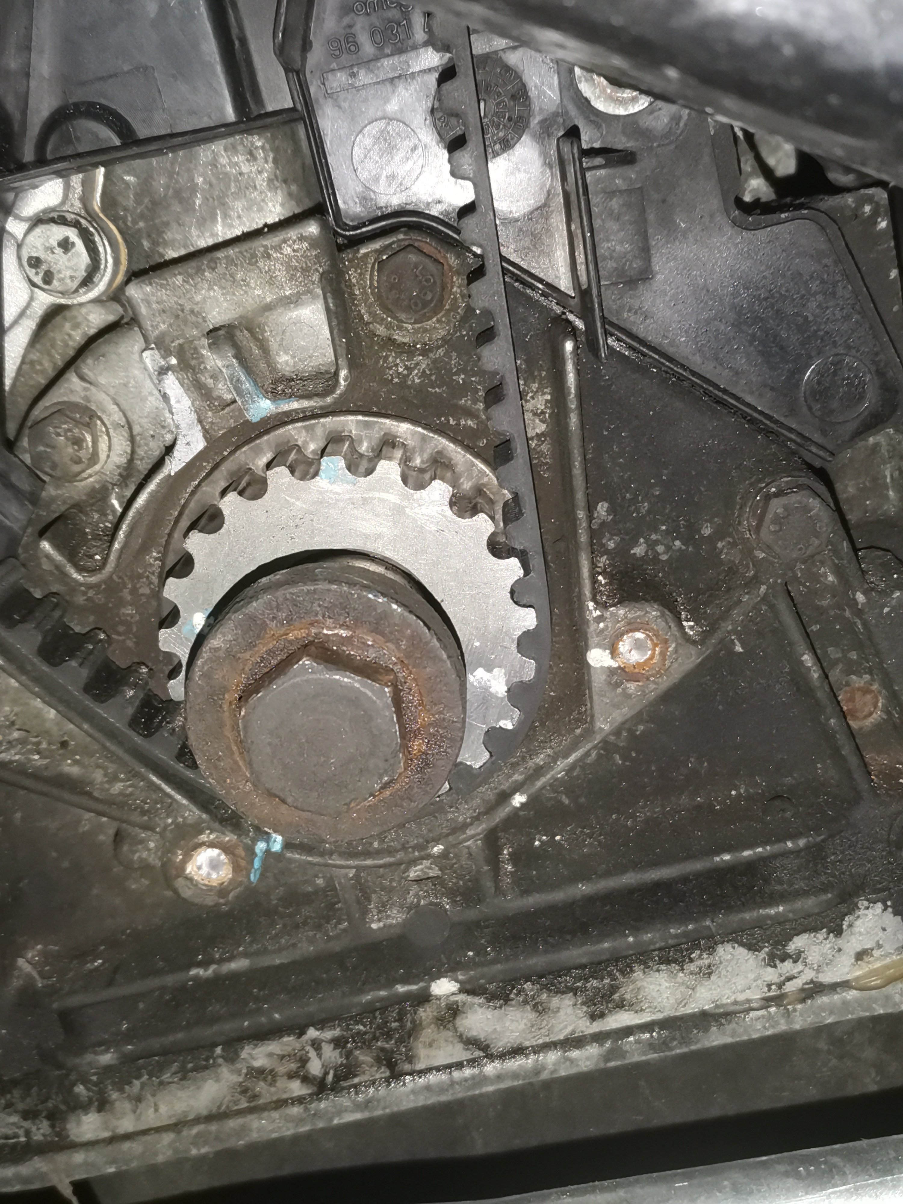

Thanks guys back up and running ,2 of the 11mm bolts that hold the timing belt cover have sheared yesterday on removal as seen in picture. They both snapped right against the block so vice grips will be no good, is trying to drill them a good idea?
Try drilling a hole then bashing in a torx bit. I don't like your chances though, if you've managed to shear an M7 bolt. It might be easier to remove the timing case and fit another.
wicked
Works best if you use the multi teeth torx bit (iso the 6 teeth torx).
