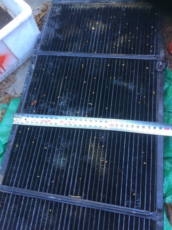

Very new to 205 ownership so please allow for a lack of knowledge, both Peugeot and mechanical ...
The car's an October 1989 registered 1.9 GTI which I believe I'm right in saying is a phase 1.5 without a catalyst?
The existing radiator has sprung a very minor leak and a replacement has been bought along with a fan switch.
Unfortunately neither fit the existing fan cowling mounting points, top or bottom / wiring loom electrical connector.
You'll hopefully see better what I mean from the images below rather than try to explain in words.
Both the new items were supplied as being for my model, however I have to accept the sellers have got it right.
The existing radiator and cowling seem to be date marked around mid 1993, so not the factory originals.
I'm thinking maybe my my car been upgraded / changed (diesel fan/cowling?) meaning standard 1.9 GTI parts no longer fit or are the parts I've been supplied not for my model?

Your rad looks like a standard 205 GTI rad to me. All GTIs have the same radiator regardless of year.
And your fan switch looks right for a pre 1991 205 GTI. The one you've been sold isn't right for any 205 GTI, either pre or post 1991.
I imagine both parts you've been sold are for non-GTIs. Take them back, get a refund and buy elsewhere.

should be a 30mm core for a gti, TD used 50mm, na-D used the sams rad as the gti.
cant check right now but an ac rad may be different, behr brand is fine if it fits
The height looks correct for an AC radiator but everything else is wrong.
AC radiator.

I've been looking at others online and none that I can find match the existing rads measurements, which are as follows - (The measurements of the replacement rad are in brackets to let you see the differences.)
Core alone, left to right - 660mm (610) / entire width, left to right - 720mm (680)
Core alone, top to bottom - 300mm (285) / entire height, top to bottom - 320mm (300)
Core depth 55mm (34)
The distance between the centers of the 2 x bottom mounting pegs 410mm (405), that difference alone means it won't fit regardless of other variations.
I suppose small differences in rad dimensions can be adjusted for, but it's the fan cowling fixing points that are the biggest problem for me, they seem to need to match those on the rad exactly so the whole lot can go back in as one unit.
if you have a 50mm core then someone has fitted a TD rad
bacardincoke
Cheers, starting to make sense now... the fan cowling is a genuine Peugeot item and appears to be the same age as the existing (TD) rad, I'm guessing they must have gone in at the same time and are a match to one another.
If TD and GTI rads differ, do the fan cowlings differ also?
If so presumably I'll either have to change like for like and install a TD rad once again (as long as that's not going to cause problems), or source the correct GTI cowling if I want to go with fitting the proper GTI rad?
It doesn't look that fat in your photo next to the silver one!
The TD rad is expensive and rare and also is not necessary for a petrol GTI so you'd probably be best off just getting a GTI fan cowling and rad.

Well I'm now 99.9% certain I've the radiator and cowling / fans from a 1.7 TD fitted.
As mentioned above TD rads are very expensive , approx. 4 x times that of a GTI, so changing like for like may not be the most effective option.
I had thought of reverting to the GTI rad., however from what I can see the cowling is different which leads me onto whether or not the fans differ too, both in how they physical fit or performance... anyone aware of this?
I'm pretty sure the change was done a long time ago, would it have been a recognised 'upgrade' and even it were, does it have any advantages?
My car's not in regular use, nor will it be driven hard so that sort of performance improvement doesn't really concern me... having said that if it genuinely aids cooling presumably that's no bad thing for any engine and worthwhile?
Turns out there's a radiator refurbisher not too far from me, so I'll be checking that option out also, if it can be done at a reasonable price may well be the easiest route!
It's a completely pointless upgrade, the standard GTI radiator can cool even heavily upgraded GTI engines.
I suspect some people fitted them to mask overheating problems elsewhere so I'd check everything else in the cooling system too.

Right... I know my existing twin fans work and the cowling fits.
If I want to revert to the correct GTI rad., along with the rad itself, I'll need to replace at least the cowling and potentially the 2 x fans also as I cannot guarantee they're the same and will fit.
By the time I do that (plus they'll be second hand parts) I'm unfortunately not too far away from the price of a new TD rad.
Found a local trader who's going to order one in at a good discount with the proviso that I'll only take it if it's a direct replacement, which I thought was fair enough of him.
So at the minute that's my potential fix.

Do You mean your getting a new TD radiator, the wordings a bit ambiguous?
If so, I think You should not, and You should get the correct GTi rad/cowls etc
Are You signed up to servicebox? This should tell You what thermo-switch was originally supplied when new, even if its not available from peugeot You can get the part number.
Gti rads/ cowls are identical to N/A diesels and easy enough to get cheaply S/H.
If You are sticking with the incorrect rad, its a traditional soldered one your local rad place will easily re-core it.

In an ideal world I'd have gone back to a GTI set up.
My circumstances unfortunately mean I'm relying on eBay and the likes to source items, plus having them being posted which combined soon adds up, plus I'm buying sight unseen.
I know the TD rad set up works, the indications are it's been on the car since 1993.
I realise it's an 'upgrade' that's of no advantage over a standard rad. but for me it's much the same cost to keep like for like as it is to convert back to stock.
As it turns out the guy I spoke to has sourced another Ordonez, which is the exact same make and model of the existing one so fits perfectly.

TD rads leave less room to access other stuff in future, the word upgrade should really read, "wrong" .
Ashman has a cowl and fans for £25 in the for sale
https://www.ebay.co.uk/itm/BOLK-Car-Radiator-for-PEUGEOT-205-17085010-Discount-Car-Parts/310776223542?fits=Car+Make%3APeugeot|Model%3A205&hash=item485bb4d736:g:MAUAAOSwOFtdNlSw
If your skint £37 Bolk rads are fine.
I reiterate its the same setup as a N/A diesel
