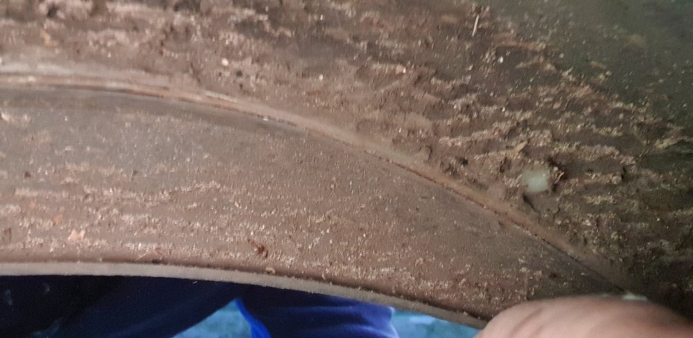

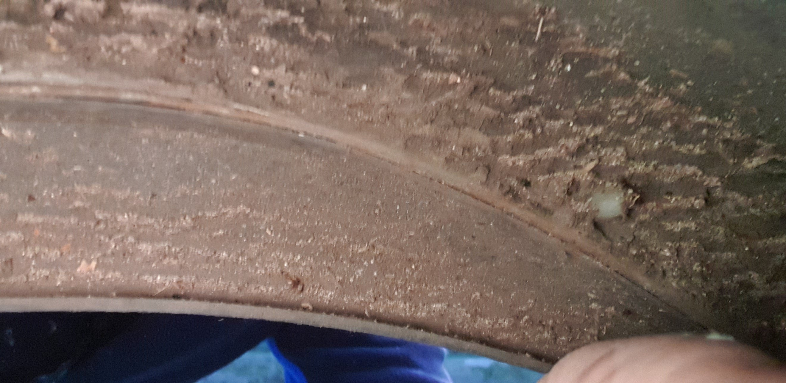

What do the rear wheel arches look like under the GTI bodykit? That's probably the most obvious difference between a GTI and non-GTI shell.

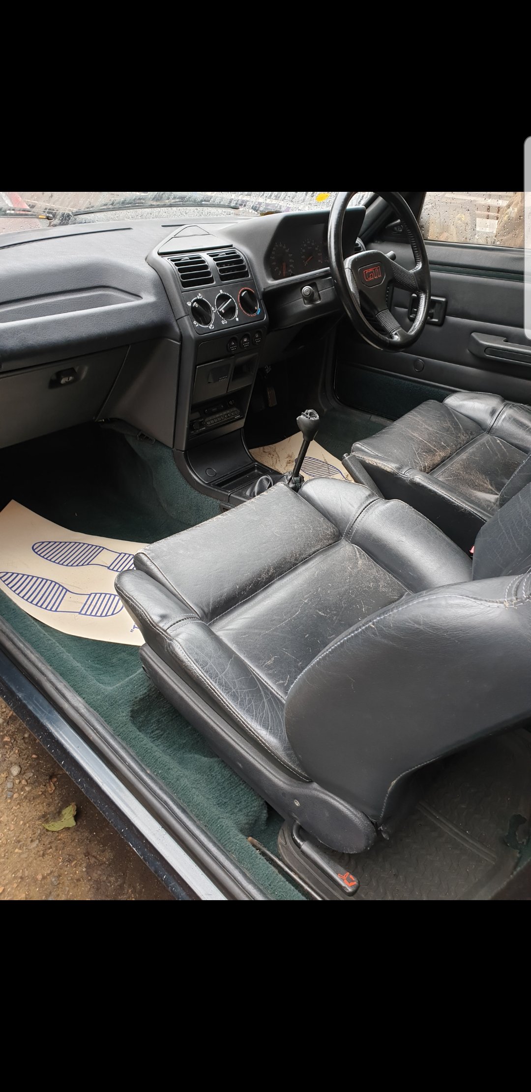

Also has green carpet and door card trim and full black leather

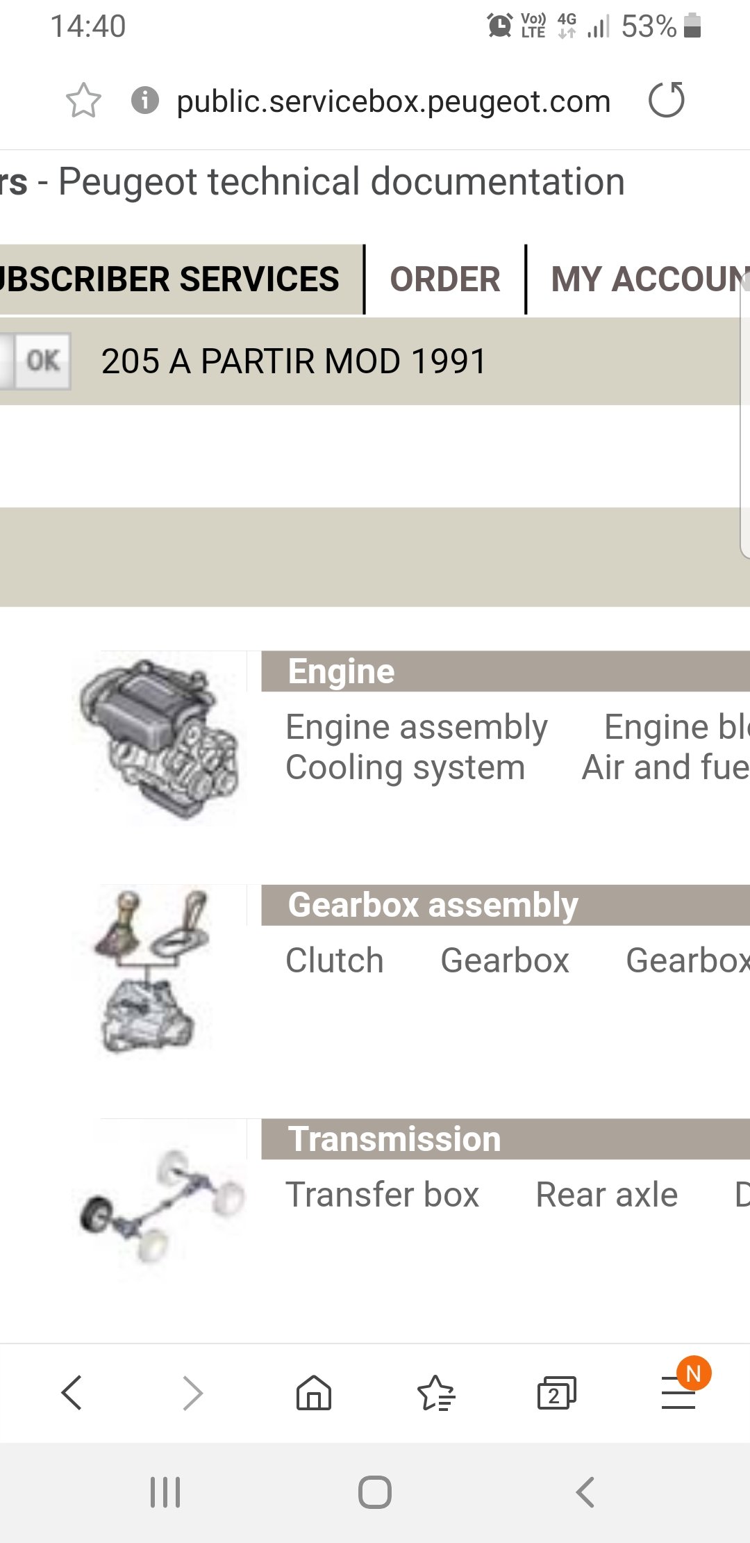

Just entered vin on service box link you send and it came up with this but I don't read French

'205 a partir mod 1991' just means it's a post 1991 model, i.e. a phase 2.
On the left there should be a link titled 'Characteristics' that should give you a bit more info. Don't be surprised if several sections are empty, there is only limited info for older cars like 205s.

Just tried to get photo of rear arches but it's a bit tight

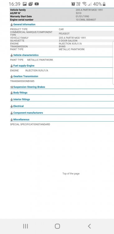

I will get a better look at weekend as its going for new tyres and track rod ends and I just looked back on that site and it came up with this20191105_162526.thumb.jpg.b0ddee4ccc2f5f6a3318dad7295205c9.jpg

Those arches look original and the data on servicebox is identical to my car so it's definitely a GTI.

Did you say full black leather ? Gentry out of the question?

My Sorrento green full leather which I believe is basicly called a Gentry had the XU9J1 engine, 105 bhp 1.9 with manual gearbox.
I suppose it is this type of car...

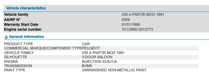

This is the ServiceBox entry for my 205 GTI 1.9:
Like I said before it also says "XU9J1/A".
It is 100% a GTI.

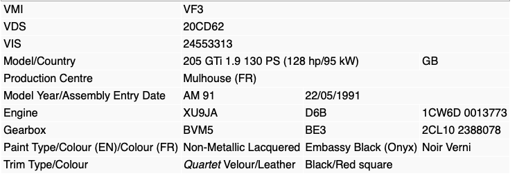

And this is what 205GTI.info says about the same VIN:
jackherer
It would be interesting to hear @griffo's thoughts on this, he is the person behind 205GTI.info and as far as I'm concerned has done more research into 205 GTI VINs than anyone else.

I've just tried entering several other 205 GTI 1.9 VINs (p1.5 and p2) into servicebox and they ALL say XU9J1/A for the engine type.

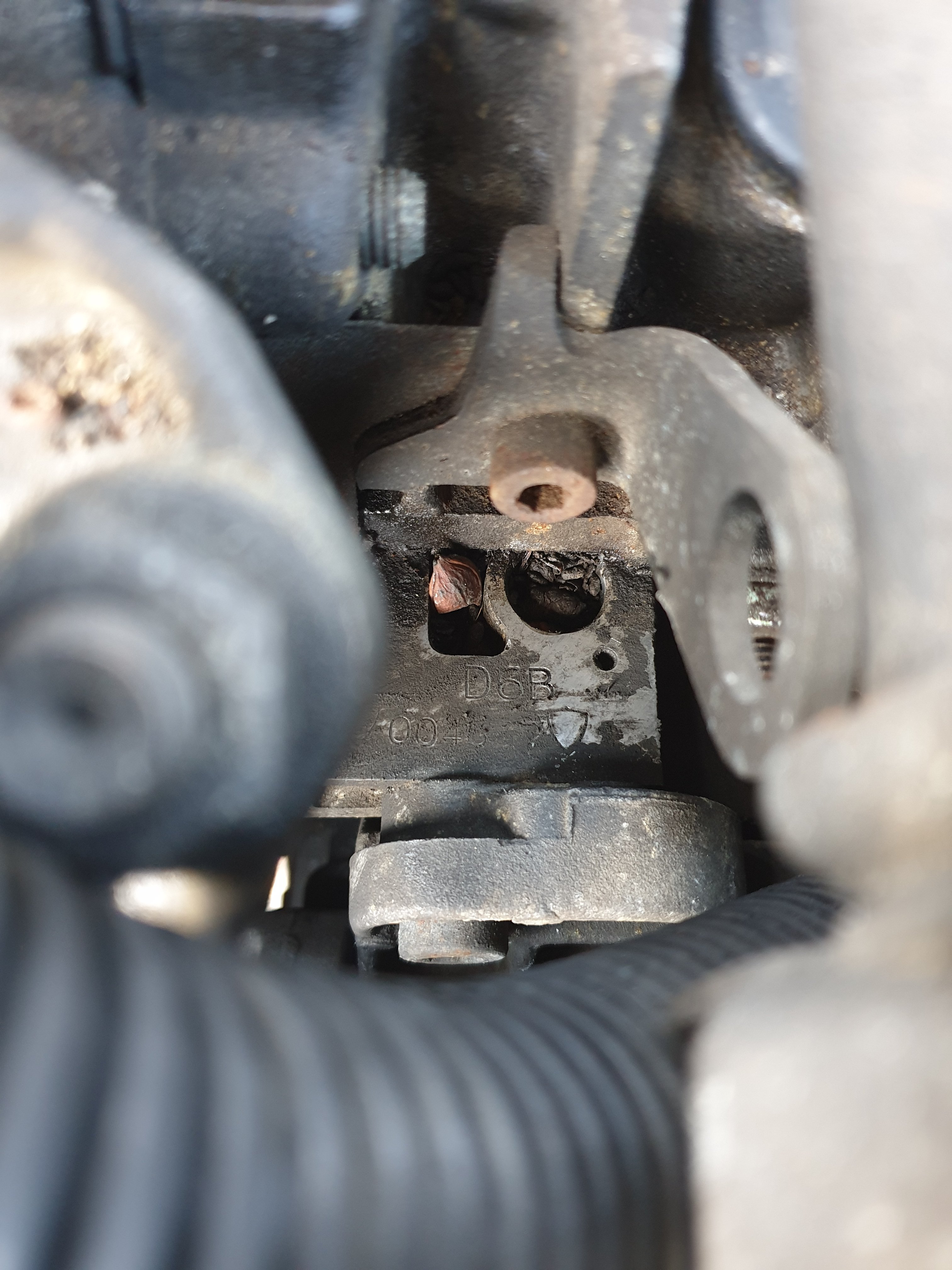

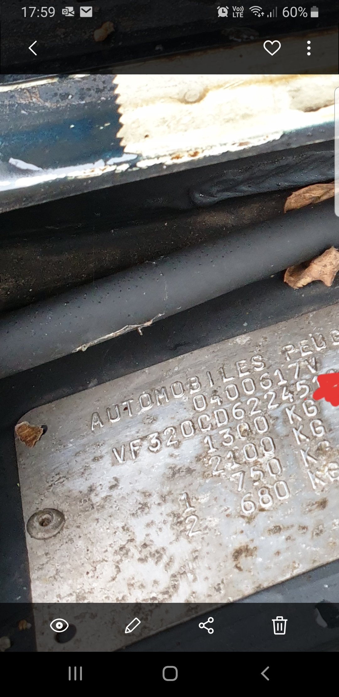

Sorry for slow reply looked for an engine number earlier and all I can see is this,no riveted tag or I cant find it yet it say D6B engraved on block where it meets the head
And yes Telf I'm rushmere so not to far
Edited by Darren

The paint code on the front panel is MORM so I think colour of ar and carpets is right
It also has another code above vin could anyone tell me what this means please
