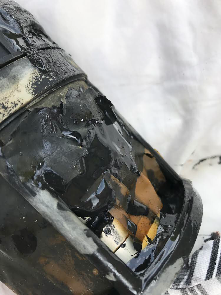

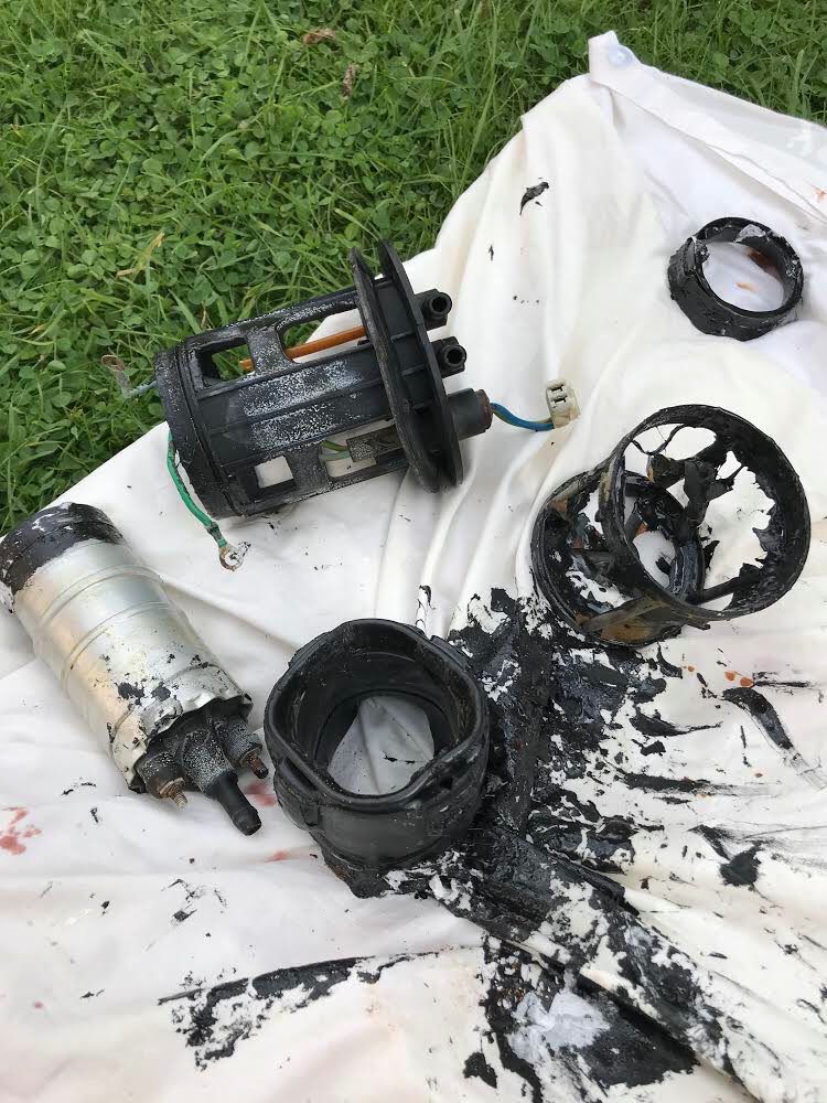

The car still wouldn’t run so I checked the voltage at the fuel pump. It was around 7V which seemed low to me. When I pulled the pump I found the rubber boot that holds it in place had turned to liquid and the strainer that clips on the bottom of the housing had turned brittle and fallen into the tank (pictures attached) - I’m assuming some reaction with stale fuel in the tank?
I tried and failed to source a phase 1/1.5 fuel pump housing so as a temporary measure I cleaned up the existing and replaced the actual pump with one that I removed years ago that worked at the time. I drained the tank and removed the debris and refitted the pump together with fresh fuel.

It's ethanol in fuel that is doing this. I helped Jeremy on here resurrect his 205 a while ago and that's exactly what his pump was like.

Is the baffle the plastic sleeve in the tank that the pump fits inside? If so the old fuel has destroyed this too! Not having much luck here.
