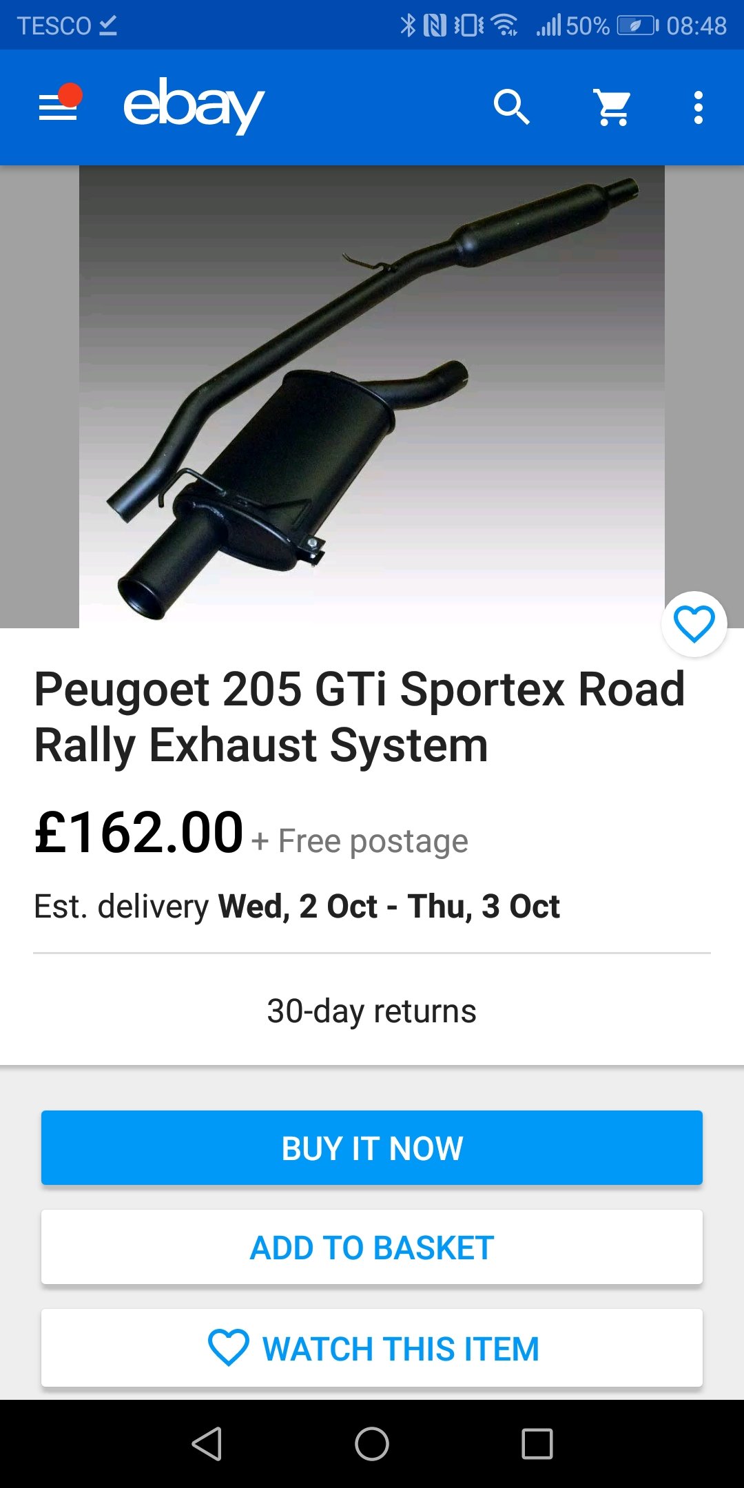

So after a week of much work by Kieran and a less than successful time at a local garage we have arrived at the conclusion that the exhaust system needs replacing and the MAP adjusting.
Kieran has supplied me with a stainless split/2pipe down pipe so now I need the rest of the exhaust.
I'm wondering if to go for a complete stainless system that a local place will manufacture at cost as yet unknown or fit a mild system off ebay.
See pic below... At £160 it seems reasonable. Any body had any experience with these systems or general advice as the best way to proceed?
Telf
Update the as yet unknown cost for the mid and rear section is £375-£425
jackherer
Sportex is cheap nasty tat...
You should be able to get a stainless system made for less than that but it will be loud, they always are.
Telf
ISC is cheapest locally . Other than that I guess a standard exhaust from a decent fitment place
