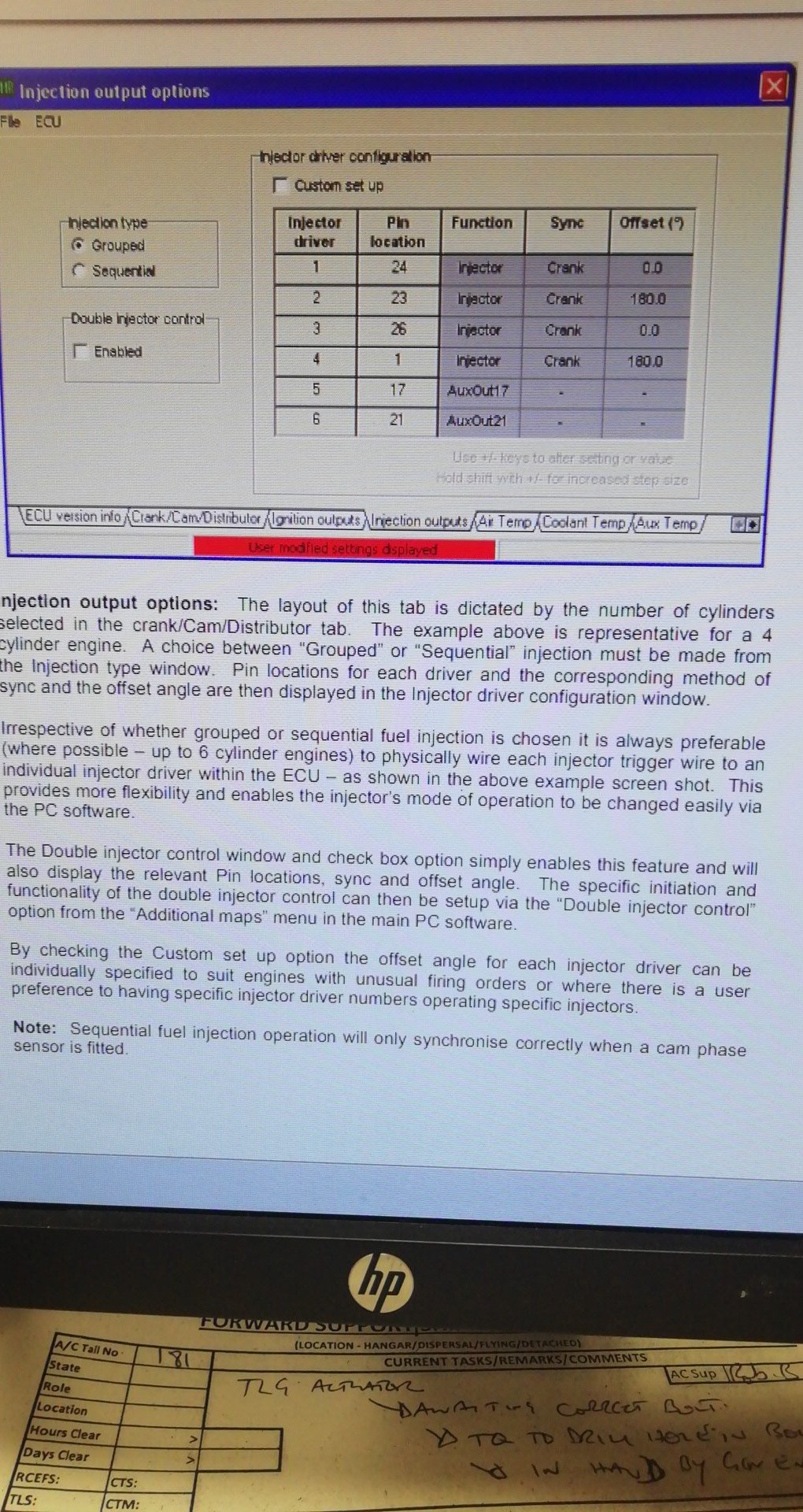

OK some updates;
I have not called Emerald yet, I'm trying to make sure I have answers for any questions they will have when they ask them.
Interestingly Paul's ECU runs absolutely perfectly in my car. I can connect to it with the laptop with the engine running indefinitely.
However it took a while to get it to run...
After triple checking the pin outs between the M3D and K3 I plugged the K3 into my loom and installed my map. Then I calibrated the TPS and inverted its operation as it is on the opposite end of the throttle shaft on my Jenveys and turns the other way.
Then I tried to fire the engine but it just coughed/spluttered/backfired. And incidentally made the whole area (inside the car, the driveway, in the garage, in the house) absolutely stink of petrol/exhaust fumes. As Paul said, how could it not?
I then compared settings between the two and noticed that Paul's ECU was set for sequential injection to four individual driver pins so I changed it to group and it ran. Badly but that was because it had fouled the plugs, new plugs and it was running on Paul's ECU just the same as it runs on mine.
This is potentially significant because Paul's car obviously isn't set up to run sequential injection. The cam sensor was disabled in the software so it can't have been trying to run proper sequential injection but the injector driver settings are obviously having a large effect as my car wont run when it is active.
Both of our looms are wired to run the injectors in 2 groups of 2. But Paul's ECU thinks it is triggering them individually so I guess it is pulsing two of them when it thinks it is pulsing one and at other times it is pulsing none when it thinks it is pulsing one. I wonder if the timing of the pulses is resulting in the bad mixture at certain RPMs?
I still don't get how it works at Emerald and changes afterwards.
I also don't know why it is disconnecting the laptop only in Paul's car.

Maybe, see my comments above, it wasn't set to batch fire despite being wired that way. (Actually group fire, two groups of two, but definitely not sequential)
Kieran regarding the sequential firing/batch firing of the injectors- surely this is a major issue?

The injector firing doesn't matter that much, it still can be setup properly if they fire the two injector pairs at the same time. I mean the standard managment fires them all four at the same time, four times per 2 crank revolutions.
Only thing I can imagine is that since the injection charge is double as big, with less time to evaporate you will get bigger puddles, which could lead to bore wash, but that is all speculation and cannot be determined from here behind my keyboard. I reckon the oil must smell very "petrolly" as well then.

2 hours ago, jackherer said:
Regarding the sequential/grouped setting he didn't think it would make any difference because it was mapped with it set (and wired) that way
Kieran I'm not sure about this. As you have said the injectors are wired as a pair . They aren't sequential in anyway. I mean if the ECU is trying to fire sequentially it seems to me it's going to miss a cylinder every so often . Surely this would account for the fuel smell due to non detonation and therefore the lamda being all over the shop.  If I understand the meaning in terms of the management then sequential the ECU is triggering the correct injector/coil signal so 4-2-3-1 or whatever but if the injectors are wired as a pair which we know they are then the injectors must be triggered as a pair .  Dunno how that effects the coil but as it's a wasted spark then it occurs to me that the coil is also wasting one 'spark' . I don't know how that would interact with a sequential injector sequence when they are paired as per the diagram.
That probably makes no sense but I'm trying to puzzle it out
So looking at the diagram my loom is built exactly like yours. Do I need 4 separate injector signal lines from the ECU? Does our fuel system differ between the MI16 and the 8v ( as in mine is a common fuel rail ). I'm wondering if I've blindly followed your diagram and missed a vital point.
When your ECU thinks it's triggering the injector for cyl 1 it's actually triggering cyls 1&4, then when it thinks it's triggering cyl 2 it's actually triggering cyls 2&3. And while it thinks it is triggering 3 and 4 there is nothing connected. If you consider that the standard Jetronic injection actually just fires all 4 at once I don't think it actually makes a huge difference but the bottom line is it was mapped that way so it must have fuelled OK with those settings while at Emerald.
The coils wasted spark occurs during the cylinders exhaust stroke so there is nothing left to ignite.
No, yours is wired correctly, you only wire the injectors individually if you are running sequential injection and that requires a cam position sensor which isn't feasible in your engine or mine.
Our fuel systems are basically the same, the only real differences between your engine and mine is 8 extra valves and 3 extra throttles.
Ok so post our chat earlier regarding the whole sequential versus group option for the injectors. If the map is set to sequential as you noticed it clearly says in the Emerald manual 'sequential fuel injection operation will only synchronise correctly when a cam phase sensor is fitted'
I've also searched a bit more online and there are a few mentions in various tuning forums that state sequential injection is only really relevant at low rpm (below 2500rpm) and then as rpm increase it becomes less important.
This seems to fit with the issue somewhat. They have definitely mapped it on sequential and yet the car is physically set up as a grouped pair.
The ECU is set to sequential but it is not wired for sequential so it is not actually running sequential. And that is how it was mapped.

That's not the point mate. If the software is set to sequential it will be trying to operate in that mode. So think about it . The software is trying to operate in that mode and is driving the injectors. At the same time it's looking for a cam sensor signal that it isn't receiving and therefore it won't synchronise, result:Fueling is out  and we get mad AFR figures.
Now when you drive it it's fine but it's now in the high 2000 rpm band at least . Sequential now doesn't matter and it appears to drive ok.
The person you spoke to earlier said it didn't matter if the ECU is in grouped or sequential but he probably doesn't realise I don't have a cam sensor etc. Essentially he has never seen the car!
Added to that could he ECU be crashing the laptop connection because it doesn't see the Cam sensor input? It ran fine on your car but it had your Map installed that we know is 100% correct
The cam sensor is disabled in your ECU and always has been.
I'm not quite sure what the Emerald is doing when the injectors are set to sequential but it is configured to only use a crank sensor as it is an impossible configuration, sequential requires a cam sensor. (technically I think it is possible to run sequential without a cam sensor with some ECUs but starting the engine is literally 50:50 every time, sometimes it will be synced, other times it will be 360 crank degrees out.)
Having it set to sequential with no cam sensor obviously does something because my car wouldn't run that way but it isn't actually running sequential.
Also don't forget I have seen your injectors firing into a bucket and it was definitely a logical group fire pattern that I was seeing (not that I was thinking of that at the time)
This definitely does not explain why my laptop is being disconnected! And anyway the cam sensor is turned off in your ECU.
