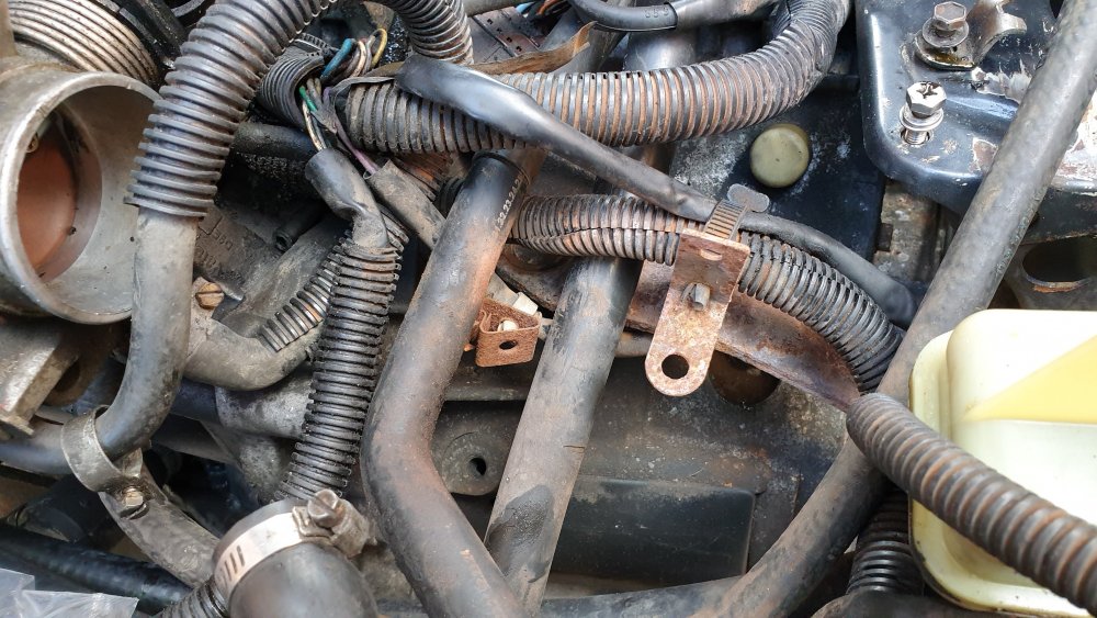

Hi all,
I'm in the process of renewing all pipes in the engine bay, including a new stainless steel intermediate water pipe in the driver's wheel arch.  All from BakerBM.  Anyway I've come across a couple of cables with clips attached but I can't see where the clips should attach. Can anyone shed some light on this please? I've attached a picture of them.

The left hand rusty  clip pushes on to the casting rib of the gearbox next to it, it is sprung and barbed to be a pushfit and holdtight. Its to hold the reverse light switch cable out of the way of the clutch operating arm.
Thanks! I like everything to be in its place. I'll take them off, clean them up and paint them first.
