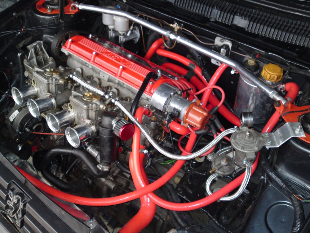

Porter87 18 Posted August 14, 2019 (edited) I understand what you mean see below for an example ha-ha, also keep in mind this was 10 plus years ago so 205’s were cheaper, dont hate me for ruining the standard model haha First 205 when purchased First 205 with mission creep What i want is a standard looking 205 with more poke keeping the original mi16 ecu and injection, im even considering putting the 1.6 wheels back on to be honest. I've done the big power and as much as i enjoyed the noise and poke the car just became too much to use on the roads (mission creep fail). i'll look forward to the meeting monday! Edited August 14, 2019 by Porter87 Share this post Link to post Share on other sites
Andy 105 1 Cars Posted August 14, 2019 Impressive work, but I see what you mean. Andy Share this post Link to post Share on other sites

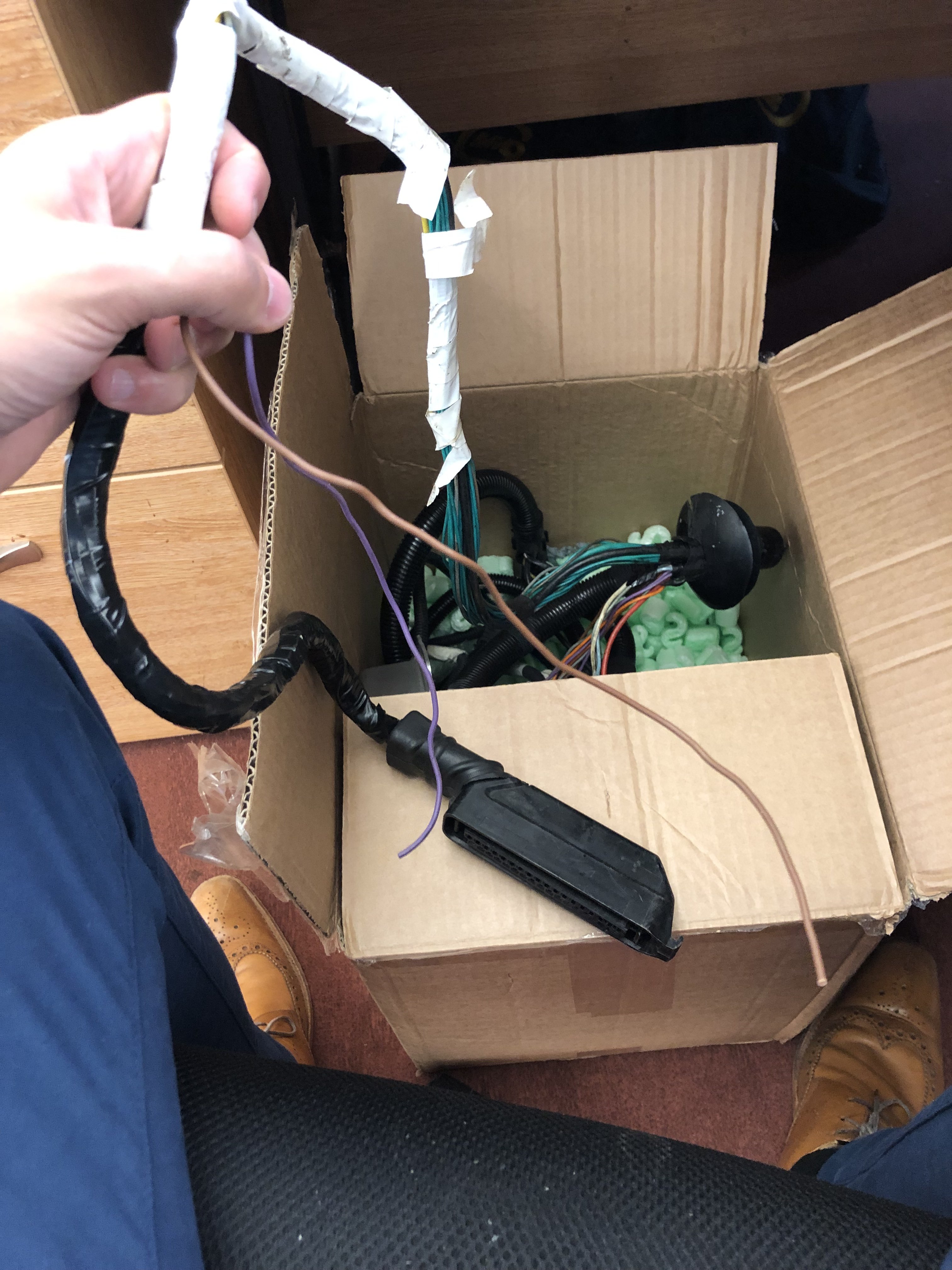

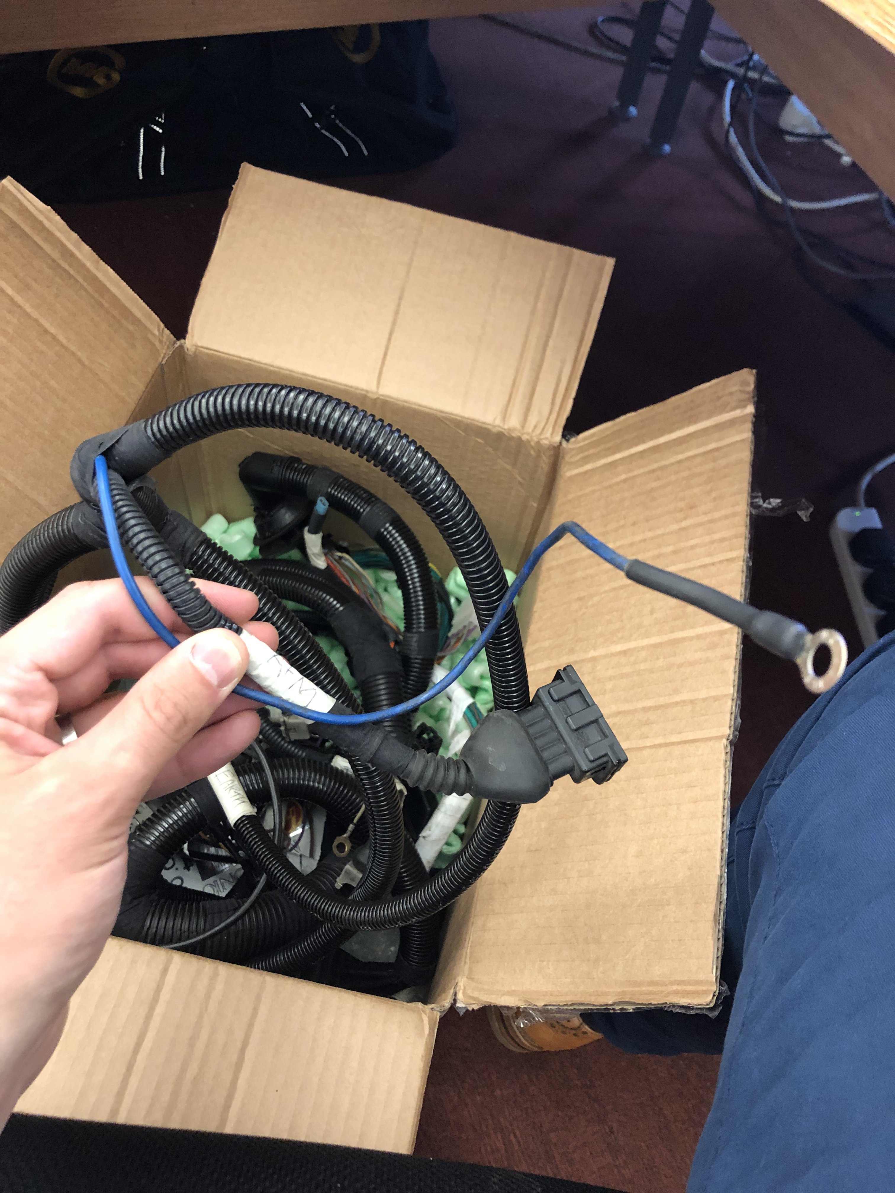

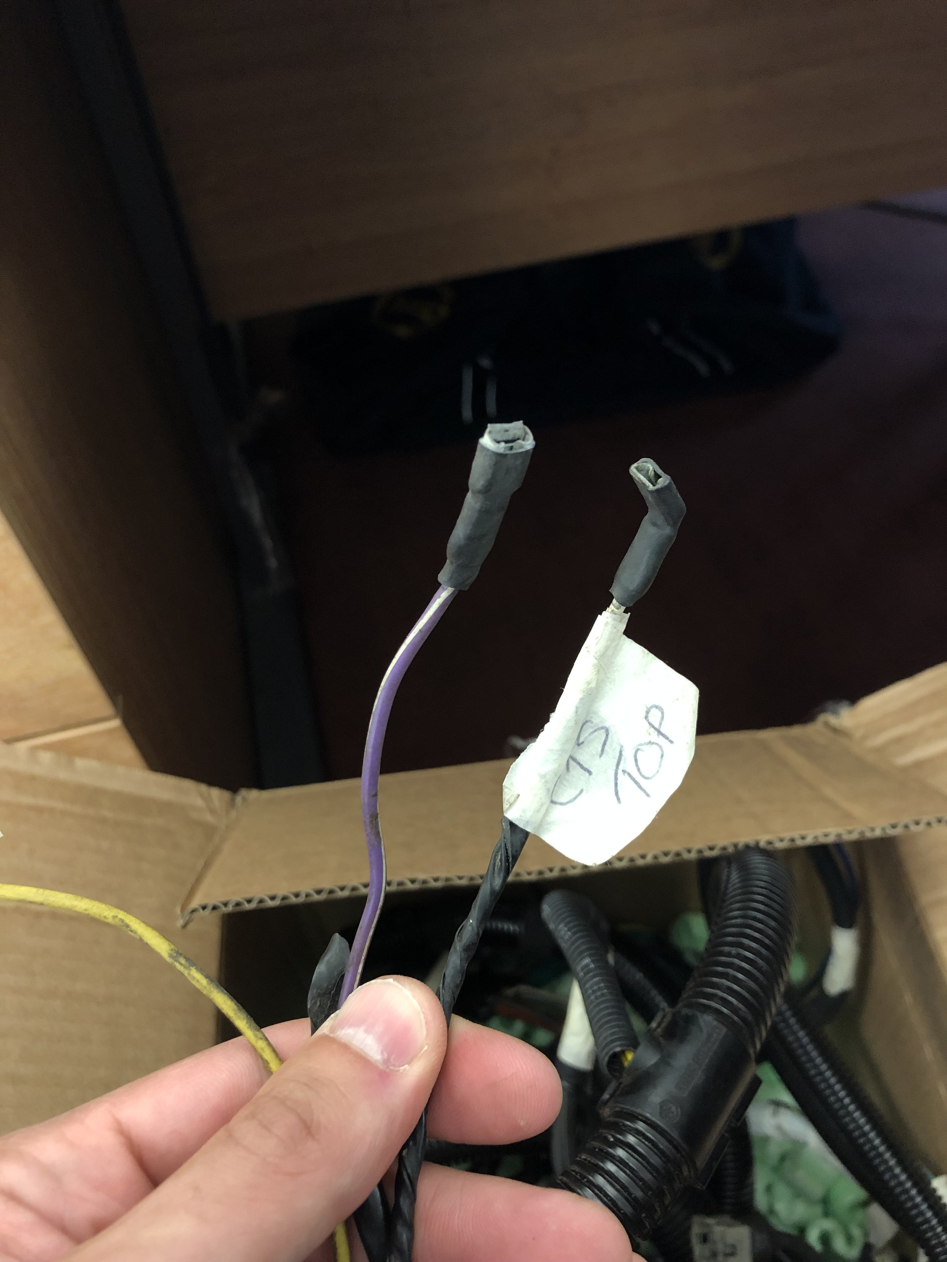

Porter87 18 Posted August 21, 2019 Mi16 Loom all sorted now. Everything labelled up other than these two wires (purple and brown) Anyone have any any idea what they are??? Cheers Share this post Link to post Share on other sites
welshpug 1,675 Posted August 21, 2019 what are the numbers on them/where does the other end go? Share this post Link to post Share on other sites
Tom Fenton 1,561 Posted August 21, 2019 I reckon they are the right colours for the reverse light switch wiring. Have you got a labelled plug anywhere else on the loom for the reverse light switch on the gearbox? Share this post Link to post Share on other sites
Porter87 18 Posted August 22, 2019 (edited) 14 hours ago, welshpug said: what are the numbers on them/where does the other end go? No numbers on them that I can see, they disappear into the loom. they come out of the ecu plug connection. They aren’t found lower down the loom from where the poke out. 13 hours ago, Tom Fenton said: I reckon they are the right colours for the reverse light switch wiring. Have you got a labelled plug anywhere else on the loom for the reverse light switch on the gearbox? Just checked the loom for a reverse switch label and nothings there. its looks like your right Tom, reverse light switch Also have these three not labeled? Thick blue wire Diagnostic port maybe? Purple/white wire next to CTS top Thanks again for your help guys Edited August 22, 2019 by Porter87 Share this post Link to post Share on other sites

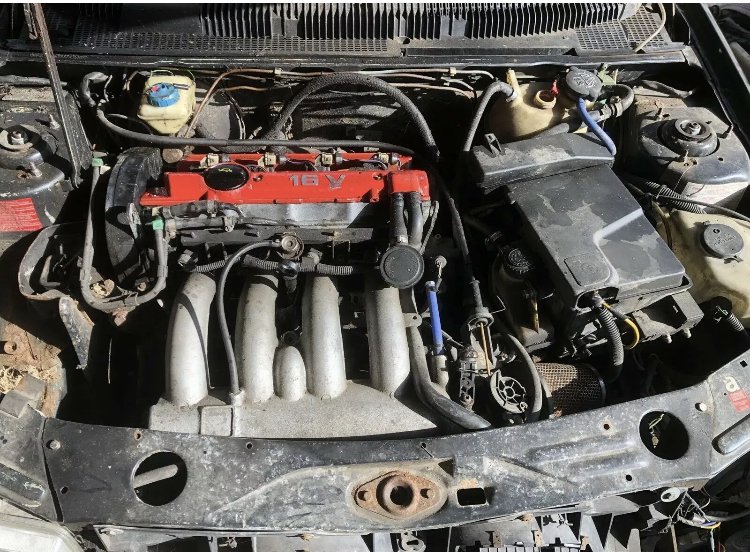

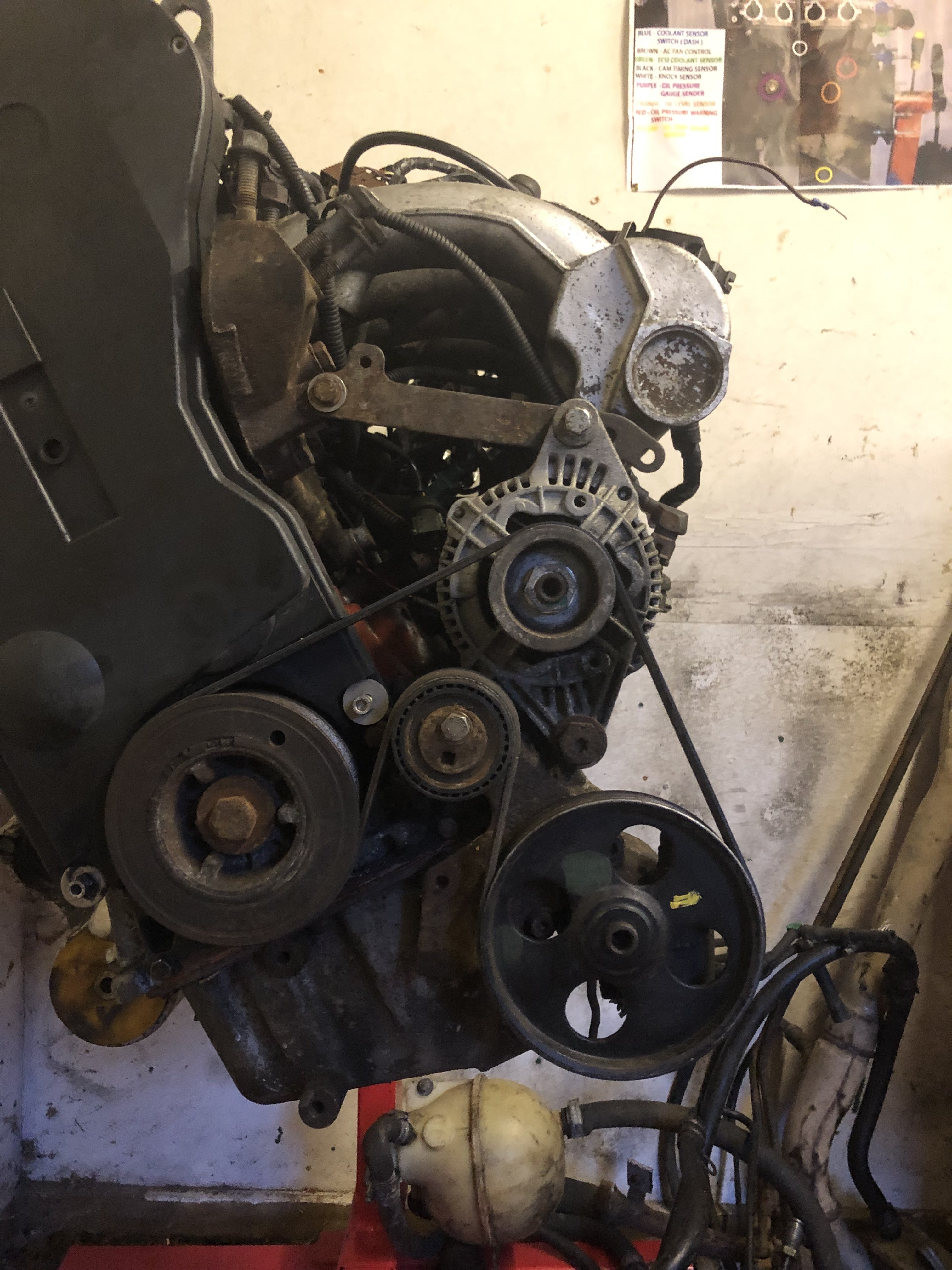

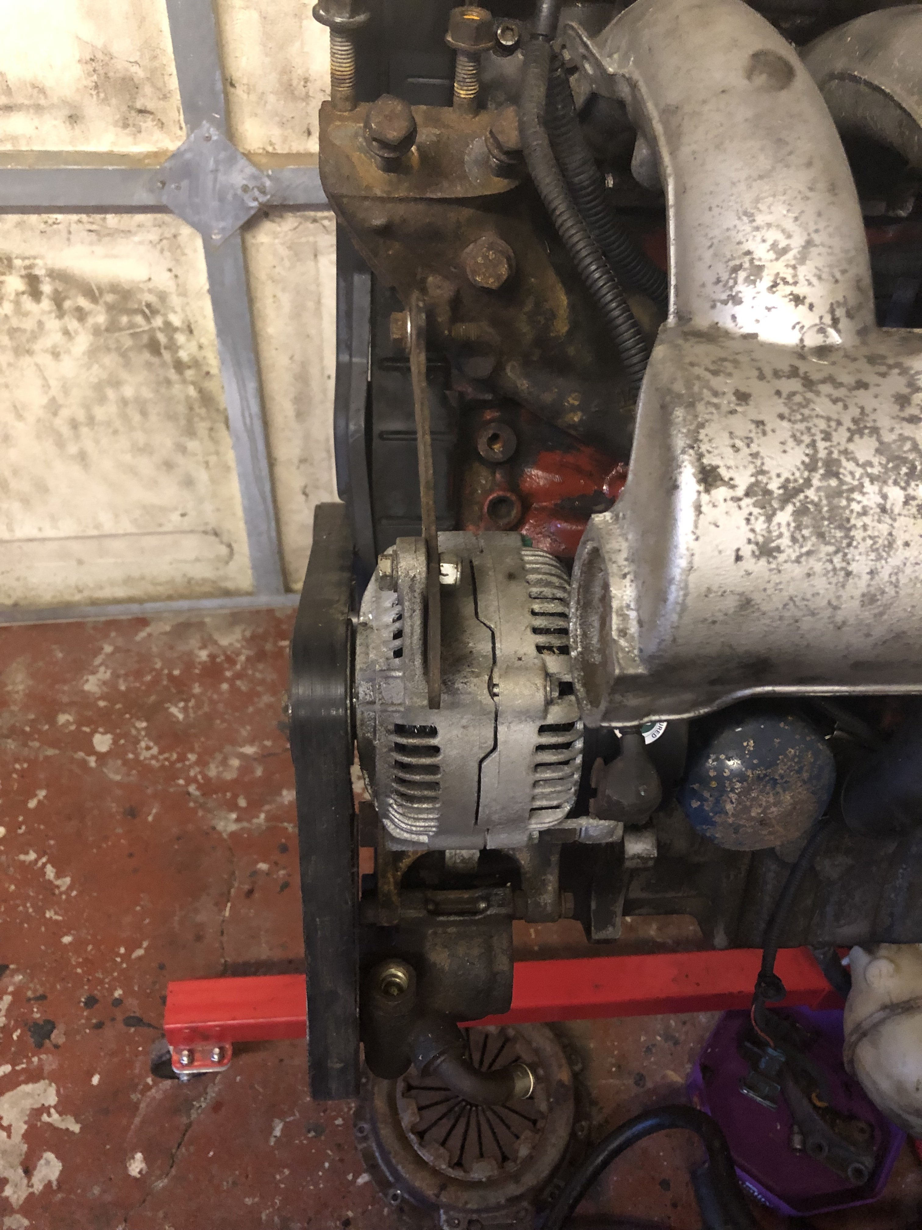

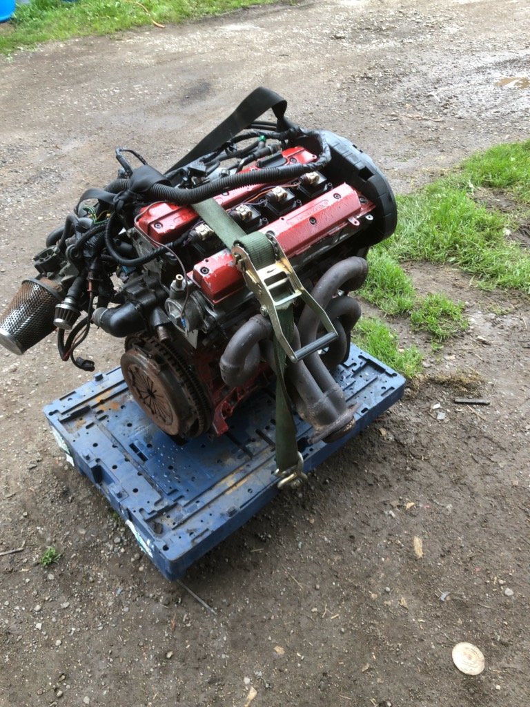

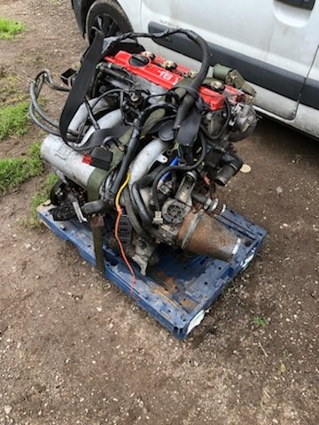

Porter87 18 Posted October 10, 2019 I finally got the gti6 engine on the stand. One thing I’ve noticed is my alternator position seems different to any reference ones I’ve seen? Can any shed some light one the position I have? Also how do I tell the difference between the vts and gti6 engines? Thanks Share this post Link to post Share on other sites
welshpug 1,675 Posted October 10, 2019 (edited) thats an s16 bracket setup, quite a bit lighter, looks like a diy steady bar, it should have a step in it, yours doesn't and its a bit wonky, could potentially break the lug on the alternator. its using a timjng belt tensioner not the original s16 sliding type though Edited October 10, 2019 by welshpug 1 Share this post Link to post Share on other sites
Porter87 18 Posted October 10, 2019 21 minutes ago, welshpug said: thats an s16 bracket setup, quite a bit lighter, looks like a diy steady bar, it should have a step in it, yours doesn't and its a bit wonky, could potentially break the lug on the alternator. its using a timjng belt tensioner not the original s16 sliding type though Thanks Welshpug, I'm looking to take off the power steering pump, is there a better way to mount the alternator? I've found on here that I should use a 6PK700 belt (easy enough to get hold of) but I think the alternator position is incorrect? Thanks Share this post Link to post Share on other sites
Tom Fenton 1,561 Posted October 10, 2019 If you want my advice, leave the pump on and plumb the PAS up. Makes them much better to drive as the ratio on the PAS racks is shorter. Share this post Link to post Share on other sites
welshpug 1,675 Posted October 10, 2019 the alternator position is fine, you can make an adjuster to replace the upper strap/support using a 205 bolt and screw, add a slot to the bar and a return on the end. though like Tom suggests I'd keep it. Share this post Link to post Share on other sites
Porter87 18 Posted October 10, 2019 Cheers Tom/welshpug, Ah that’s good to know the alternator is ok where it is. Only reason for looking to remove the PAS is that it plays up ever now and again. Sounds like darth Vader has taken over my steering when I’ve been out for a while. haha. I also didn’t mind my old 205 without the pas.... that was some time ago now though I hear people running the pas racks with all the bits removed? Not sure if this is any good or not? Share this post Link to post Share on other sites
Tom Fenton 1,561 Posted October 10, 2019 I don’t personally like pas racks without the power, to be honest I think every 205 is better with pas. The issue with yours could be that the existing pump is old and tired. 1 Share this post Link to post Share on other sites
petert 607 Posted October 10, 2019 (edited) The alternator strap would be better it were on the other side of the alternator, with an appropriate width spacer between strap and block, in order to keep the load perpendicular. Having said that, get PAS anyway you can. Edited October 12, 2019 by petert 1 Share this post Link to post Share on other sites

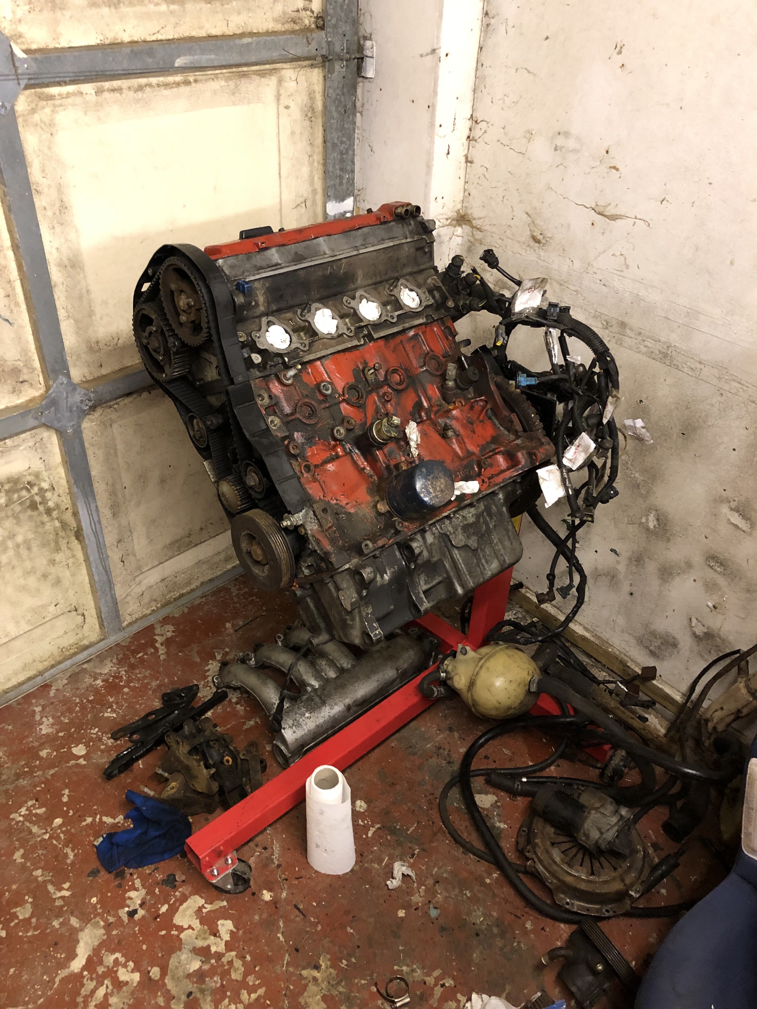

Porter87 18 Posted October 11, 2019 18 hours ago, Tom Fenton said: I don’t personally like pas racks without the power, to be honest I think every 205 is better with pas. The issue with yours could be that the existing pump is old and tired. Noted, I'll look to replace the pump and get new lines made up. keep things tidy 14 hours ago, petert said: The alternator strap would be better it were on the other side of the alternator, which an appropriate width spacer between strap and block, in order to keep the load perpendicular. Having said that, get PAS anyway you can. good Idea! Thanks Peter. I have a couple of old spacers that will do just the job. Started to strip back the engine ready for paint and a general tidy up Share this post Link to post Share on other sites
