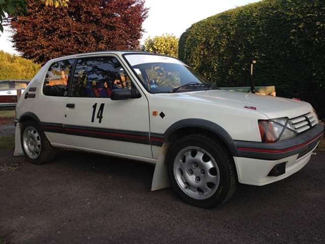

I brought this little gem a couple of years a go to have a go at some 12 car rally and other advents that my local motor club, as some people from drivers see on my Facebook account me doing bits and bobs I thought it was time to put a thread up as there is not much going on.
How car was

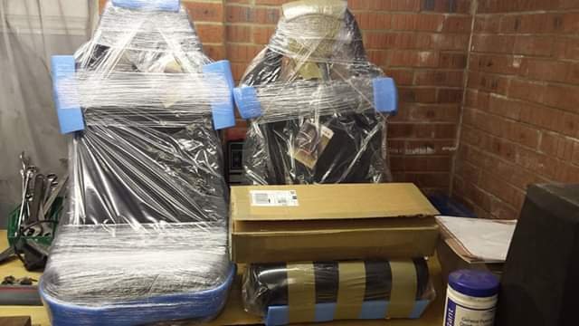

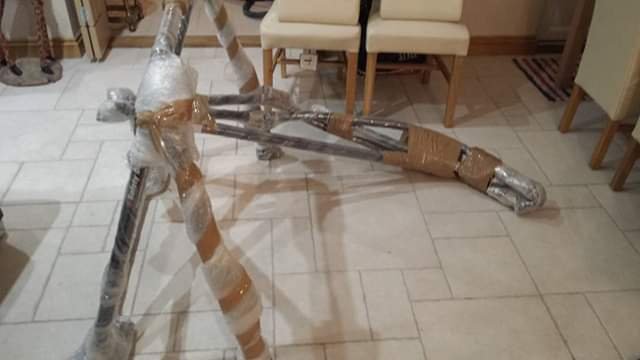

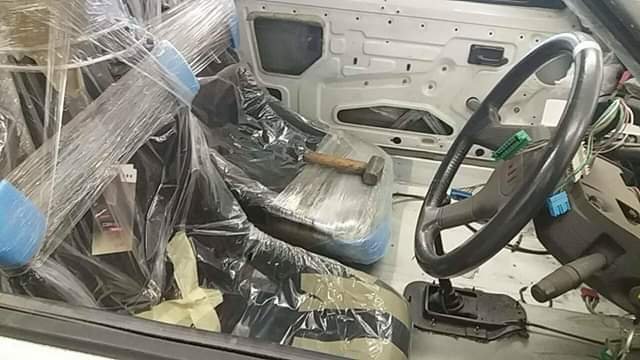

Cage and seats I brought

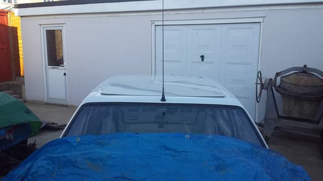

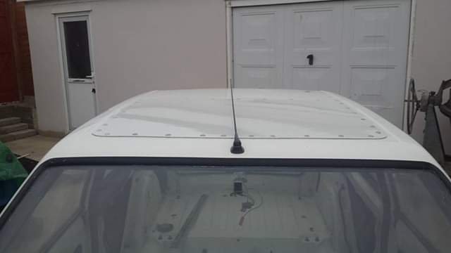

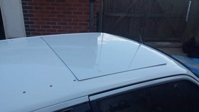

I decided to plate sunroof

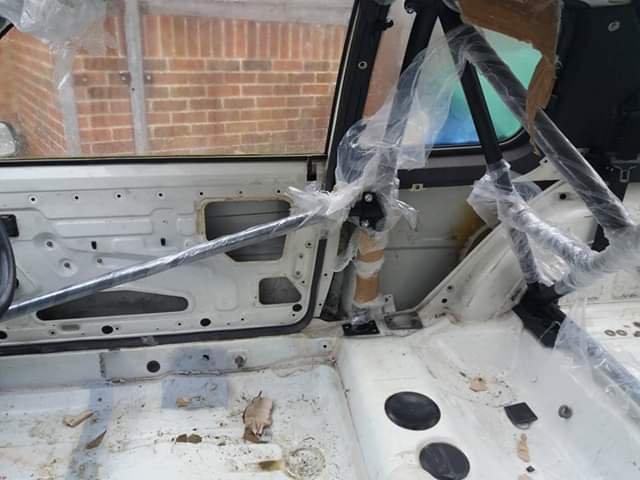

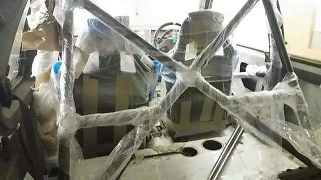

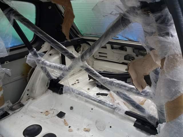

Test fit of cage and seats and mounts put in

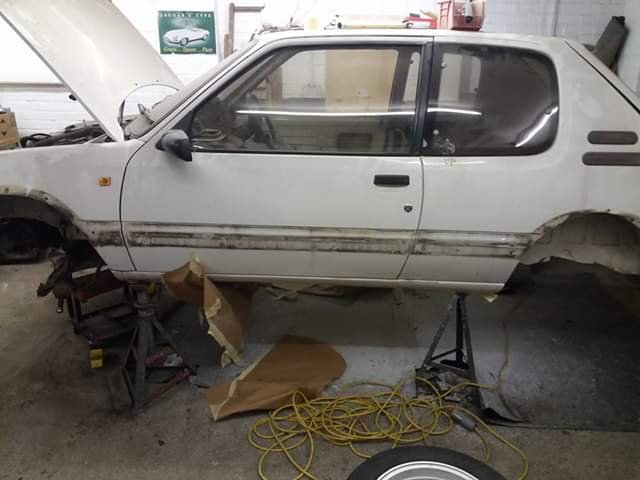

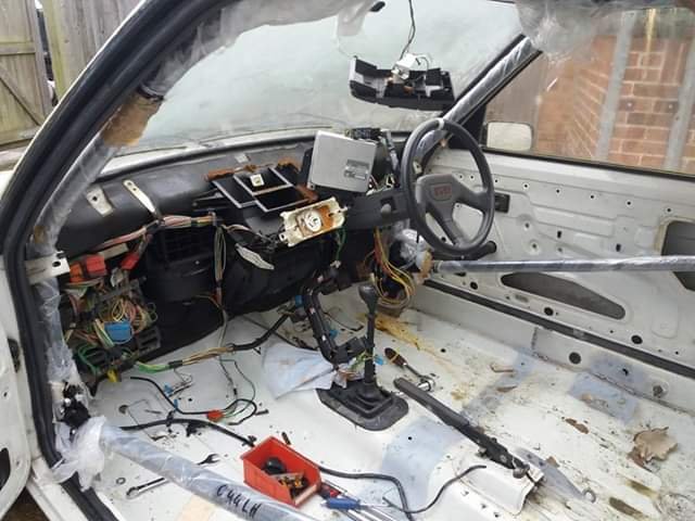

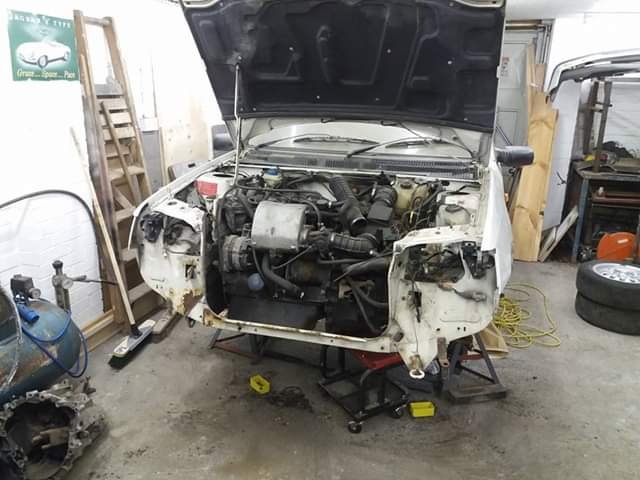

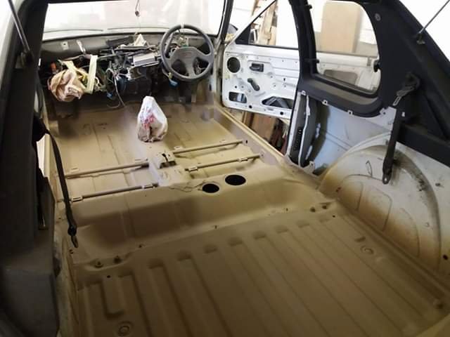

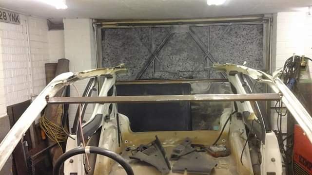

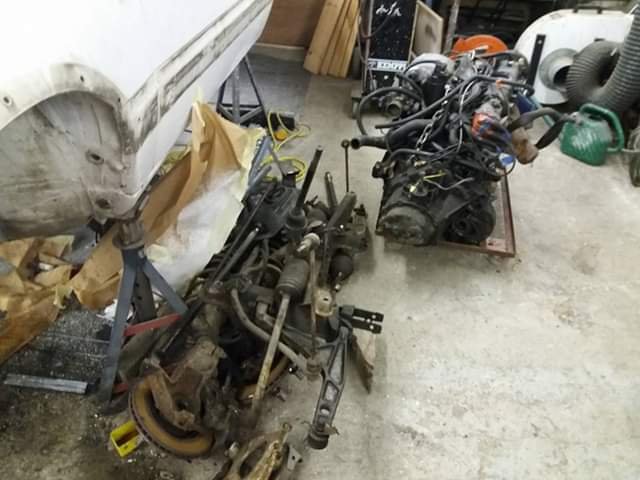

Strip down of car
dale205mills

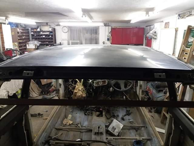

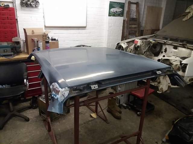

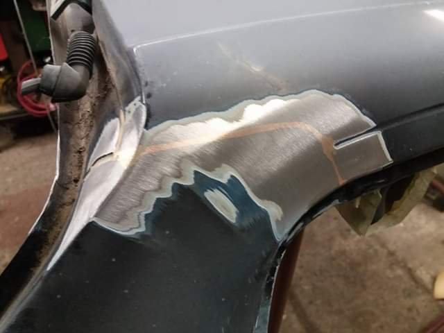

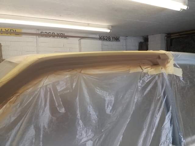

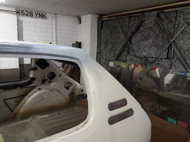

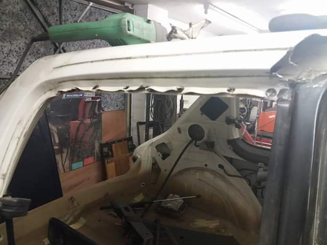

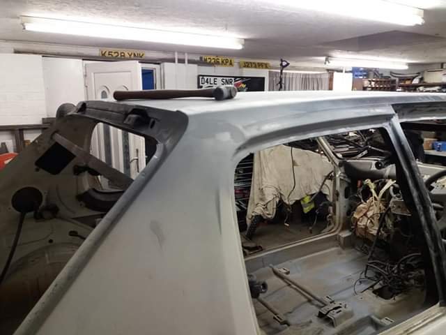

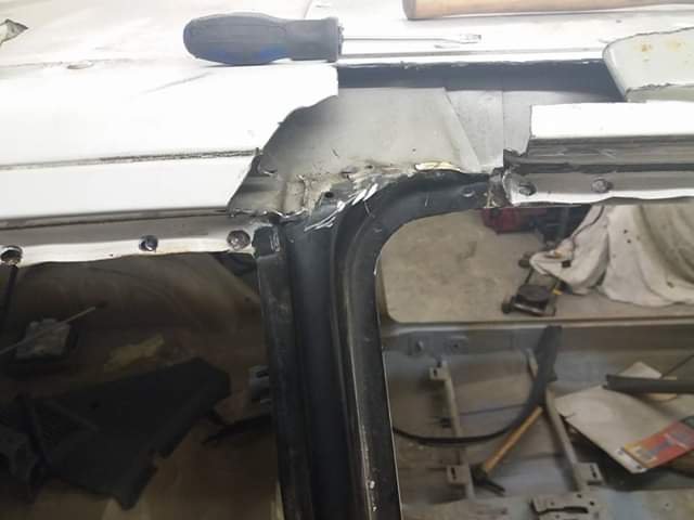

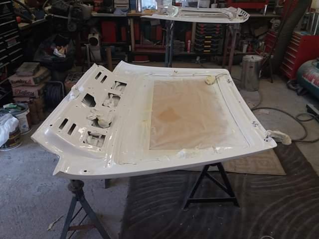

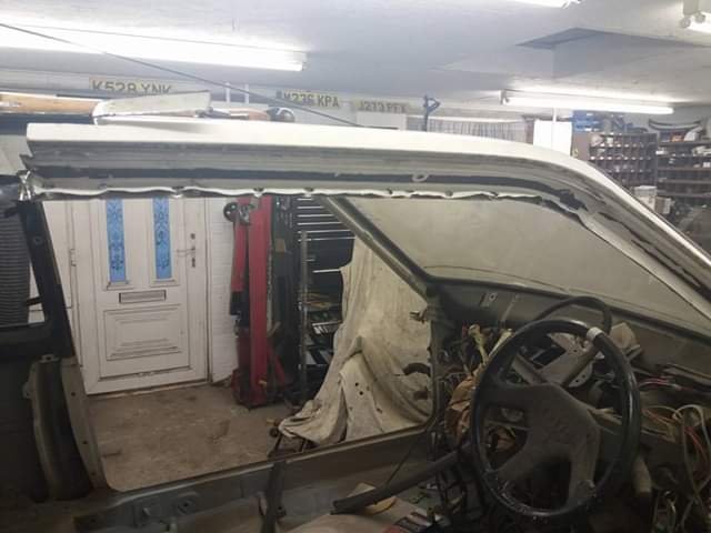

I then had the bright idea of swapping the roof skin that was done in about a day and a half with great help of photos from fellow members threads
dale205mills
New roof on and tidy of joins

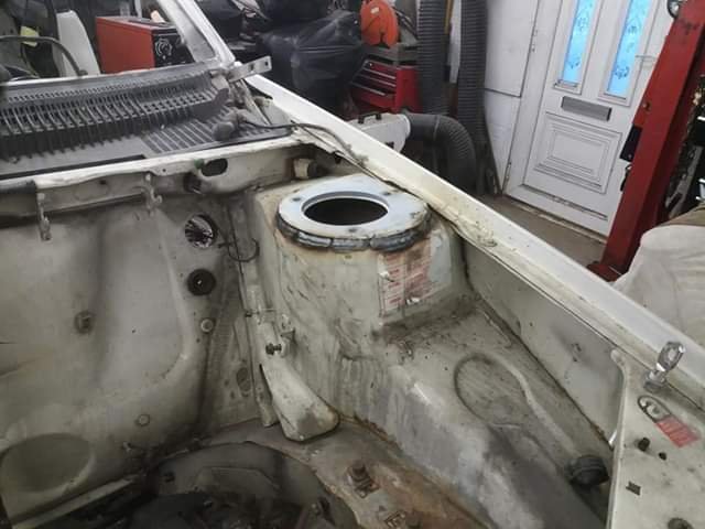

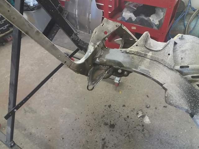

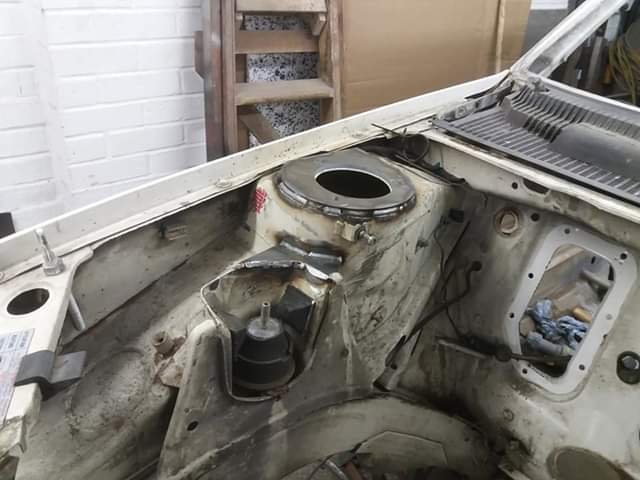

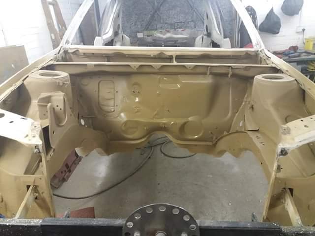

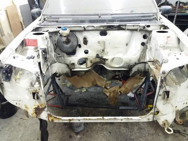

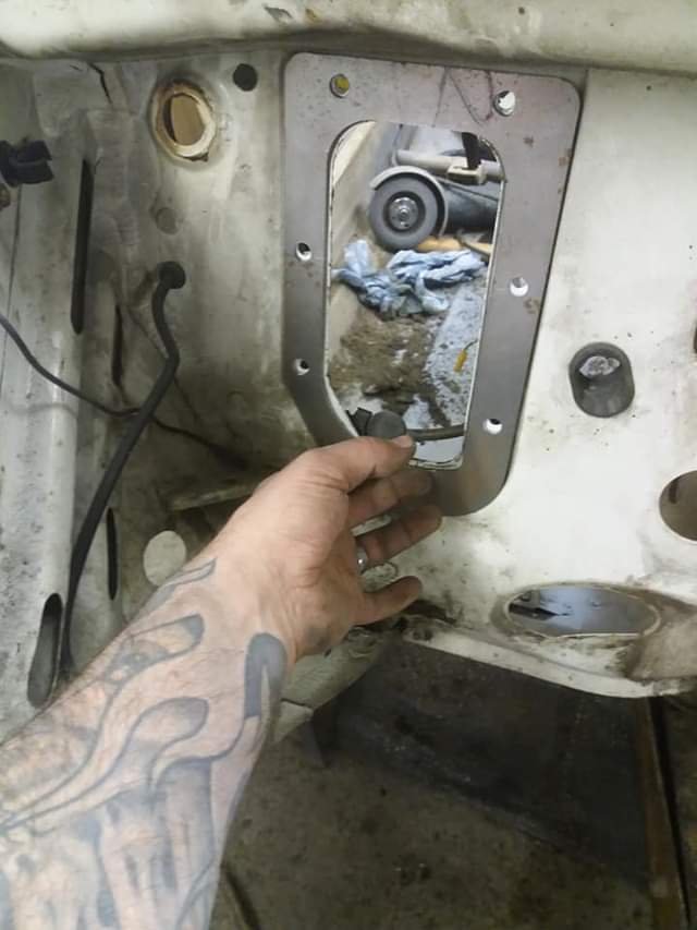

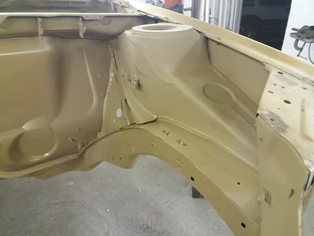

Engine bay strength plates
dale205mills

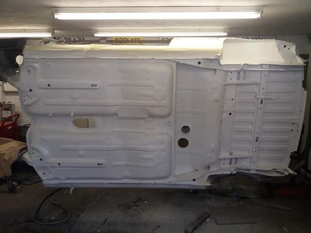

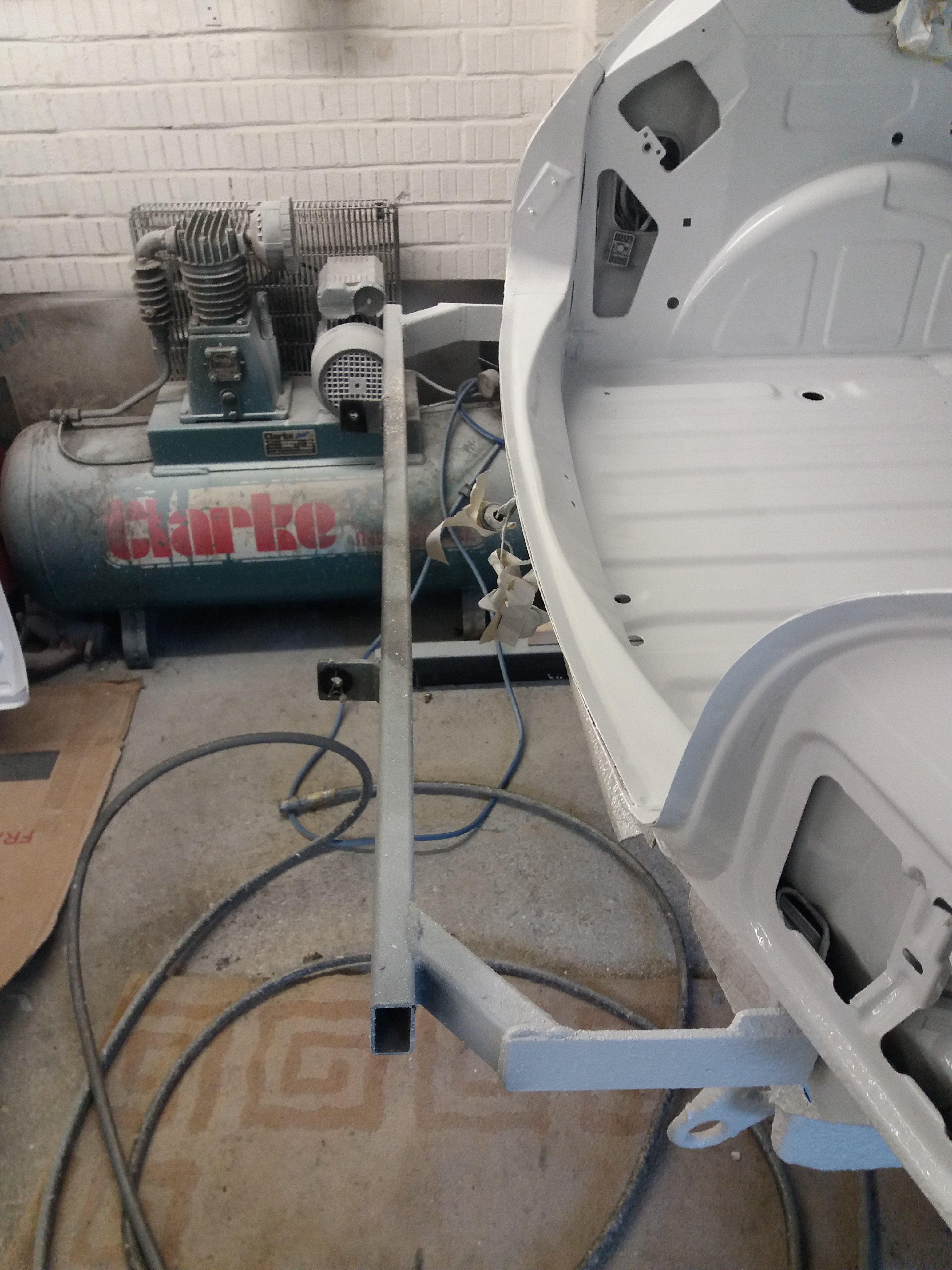

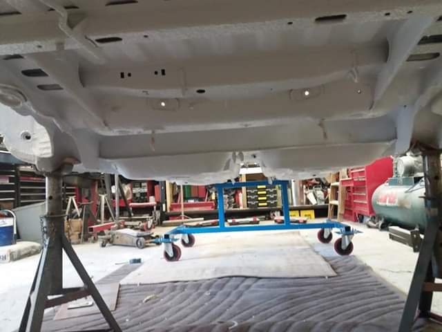

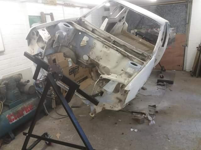

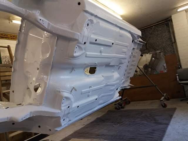

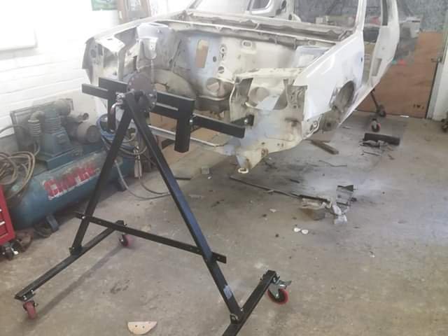

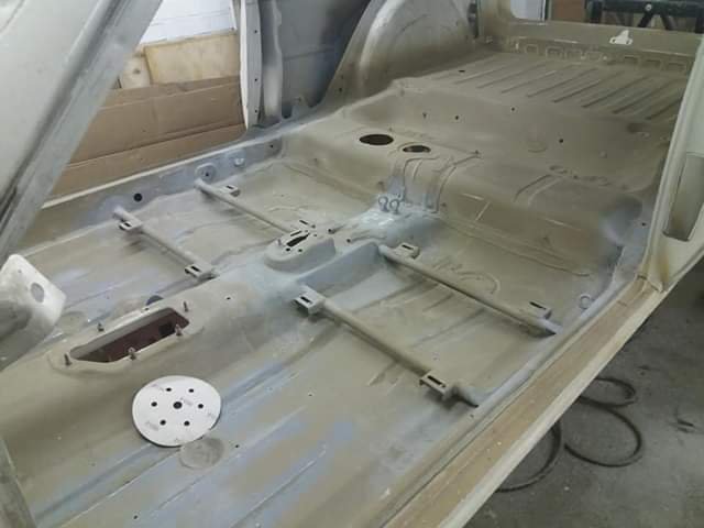

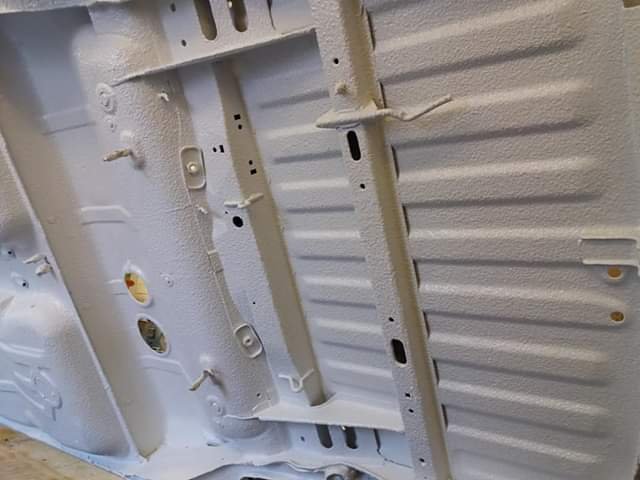

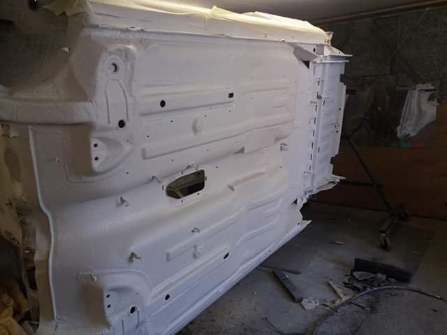

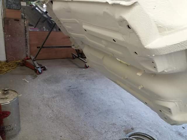

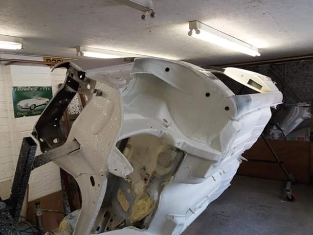

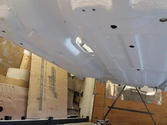

I decided to buy a roll over spit to do the underside, first job was clean and stone chip
dale205mills

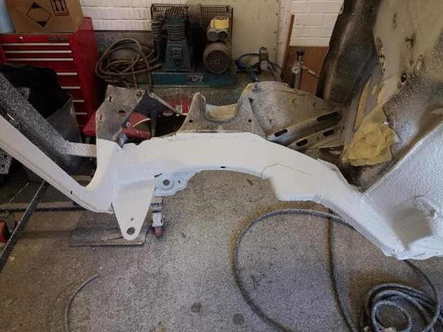

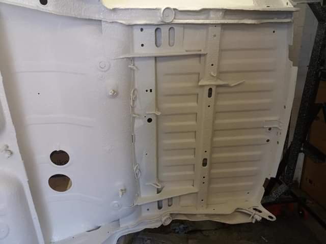

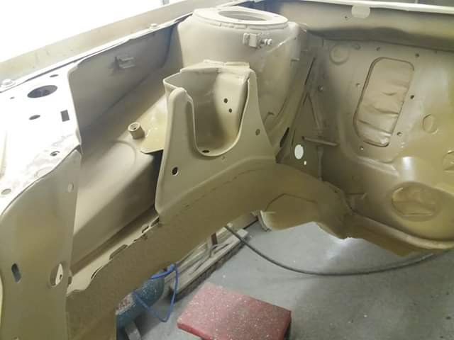

I had enough of looking at underside so engine bay tidy up, prime and sump plate bracket put in.
dale205mills

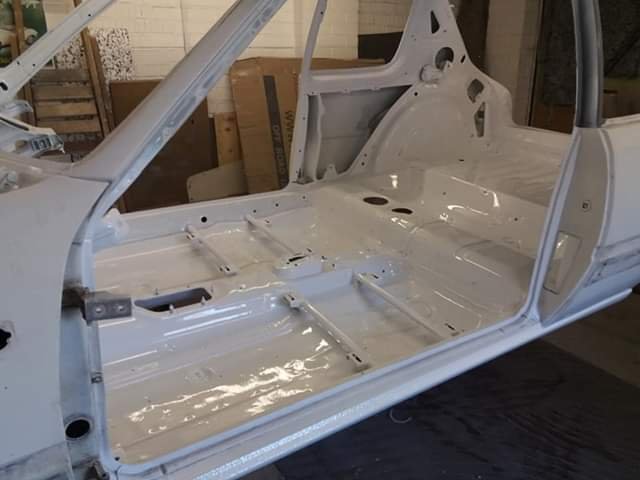

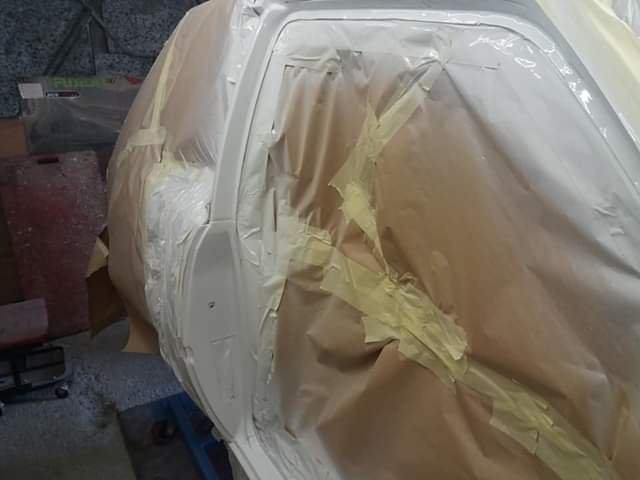

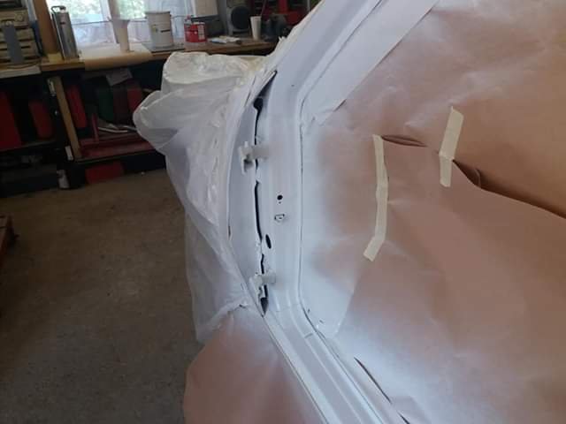

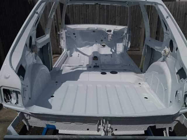

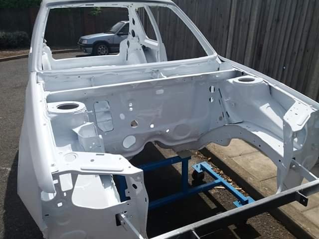

It was time to paint inside of car, underside and engine bay.

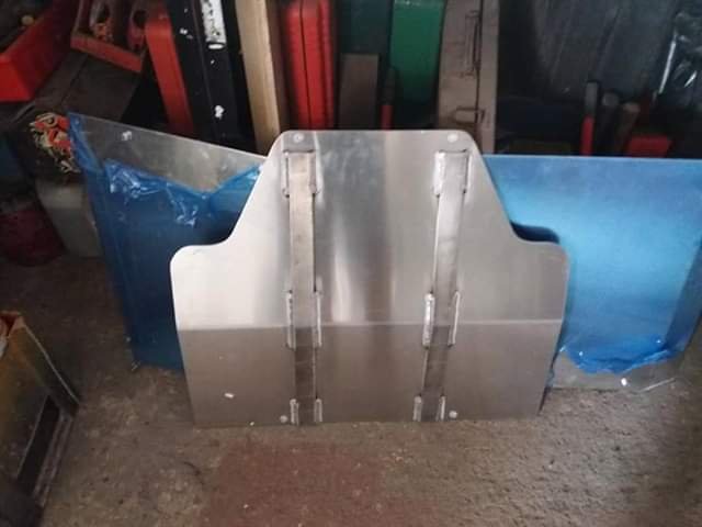

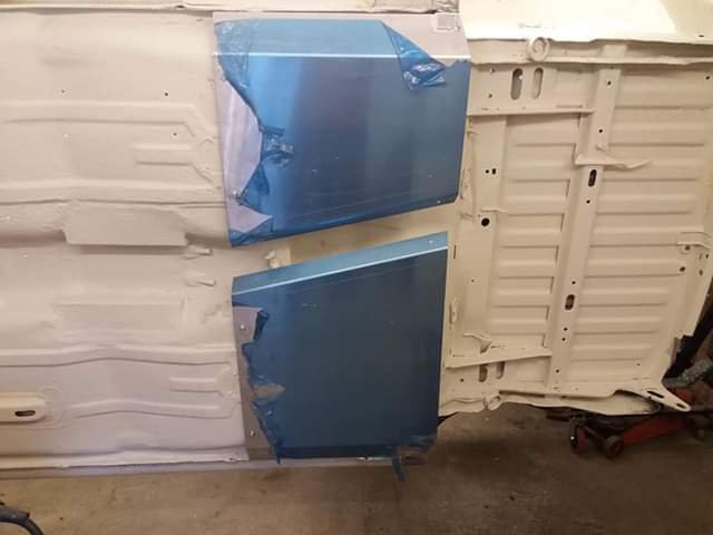

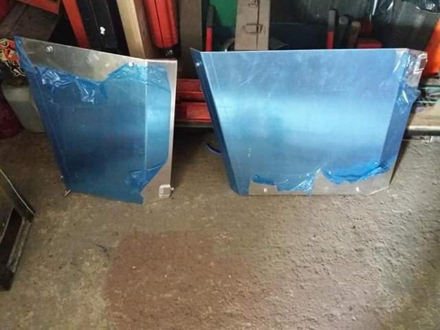

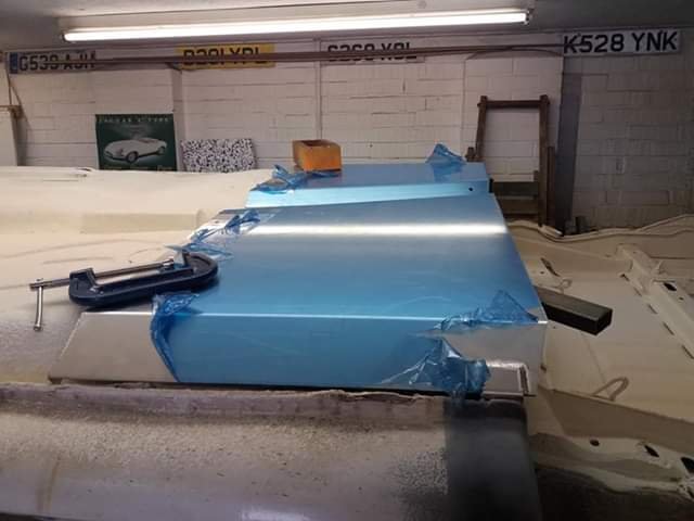

I forgot to put photos up of trial fit of tank gaurds
dale205mills

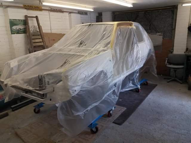

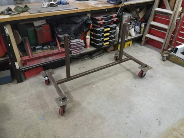

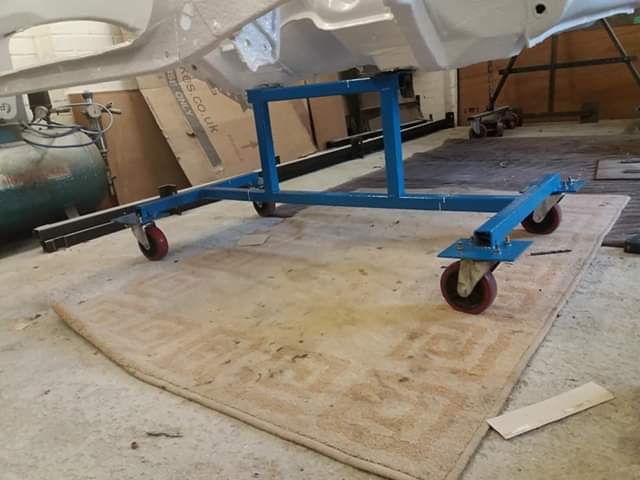

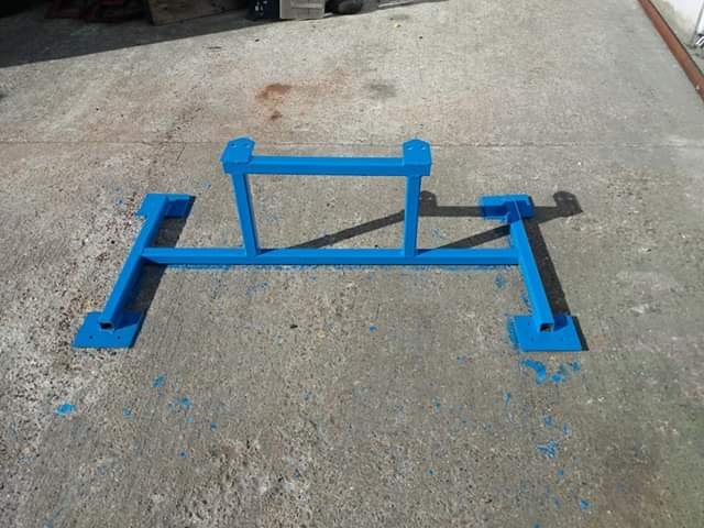

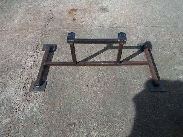

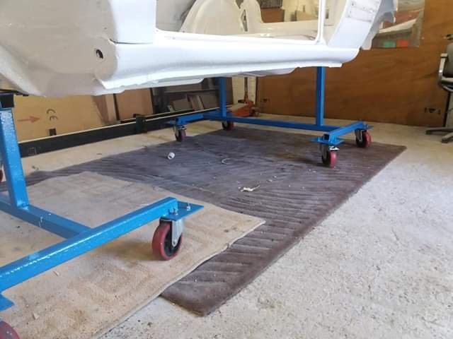

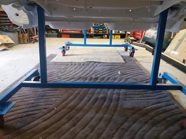

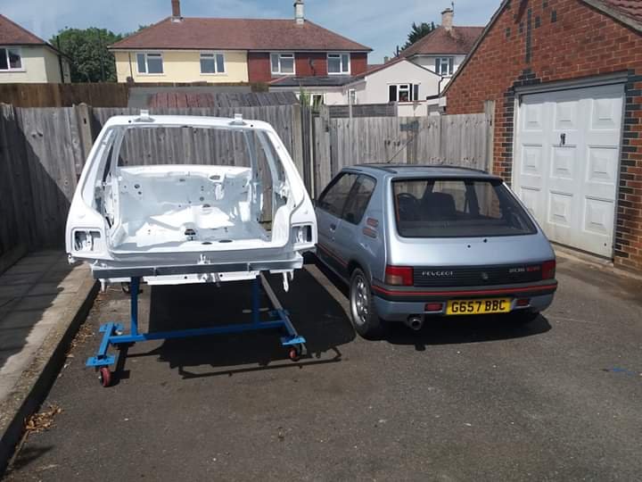

Nexted up was to make up some trolleys to move the shell about.

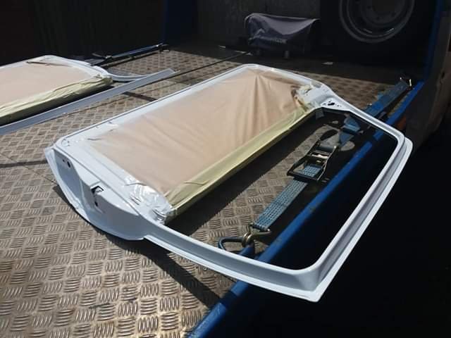

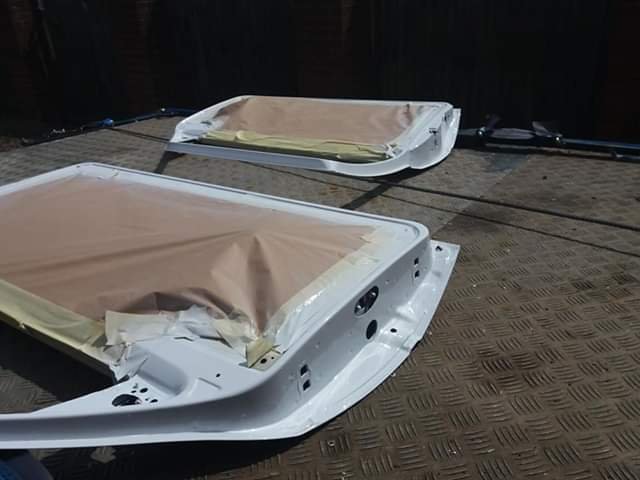

I moved onto door shuts and boot shuts
dale205mills

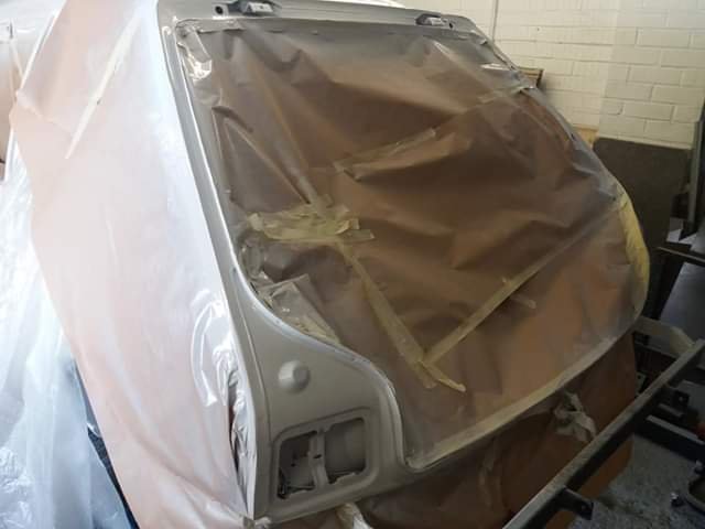

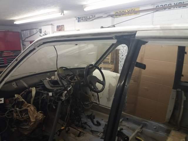

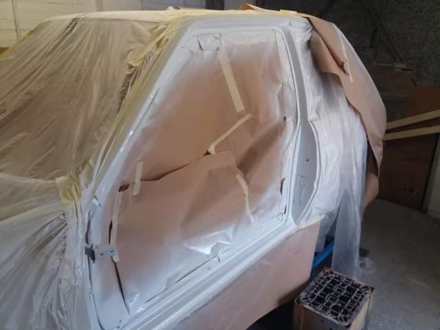

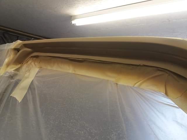

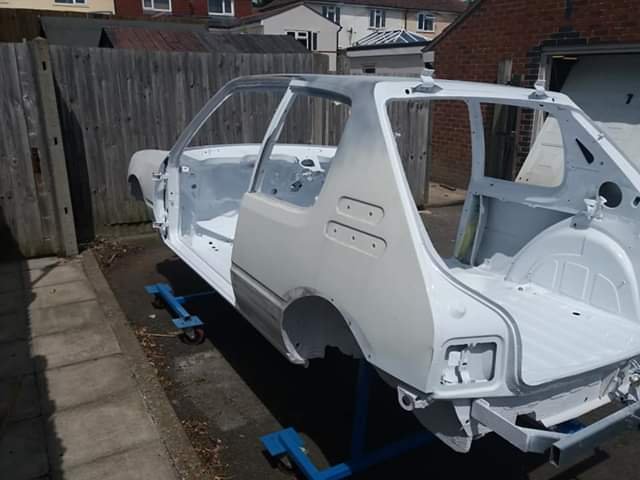

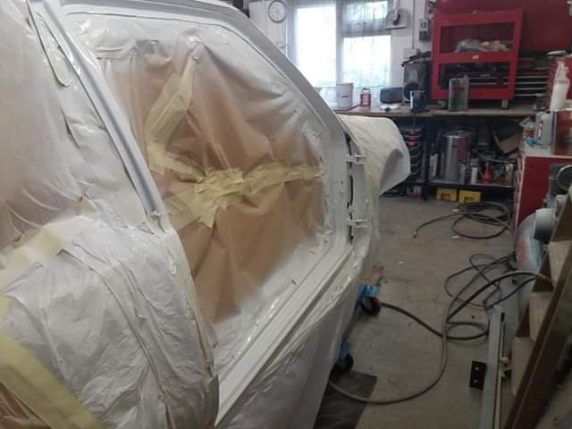

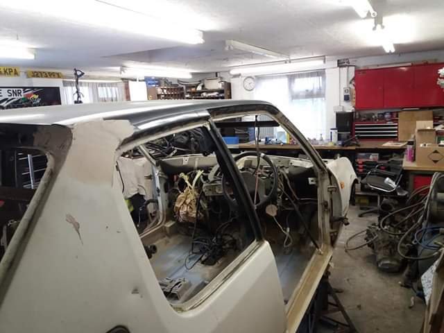

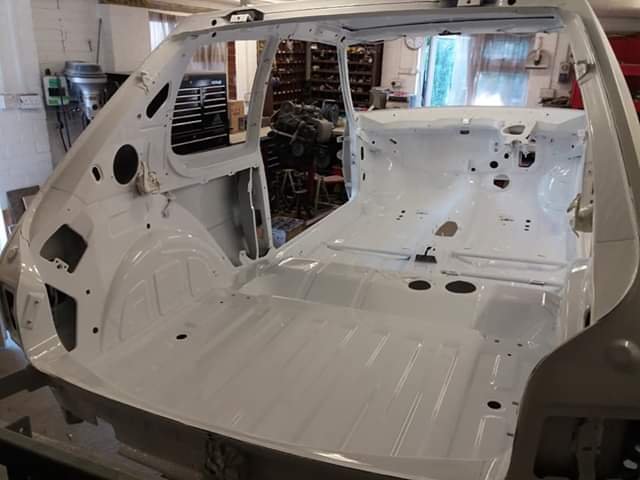

Fast forward to today and it was the turn of doing inside of panels and yes I no some one will ask why I left rear window in but time came into it
dale205mills

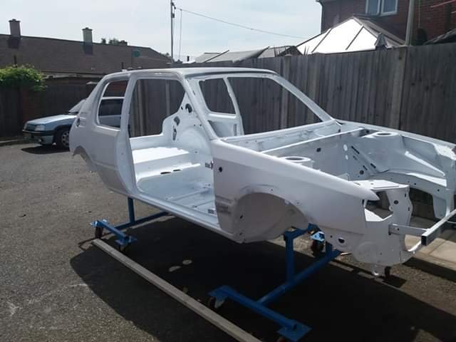

The first time 205 has been outside and put nexted to the winter hack, I put my shades on to look at the engine bay and inside B) the shell will have the panels refitted and the rest of paint work done in a oven. I will try to update as I move along with build, yes some of the ways I have done things mite be wrong or not to a good standard but im happy with my work and I know my sentences and spelling mite not be of a good standard but again I'm not a keyboard worrier and show my skills with my hands.

Now this is an honest question, have you actually done any night events before? I only ask as you end up going down the roughest narrowest bumpiest scratchiest lanes known to man, well at least up here you do. The point I'm trying to make is that I would not get hung up about an oven paint job, from these photos I'd say you are more than capable of doing it yourself. Should you then scrape or mark a panel its easy enough for you to put it right, you also won't get precious about the car in the heat of competition. Its nice to have a well turned out car, but don't go OTT. I would also tie the cage into the pillars as much as possible, its surprising the difference to rigidity of the shell that it makes.
If anything I would say spend the money on the suspension, brakes, LSD.
Too late now, but given you've added strengthening plates, I would have taken the opportunity to change the strut mounting points, in order to pickup some caster. Nice work!

I have done a couple a while a go and spent a lot of time on the routes in my younger days and I am ready for scrapes and dents will probly end up crying tho but in some ways I sort of fallen out of love with 205's and got fed up looking at it in the workshop as I'm spending more time with my boy going off road on are motorbikes and that's sort of why I sold the red 205 xs and mite get rid of the topaz gti6 and just have my silver 1.9 and my white 1.6 and buy something different. I did look into tieing the cage more and some ways I wish I went for a bolt in as I wouldn't like to start welding bits to a bolt in but if I do it again with my spare shell that would be on the list.
I didn't really want to do that sort of things on this one but suggestions like that go in the note book for nexted project and this is why I should of put this thread up to start with. Thank you just got to get back into it and not go out on off road bikes with the boy and get muddy.
Richie-Van-GTi
Looks great Dale, where did you get the spit from , or did you make it?

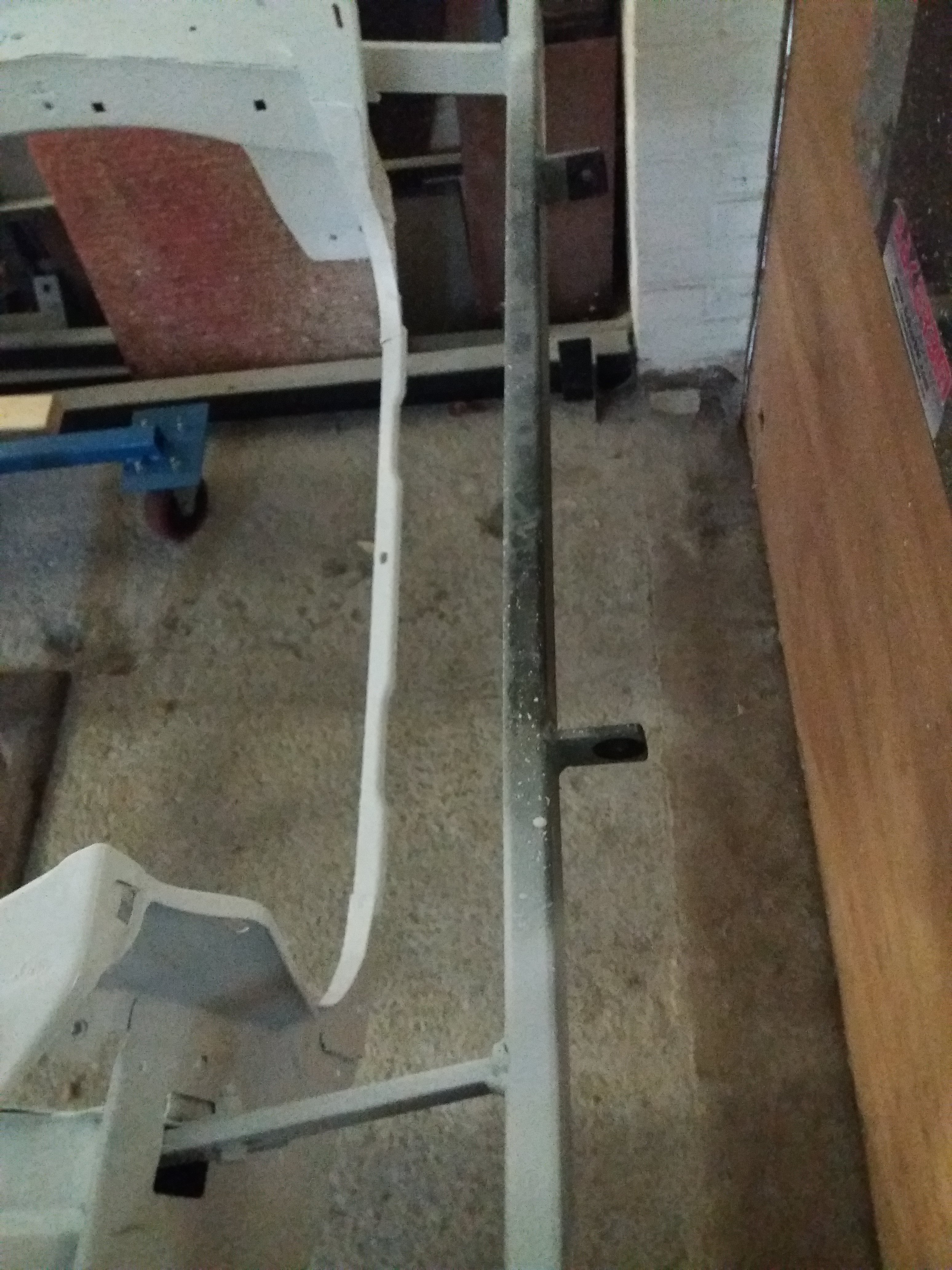

Thanks. The spit came from a company on eBay there called handlingsoloution and they started off just making them for old ford and they do the kit to fit a 205 all I can say is I will never do another bare shell with out one.
Richie-Van-GTi
Just had a look on eBay and one was for sale 2 miles away from me second hand. Bit different to your but same basic principle. Can you send me some photos of how your car is mounted please
artois7
Nice thread, thanks for sharing!
dale205mills
Sorry for late reply, the spit is bolted to car threw bumper mounts like photo, the company sell a kit for the 205
