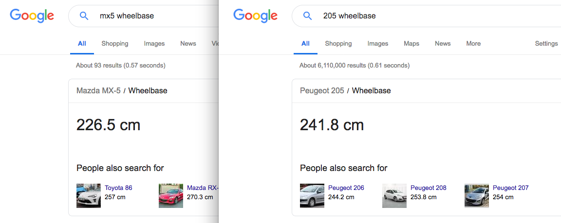

jackherer 543 Posted April 8, 2019 On 4/8/2019 at 9:46 PM, Adam said: I think that there is only a 15mm in a difference I googled it just now and it's more like 15cm. We've got the 205 wheelbase listed as 242cm here: ...so that's certainly in the right ballpark for the 205. And the MX5 is listed as 226.5cm on Wikipedia. That's the mk1, the mk2 is 227cm and the mk3 is 232.9cm Share this post Link to post Share on other sites
