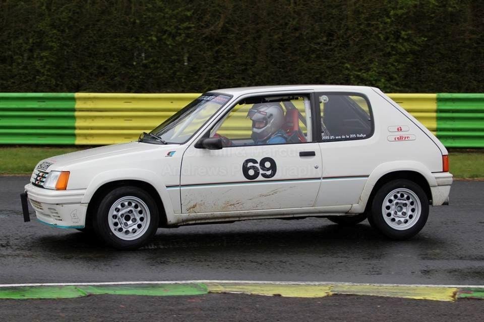

Euro Rallye runs the 1.6 gti discs and calipers. Fitting the 1.9 discs on would give you no advantage it would just reduce the track. I run my EuroRallye with standard 1.6 calipers and either Tarox or standard genuine 1.6 discs with Carbon Loraine RC5 pads, absolutely mega set up, adds nothing to the unsprung weight and works very well from cold up to daft temperatures. Only downside is the nasty horrible residue of chewed up discs the pads leave on the wheels plus some squeal. Stick with drums on the back, much better than discs, especially if you use the handbrake as they really lock up the rear wheels with standard brake shoes.

EuroRallye definitely has standard 1.6 gti discs not 1.9 discs.
13" PTS wheels
