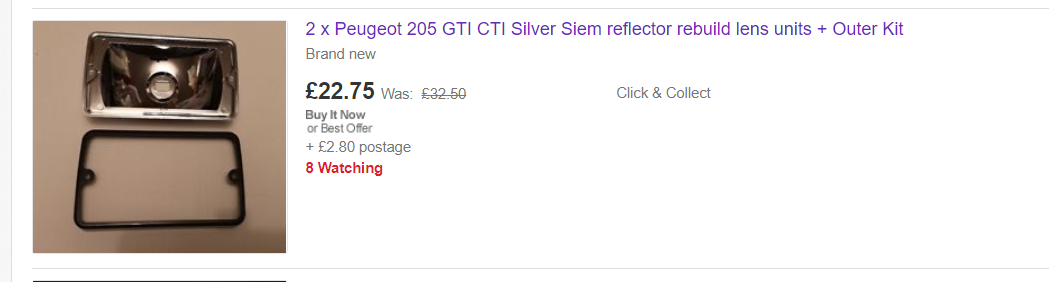

One of the lenses on my 205 (obviously) has corroded and it would appear that replacement units are big money. Has anybody had any experience of the repair kits that are being sold on ebay at the moment? ie do they fit, are they worth it etc. Example below
Many thanks in advance.

Yeah i bought one of these repair kits a year or so ago. The bulb holder wouldn't  fit properly in the reflector but with a bit of careful cutting and filing i got it fit ok. There's no seal for between the reflector and siems glass lens so pretty sure water can get in. But i've not had any problems so far and my full beam is soo much better than with the old rusty reflectors..
