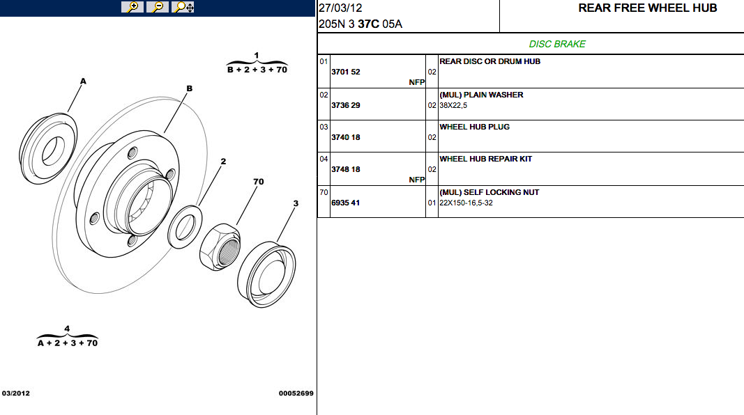

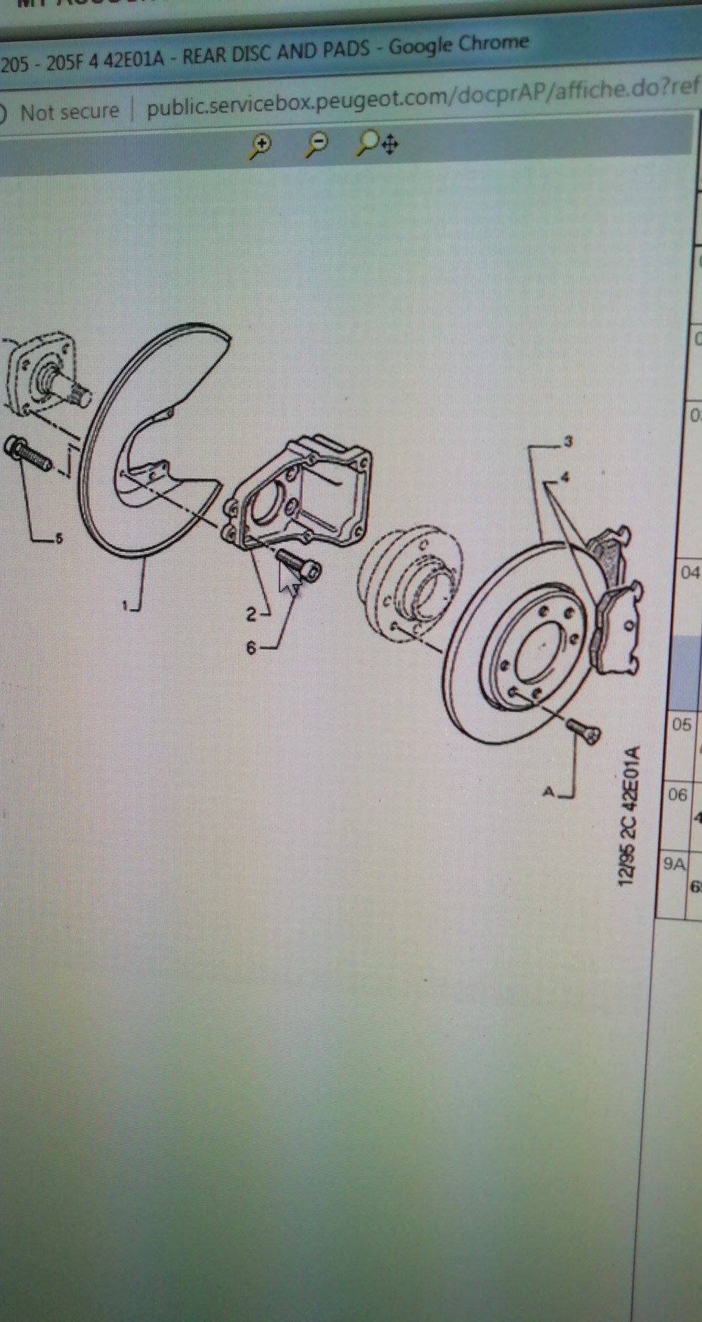

yep, you're missing the spacer.
As in the debris guard Mei?
I've just done another check on service box  and don't see a spacer , only the debris guard
Edited by Telf
1849785804_ScreenShot2019-03-01at19_54_19.thumb.png.30bbc925ab8cd1fd64ea3f7dcfac4197.png1403946302_ScreenShot2019-03-01at19_55_37.png.e79b94932d611618654855d9195e10d0.png
cheers Kieran- I looked at this on service box earlier but wasn't sure when I compared it to the other diagram . I think that part may be missing. it didn't come with the new hub
That second photo is an aftermarket kit so it looks like it comes with some brands but I've never got one.

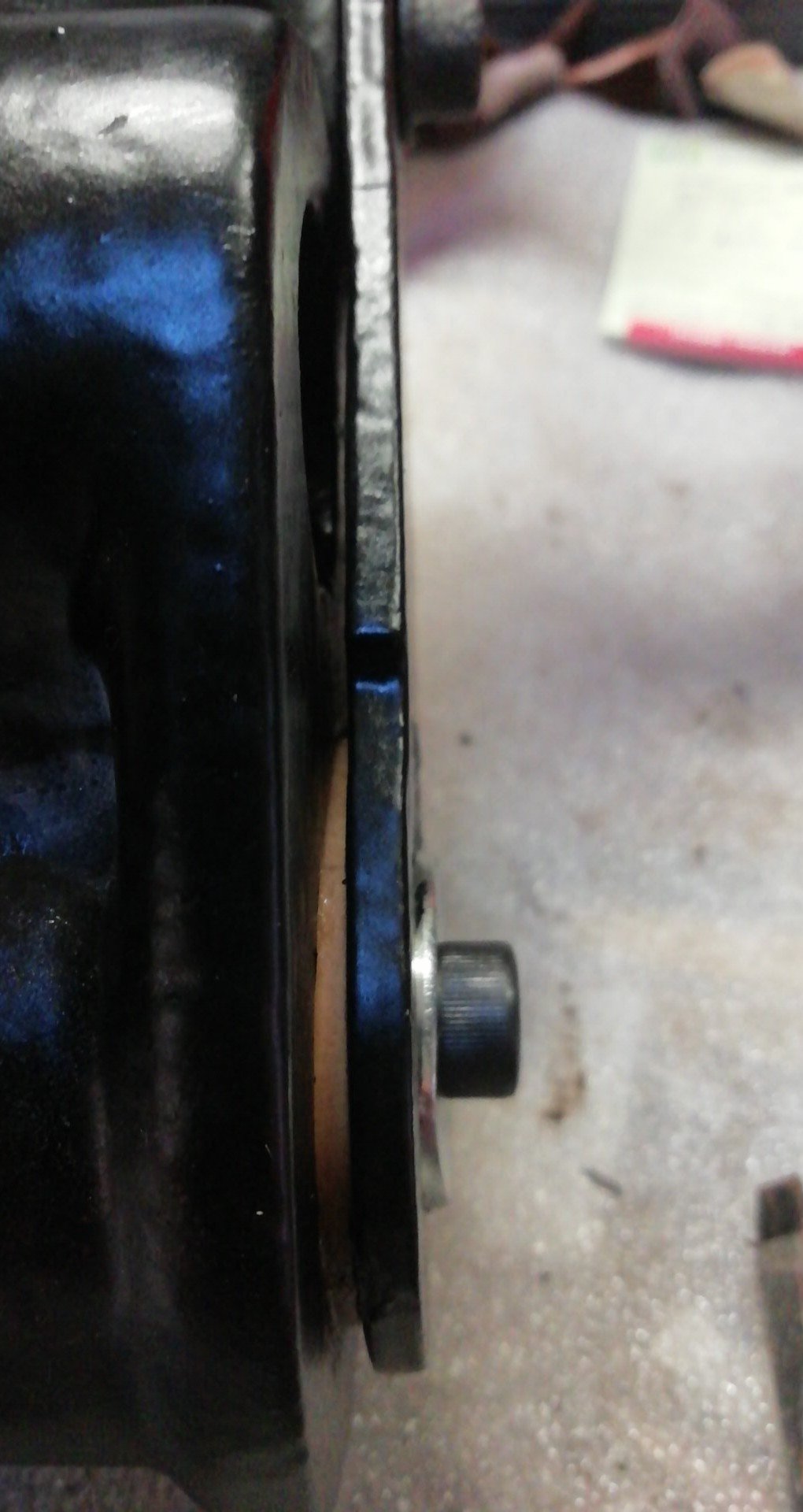

So I think I've sorted the anti roll bar seals- does this look better?
Not sure your soposed to have two bolts there!  One is soposed to be a plastic cap.  https://www.ebay.co.uk/itm/Rear-Axle-Arb-Torx-Plastics-Screw-Suit-Peugeot-205-306-309/222246979194?ssPageName=STRK%3AMEBIDX%3AIT&_trksid=p2057872.m2749.l2649
  • Thanks 1
Yeah the bolt was in just to add pressure whilst I was pressing the seal in . It is supposed to be a cap. I can't see a reason why you couldn't seal it with a suitable size bolt though and some sealant unless kits a clearance issue?
Clearance is very tight to the tyre at that point!
I've ordered the hex seals from desborough designs mate from the link kindly supplied
The plate should sit more or less up to the trailing arm. Gap there looks too big still. Tyre is very close.
ok tom ill have another go al it- cheers
