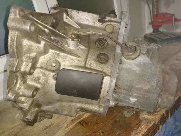

Richie-Van-GTi
Thats a BE1 with hydraulic clutch as far as I know in first picture and be4 in second.
Not sure if you can put a be1 bellhousing and fork on a be3 box then use the be4 hydraulics with it to acheive the above. I think biggest issue may be the pedal.

early be3 cases still had the hole for the be1 style clutch arm.
SRDT
The regular BE3 case is older than the BE3 itself as the later BE1 used it too, the problem is that it may not be fully machined for the early BE1 setup.

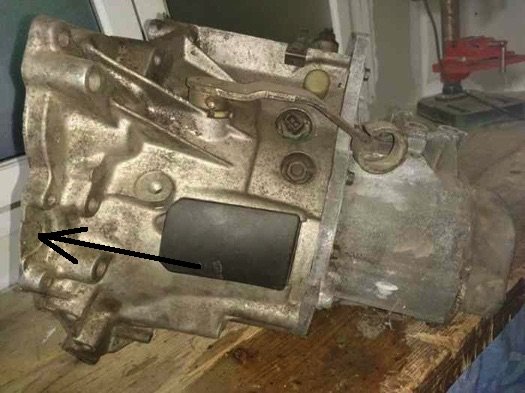

I have two idea's.
1) I'm thinking of grinding out the boss casting where ether BE1 mounting boss is on the BE3. The welding a arm onto the BE3 for arm to its protrudes out the casing side. Then using a push salve cylinder.
2) utilising a wildwood pull type actuator and using the existing clutch arm and anchoring the cylinder at one end. The cylinder roughly located where the existing clutch cable passes through the top part of the casting.
What?
I just looked at three BE3 boxes from the mid 90`s all have the correct machining if you want to use hydraulics with them.
Krash67
I was referring to this part here, where from images i have seen with the BE1 is where the push slave cylinder sits . The gearbox I have is the same as the picture, however grinding this thin section of casting out, can utilise the opening and the two threaded bosses above and below as the mounts.

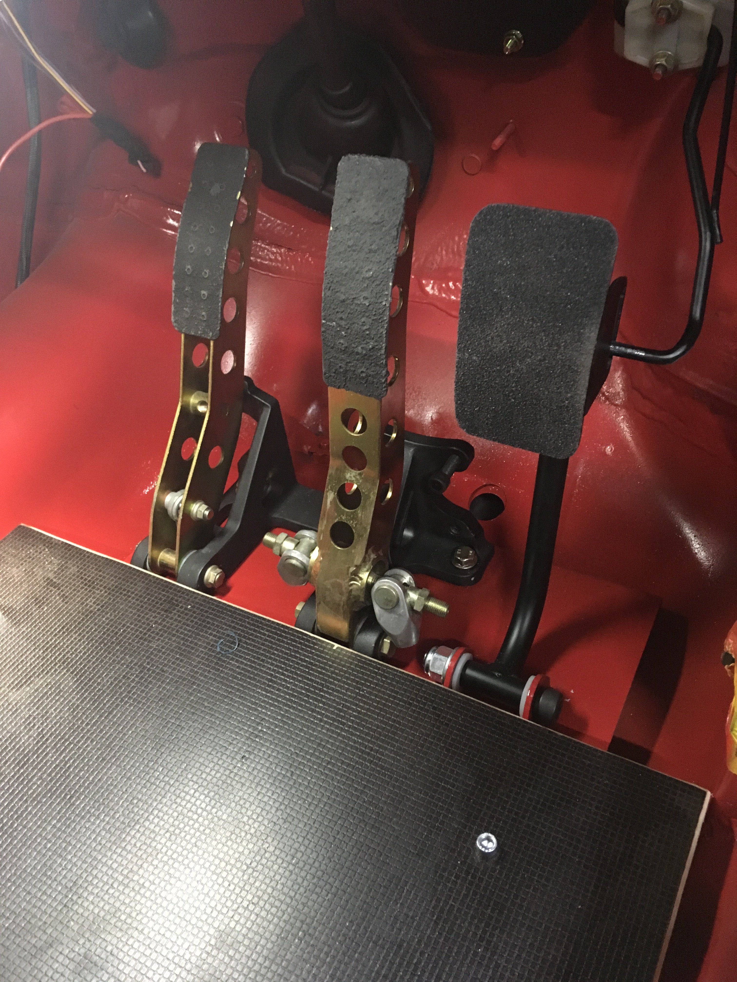

What are you doing about the pedal?
Krash67
Pedal Box
