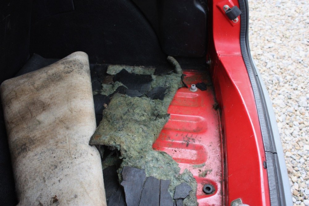

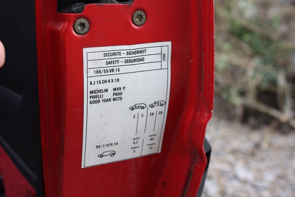

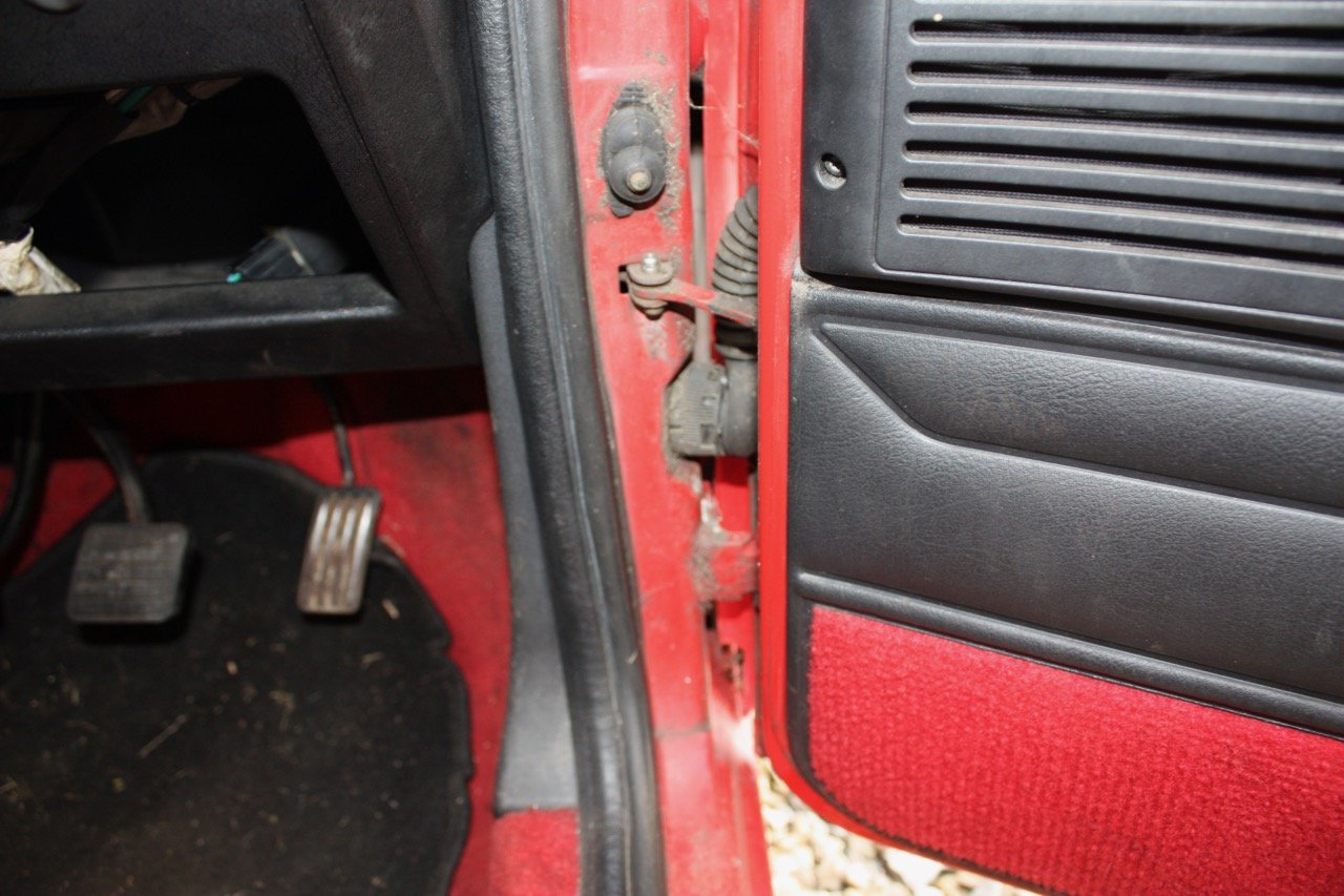

First inspection revealed a very original and unmolested car:
  • Very little rust > apart from 10p size spot in passenger footwell and similar size spot in rear floor above exhaust
  • Orignal Speakers
  • Original Parcel Shelf
  • Original Head Unit
  • Original Headlights
  • Original SIEM Fog Lights
  • Zero Accidents with all Original Panels, Factory Welds, Glass, Bumpers, etc...
  • Paint Code on NSF crossmember
  • Factory Jack with little rubber grommet to stop rattles
  • and so on

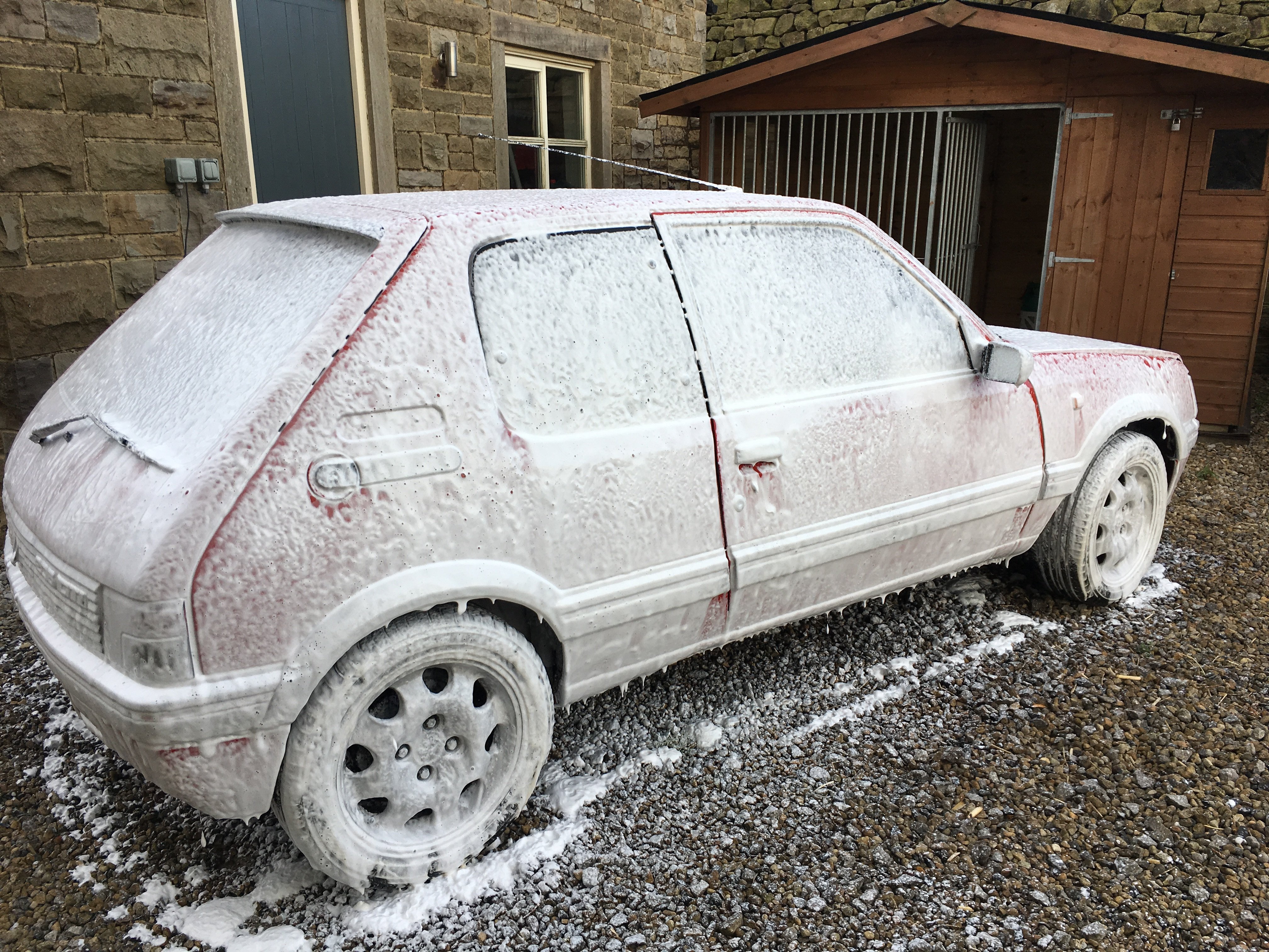

First picture is of her receiving her first wash for 15 years!

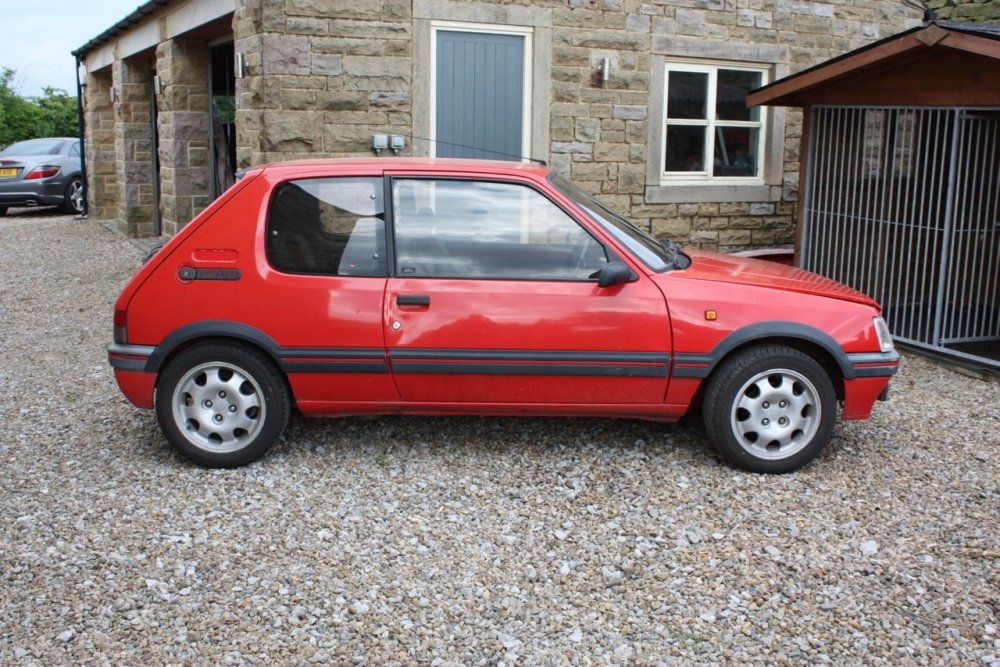

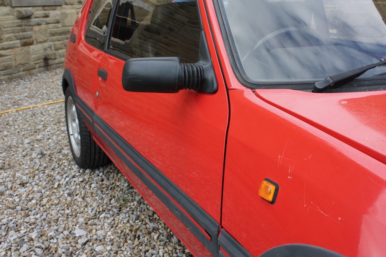

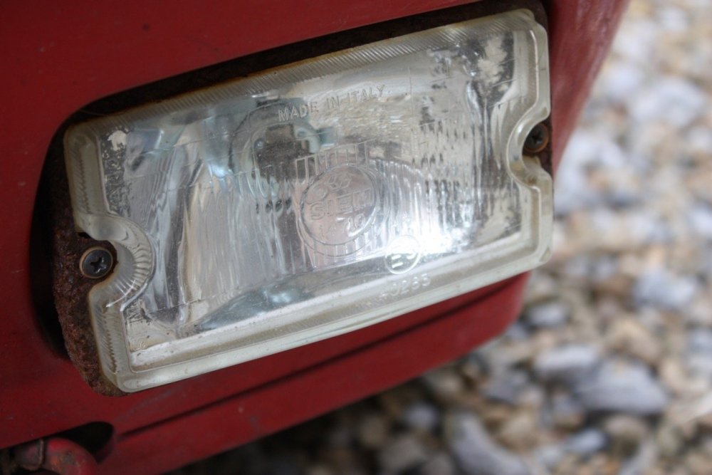

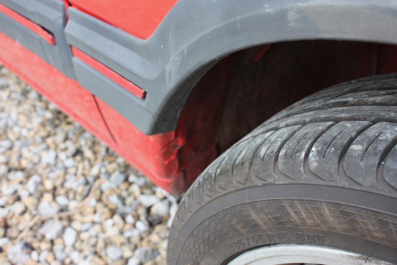

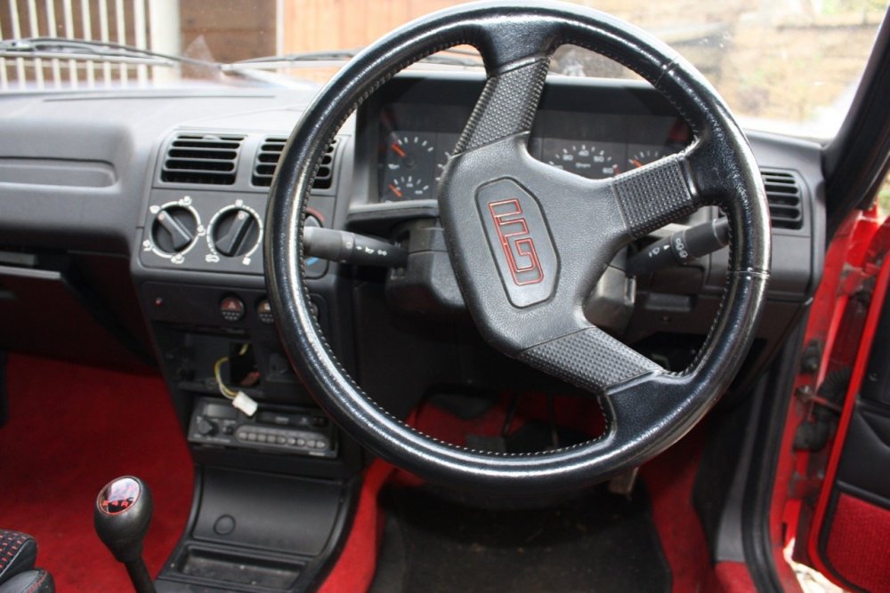

Some picture before the work commences

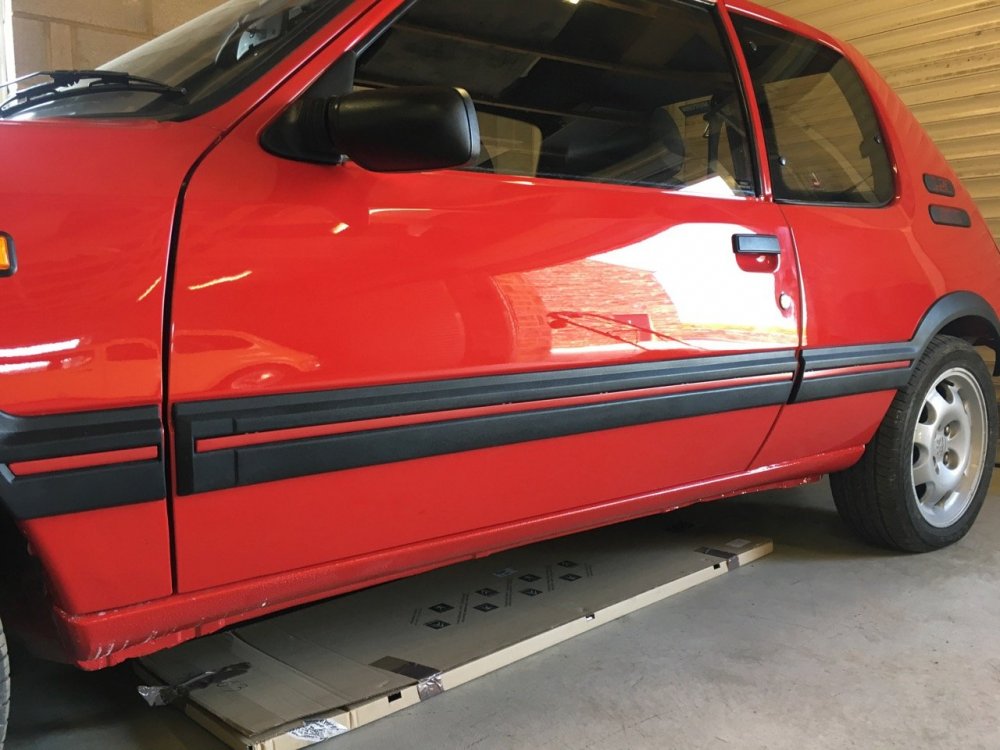

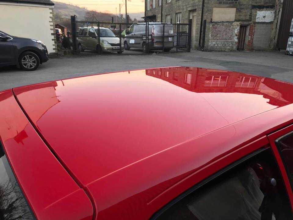

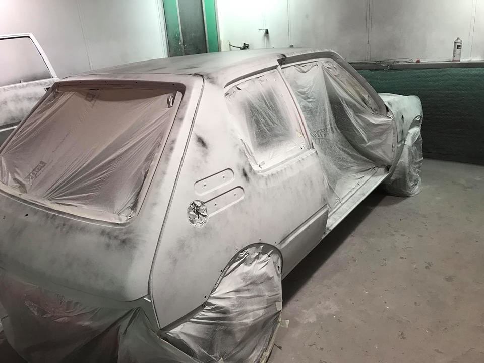

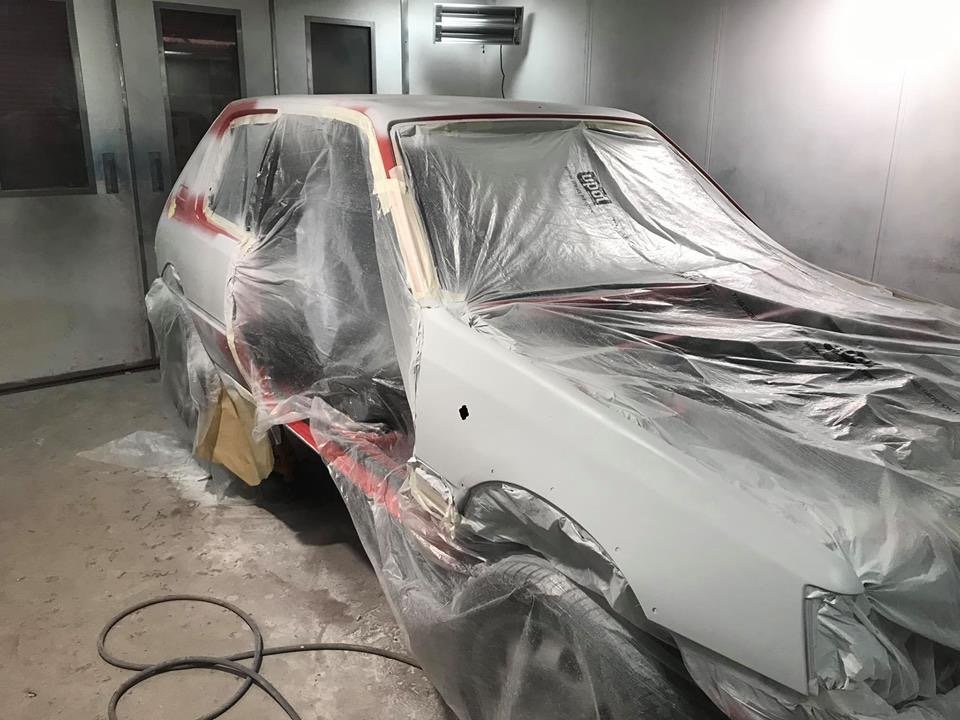

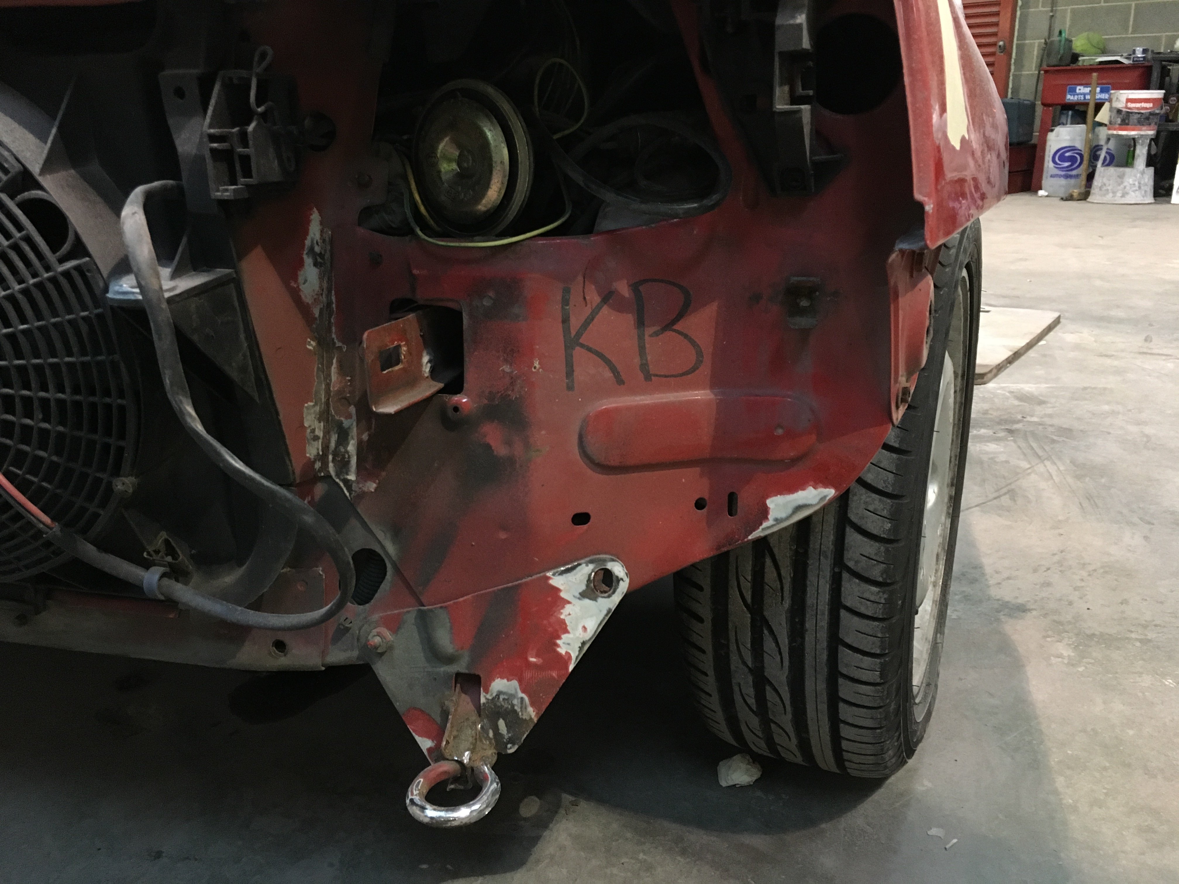

bzzzracing

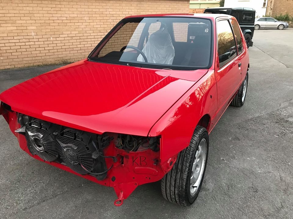

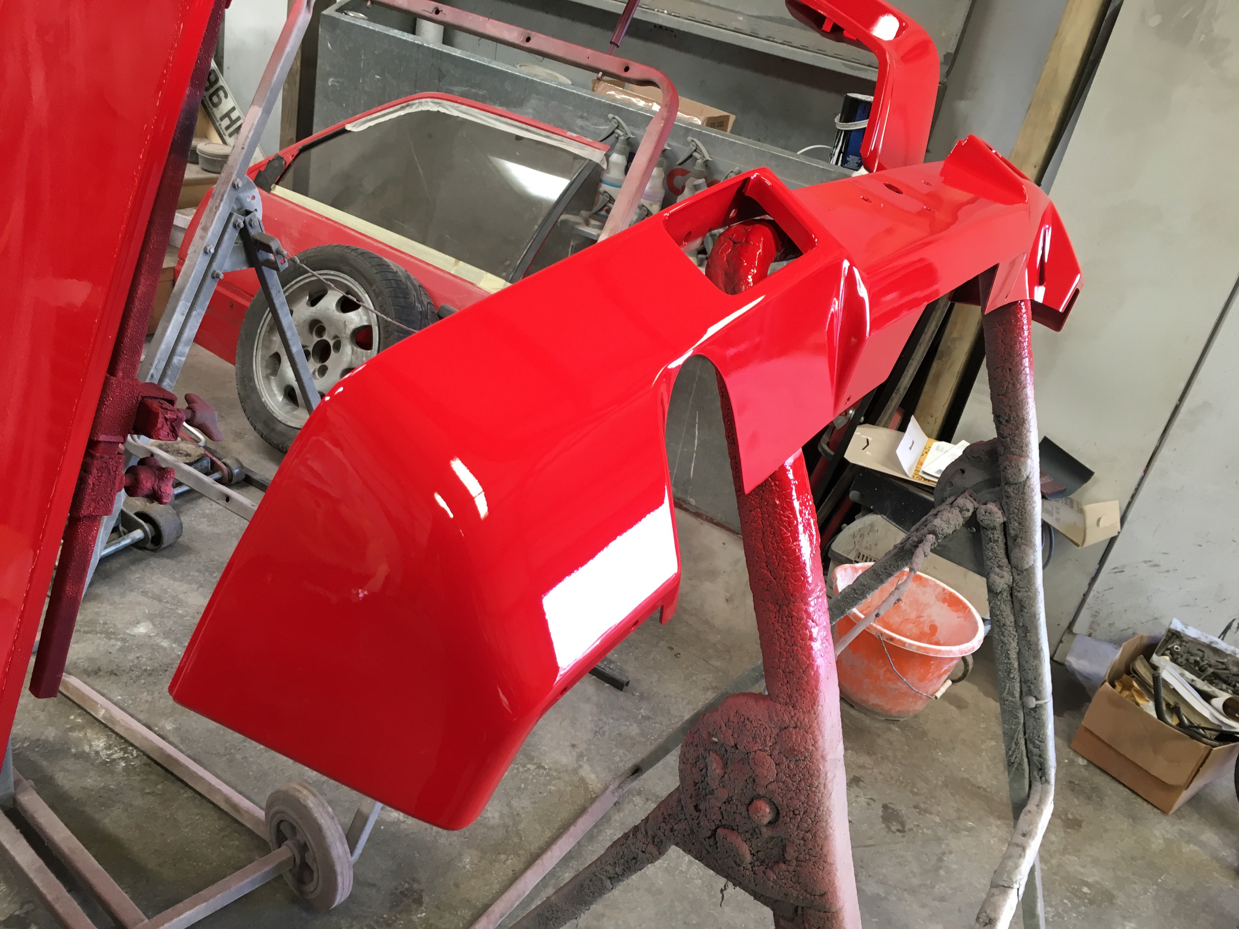

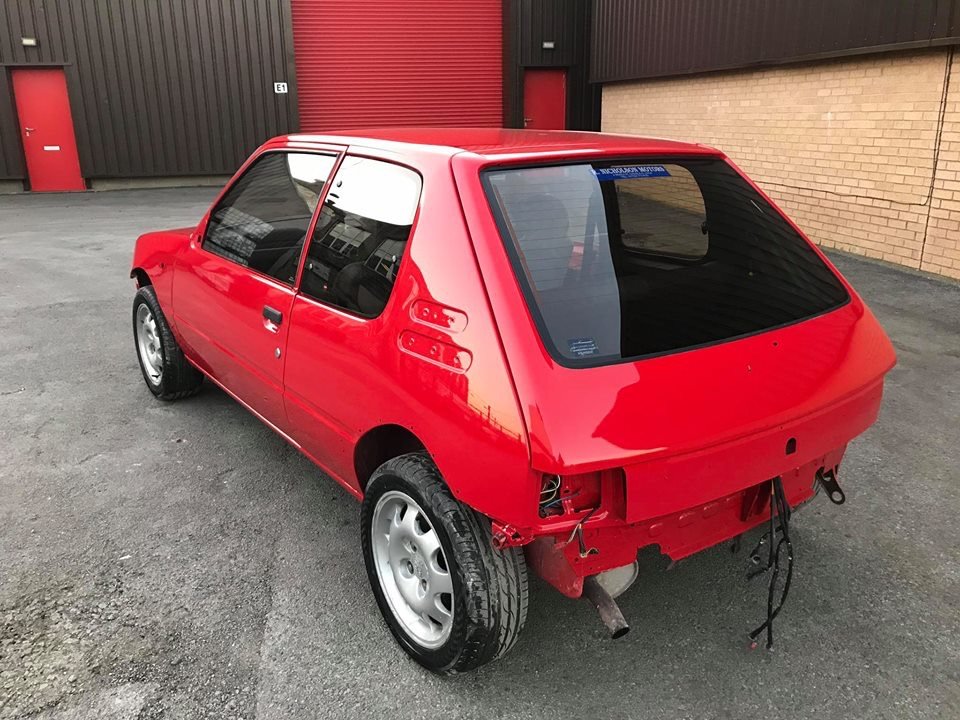

Some pictures showing the car after received fresh Cherry Red paint.  Note, the original paint code is not only on the slam panel in the engine bay but on the front left corner behind the front bumper.  We made sure to leave the factory code on and to not paint over.

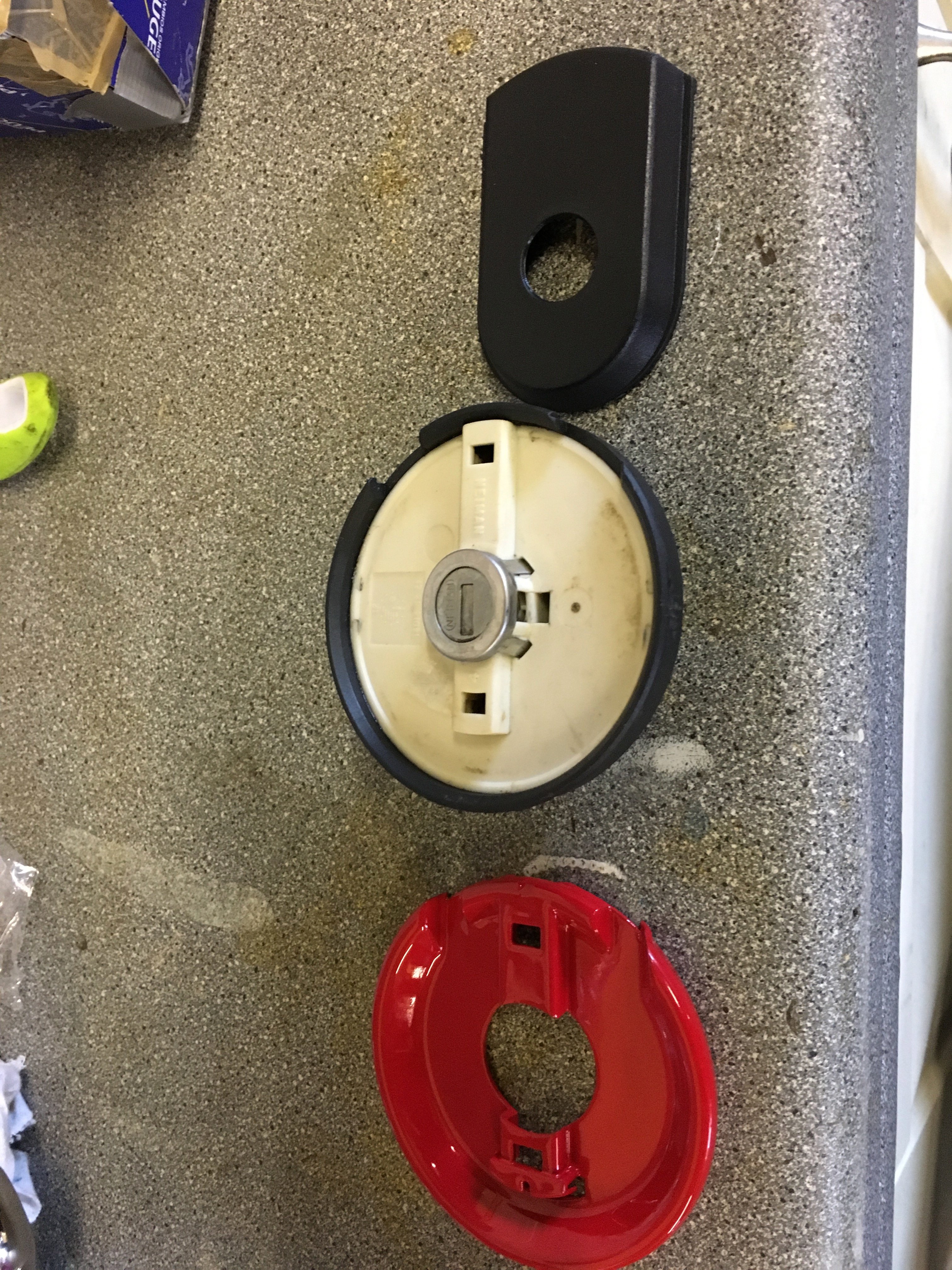

bzzzracing
Rebuilding the Petrol Cap. Prize apart carefully with a screw driver.  The black plastic was sourced from GTI Powers river in France.

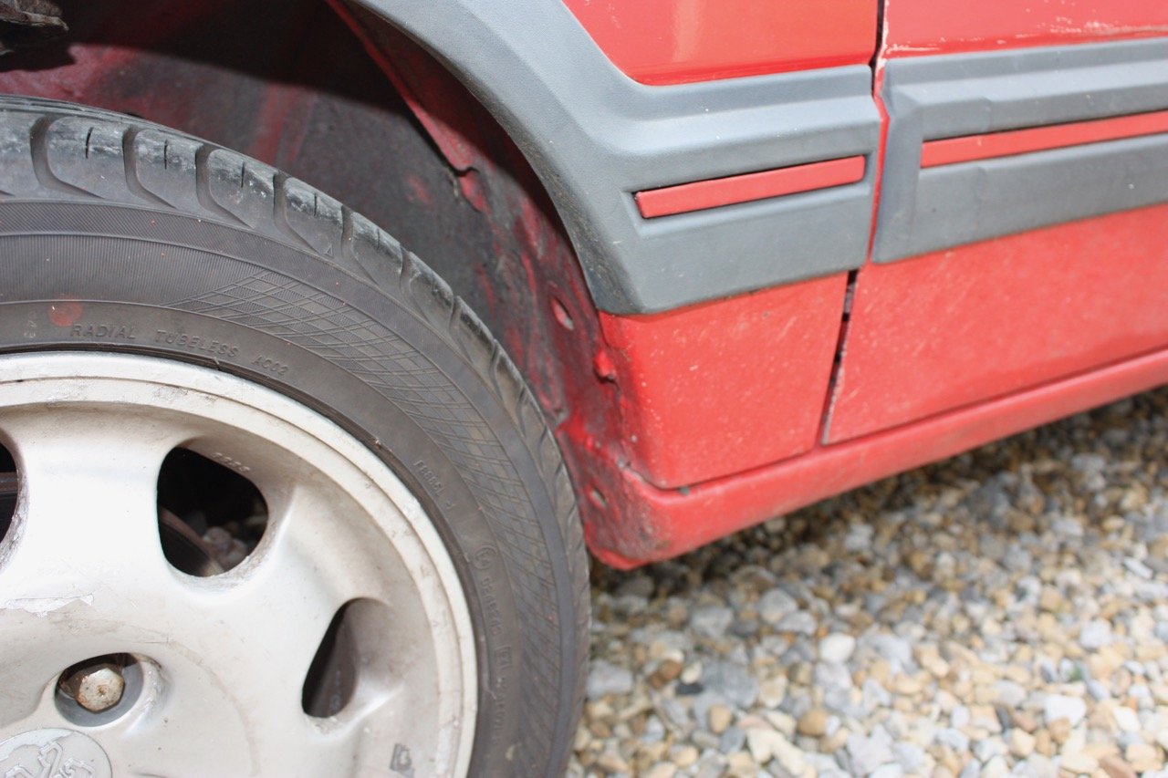

bzzzracing

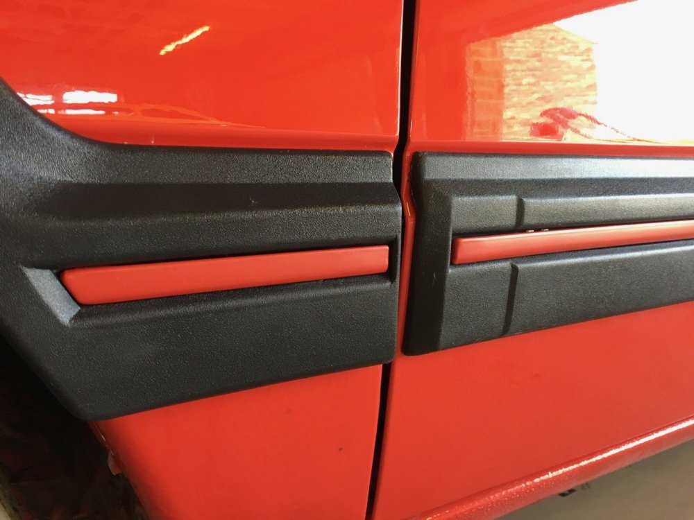

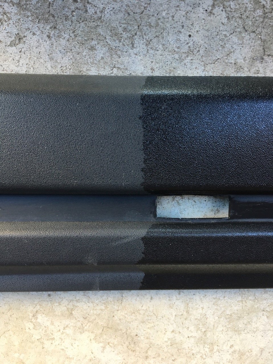

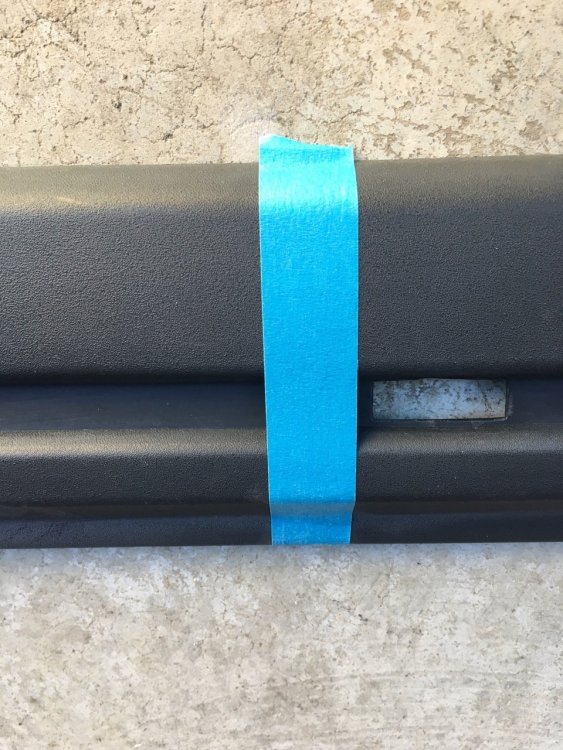

Decided to keep as much of the original black plastic mouldings but replace the red inserts with new from the Peugeot Museum.  The picture shows the trim being treated to a coat of Gtechniq C4.  Results are amazing.
bzzzracing

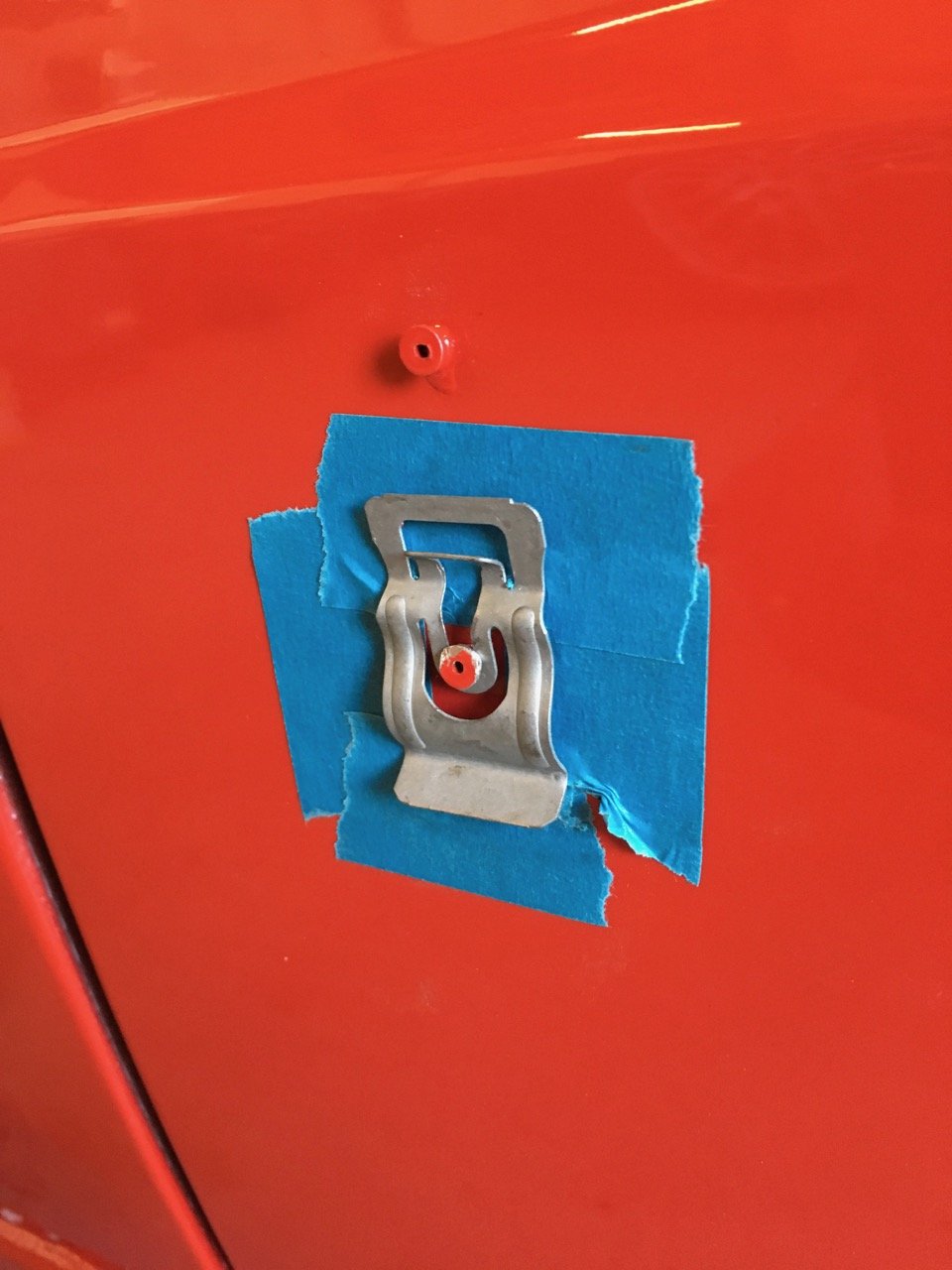

New clips going on for the plastic trim.
bzzzracing
Plastic trim fitted on Near Side with new Red Inserts

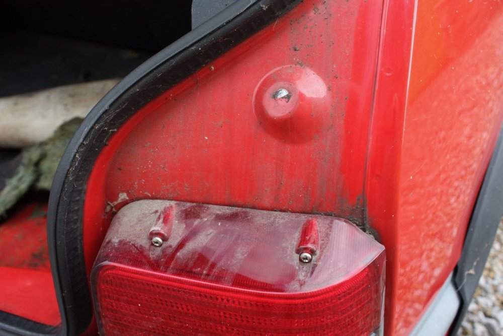

New Old Stock rear bumper fitted together with new rear panel from Peugeot Museum and NOS bumper plate lights.
