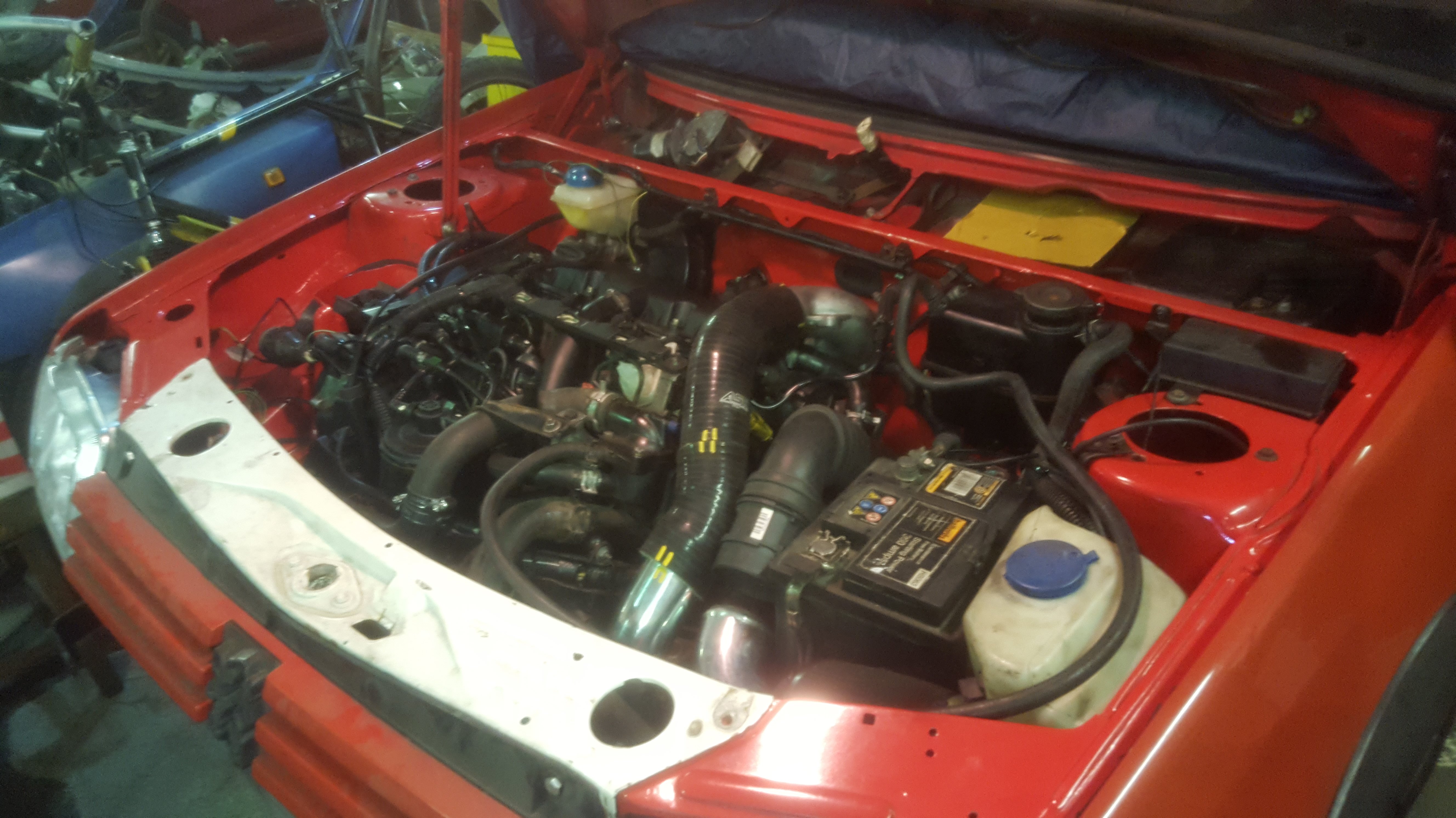

Grez4
Some pics

I have been a bit busy with various things so little work or updates.   I did today however have time to figure out that the cheap pump I was using didn't supply the HP pump with enough pressure to actually allow it to work.   After badly fitting an inline pump that had been removed from the track car for being a little bit intermittent....it fired straight up.!!
She lives!
Before I try and chuck it all back together.... FMIC? or not?  I am trying to get this thing running with bits out of the garage but an FMIC would require a bit of money.  hmmm.
