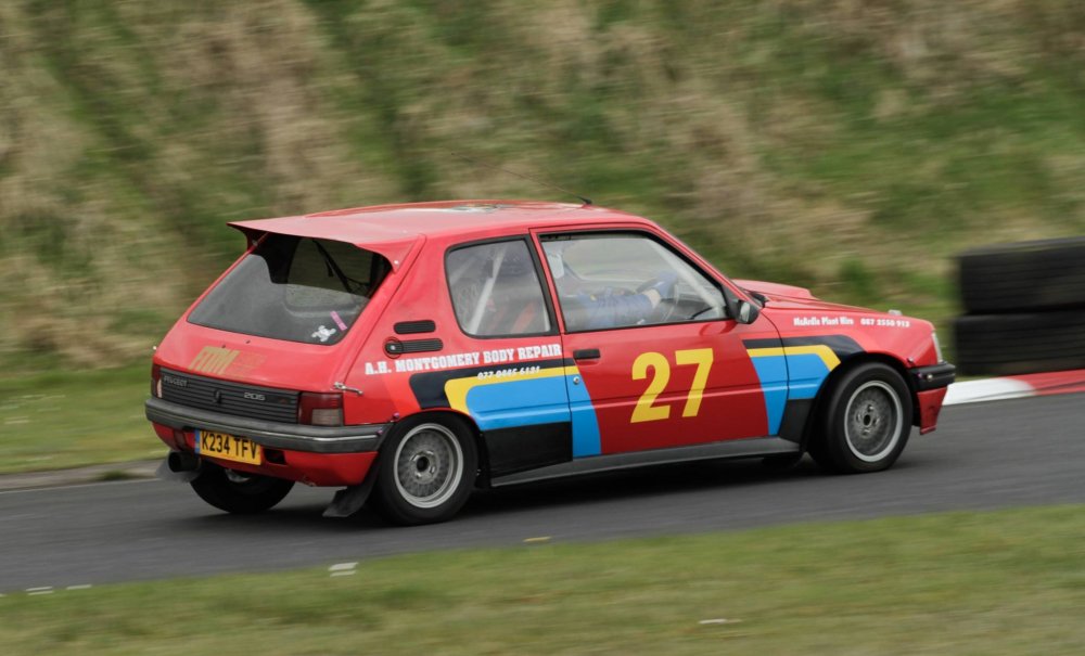

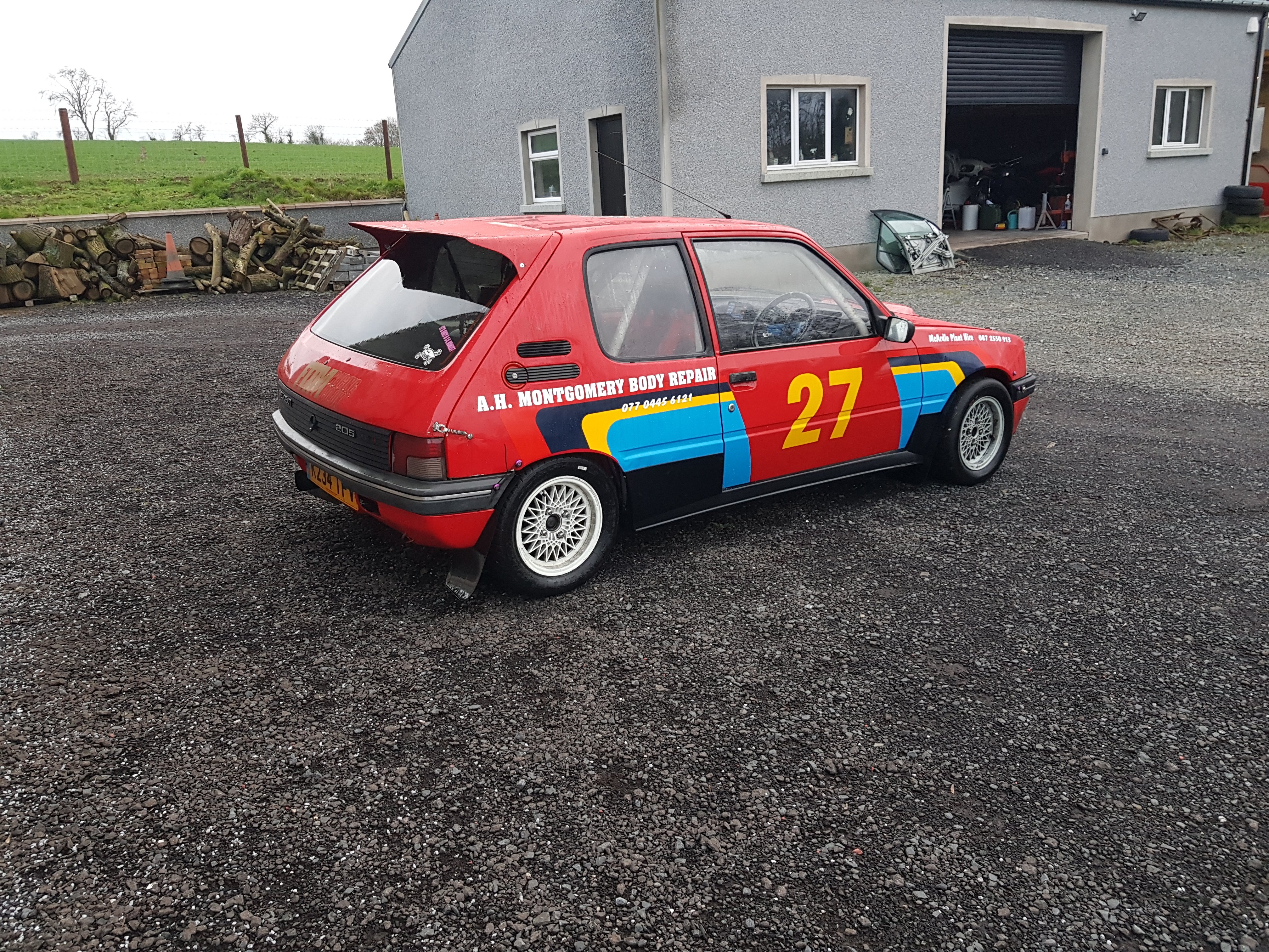

Thought id start a post of my wee 205 rallye, first pic is when i got her, bog standard msa logged 205 rallye, first job was a respray to tidy her up.
then the mods came :D

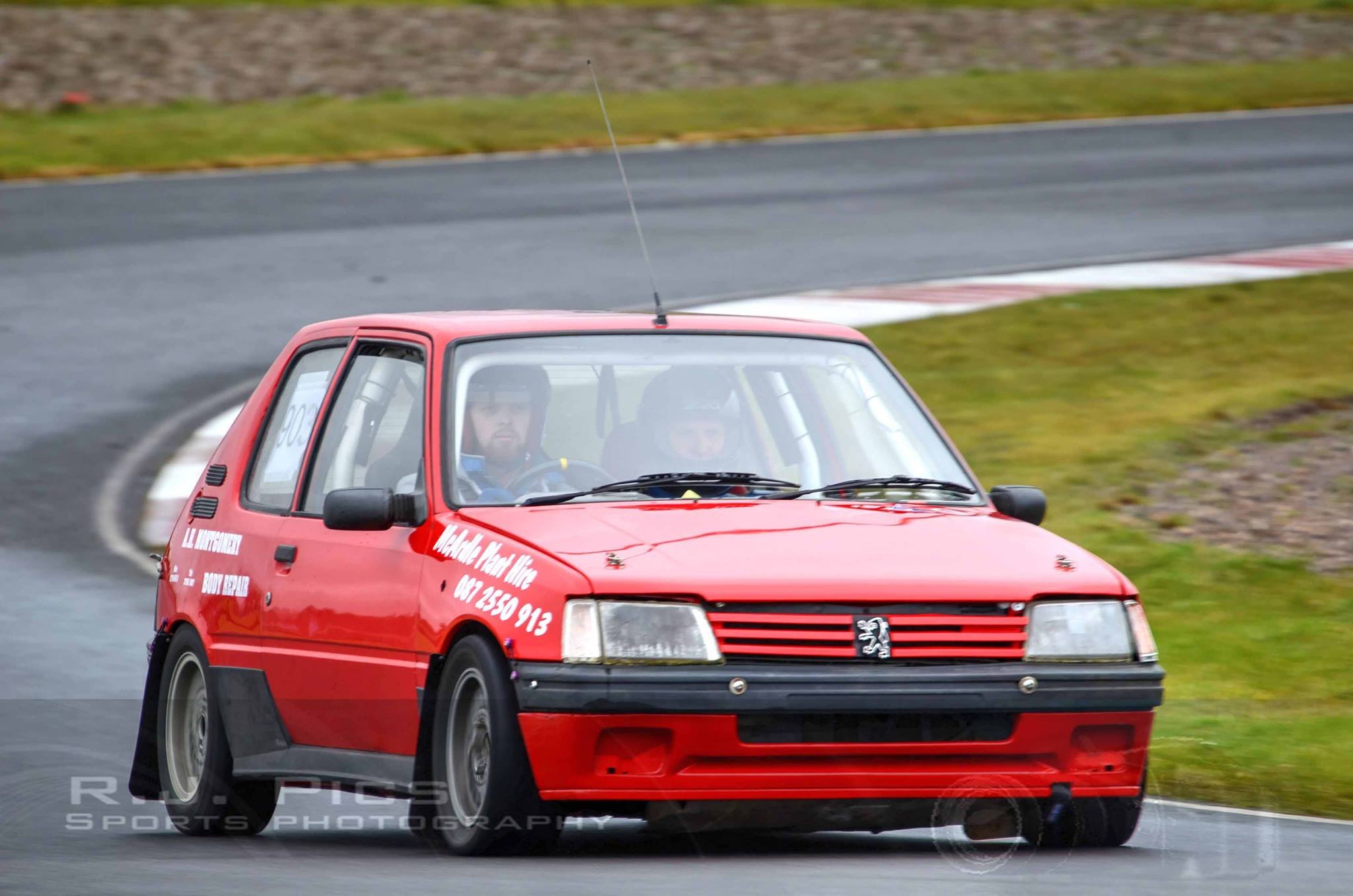

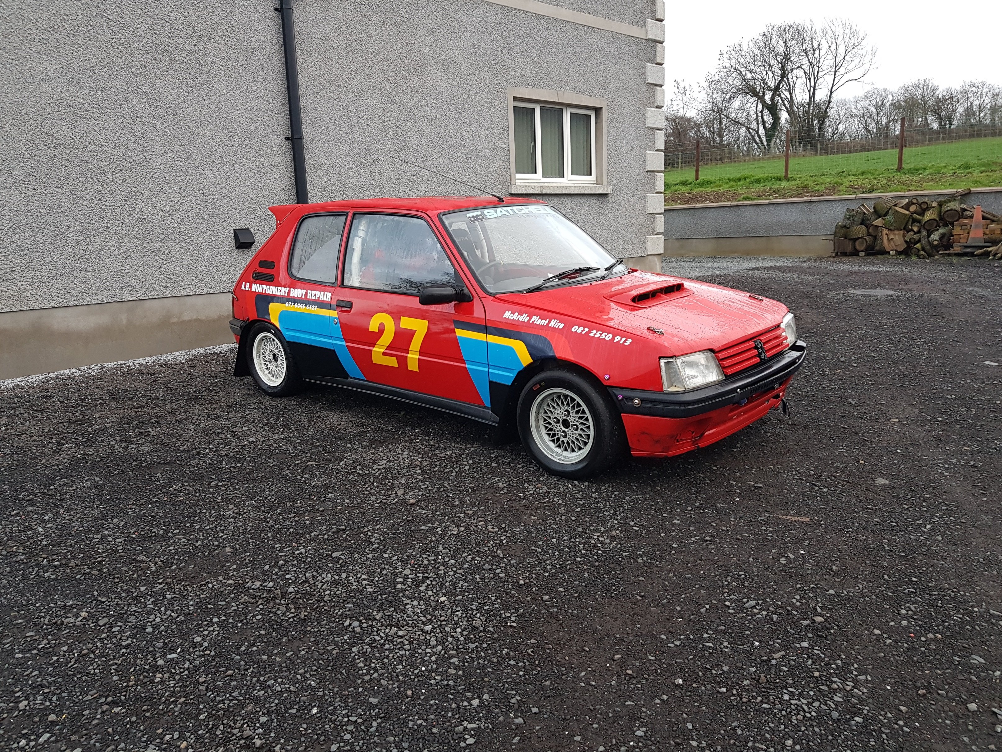

monty1991
most up to date photos

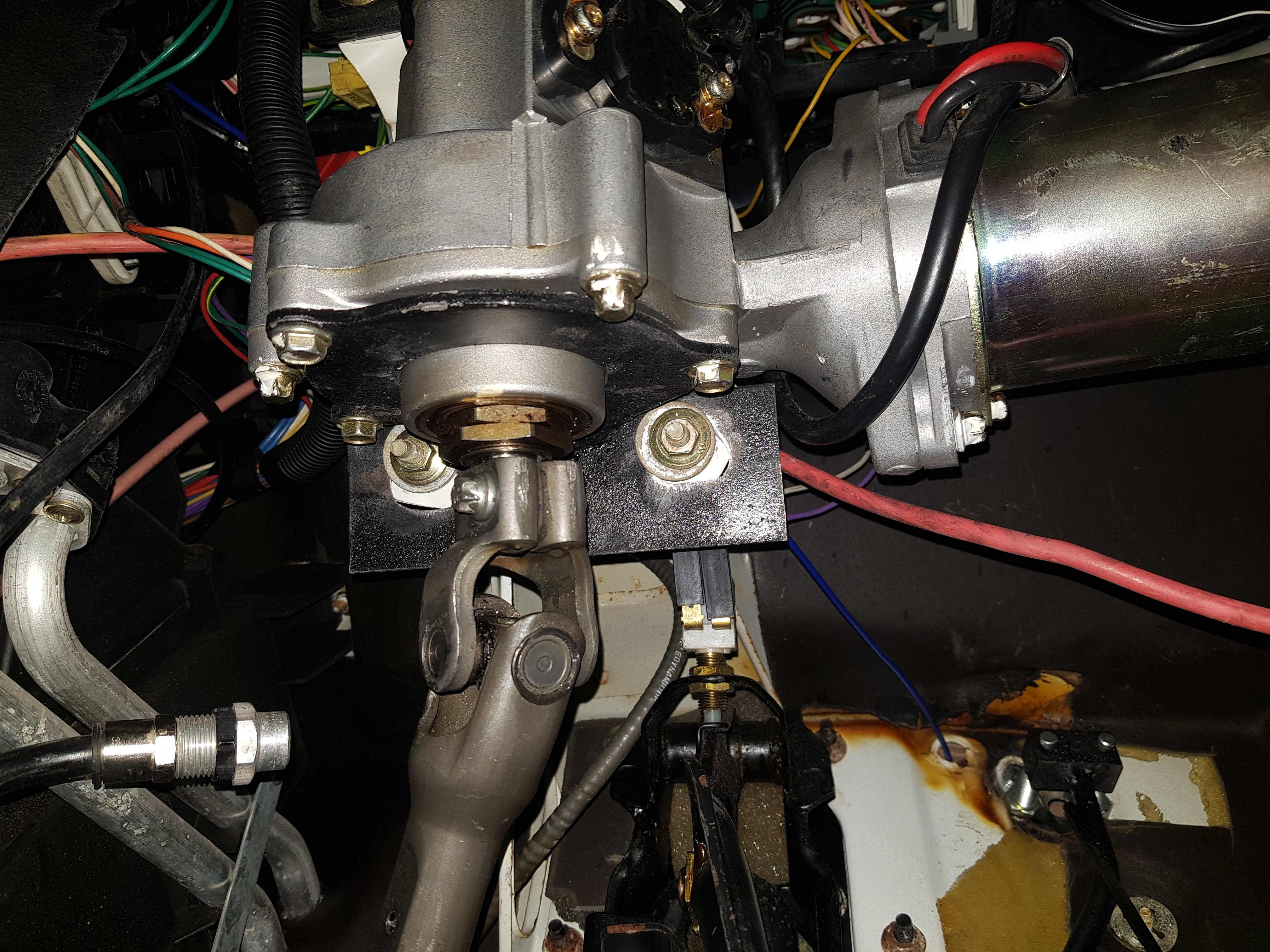

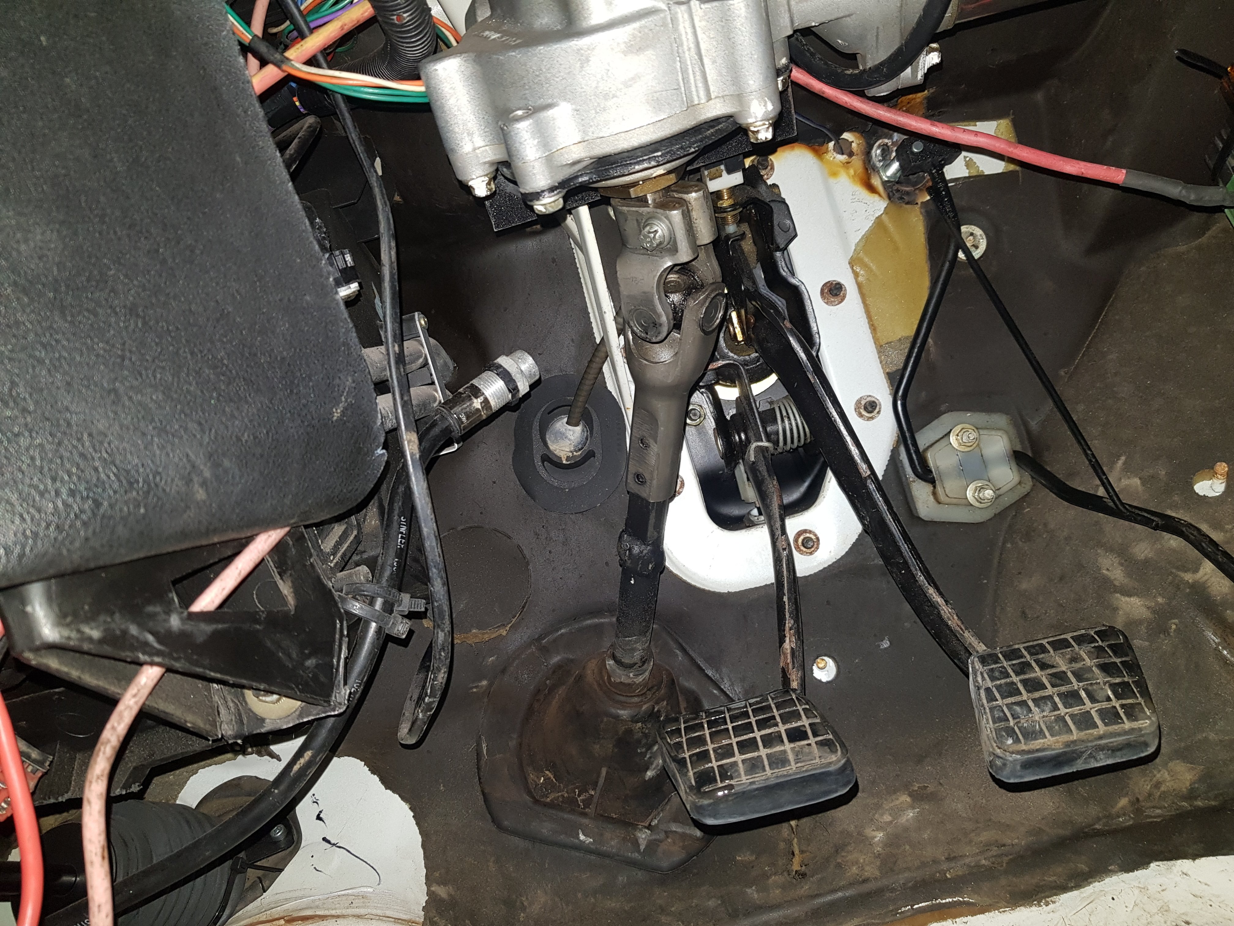

Krash67

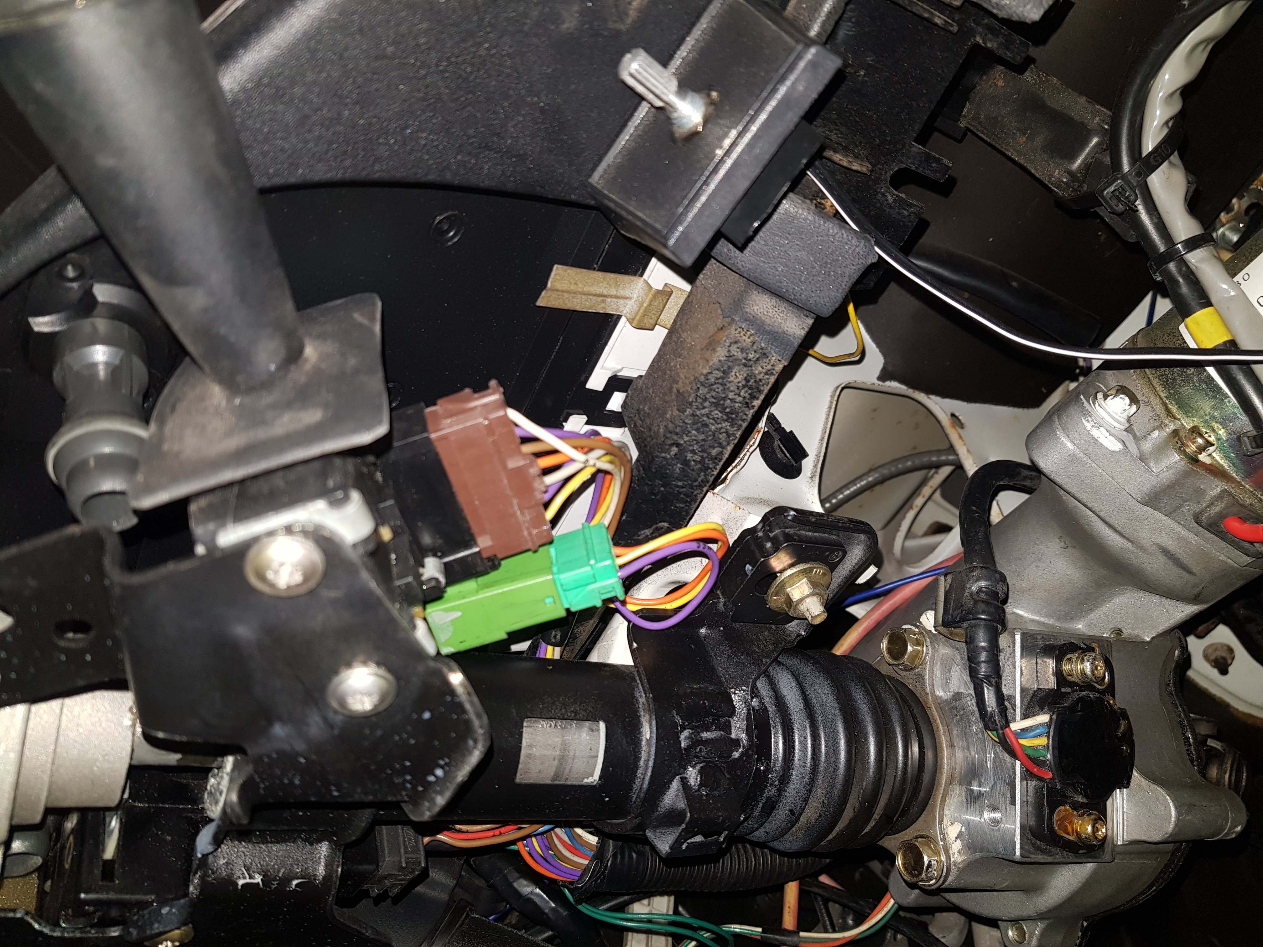

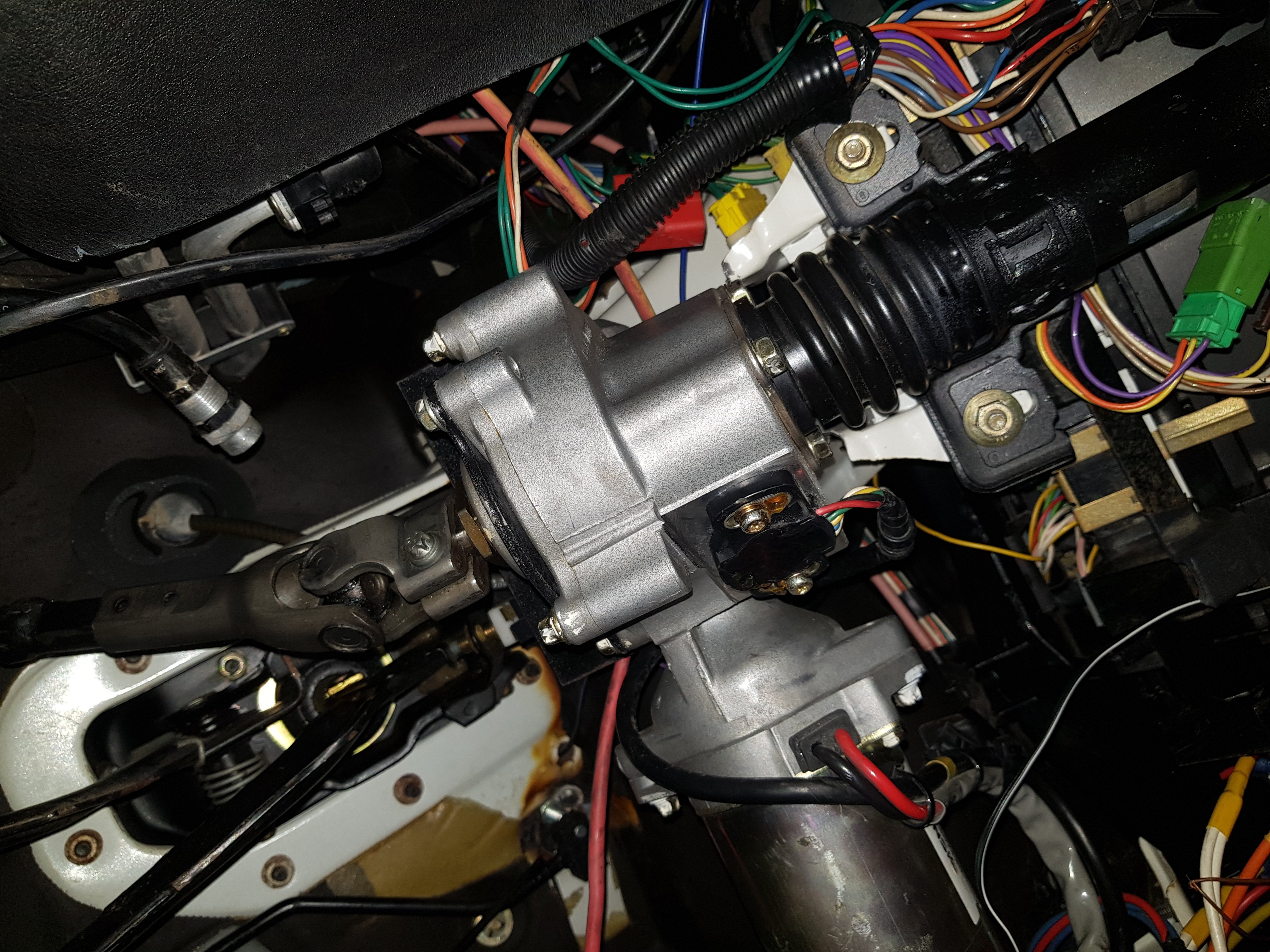

Any chance you can share a picture of the corsa EPAS set up. Contemplating the set up.
monty1991
ill get a few pictures next time im in the shed, its not great for the road but on track its awesome!
monty1991
Sorry for the delay
monty1991
monty1991
its not the tidiest of jobs but it works :D

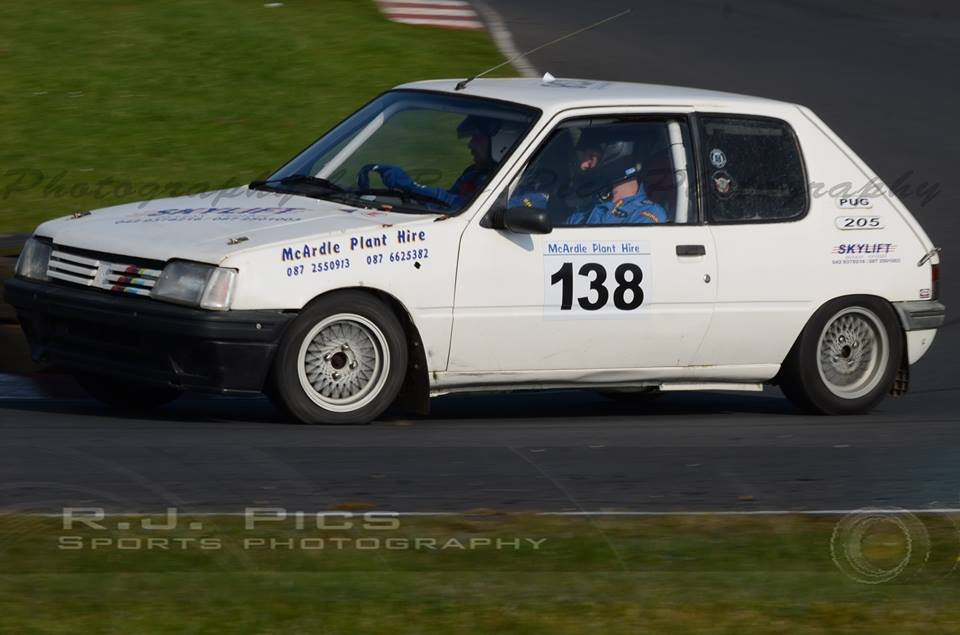

monty1991

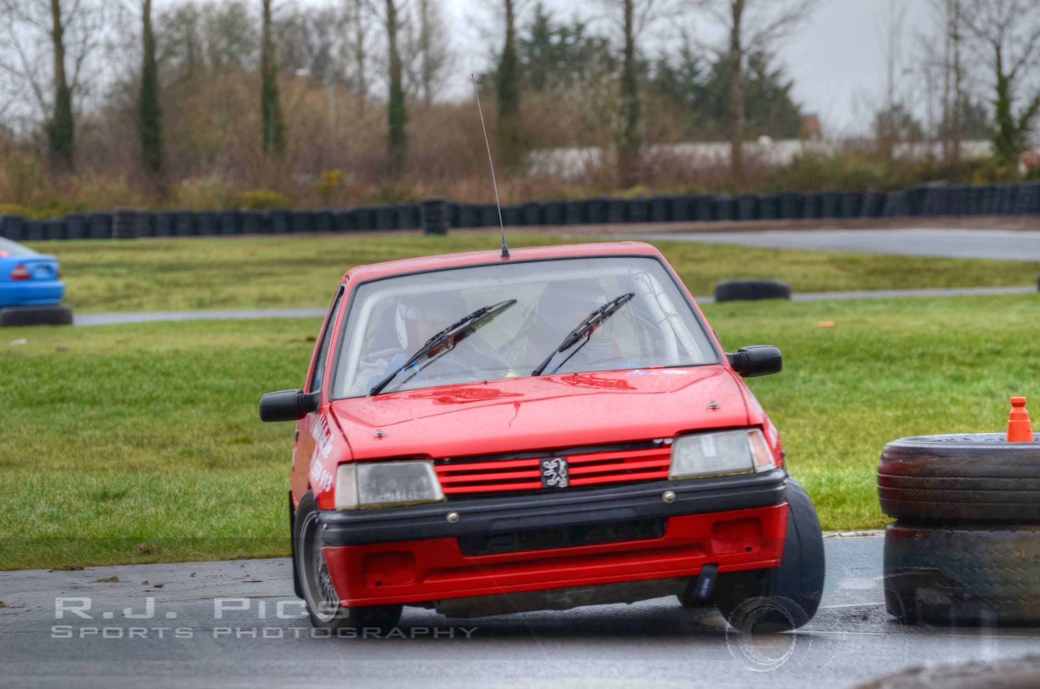

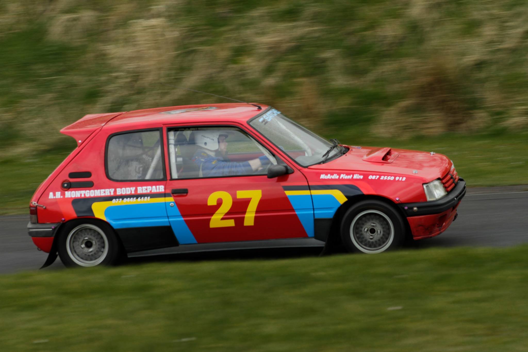

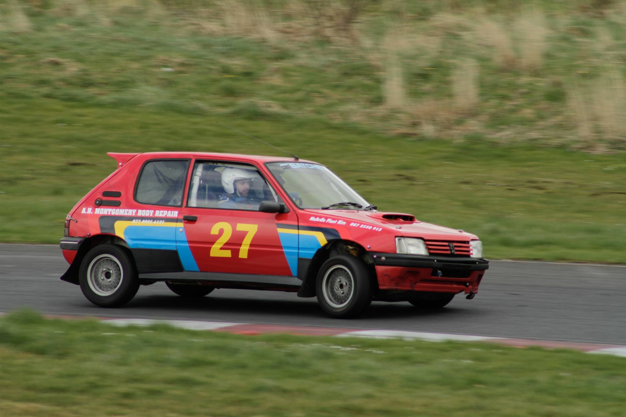

few snaps from my latest event, came first in class betting a few civics and novas ;)
