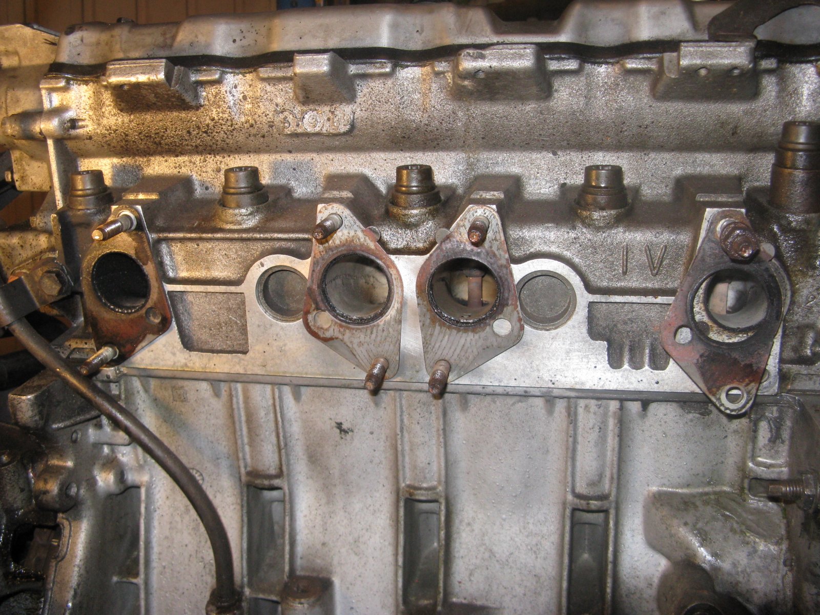

If you put them onto the bolts 180 degrees out the big hole for the exhaust gas is out of position , try them on head or manifold before assembly and note the position of the little rounded tag that sticks out then make sure its in the same place once you have it all back together . I stripped one down once that had 1 or 2 wrongly fitted and had probably been there for a decade partially blocking the gas flow . For your own interest you might want to measure the size of the exhaust port in the head and the manifold and then the diameter of the hole in the 4 gaskets - i had some Moprod gaskets once that were about 2mm smaller than the port size . The size varies between gasket make , i found the ones i bought from Peugeot had the largest hole so no gas flow restriction .
