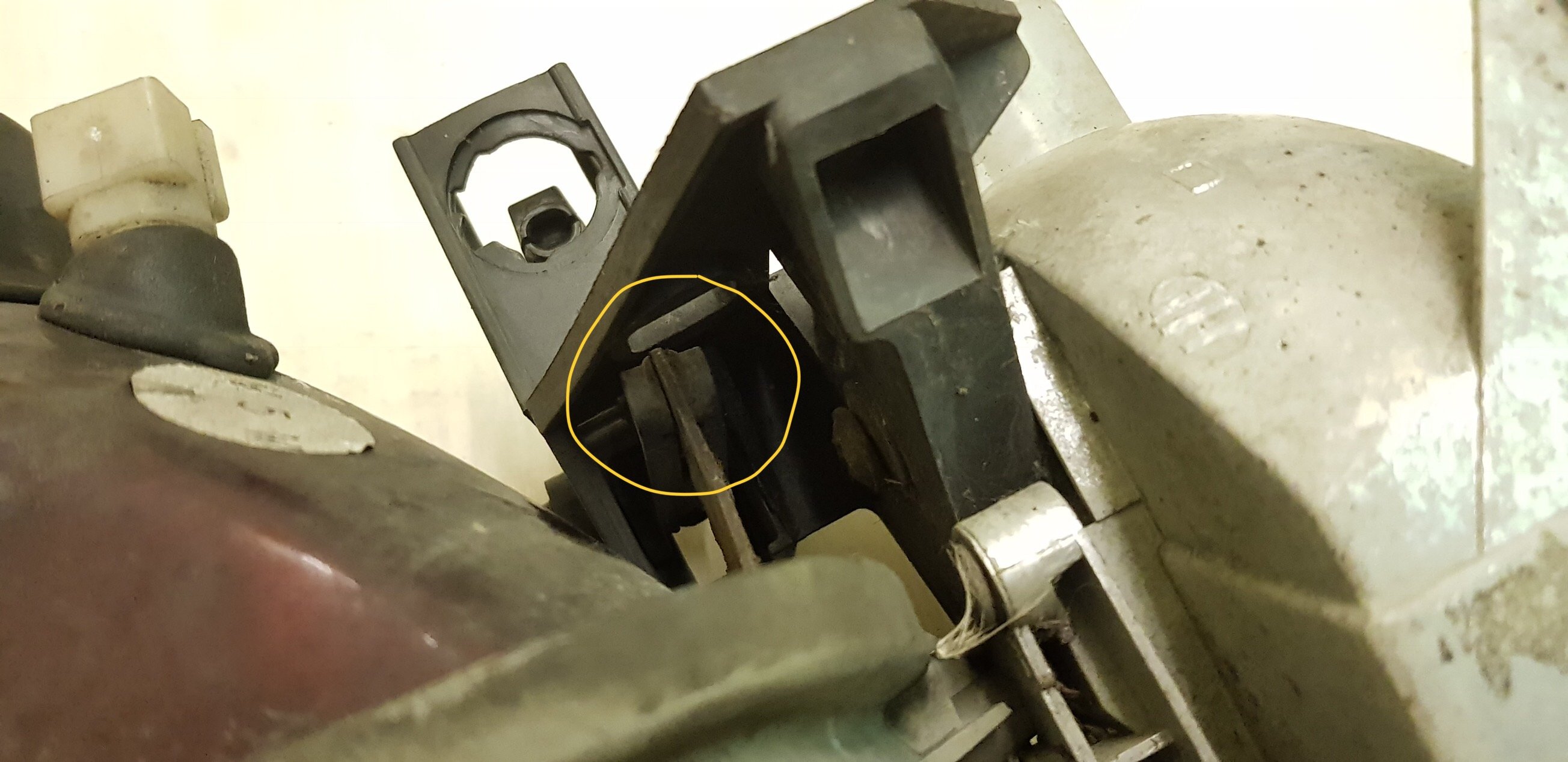

Philpooma 30 Posted October 1, 2018 Help wanted please. I’m in the process of stripping a 205Gti down for a light restoration and I’m stuck on how to remove on the the headlights. The Haynes manual mentions unclipping the adjuster mechanism to allow removal after releasing tension on the spring clips. I cant see how to unclip the adjuster mechanism and thats after me removing one of the headlights already. To do this I removed all the plastic mounting parts, however on the other side, one on the small 8mm nuts is chewed up and not wanting to come out using all usual methods. Can anyone advise me what I need to release to remove the stubborn remaining headlight. I have added an image of the removed headlight, is the the joint that I need to unclip? If so how without breaking it? Share this post Link to post Share on other sites

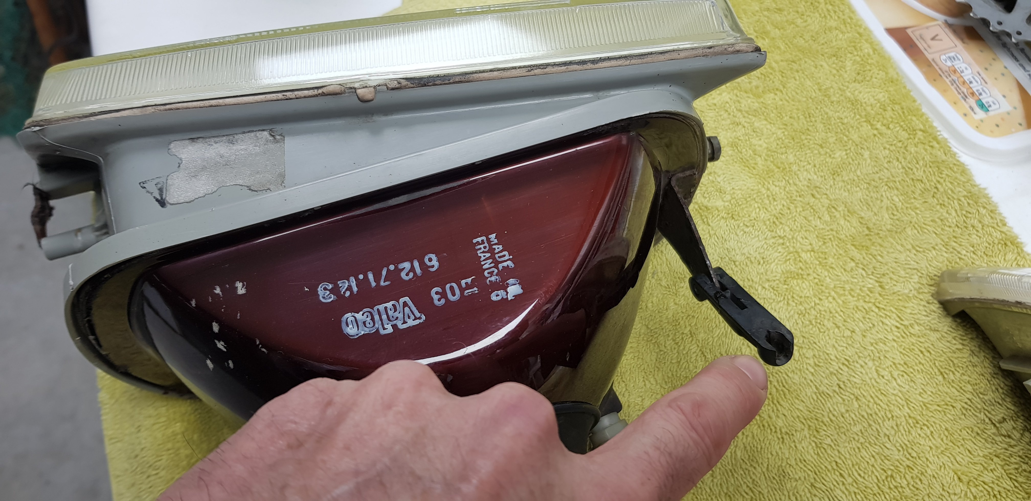

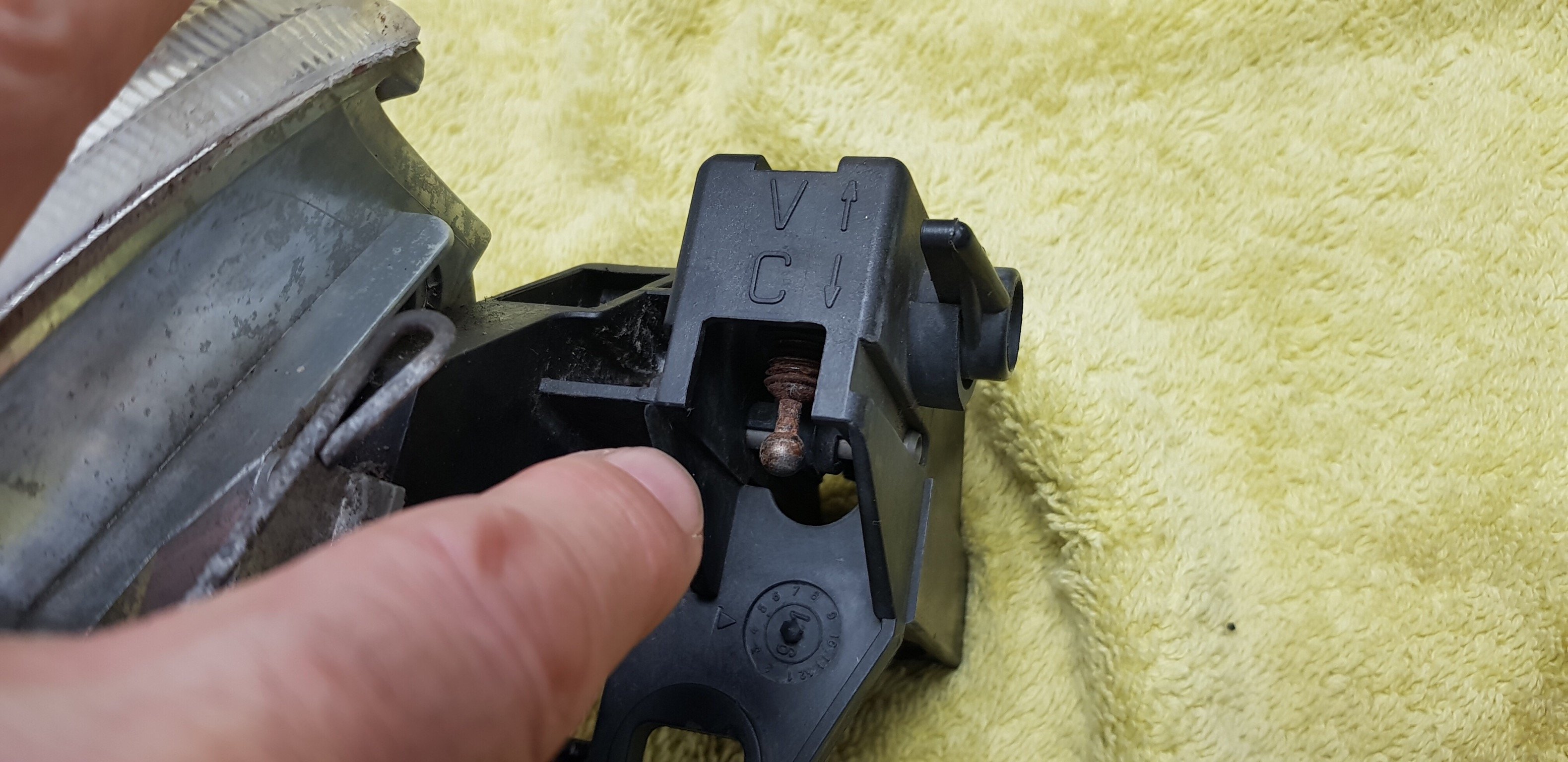

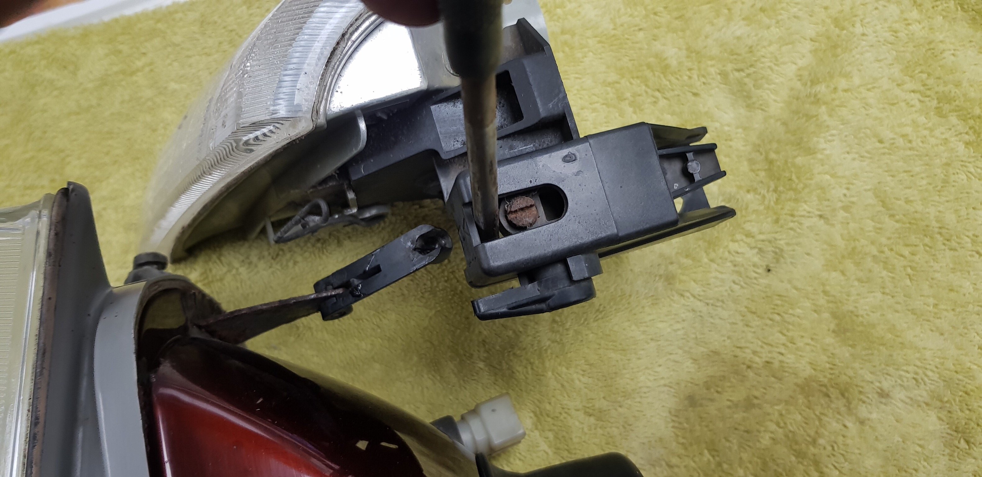

Philpooma 30 Posted October 1, 2018 Thanks for the replies guys. I have just taken a look at it before I saw your messages and managed to figure it out. If it helps others I have added some images of what I did. The image below shows the ball socket that needs to be released (already released of course) This is the ball that clicks into the above socket located vertically below the headlight adjustment screw Shown below is the side indicator and headlight, the drift shown in the image is pushing down where you press sharply to release the ball and socket. 1 Share this post Link to post Share on other sites
Tom Fenton 1,549 Posted October 2, 2018 I would add to this for the benefit of others, your method of pushing from the top vertically down, will not work with the assembly fitted to the car. You need to push the link arm horizontally backwards towards the rear of the car when it is all fitted in its normal position. Share this post Link to post Share on other sites

Philpooma 30 Posted October 15, 2018 On 10/2/2018 at 8:41 AM, Tom Fenton said: I would add to this for the benefit of others, your method of pushing from the top vertically down, will not work with the assembly fitted to the car. You need to push the link arm horizontally backwards towards the rear of the car when it is all fitted in its normal position. Hi Tom, yes you are correct, thanks for pointing out . I should have described this method better, the plastic link is vertical when fitted on the car, so as you say it needs to be popped off towards the front of the car Share this post Link to post Share on other sites
