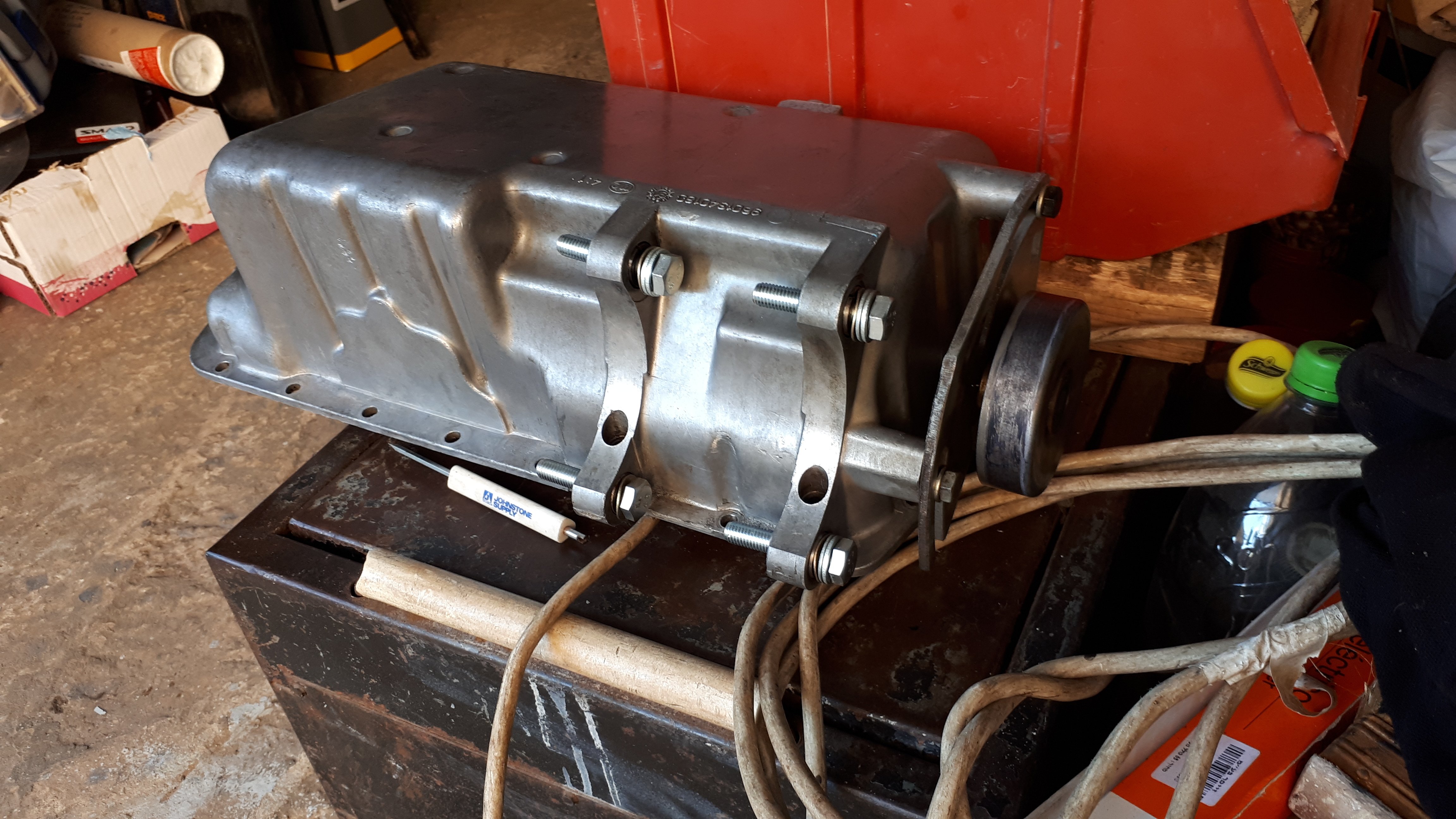

Hi, i have 205 with factory air con and my sump is leaking.
i saw the prevoius owner used a gasket (which is hard as a rock hence why it's leaking) but the peugeot manual says to replace the gasket with rtv when you have air con - which i want to avoid if possible.
My question is can i get away with using  the regular gasket or i have to use the rtv (i have both) ?

Generally speaking, on an alloy sump (like yours) I would always use a good quality RTV in preference - you have to ensure that the surfaces are fully degreased and won't get contaminated before the RTV fully sets though, which can be a pain with the engine in-situ and oil running down the inside surfaces of the block.  A gasket will usually work OK though.
No gasket and ThreeBond 1211.

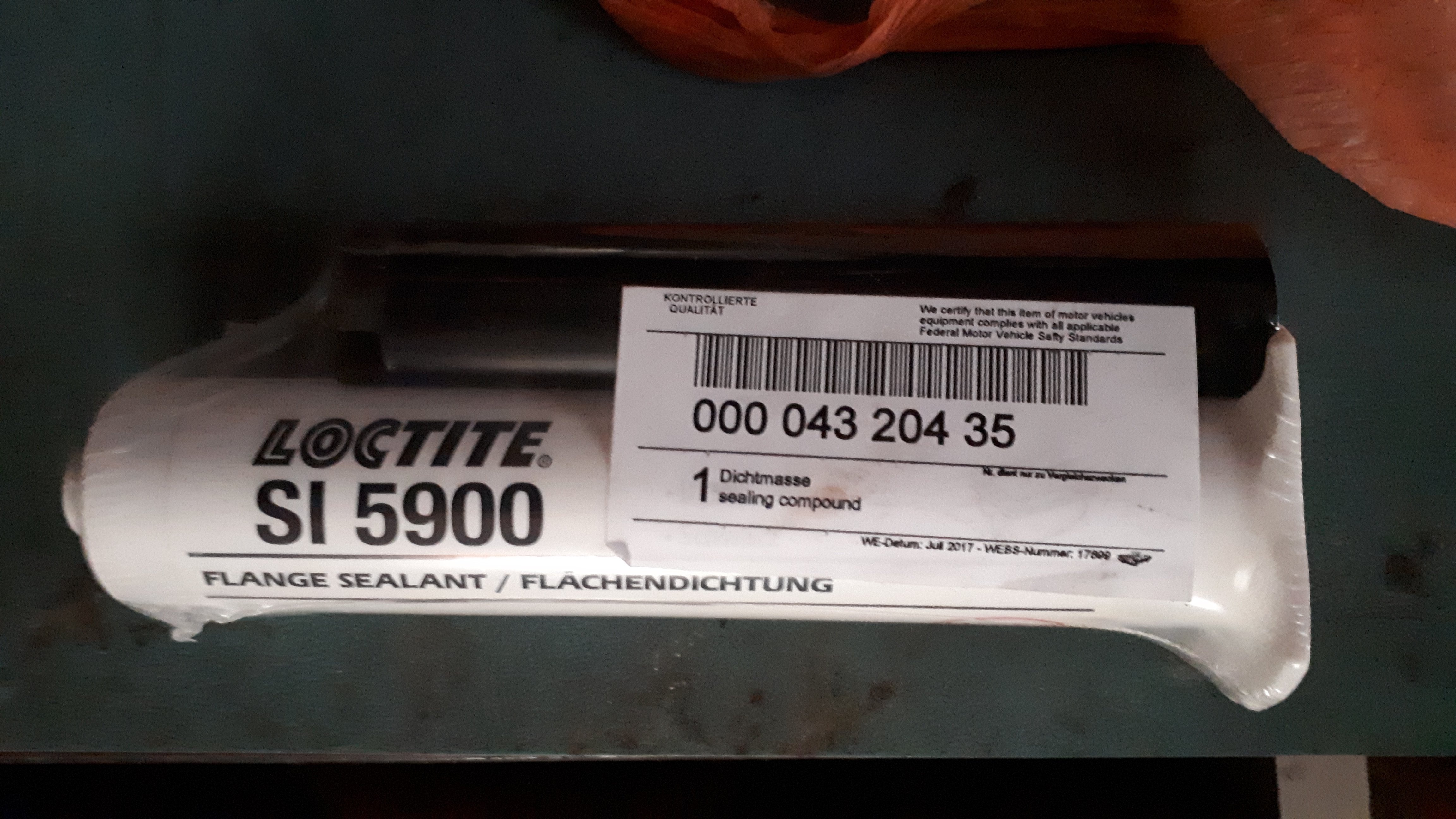

This is sealent that i have which was recommanded by loctite for this application.
The original sealent was
Autojoint AJ 66  (peugeot part # 9735.69)
Which was a loctite product hense why i contact them for replacement.
I'm not a fan, but go for it. The world has come a long way since 1986. You'll appreciate 1211 when it comes time to remove it.
I think everyone has their various favourite sealant.
I use Wurth RTV silicone, or Stag Wellseal. Depends on the application.
