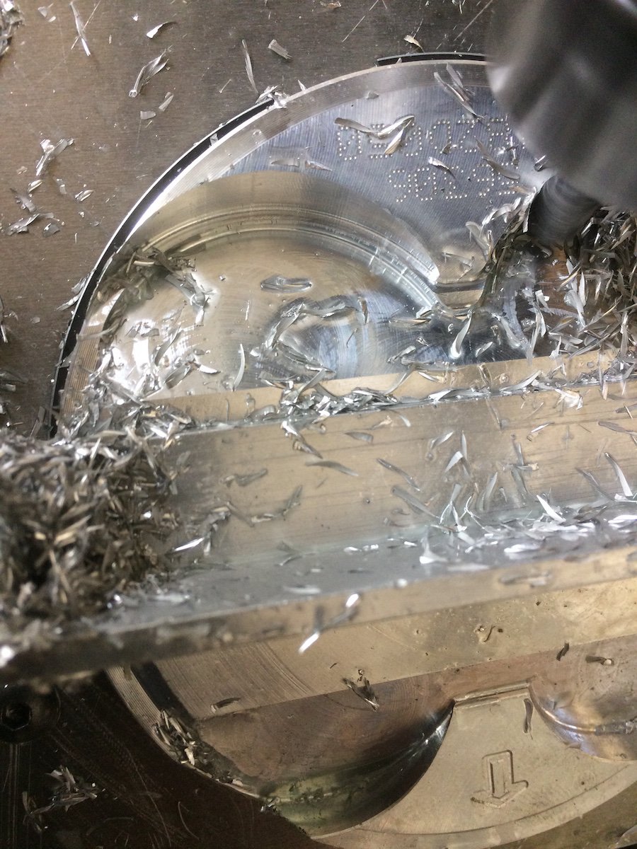

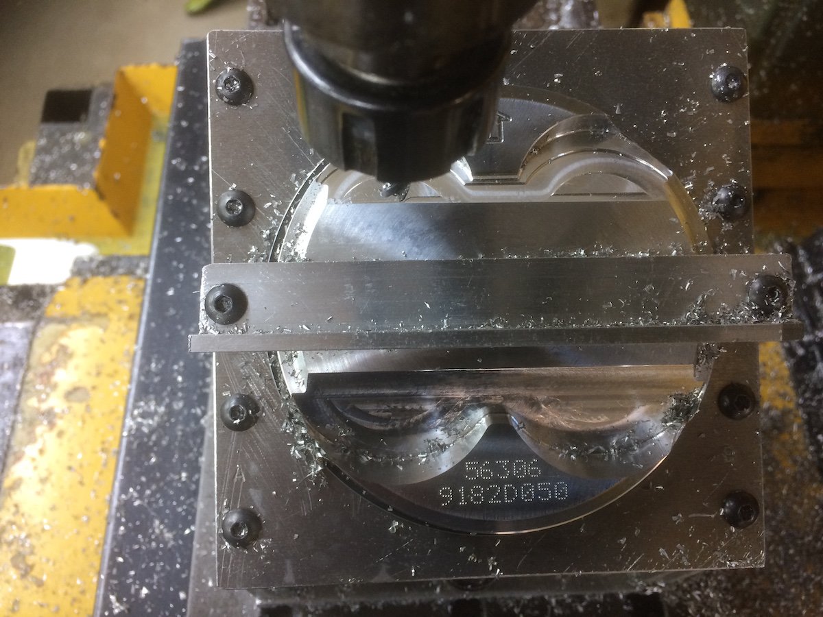

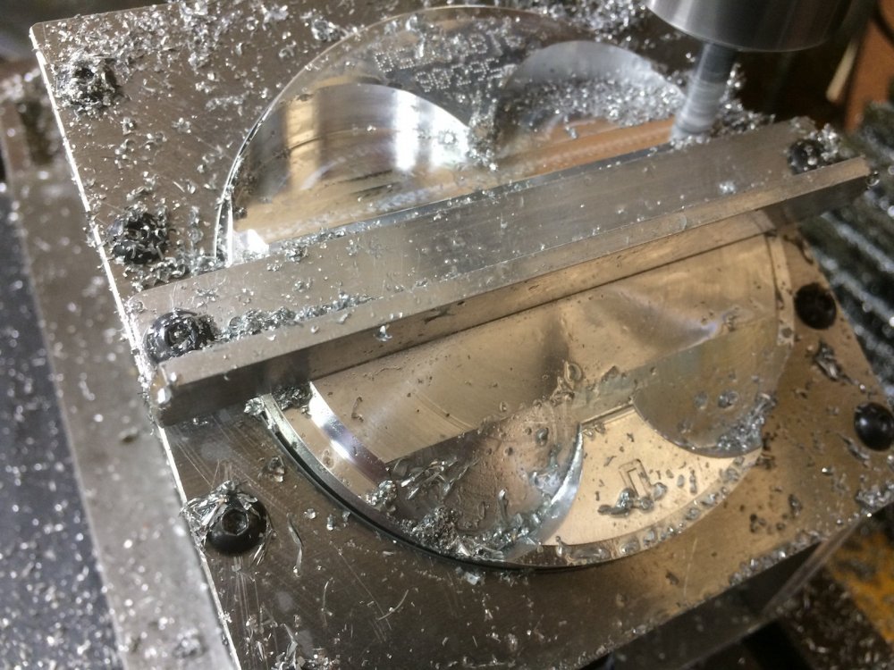

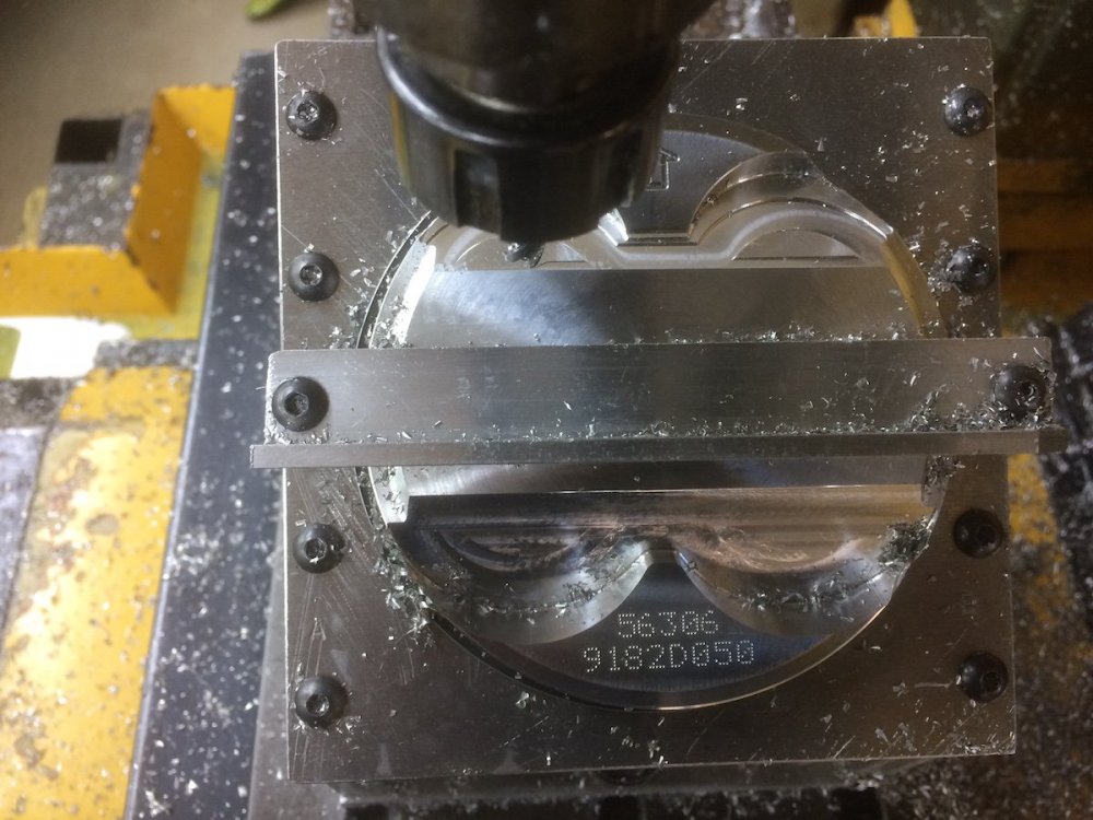

petert 607 Posted September 19, 2018 I finally got around to doing something with some Wossner GTi6 K9182D050 pistons I picked up cheap. They're going into an XU10J4 block with an XU9J4 head, fitted with 36.5/30.0mm valves and some lairy cams. I had to take a bit off the dome, otherwise they would have been 14:1. The other issue is the radial clearance required for the larger valves. I had to go 0.5mm deeper as well, to get the lift @ TDC clearance correct. They really are cheap and nasty pistons. The deck isn't even parallel to the pin. Share this post Link to post Share on other sites

petert 607 Posted September 21, 2018 It gets worse. I started cutting the exhaust pockets today, with a program I've used many times before. It seems the centres for the exhaust valves aren't anyway near where they're supposed to be. From the picture, you can see there is approximately a 4mm gap on the periphery. At least it's in a safe direction. There's no chance of ever hitting an exhaust valve radially. But what about the lost compression? I'll have to make a special program to clean it up. 1 Share this post Link to post Share on other sites
Andy 105 1 Cars Posted September 22, 2018 It looks as if Wossner have machined very large valve pockets for both inlet and exhaust as some kind of generic solution and then put a significant intruder dome to compensate . Shame that they could not centre up the pockets . I am feeling worse by the minute . If I take my Wossners any where near Guy Croft he will throw them in the bin Andy Share this post Link to post Share on other sites
allanallen 528 2 Cars Posted September 22, 2018 Certainly looking like they’re just a generic 16v piston with the pin size and height machined in to sort of suit the application, rubbish. Nice jig pete 1 Share this post Link to post Share on other sites
petert 607 Posted September 23, 2018 I ended up running the program as is, leaving that step to a depth of 1.2mm. I'll blend it in with the dremel so there isn't a hot spot. CR finishes at 12.1:1 with a 0.7mm gasket or 12.4:1 with a 0.5mm gasket. I'll run the later and it will be fine. Share this post Link to post Share on other sites
