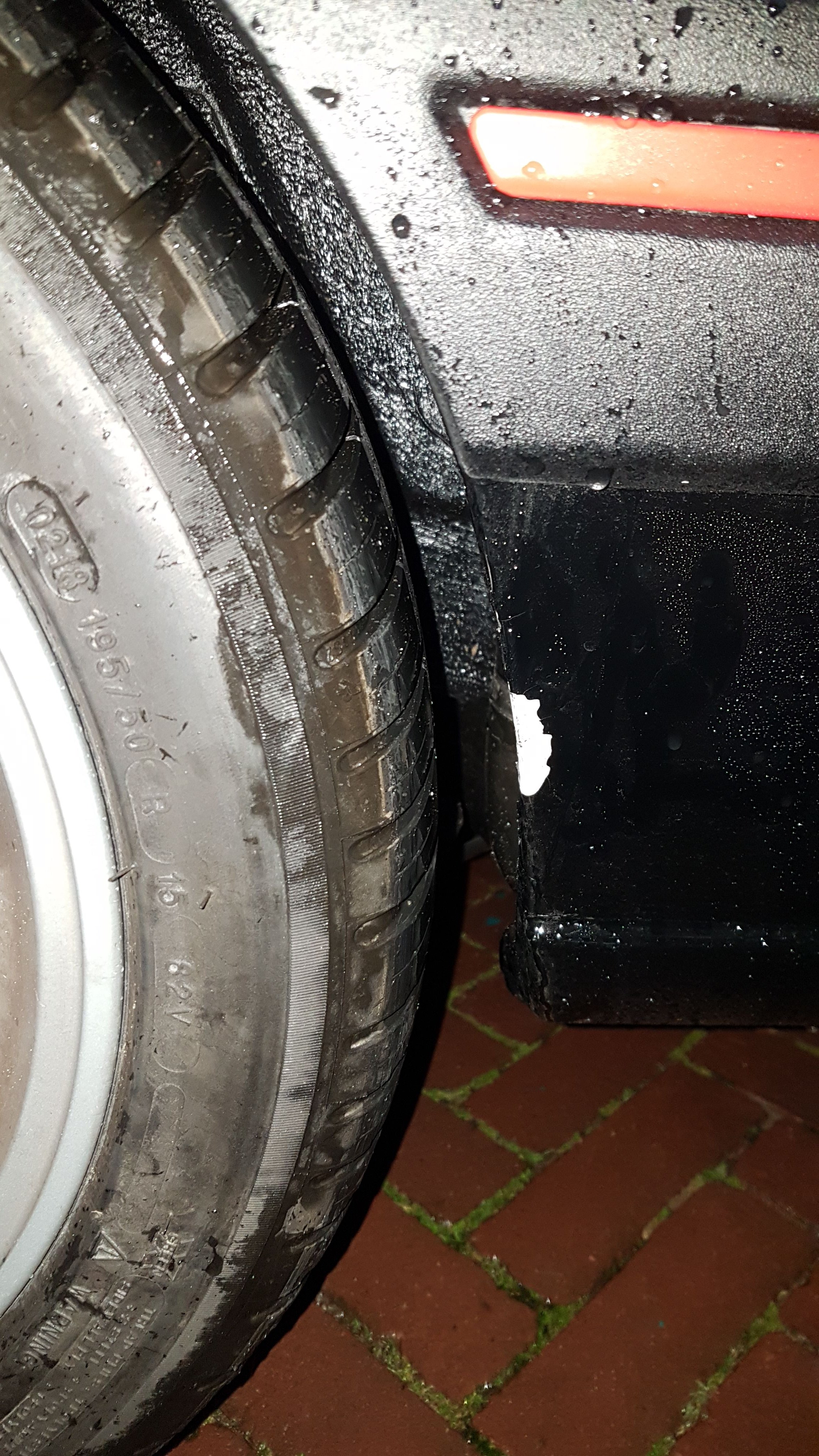

Was supposed to leave for France in a few hours, after putting all the stuff in the car, and taking it for the last shopping run, i noticed a scraping sound coming from the rear right side when cornering to the left..
After inspecting what could be the cause, i noticed the wheel had hit de metal in front of the wheel..

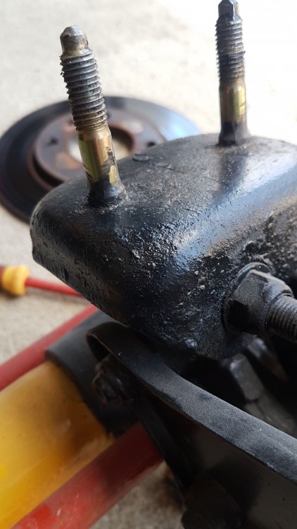

Rubber mount on the back seems to be ok, after jacking up the car i dont notice any movement, just a screecing sound...
What could be causing this ?

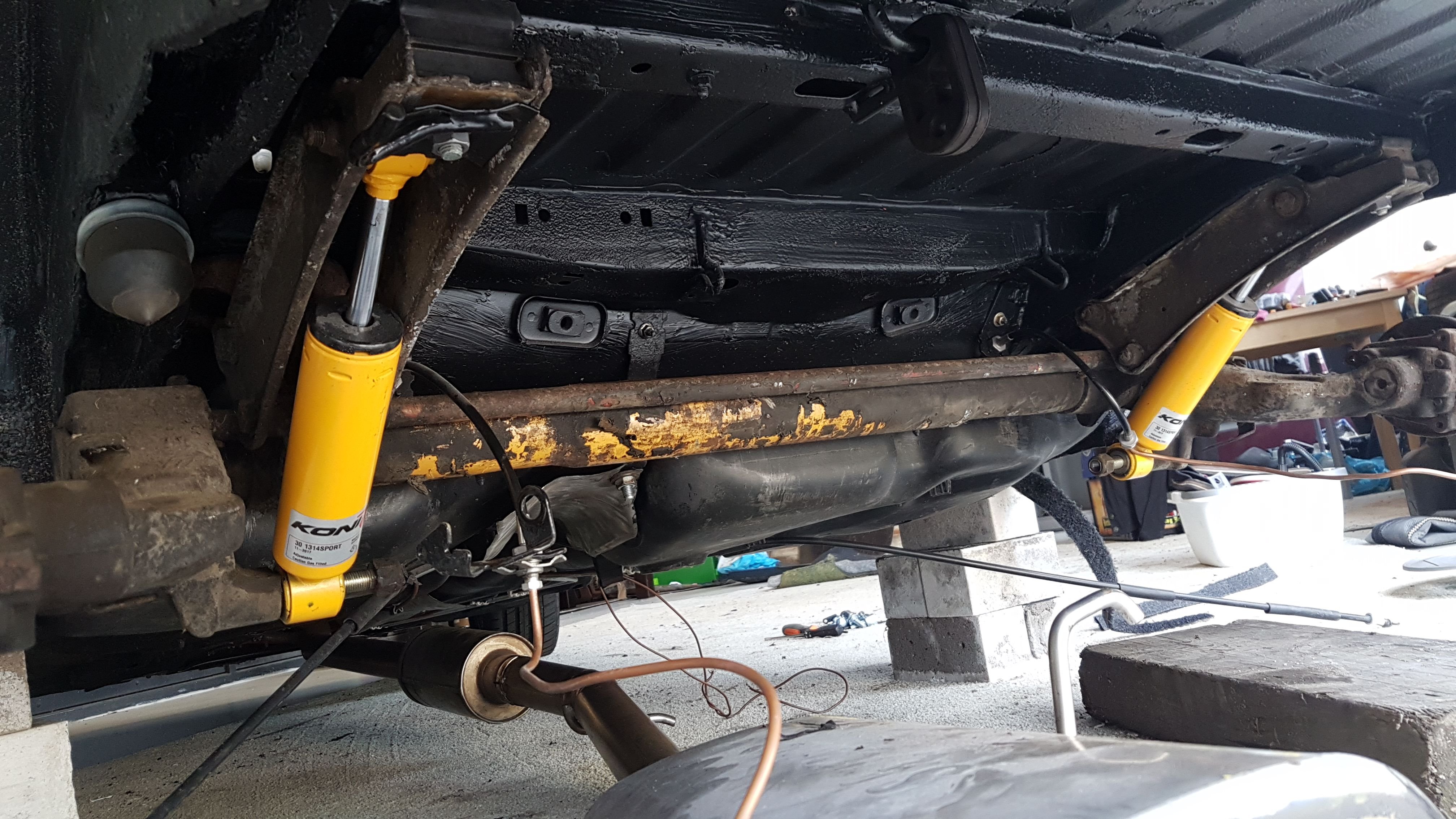

the bearings in the tube have failed.
probably needs a new cross member as they don't often salvage when gone that far
you can use a basemodel tube if you can't find a decent gti  item
also probably missing a bump stop.

Missing bumpstop is true, replaced the whole axel from a second GTI, which is in standard heigth, after some hard testing, problem is over :)
On the original axel, i noticed this "thingie" isnt as stiff as the one on the left, and on the other axel..the rubber must be worn out.
