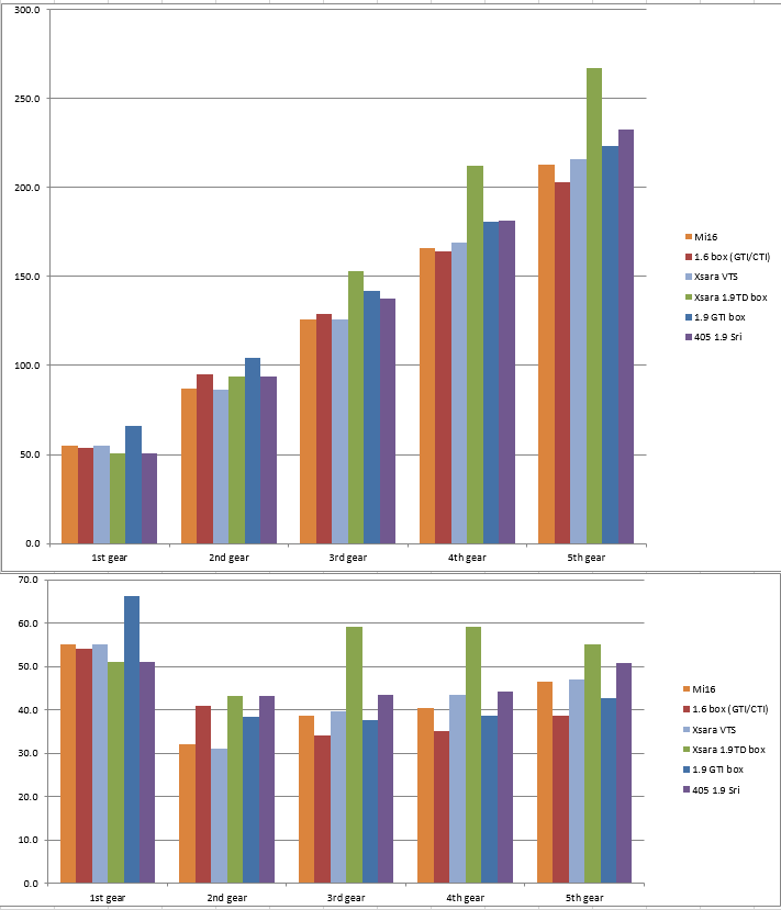

The gearing of the 405 SRi box, next to some other boxes plotted below...  (in km/h)
Currently I'm using the 1.9TD box and like the long gears on high ways, but the gap from 2nd to 3th is a bit too much on mountain roads/tracks.
For my new engine I would like to have that a bit shorter, but don't like long 2nd gear from the 1.9 gti box in hairpins either.
The upper graph is speed at 6500rpm. Second graph is the speed change through the gear until 6500rpm.
I'm still considering to swap the 5th for the 1.9td 5th, make the 5th gear as long as the 1.9TD 5th...
