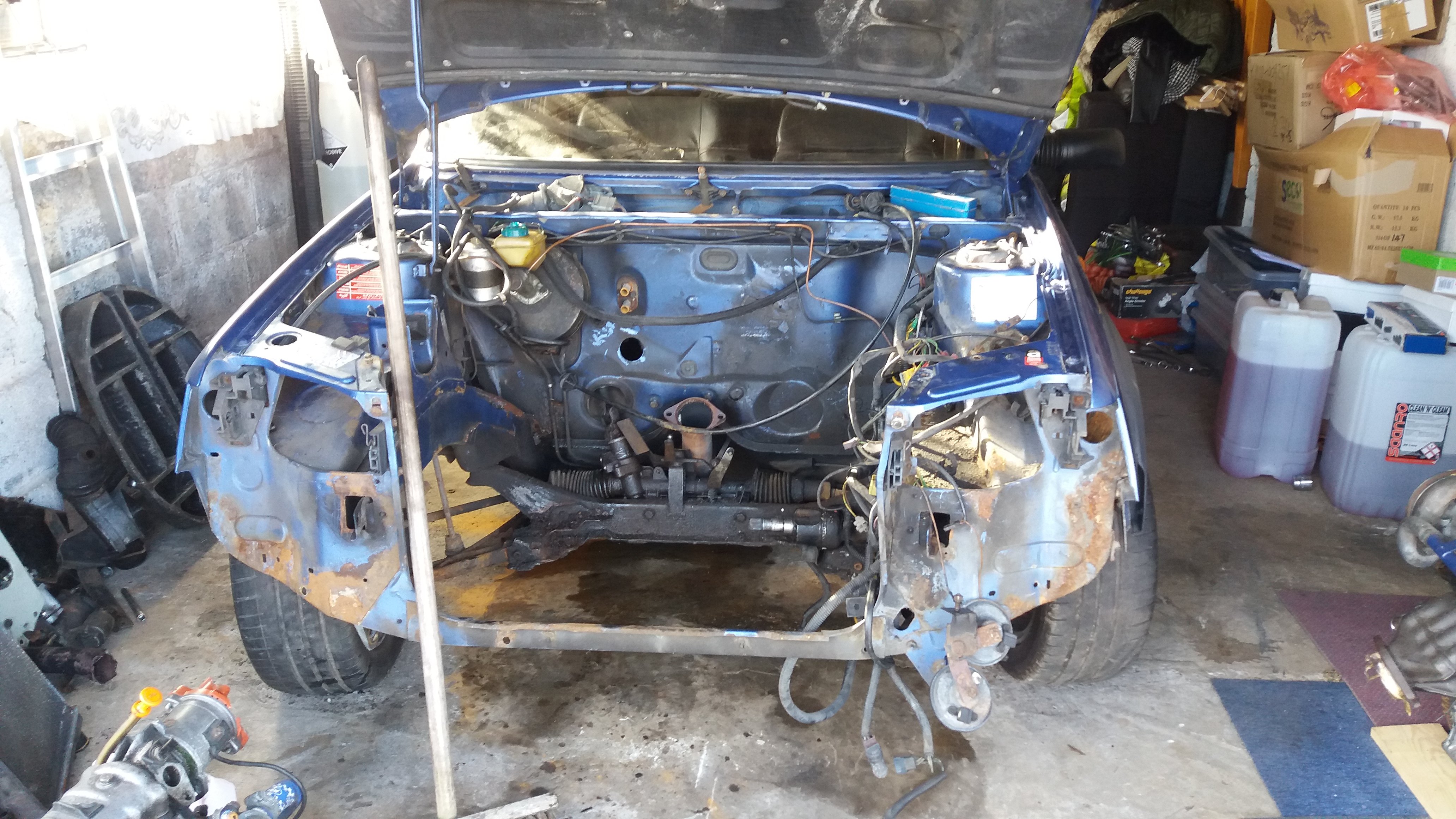

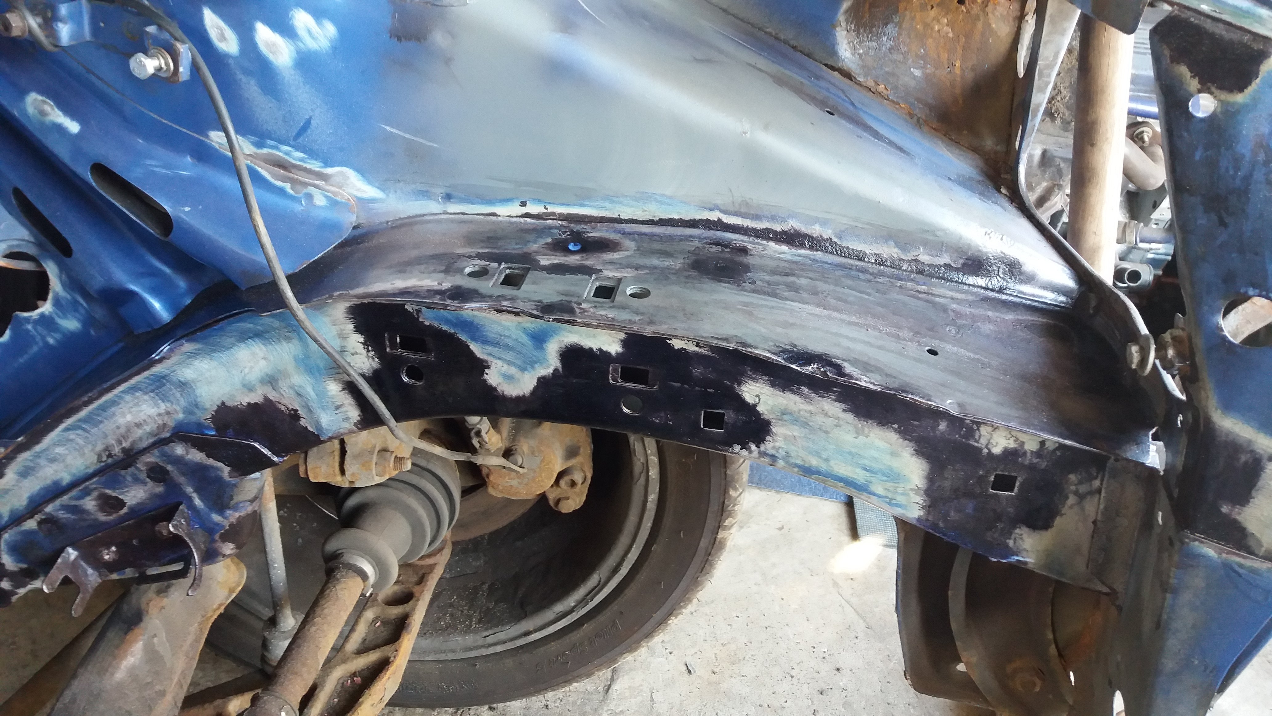

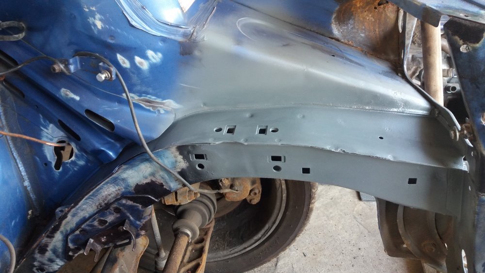

dwainb1986 3 Posted July 25, 2018 (edited) Hi everyone. Firstly im new to this forum and new to car restoration!! But i guess everyone has to learn and start somewhere ? Right i bought a 205 gti 1.6 miami blue g reg in may with a blown engine , my intension was to refit a new engine and use as a weekend toy but after removing the old engine and a spot of luck i found a 1.9 alloy block mi16 that was sat in a shed for 9 years and has never been fitted since the fella fully rebuild it ! Best thing about it was it was only 250 pounds and came with everything needed to slot into a 205 ☺ anyways as many of you know the 205s it soon came clear this was going to be quite a project.. once i started i realised alot needed doing e.g RUST .. the more things i took of the more i decided to do a full restoration and id need to replace lots of parts afterall it would be silly just doing a swap and leaving the car tatty!! So all the helpfull advice people are willing to give will be great. Few things im stuck with is as ive ground down bubble rust back to bare metal ive then treated it with hamerite krust ,is this the best way and then what primer would be best ? Im doing the bay myself but when finally finished il treat it to a full respray ... ive a few pics of the progress if any1 could share some advice on best ways to do things or what ive done wrong! Could some1 please tell me what that is in 1 of the pics where the brake pipes go into as i cant seem to find 1 .thanks guys Edited July 25, 2018 by dwainb1986 Share this post Link to post Share on other sites

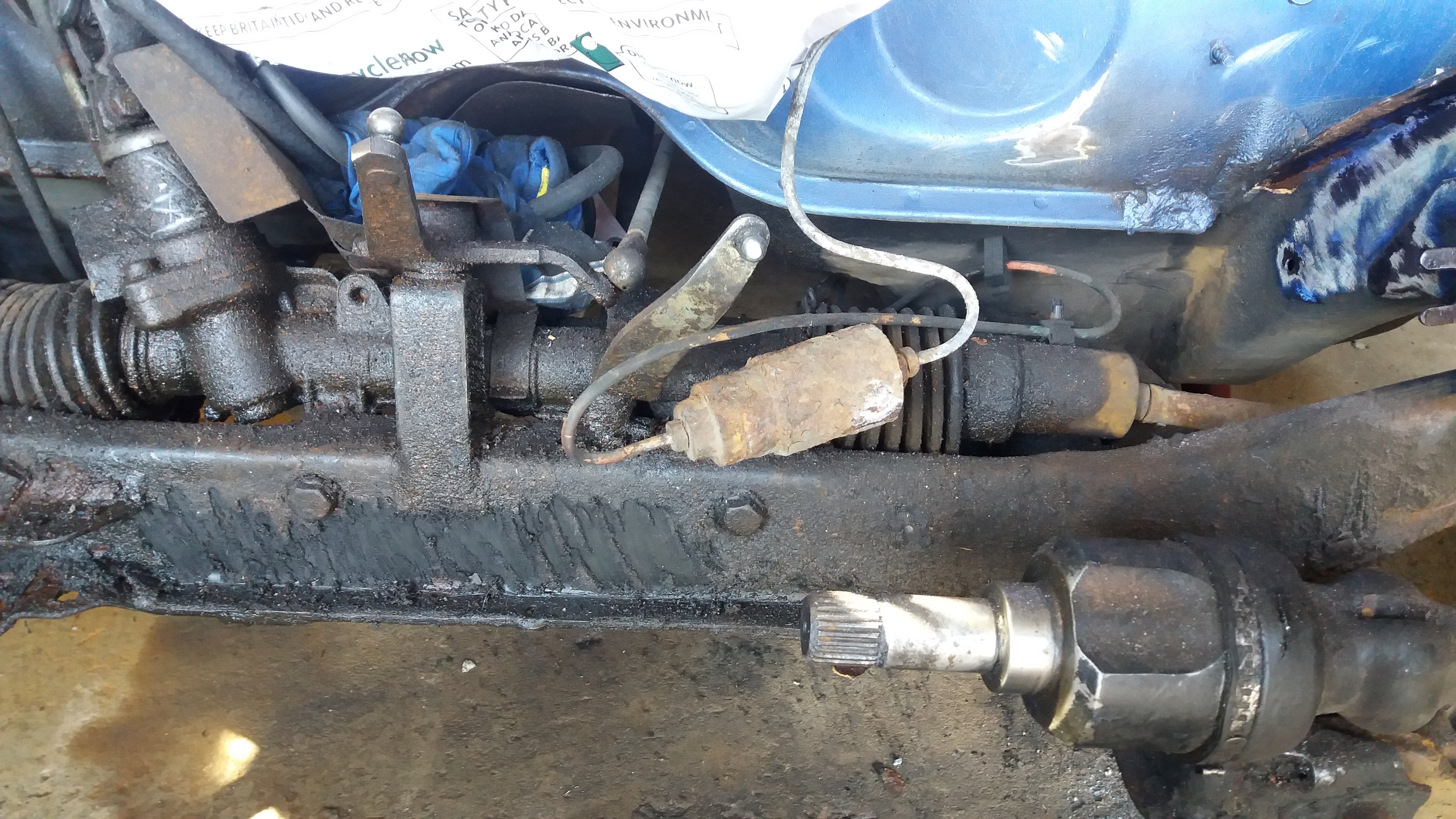

jackherer 543 Posted July 25, 2018 On 7/25/2018 at 4:46 PM, dwainb1986 said: Could some1 please tell me what that is in 1 of the pics where the brake pipes go into as i cant seem to find 1 That is the 1.6 rear brake compensator. Share this post Link to post Share on other sites
dwainb1986 3 Posted July 25, 2018 Thankyou will that be good enough for the swap? The car currently has 1.9 brakes on the front and its also had rear disk conversion with gti6 callipers Share this post Link to post Share on other sites
jackherer 543 Posted July 25, 2018 The only 205 I've had with a 1.6 compensator also had wilwood 4 pots and 1.9 rear discs and it worked fine on that so yours should be fine too. It works via inertia and it has to be fitted in the right direction relative to travel for it to work properly. Share this post Link to post Share on other sites
Anthony 1,003 Posted July 25, 2018 As above really - in my experience the 1.6 compensator works perfectly with 1.9 brakes all round and I've run several cars in that configuration. Indeed, in some ways I prefer it as that compensator seems far more reliable than the individual 1.9 type. Share this post Link to post Share on other sites

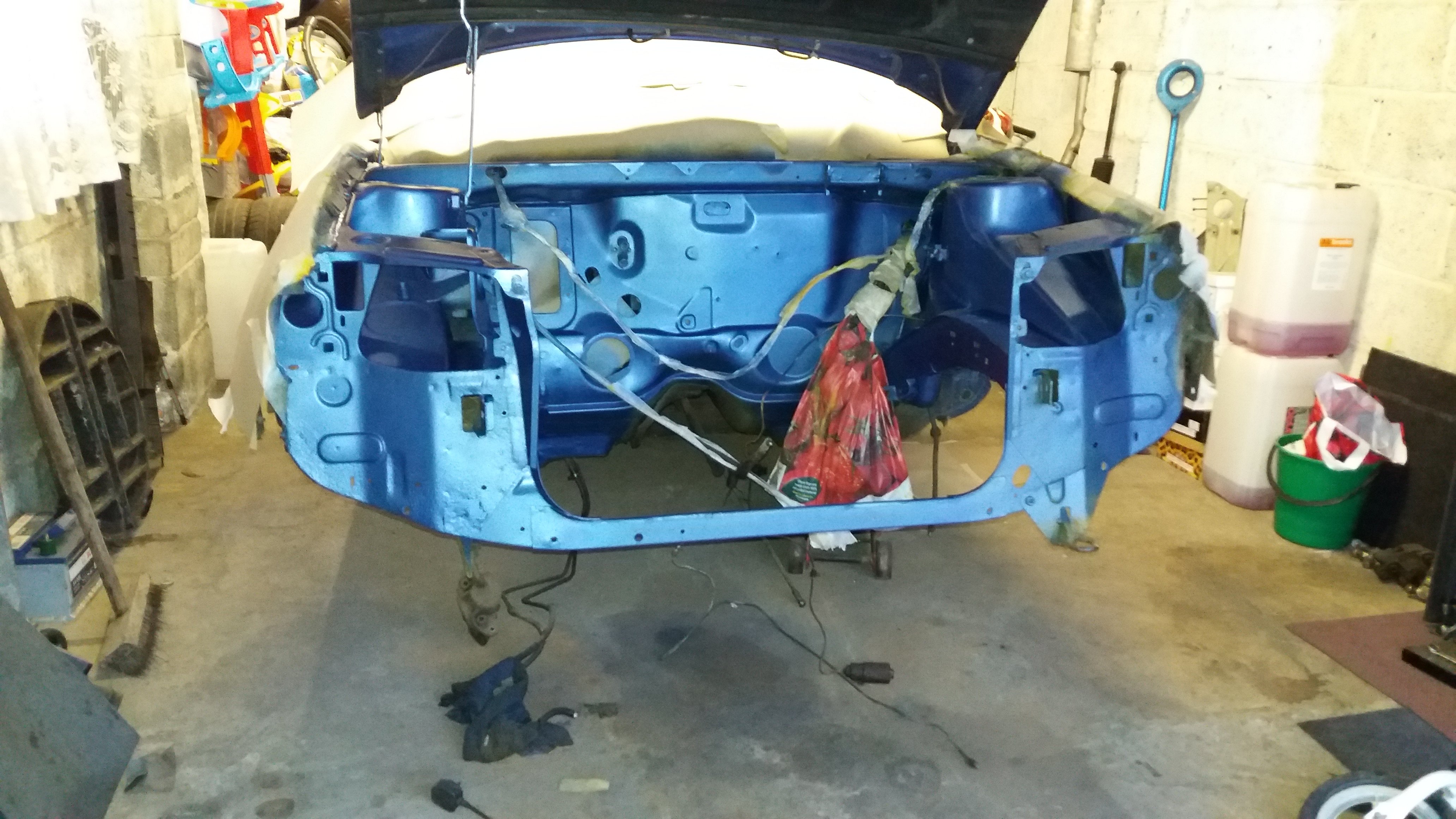

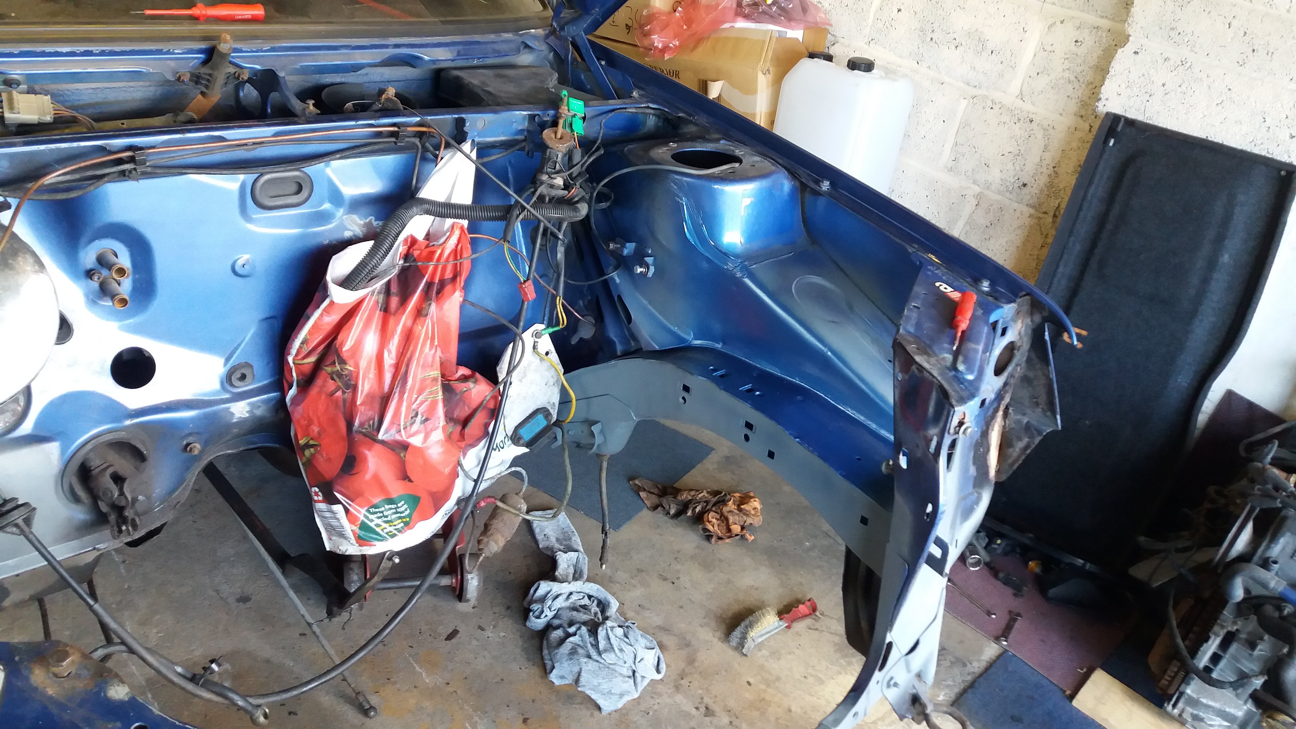

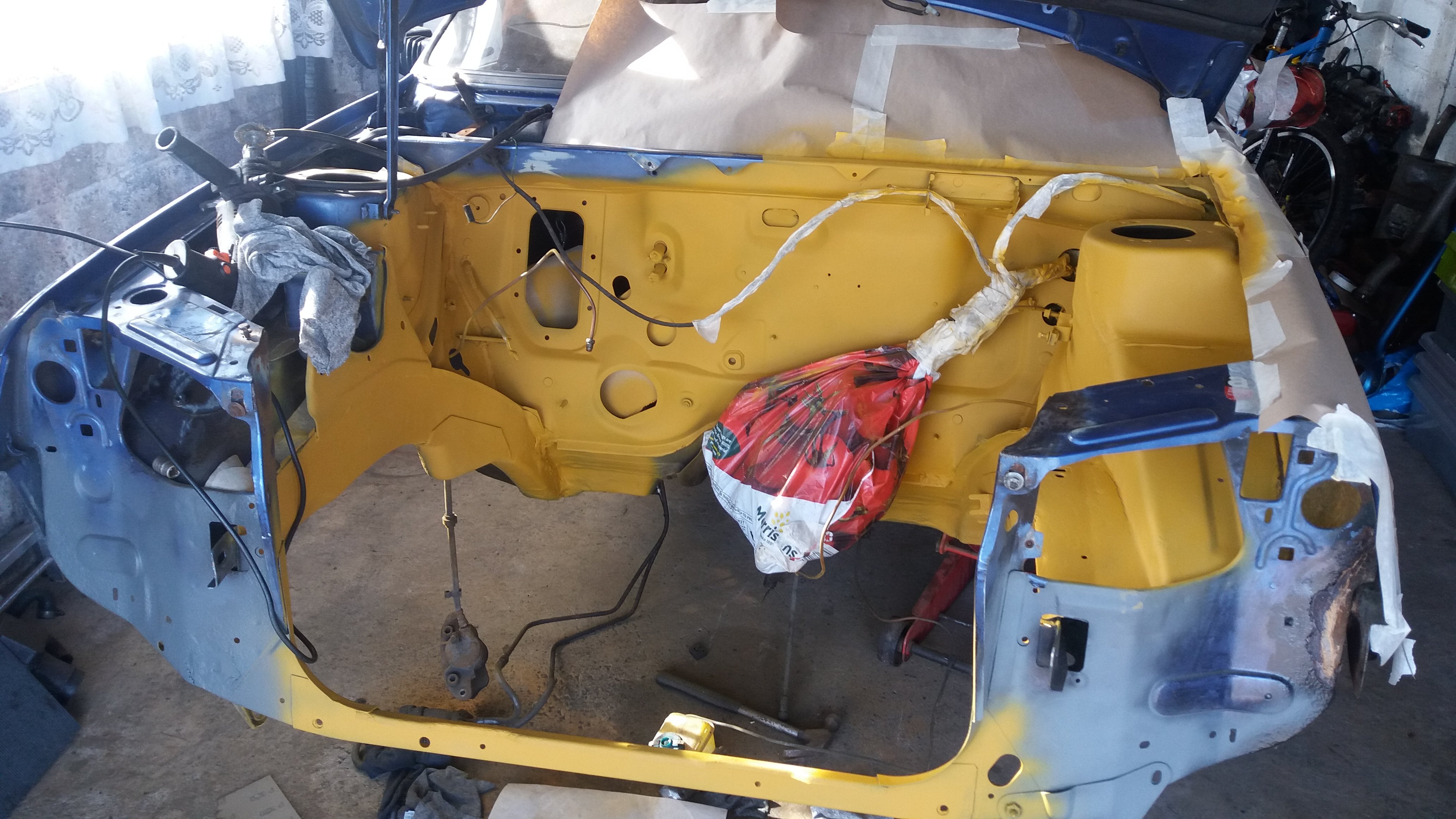

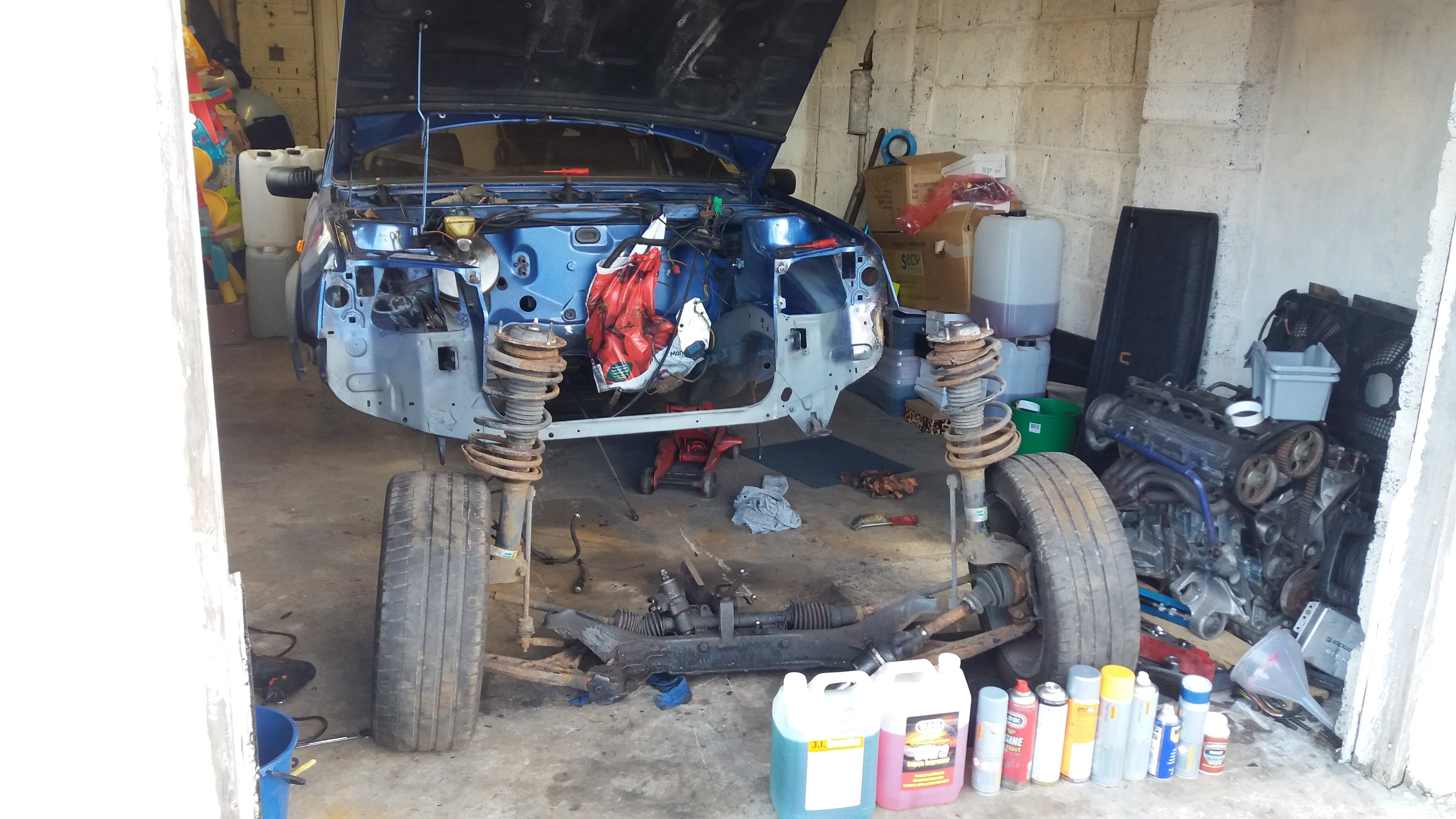

dwainb1986 3 Posted July 30, 2018 Little update . The more i have a go the more i seem to strip .. ive now decided to have the subframe coated with new arms droplinks bearings brakes rebuid .the main problem i have is ive got the limited edition miami blue on a g reg so reading many posts its a night mare to match up the paint!! A trip to halford after reading there miami blue was a match for my paint code m0my turned out to be a differnt shade .. but considering what it looked like before under the bonnet im sure a slightly differnt colour will stand out like a sore thumb?whats peoples thorts on this? I dont want to go through all this hard work and it look silly. Ive looked at so many pictures and alot of the bay will be unseen . Also what would the best underseal be to use ? Ive added few more pics so if any1 can advise on anything id be greatfull . Like i said in previous post this is all new to me so its also a learning curve. Share this post Link to post Share on other sites

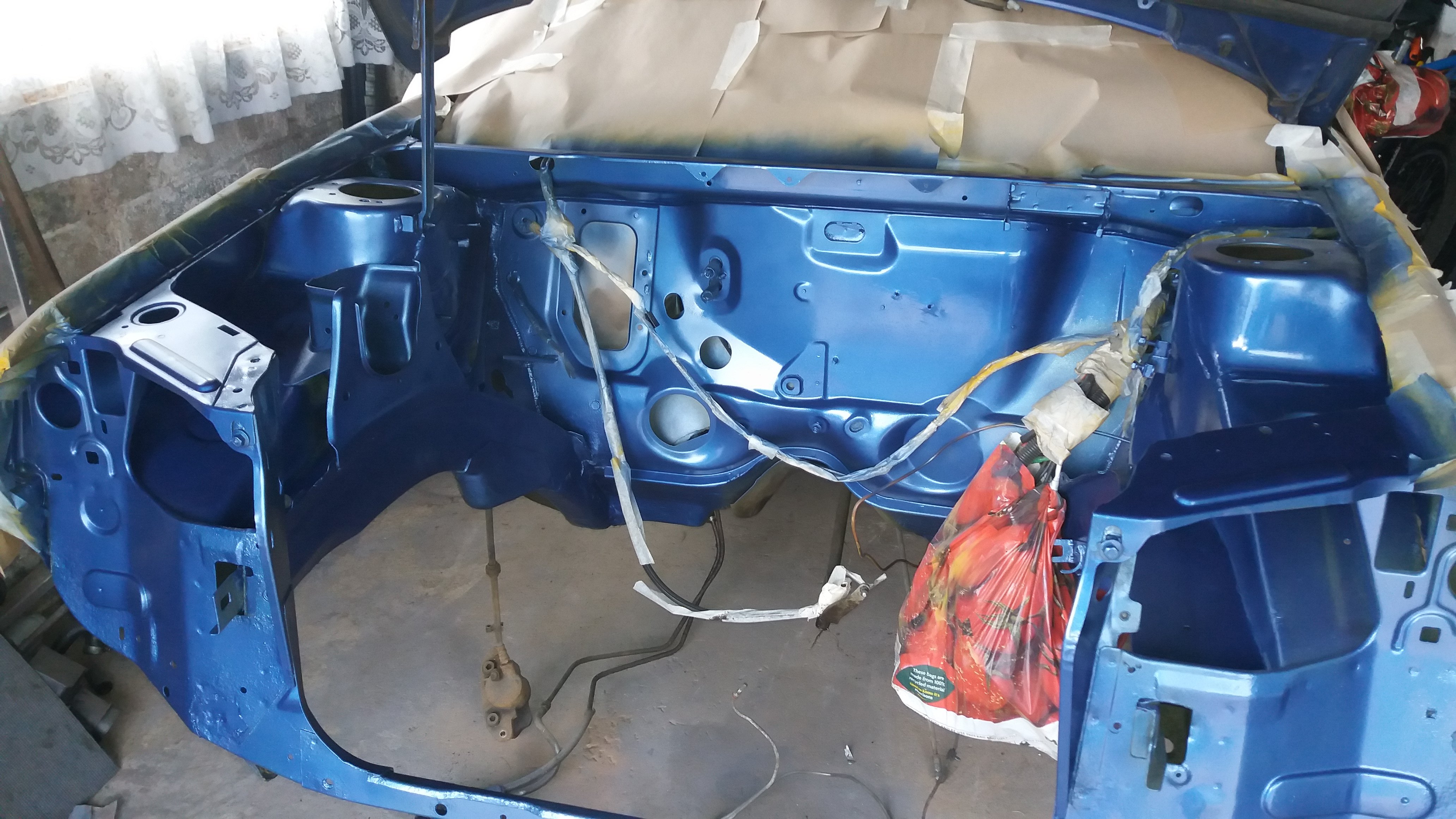

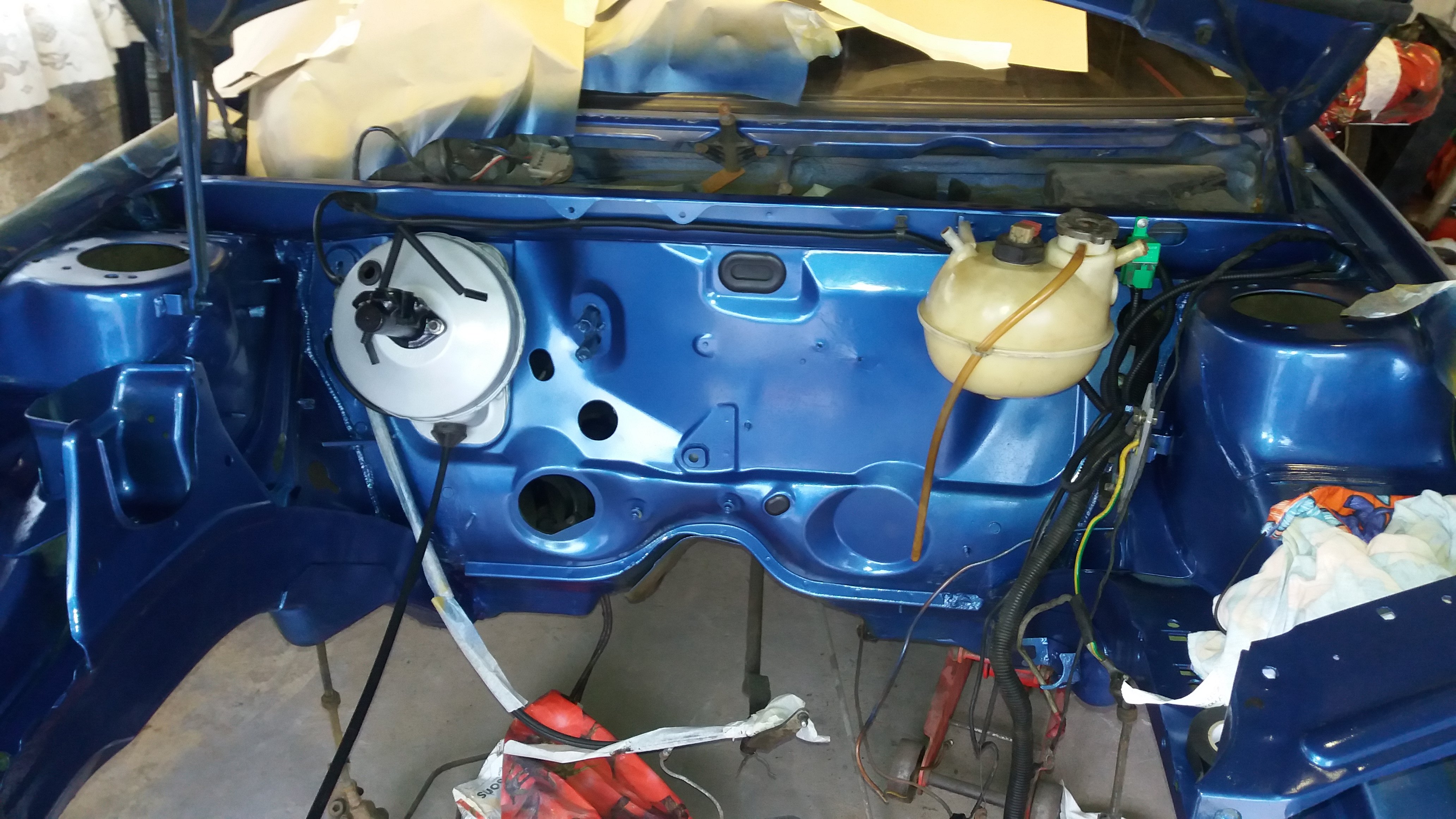

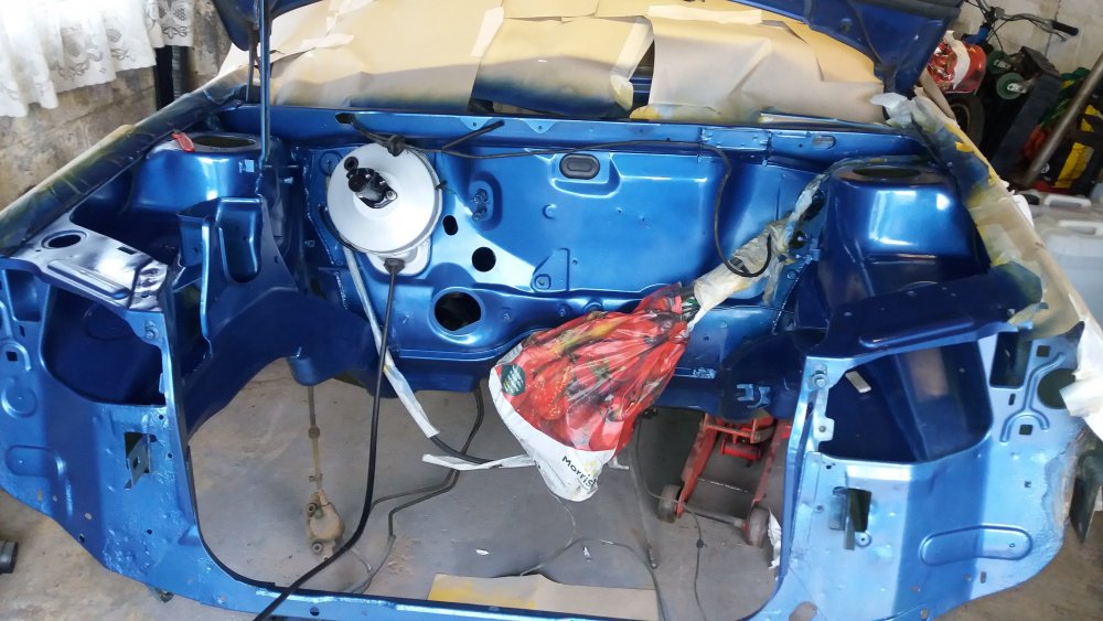

dwainb1986 3 Posted August 18, 2018 Slowly treated all the surface rust and painted the engine bay. I know its a slightly different shade but compared to the rust oil and dirt i think it looking good. Eventually when its due its respray il have the bay done to match the rest . Just having the sunframe coated at the min new arms drop links etc will soon be fitted and i will update more pics . 1 Share this post Link to post Share on other sites
dwainb1986 3 Posted August 21, 2018 Another couple of hours on the pug ! Juggling between work child and the MRS ... Managed to attach a few more parts light wiring is now out of the bag and in a state so slowly clean it tape and conceal the wires best i can . 1 Share this post Link to post Share on other sites

yeti-dj 7 Posted August 24, 2018 On 8/21/2018 at 9:00 PM, dwainb1986 said: Perfect.thankyou i was thinking o/s next to the strut but if it fits in the origional place id rather that. Hi, fit the ecu in the same place as the gti one came from, its a bit of a tight fit but does go. Regarding the brake compensator, I have the same set up of callipers on my GTI and run without any compensator, never locked the back brakes yet. good luck Share this post Link to post Share on other sites
dwainb1986 3 Posted August 24, 2018 Oh perfect !!! The compensator just looks old and rusty and trying to find a replacement is a nightmare !! So would i just bypass it and run a new brake line from the resevoir to the rear brakes? Share this post Link to post Share on other sites

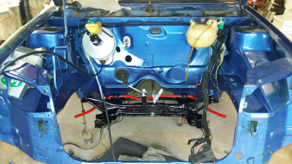

dwainb1986 3 Posted October 7, 2018 Hi everyone. Well as most projects go ive hit the lazy part where you get fed up and frustrated so you leave it a week and that week turns into months ! I have however managed to get the newly coated subframe back on and few other parts put in place. Im on with the hubs shocks etc . Im after a plug and play wiring loom or shortned inlet and exhaust if any1 has a spare lying around ? Let me know as these kits can be expensive .. Share this post Link to post Share on other sites

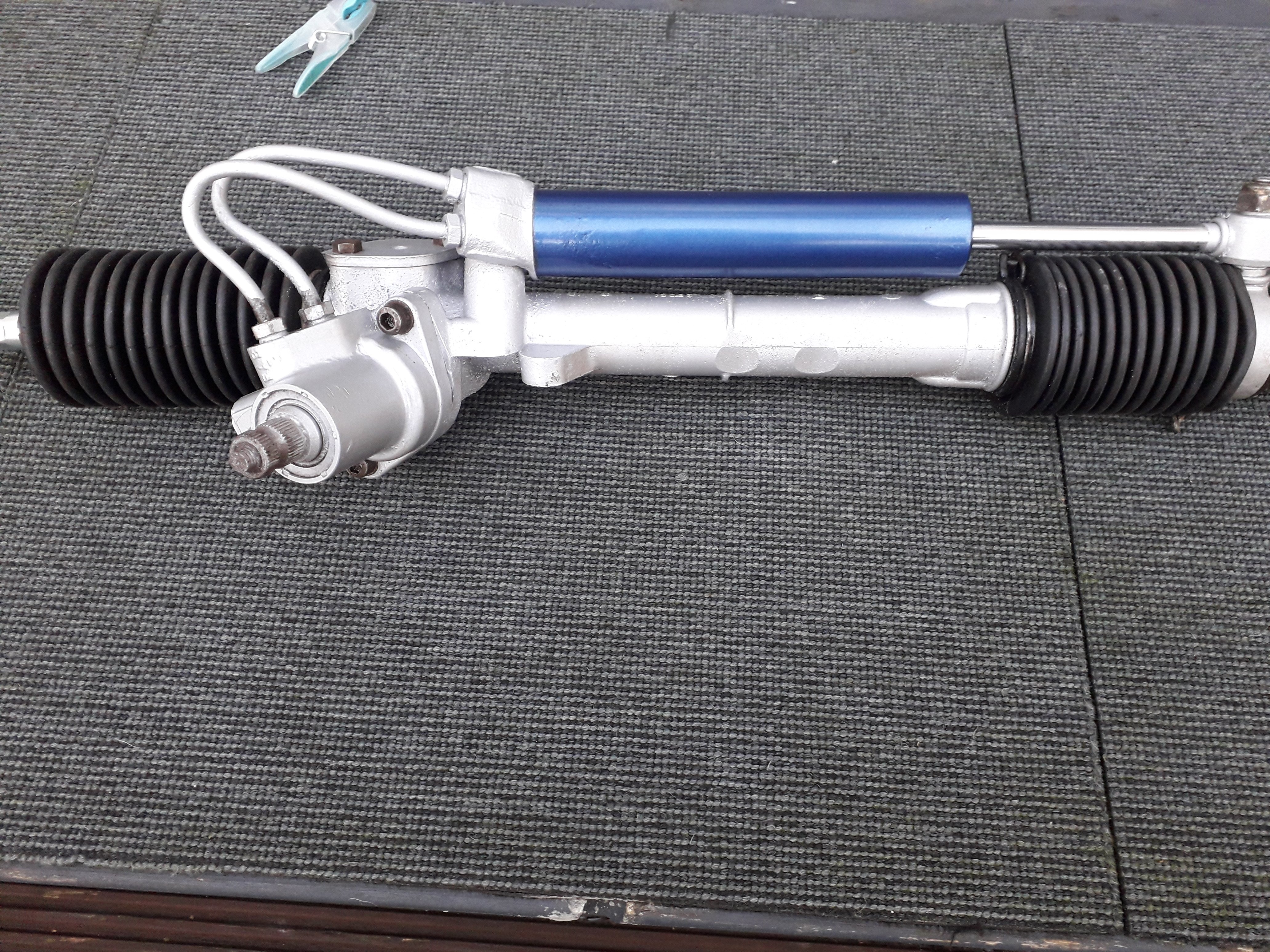

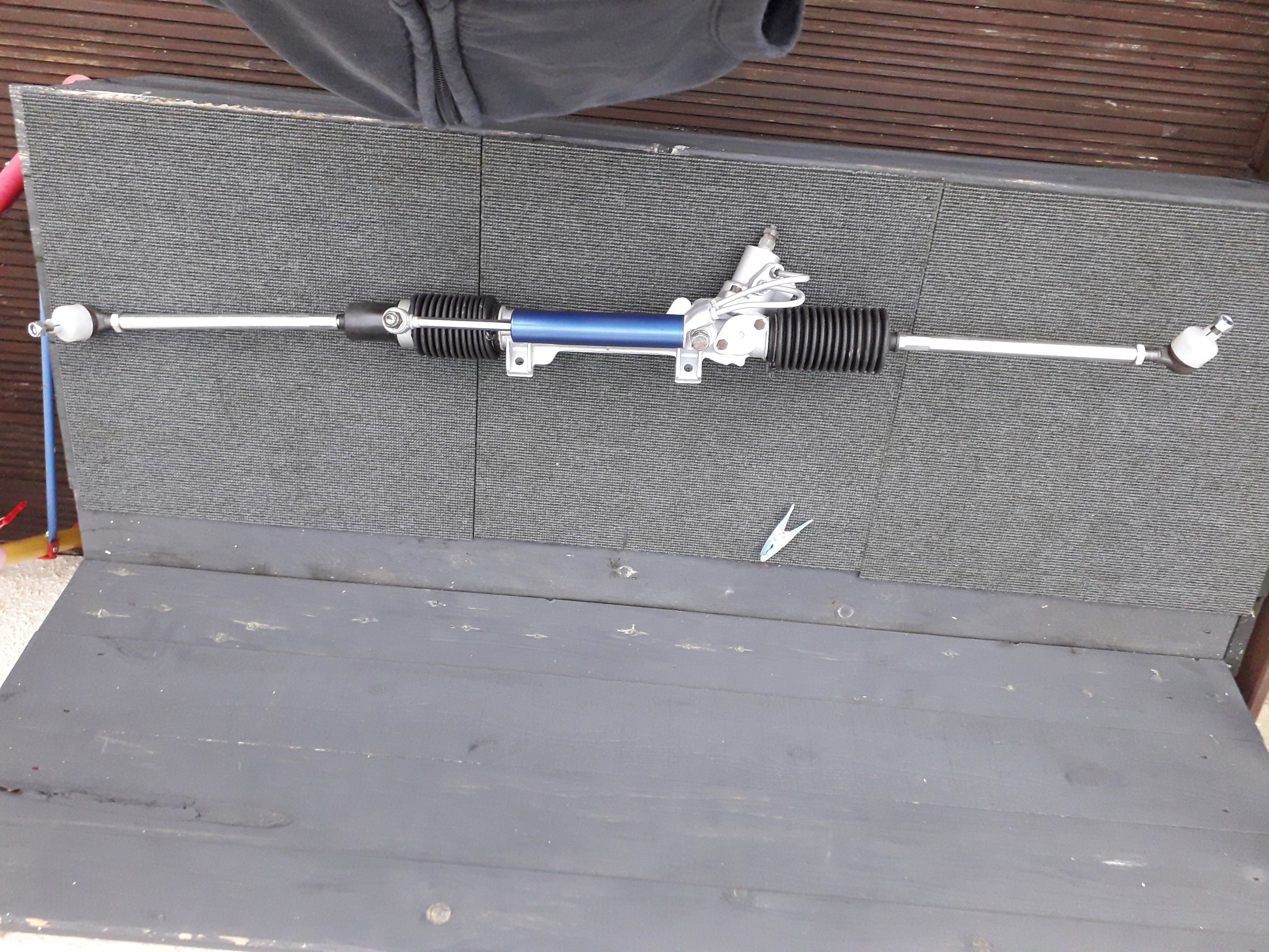

dwainb1986 3 Posted January 11, 2019 Quick update as had a major rethink lol Mi16 engine sadly now sold and original 1.6 going back in decided it was best original .. Anyways steering rack all rebuilt and cleaned fuel filter clamp back in and painted bottom arms now on almost ready to finally get of the axle stands and hit the floor for the first time in a year ha. Share this post Link to post Share on other sites
