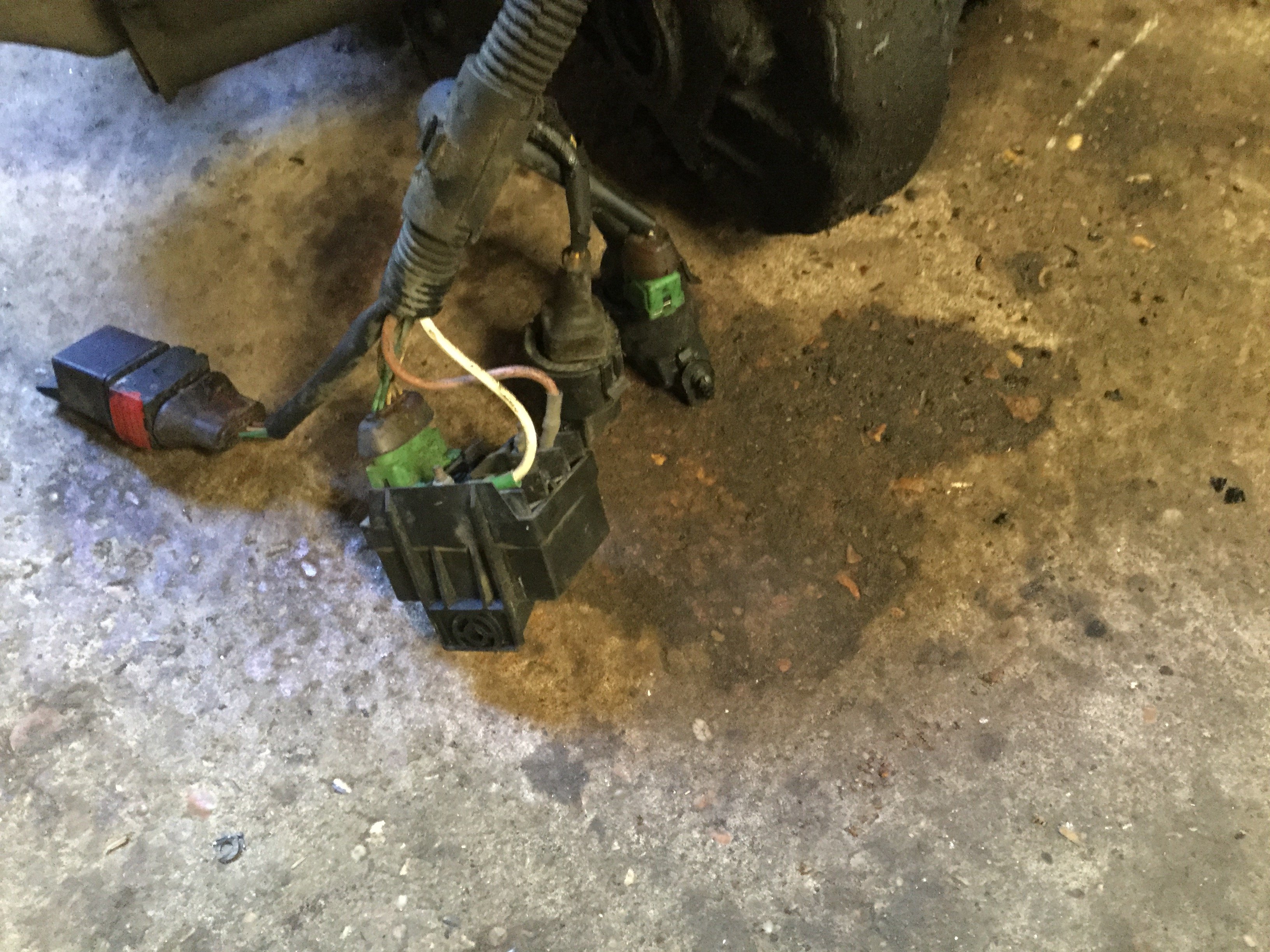

1. Engine I want to put in

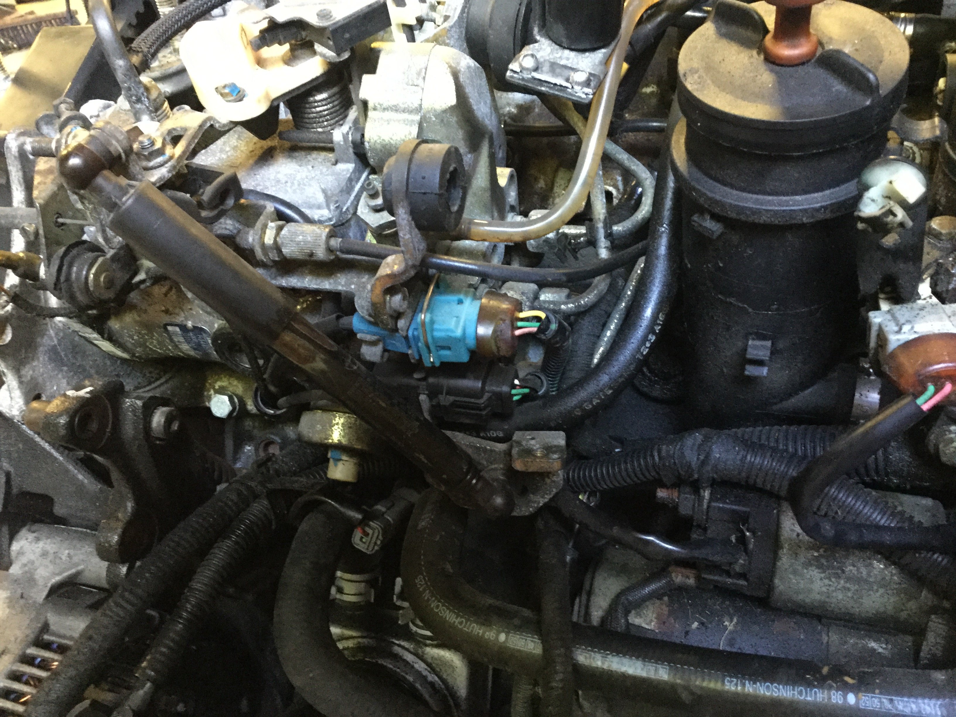

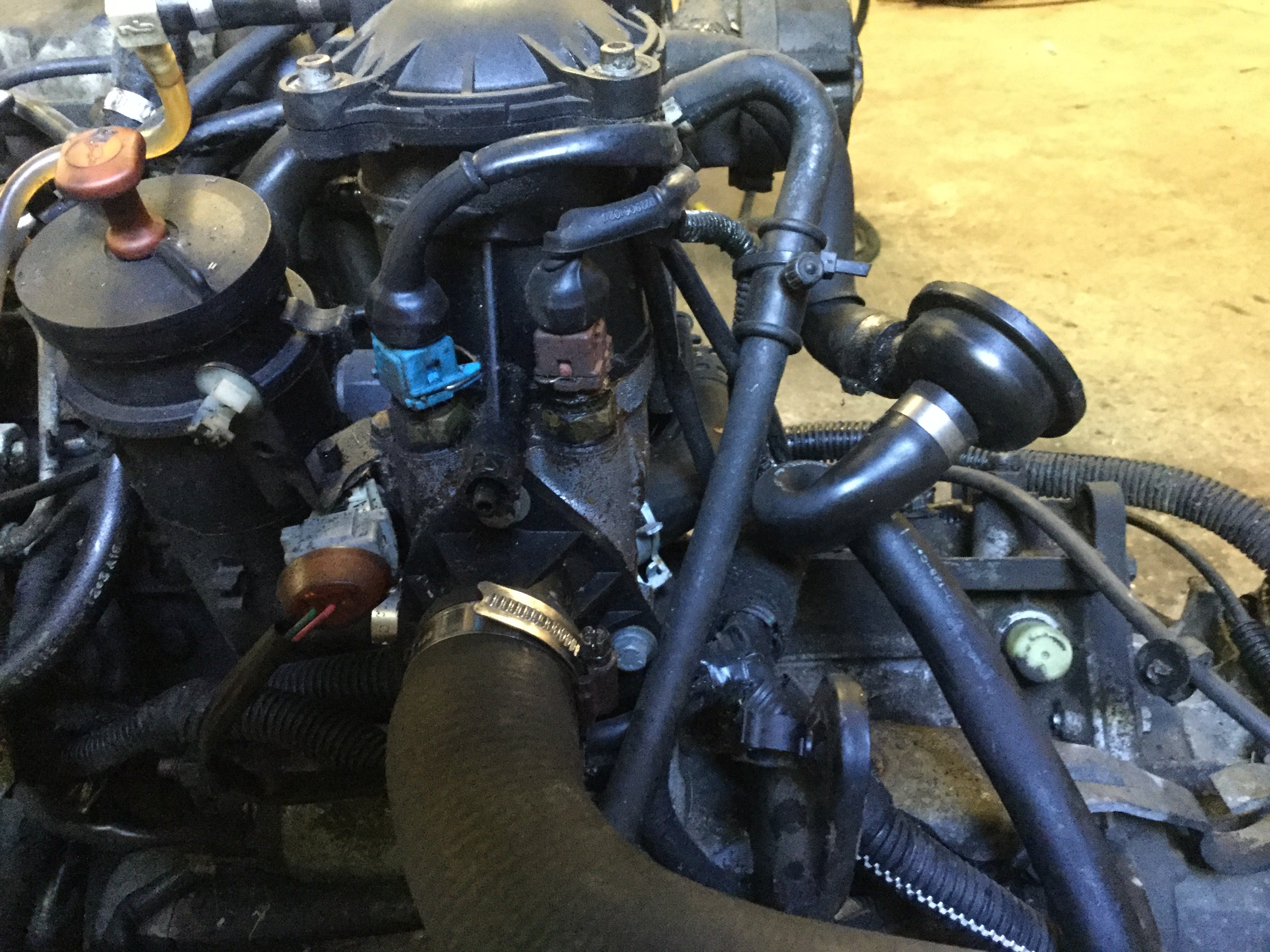

2.3.4Plugs on fuel pump and oil , alt ,

 But only connection out of loom are the 2 round plugs shown in bottom right of pic 1

I’d too the left hand sensor , in the 3rd pic down is that the grey plug with red wire on top , just above oil cooler pipes .

4th photo down, the blue plugged sensor on the left is what you need from your old engine, it does the overheat light.

The sensor with the grey plug and a red wire in the 3rd pic is for oil pressure ,use the oil pressure switch out of your old engine to mate to the 205 loom connector, its a simple Lucar blade.
