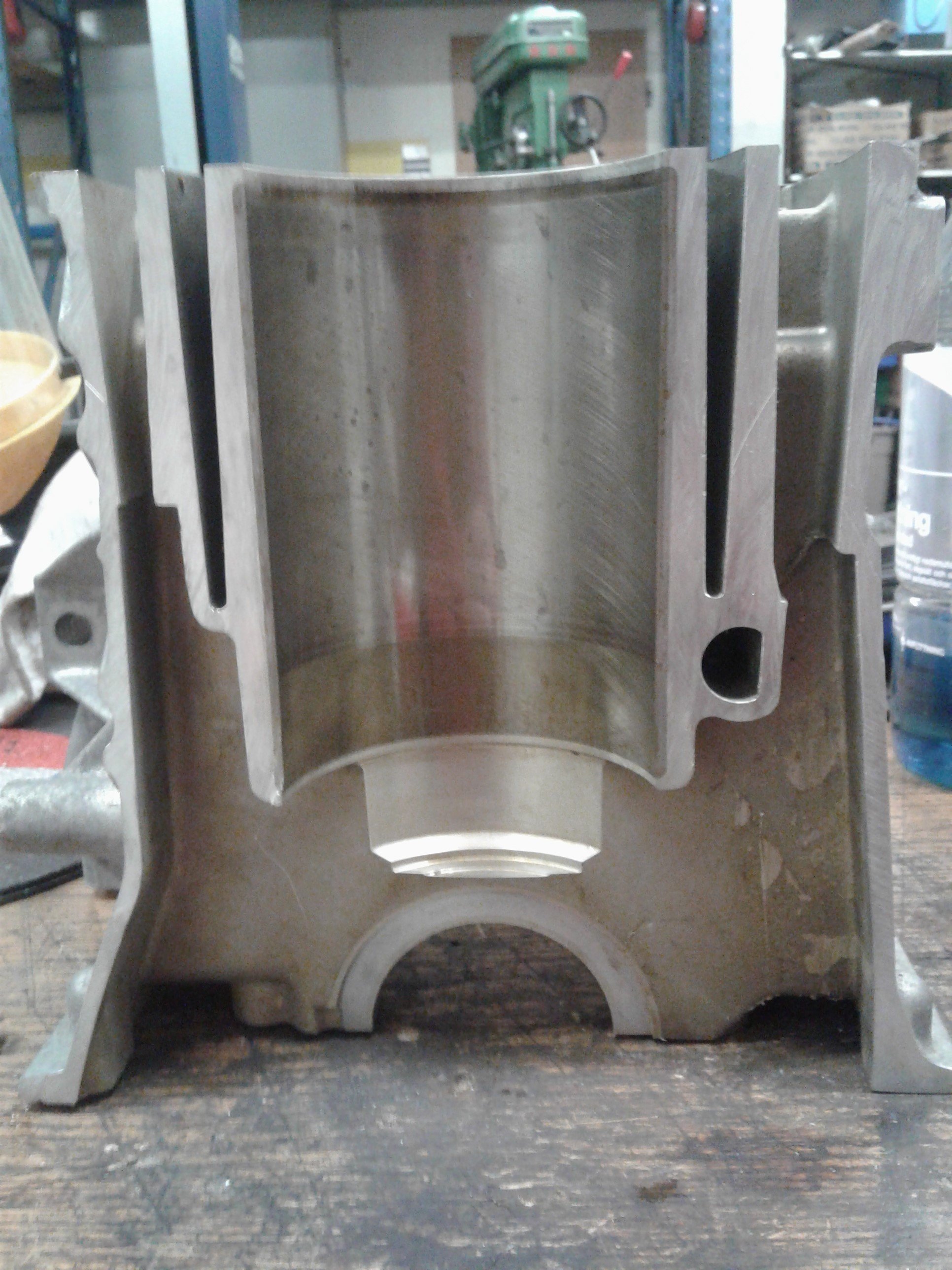

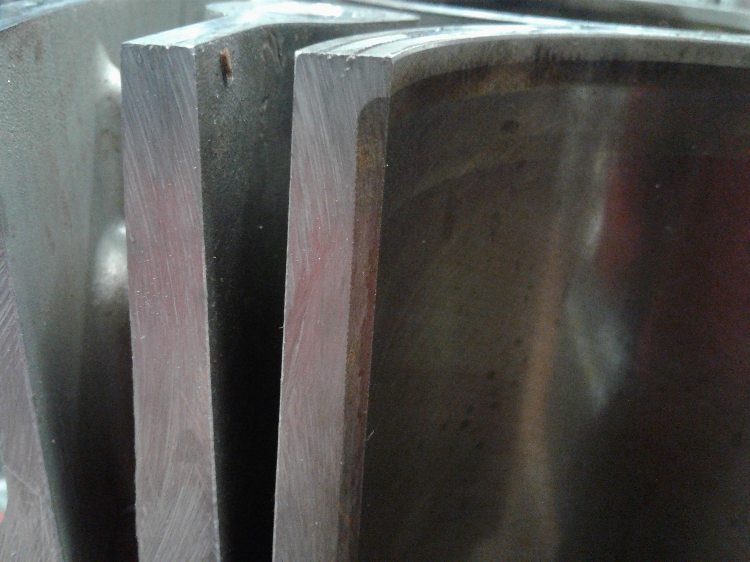

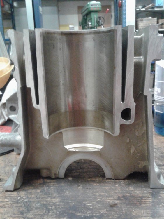

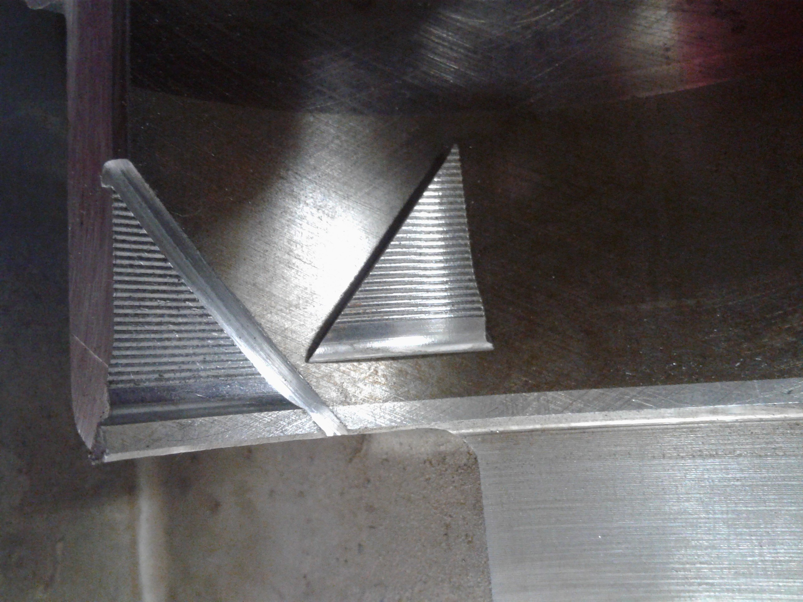

A little update: FYI I have now split the cylinder on a EW10J4, and that was enlightening to say the least. Thickness of the liner differs from 2.0 to 2.5 mm. So boring it out from 85 to 88 will not work. The liner got riffles to make it sit better in the aluminium. Does anyone know if there is a thicker liner in the EW12?
Regards

couldn't say myself if the liner is thicker, however it is 86mm to start with, so 87mm should not be an issue, DCC was planning on going 87mm with an EW12 till he changed his mind, I believe Sandy Brown has built an almost 2.3 with an EW12 block.
Thijs_Rallye
That is one piece of marvelous casting engineering imho. I love people being this thorough when building an engine!
