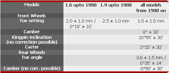

I’ve never measured it there but it’ll be bugger all if you’re set at standard castor, 1 degree if you’re lucky. There’s nowhere near enough castor on them
images?q=tbn:ANd9GcT8RxZxDhGikOsJaFkkrwU
PhilNW
I have the settings thanks welshpug just wondered if you are supposed to get equal readings i.e. -1.5° on 20° left and +1.5° on 20° right giving say the 3° in total? OR maybe -1° L and +2° R to give the 3°

As welshpug says it doesn’t work like that, it’s a compound angle with the top of the damper pointing inwards and rearward.
what exactly are you trying to do?
I get what he means, it’s a way of measuring caster, you turn the wheel out by 20deg, measure camber, turn it in by 20deg, measure camber again, add them together gives you caster angle. I’ve personally never worried too much about the actual number, but on cars with adjustable shizz it’s a useful check that you have set it equally side to side.

Trying to get an idea how much camber gain/loss you get when turning the wheels from straight ahead

Tom is correct.
Dynamic camber gain on 205s is crap, like most fwd cars to be honest, massive improvement to handling can be made by getting more castor.
My 205 has 6 deg of castor. I haven't measured how much, but it does pull on a considerable amount of camber. It takes a lot of mods to get up to 6, but even getting to just 4 will improve handling considerably.
