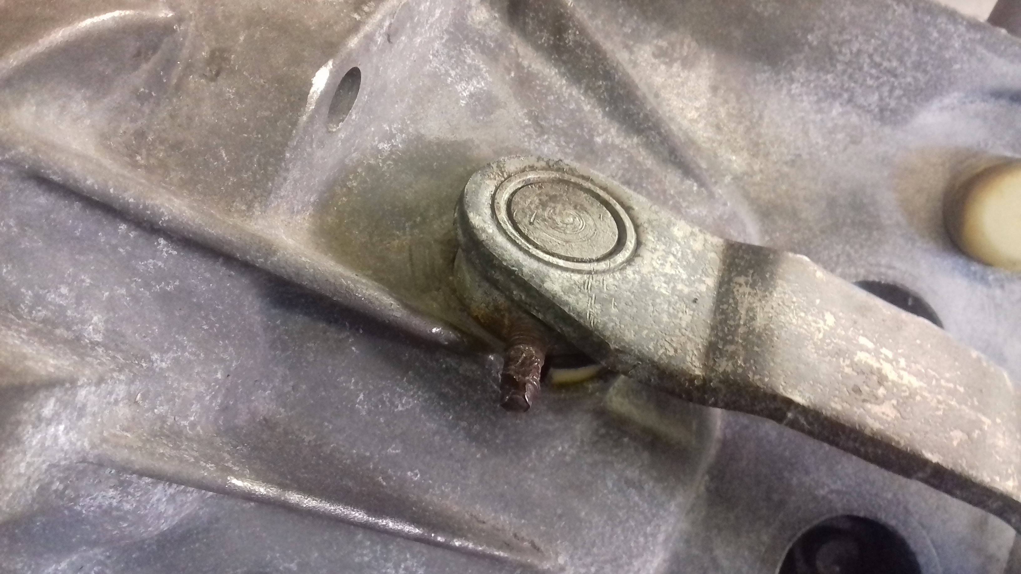

Telf 227 2 Cars Posted April 20, 2018 (edited) Can anybody give me any advice on the best way to remove the pin on the clutch arm so I can get the bushes changed! Thanks Edited April 20, 2018 by Telf Share this post Link to post Share on other sites
welshpug 1,670 Posted April 20, 2018 its an M7 thread, the dealer way is a slide hammer attachment, I have had some success with adding a small section of tube and winding an M7 nut down it, though the threads aren't that strong really. Share this post Link to post Share on other sites

Tom Fenton 1,554 Posted April 21, 2018 If you are careful you can drill the pin out and then draw the arm off with a puller. You need a good eye to drill the pin out square though without deviating. The arm will also likely be a tight fit on the shaft and need a good puller to get it off. Share this post Link to post Share on other sites
allanallen 528 2 Cars Posted April 21, 2018 Ages since I’ve done one but I’m sure I’ve always just drifted them out in the past?! Share this post Link to post Share on other sites
welshpug 1,670 Posted April 21, 2018 the later smooth pins with the spring tend to come out easy but the earlier type have a very slight taper near the threaded end and go in very tight. access to drift them out is not great, you cant get a straight hit. Share this post Link to post Share on other sites

Telf 227 2 Cars Posted April 21, 2018 thanks guys, yesterday I tried putting a couple of nuts on it to lock them and then used a hammer drill action to persuade it- that didn't work... then I put a set of mole grips on it and that just knackered the threads... then I set about it with a drift and a hammer- but the access is crap and I didn't fully commit because I didn't want to damage the case. Last option today is drill it out I think then failing that cut the whole thing off. What a crap design. Share this post Link to post Share on other sites

Telf 227 2 Cars Posted April 21, 2018 no mate I haven't - its still a bonk design. I used my engineering know-how and resorted to a hammer, punch and junior hacksaw, got it out in about an hour LoL Share this post Link to post Share on other sites
