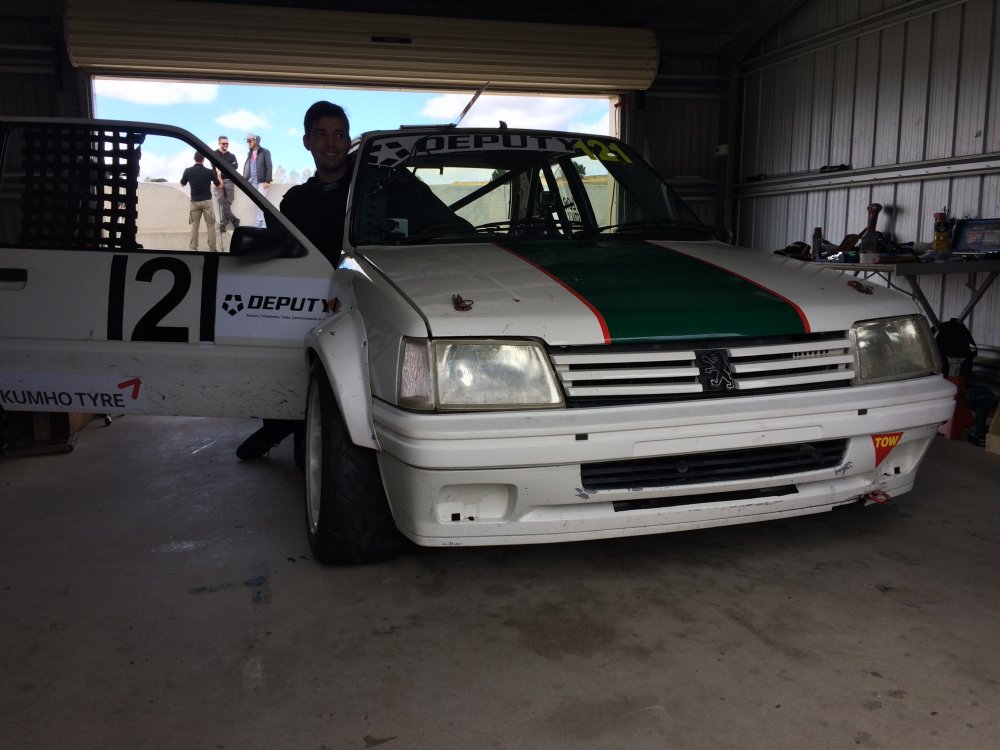

woodymi16 24 2 Cars Posted March 21, 2018 OK a bit like asking how long is a piece of string....... I've fitted a Satchell subframe and wish bones and have some arch extensions to fit. What I need some help with is how much (if any) I need to trim the wings to ensure enough clearance for the tyres. Front shocks are AST 5300 with 60N/mm springs and the front end doesn't move with me trying to bounce on the wing. If anyone has any pics of anything similar or any advice that would be much appreciated. Share this post Link to post Share on other sites
Biggles 65 Posted March 21, 2018 Track car I presume with springs like that. If the photo is with it on its wheels then I'd try it as is. I run 325lb and use about 1" of compression on the track. Share this post Link to post Share on other sites
woodymi16 24 2 Cars Posted March 21, 2018 6 minutes ago, Biggles said: Track car I presume with springs like that. If the photo is with it on its wheels then I'd try it as is. I run 325lb and use about 1" of compression on the track. Yes track car and its on its wheels, thanks for the info. Share this post Link to post Share on other sites

petert 601 Posted March 22, 2018 Unfortunately you won't know until you corner weigh it. I run a similar front end (ie 405 driveshafts) with 650lb springs. I have had to cut my guards back to just above the holes and roll the guards, as the tyres were getting sliced. Your springs are relatively soft and I think you'll have issues. Share this post Link to post Share on other sites
woodymi16 24 2 Cars Posted March 22, 2018 2 hours ago, petert said: Unfortunately you won't know until you corner weigh it. I run a similar front end (ie 405 driveshafts) with 650lb springs. I have had to cut my guards back to just above the holes and roll the guards, as the tyres were getting sliced. Your springs are relatively soft and I think you'll have issues. Ok thanks Peter, corner weighting is booked next month. I may have to make some sort of gauge to tell me how much travel I get under load. Share this post Link to post Share on other sites

allanallen 528 2 Cars Posted March 22, 2018 47 minutes ago, woodymi16 said: Ok thanks Peter, corner weighing is booked next month. I may have to make some sort of gauge to tell me how much travel I get under load. A cable round the damper rod/insert does the job, failing that a depth gauge on the groove in your tyre 1 Share this post Link to post Share on other sites

Biggles 65 Posted March 22, 2018 9 hours ago, allanallen said: A cable round the damper rod/insert does the job Cable tie Does the job very nicely Share this post Link to post Share on other sites
