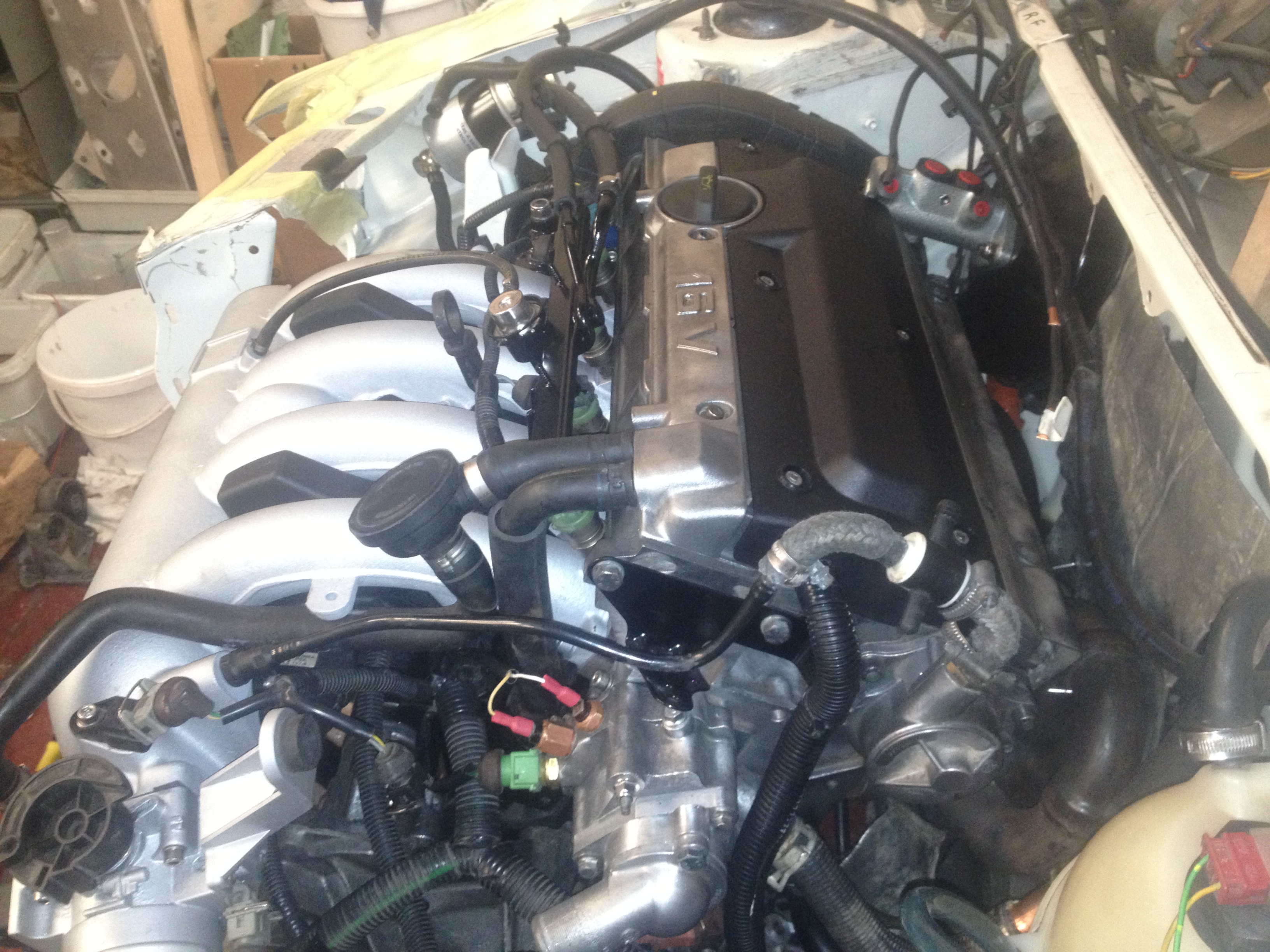

On the 205 Tstat housing there is a shorter sensor and a longer sensor (single blade), and iirc the shorter on is the actual sensor (variable resistance for gauge), and the longer one is the switch for the gauge warning light, (not the stop light).
So i think you want to get a Tstat housing from a GTI6, find the wires from the dash (iirc 47 and 47a and extend/or jump onto the GTI6 loom), and fit the two sensors from the 205 in the Tstat housing.
here's a pic i found of mine when i did GTI6 conversion, and all works as it should (you can see the single blade/wire sensors.
Treat the above with caution as it's been a while!
