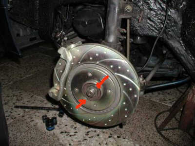

I am in the middle of buying hubs from a 205 1.9 GTI, but I wondering how to see difference between compared to other hub that looks like the a 205 1,9 GTI.
For example the Peugeot 306 hubs look quite similar, but I have heard they are not.
How do I know a peugeot 205 1.9 GTI hub.
I know that the Peugeot 205 1,9 GTI has 25 splines for the driveshaft and a wheel bearing in the size.

If the hub is complete with the bearing in then you can usually identify it by the drive flange having a slot across the end.
I think the 306 hubs are usually plain on this flange, another identifying point could be the ABS mount more likely to be found on the 306 hub.
